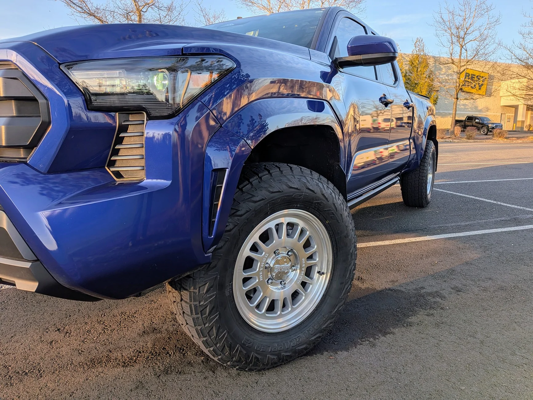

Went up from 265/70R18 (32.64" & 46lbs) to 275/70R18 (33.19" & 45.5lbs) in the Nitto Terra Grappler G3. 275 feels much better on our bumpy city roads; much more plush! Fills out the wheel well nicely as well.
Apache off road 1/2" rear spacer will go on today .

I would try out 28psi and see how it feels.
How is the 8AT with the 33s? First feel any longer?

Will do! They recommended 29psi in the 265s. Haven't had the 275s on long enough to see how everything else feels.
Currently having issues with the level. Took it to a shop to have them throw in the rear spacers and they measured everything and it's now perfectly even all the way around which means it added over 2" up front on the second perch setting, but 2 issues:
1. I wanted a little rake
2. Camber was off
They're gonna take the 5100s down to the first perch setting for a 1" / .5"
I'll let ya know about the AT !

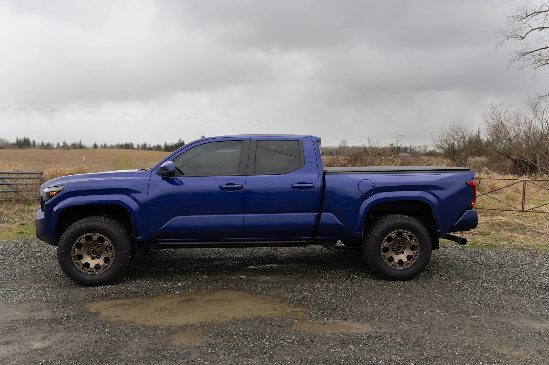

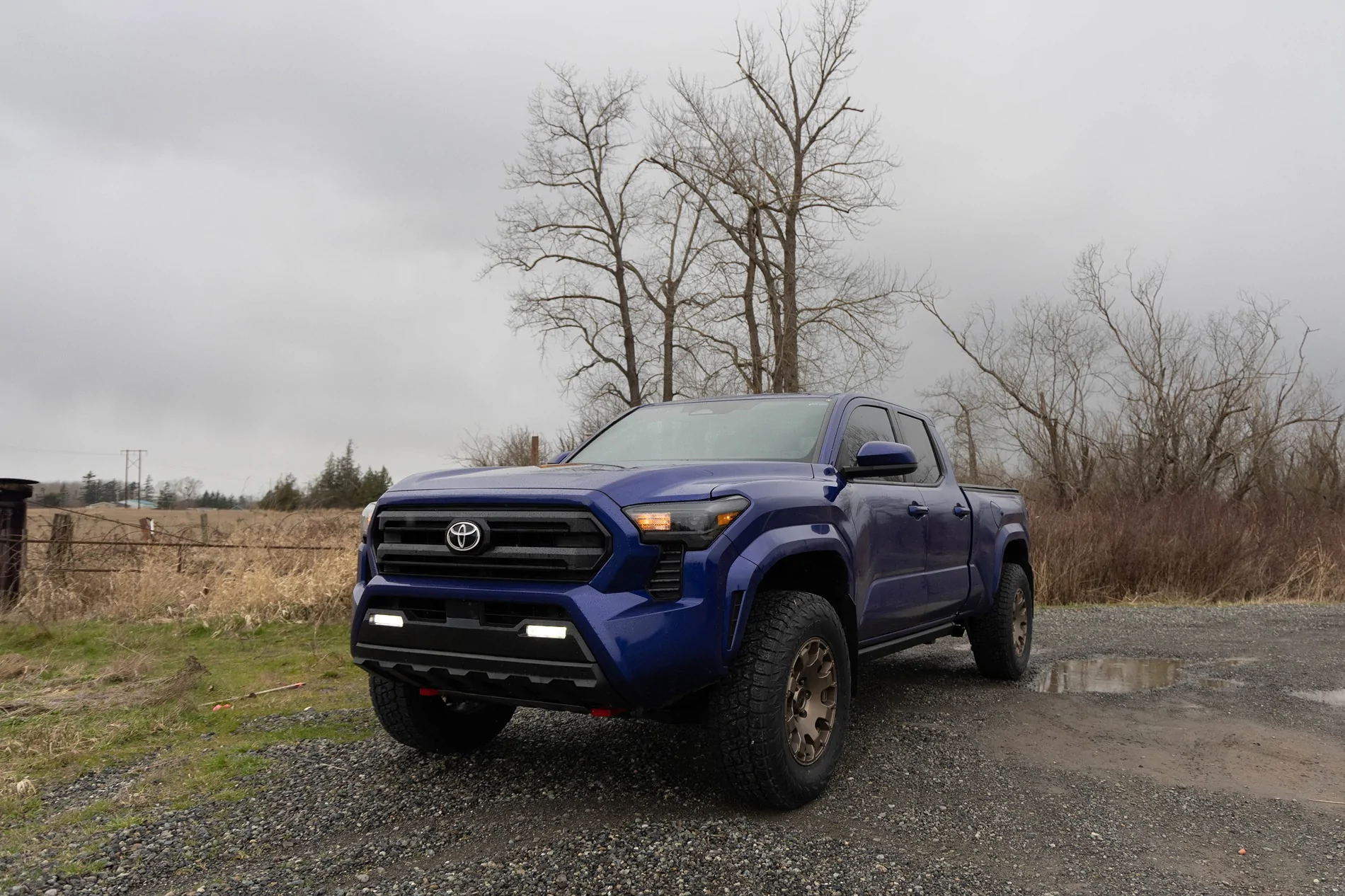

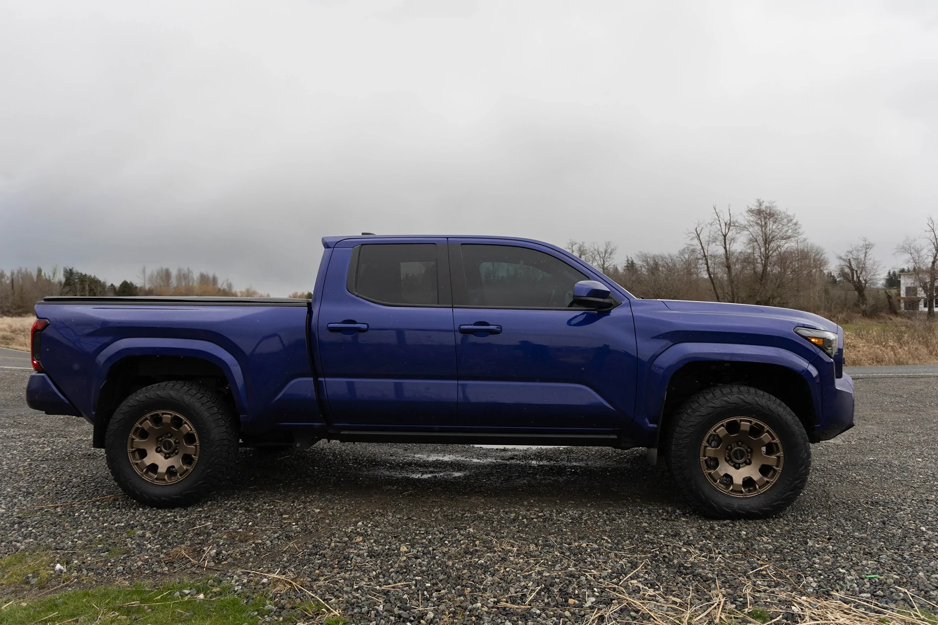

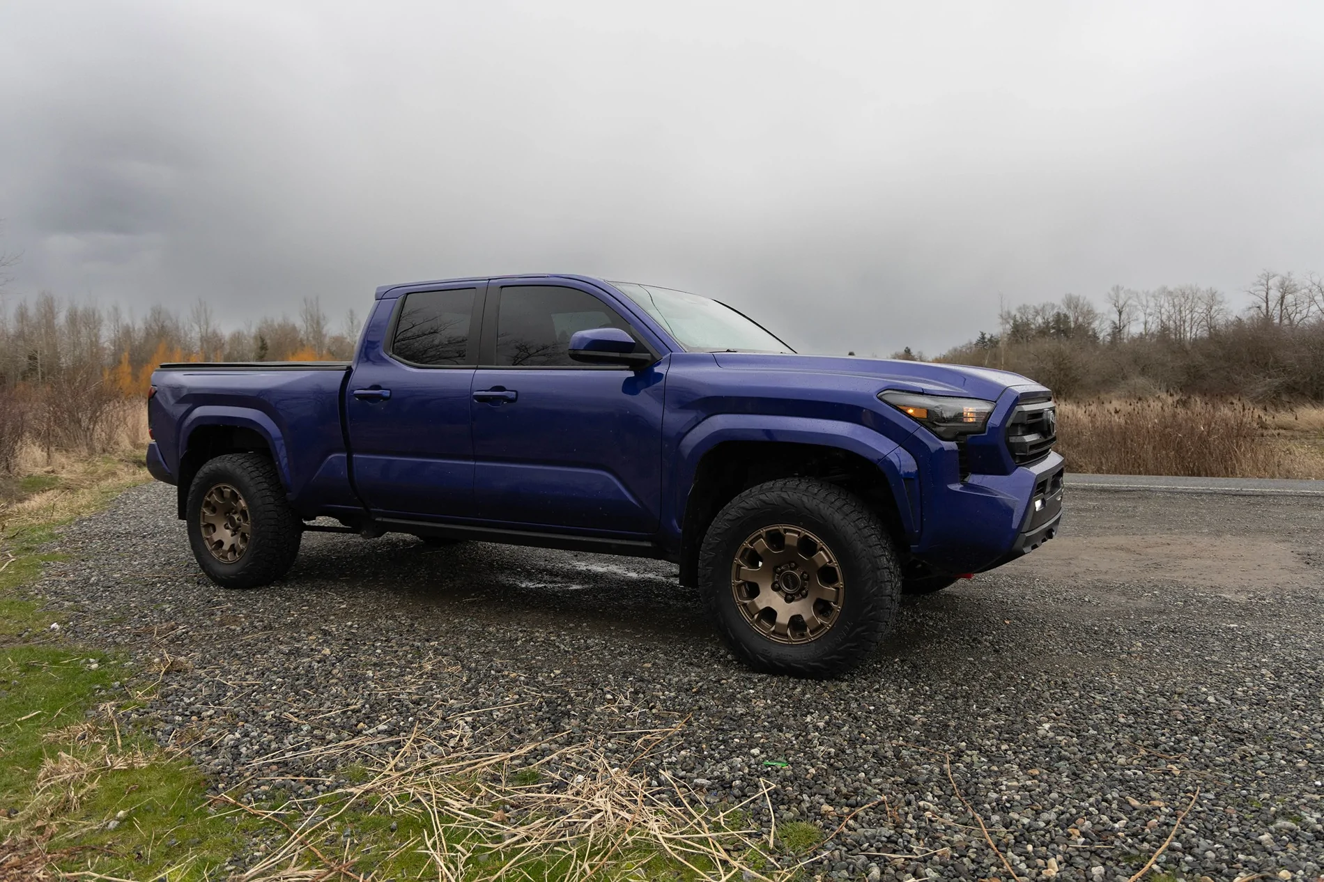

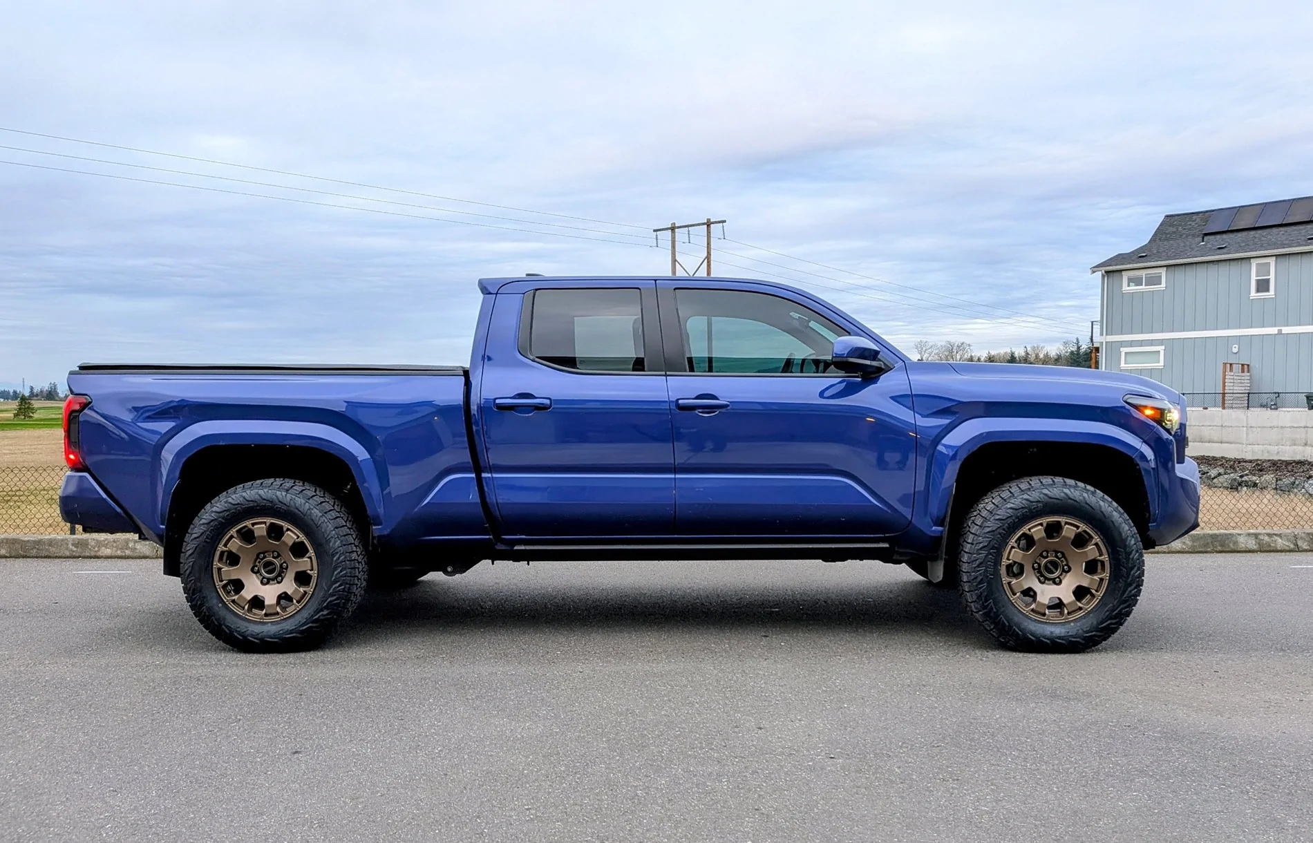

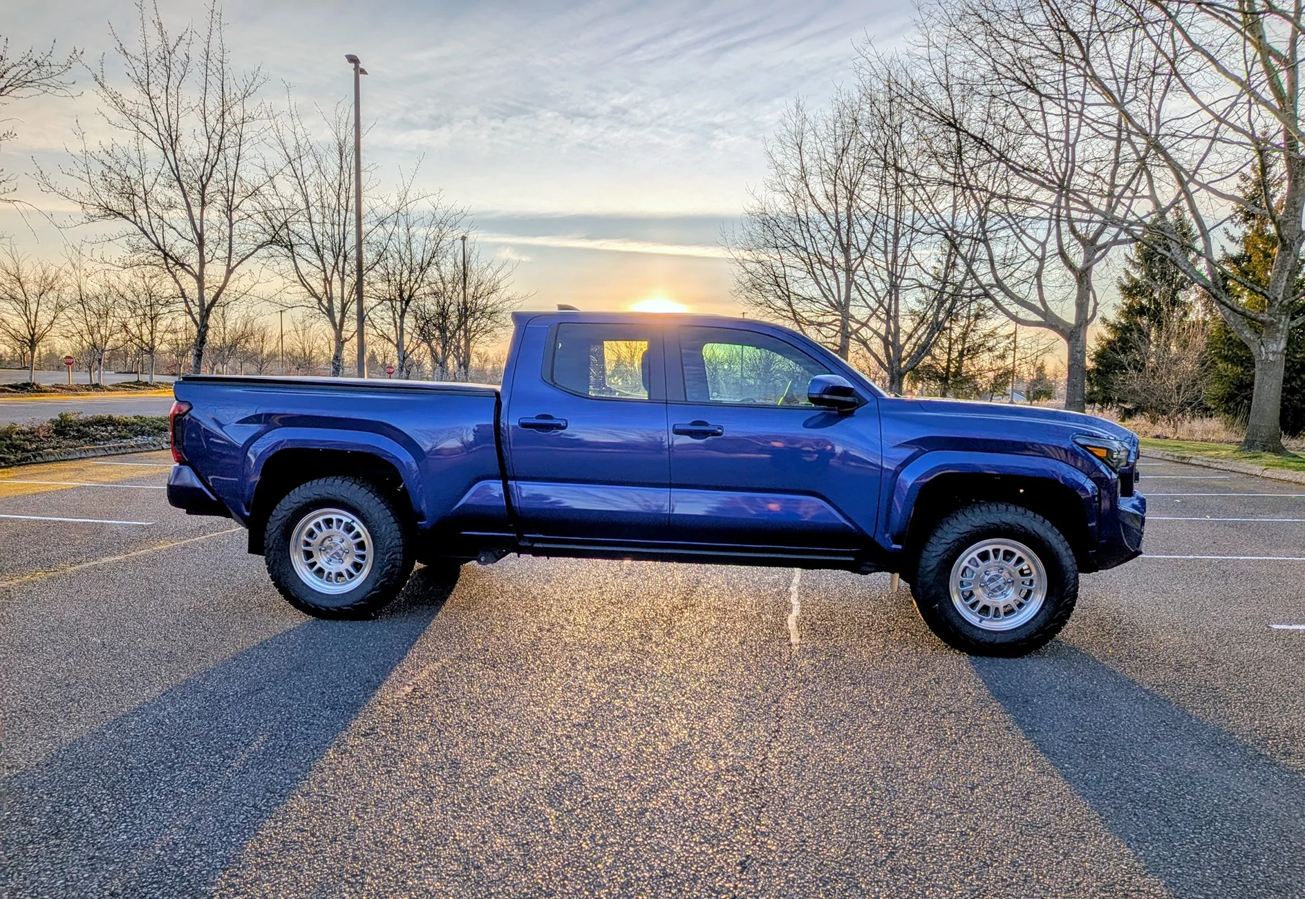

Squat corrected. Bilstein 5100s set to 1" on the front which gave a total of 1.5" lift when measured to the wheel well. Near level at the rocker/cab with no rear lift. Apache Offroad 1/2" spacer added in the rear for a little bit of THAT RAKE, baby!

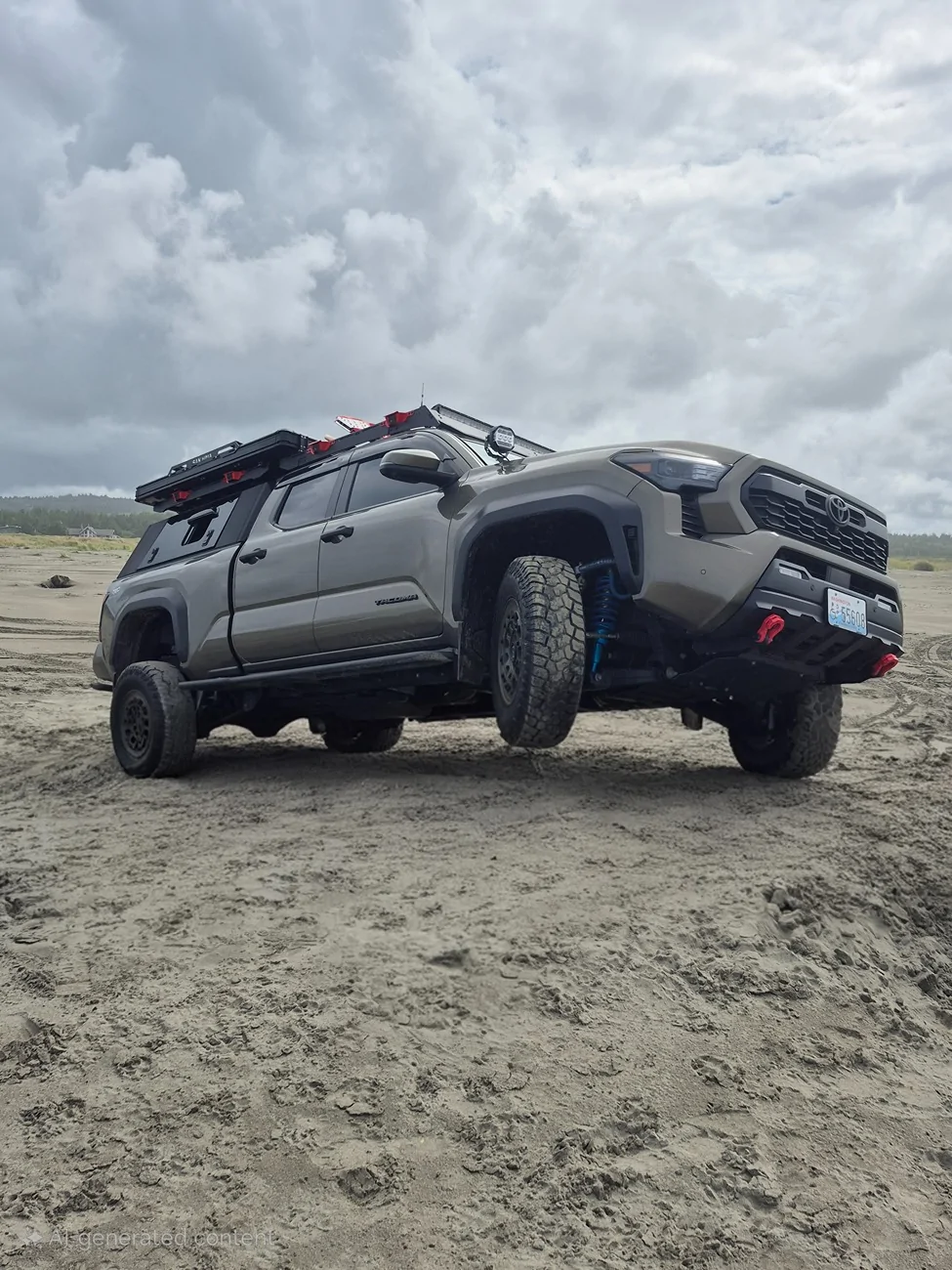

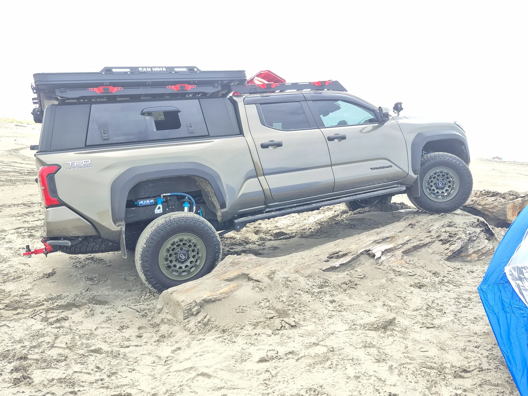

I found out that original Center caps were obviously not designed to run through the duner down towards the local bar in . After i turn left, at the tee, then I go down to the first main beach exit to the right. Great place to take a break, cleanish outdoor bathrooms with sinks. You also can park and walk in if you feel any hesitates towards driving on the beach.
Since I've started building this truck I will only buy the best I can when I can.
2.5" KING with new Total Chaos uca's
Dobinsons c57-819 .I now have dobinsons c57-821 are on the way, as well i ordered new 650lb. Springs to replace the 450lb ones that came on the Kings 🤴
The wife and I will go the legal speed limit 25 miles an hour taking full advantage of jumping when possible and switchbacks that are below the grass line and above the clam beds. So that I'm not breaking any rule
There is a good 10 mile strip of beach that ranges from a 18/12 inch drop to an equivalent jump I've found throughout about a 15 mile long stretch and always have 1/2 to mile wide woops 🤑
We found a dog friendly part of the beach, so we all had fun

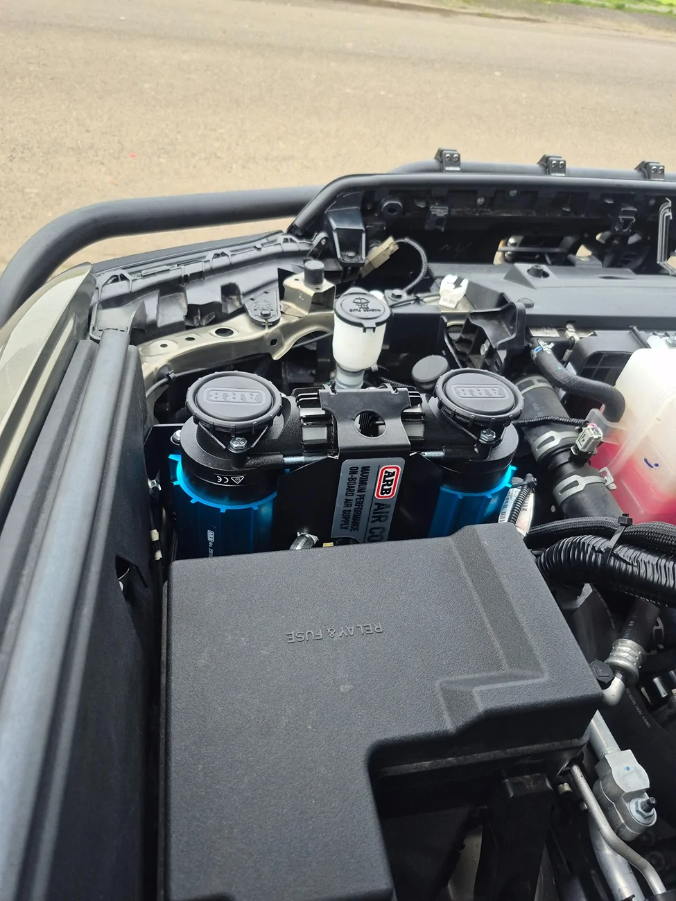

This was the 2nd time I got to use my ARB twin with the zroadz bracket......
Wait for it👍👊👏👏🫶🤝 i use a 4 line setup for faster inflation/deflation
