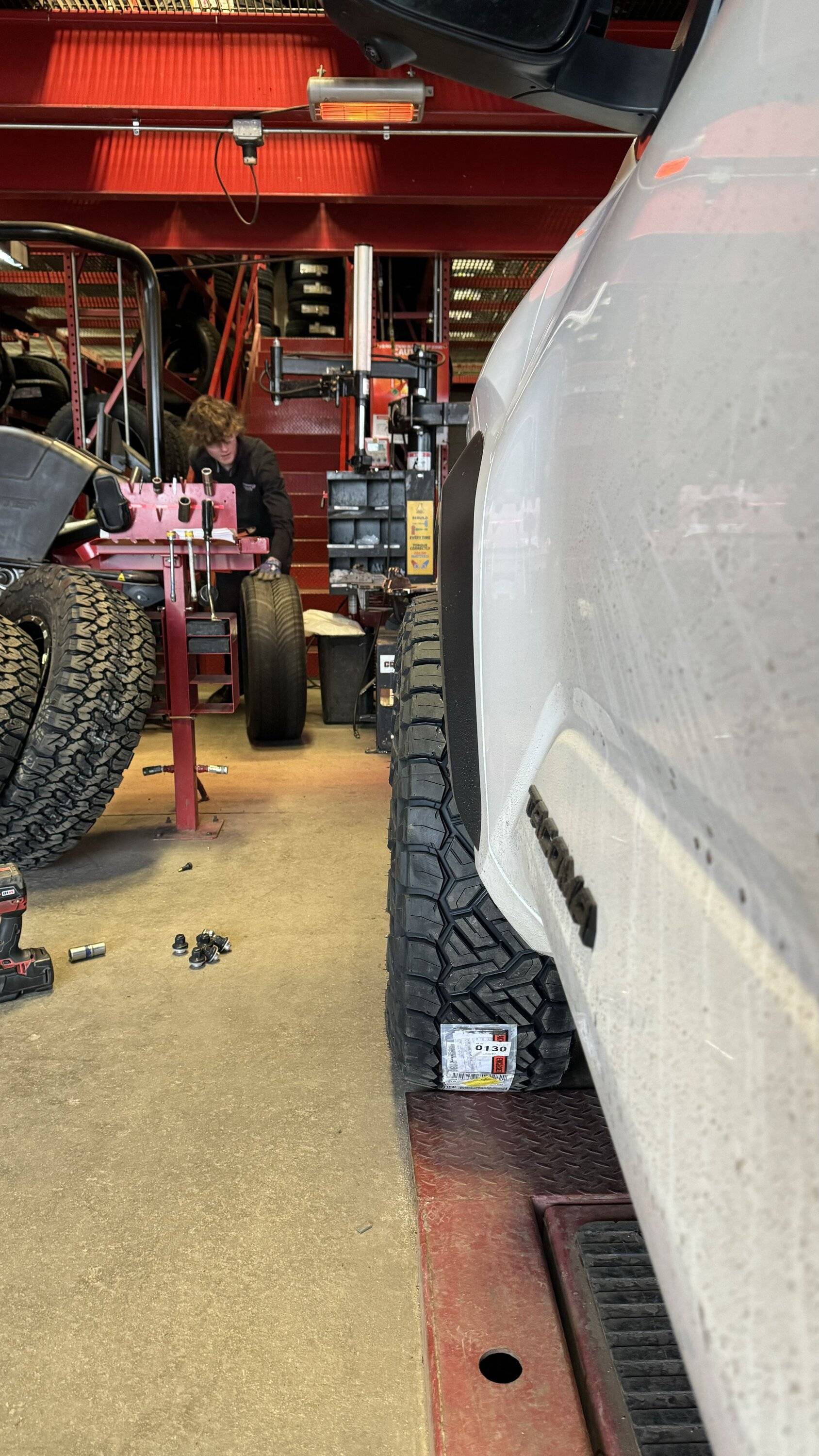

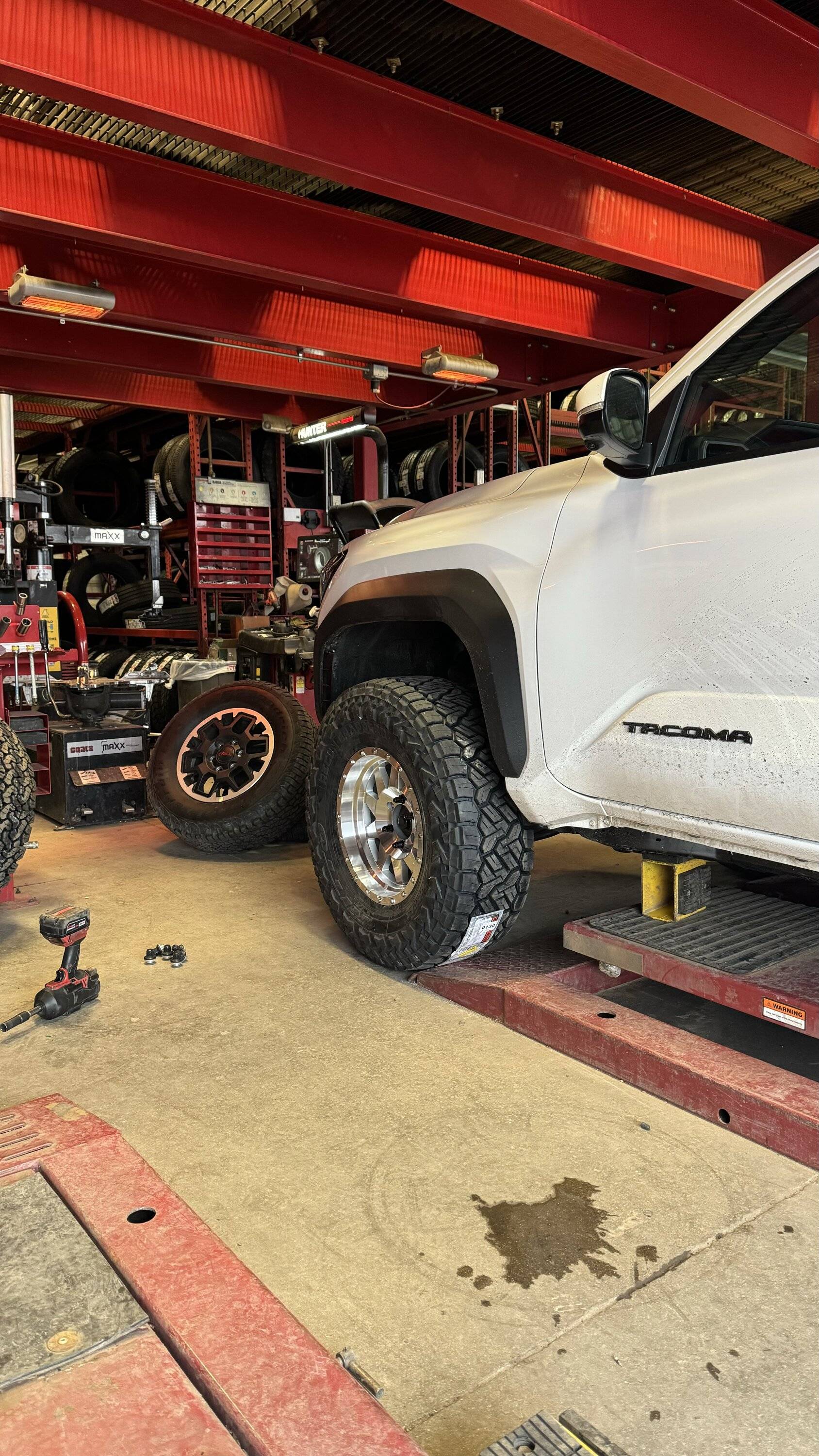

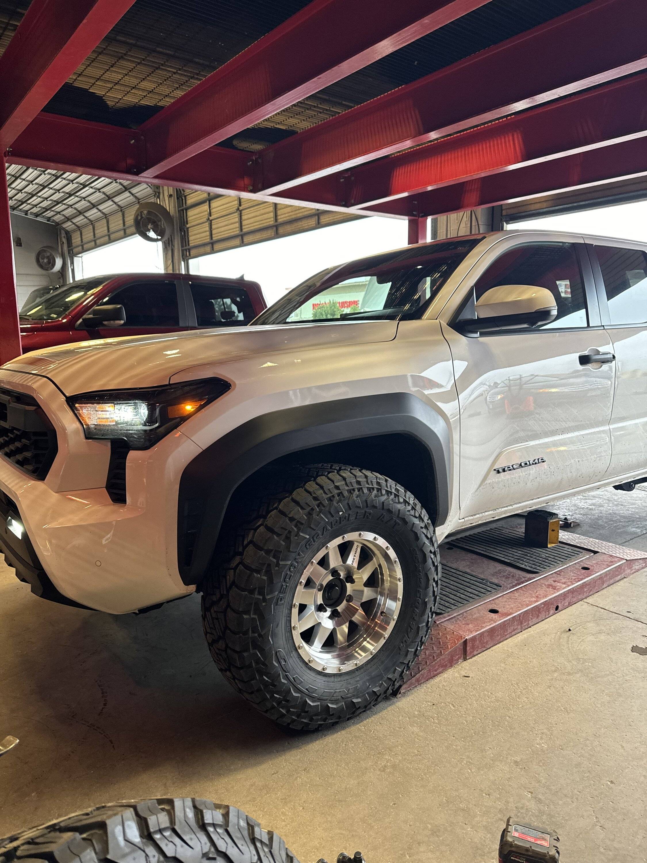

Here are some pictures of a nitto recon grappler 35/12.50R17 with a 17x8.5 0 offset. Stock height, it’s a tight fit but it’s doable, you’d have to remove the bracket from the body mount and trim a tiny bit off the front bumper. (At the very bottom)

First 35s we've seen i think. Have you driven it yet? How's the turning clearance, any rubbing?

Very little rubbing with stock suspension, I haven’t driven it with 35s yet. Those weren’t my wheels so we only did one tire

Hopefully society doesn’t forget to get positive offset wheels to avoid sticking the wheels out a mile lol

Despite not liking too much poke so I'm not kicking back rocks to myself and people behind me, this looks dope. I'm really curious to see how well it performs with the stock suspension!

That building and equipment look familiar. The last pic looks like they where using the floor lift to increase the height of the truck to a 6 inch lift.

It was at discount tire!! We lifted the truck up to a full 3in lift
