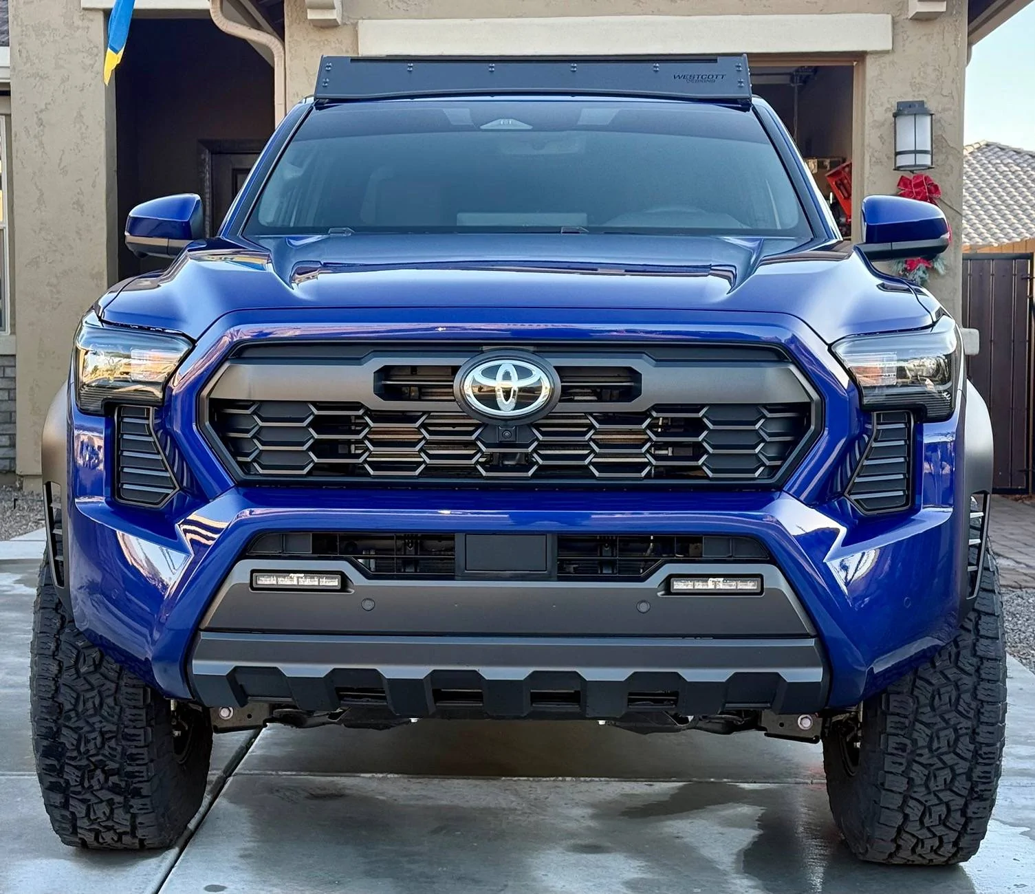

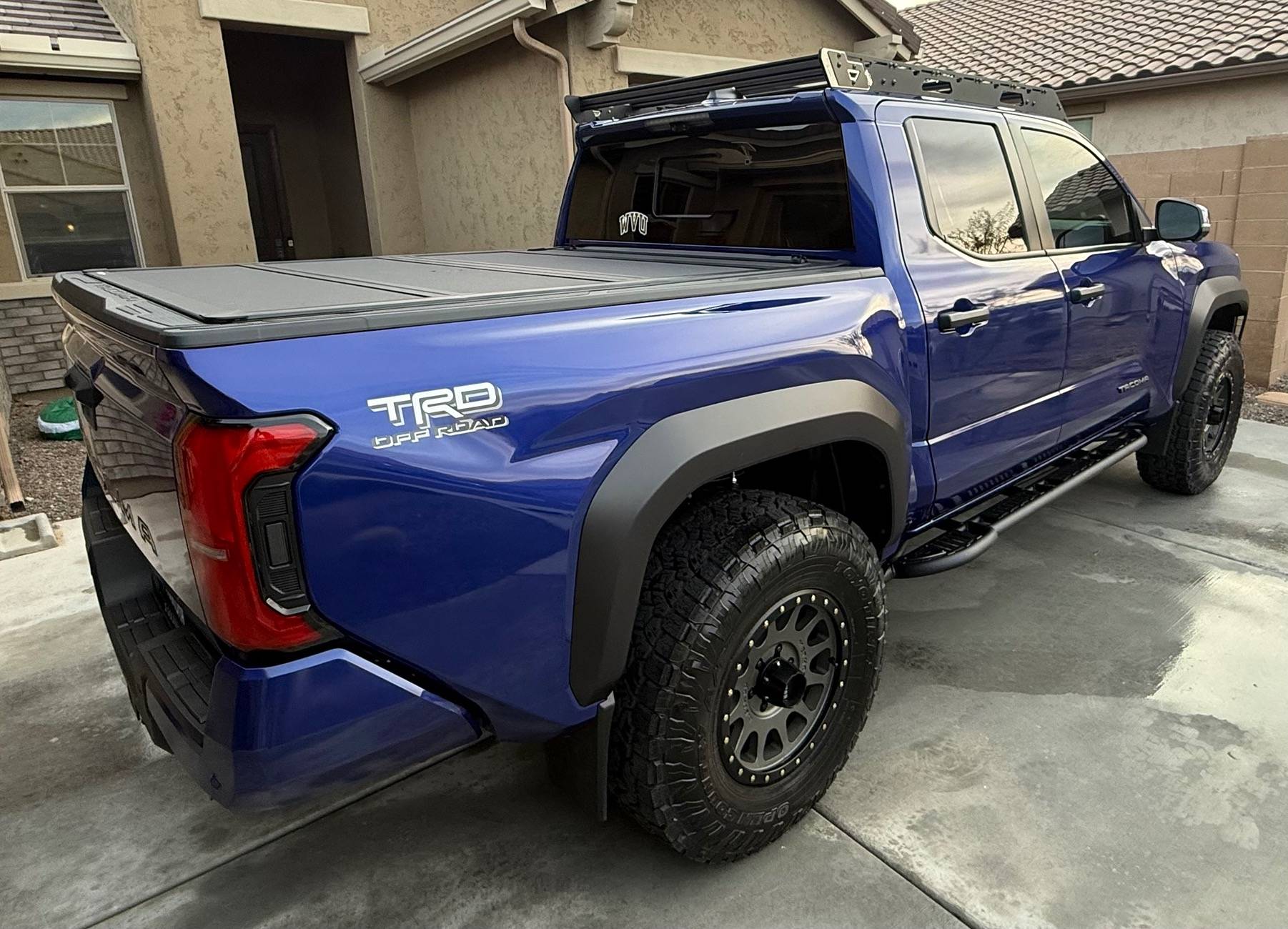

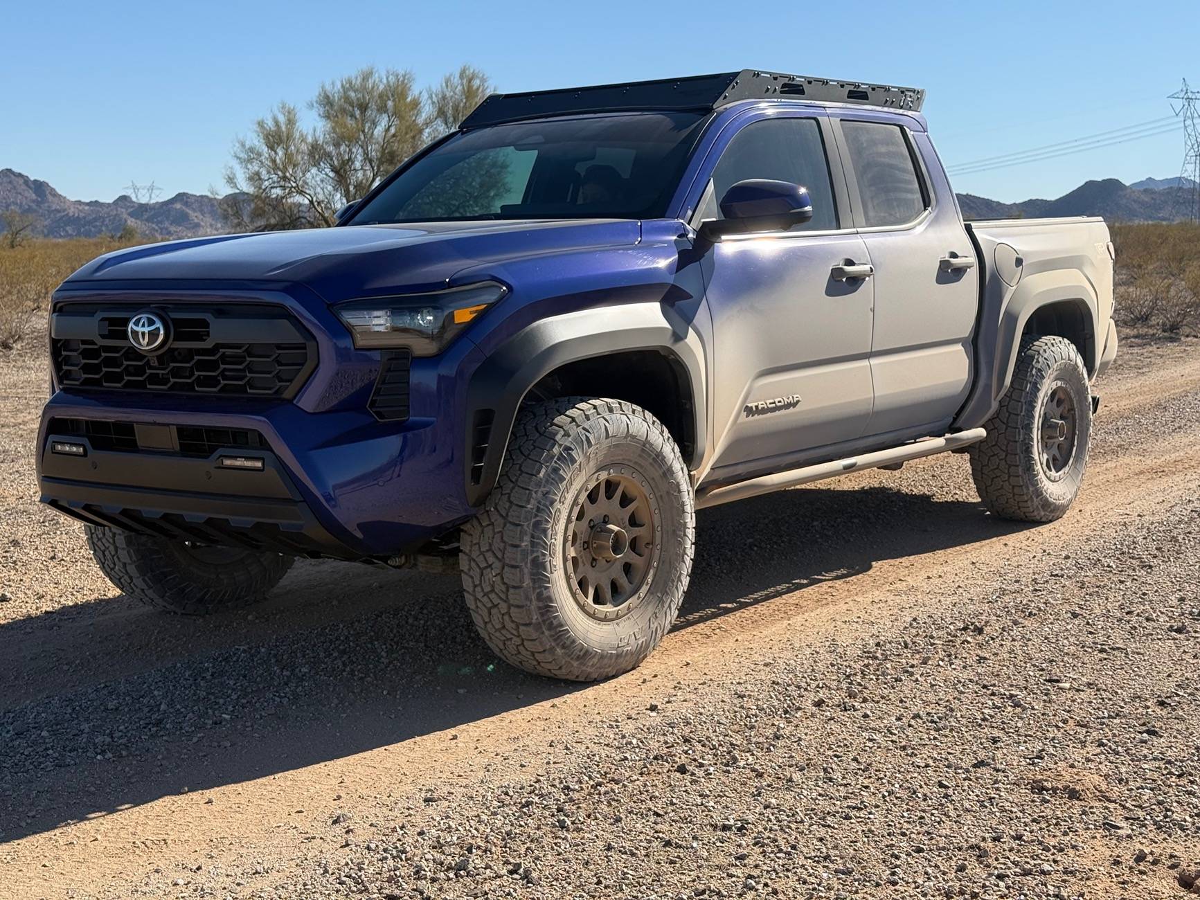

tank69
TANK
Sep 30, 2024
Goodyear, AZ
2024 Tacoma Off Road
No issues whatsoever! Same build I have.
2024 Tacoma +25 offset and 285/75/17r plus Westcott Designs precollar lift- any issues? IMG_0414
2024 Tacoma +25 offset and 285/75/17r plus Westcott Designs precollar lift- any issues? IMG_0376
2024 Tacoma +25 offset and 285/75/17r plus Westcott Designs precollar lift- any issues? IMG_0267
