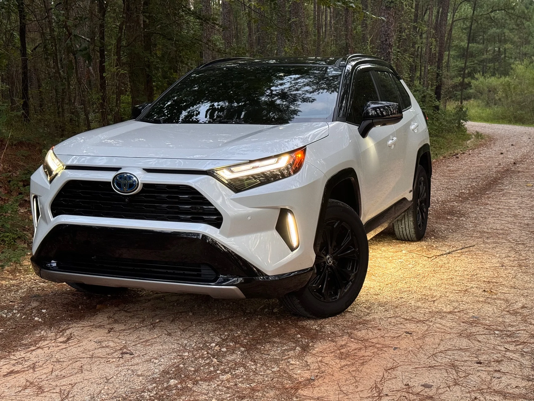

I found a pair of 64-inch truck-bed LED strips on Amazon for $40 and mounted them underneath the vehicle, basically running the length of the doors. I tapped them into the interior dome-light circuit, ran that through an on/off switch, and then split it to the left and right light strips.
It worked really well because the entire area underneath the front and rear doors was evenly illuminated instead of having one concentrated light coming from the mirror. They also faded in and out with the factory interior lights, which made the setup feel surprisingly OEM.
I ran them through rain, snow, road grime, summer heat, and winter with zero issues.
I already bought another set for my Tacoma Pro, but I haven’t installed them yet. On the RAV4, there was a small opening with a rubber grommet on both the driver’s and passenger’s sides that made it easy to route the wiring into the cabin. I’m hoping there’s something similar on the Tacoma.
Personally, I preferred the look and coverage of the long strips over a single mirror-mounted puddle light since the light was spread evenly across the entire side of the vehicle.
