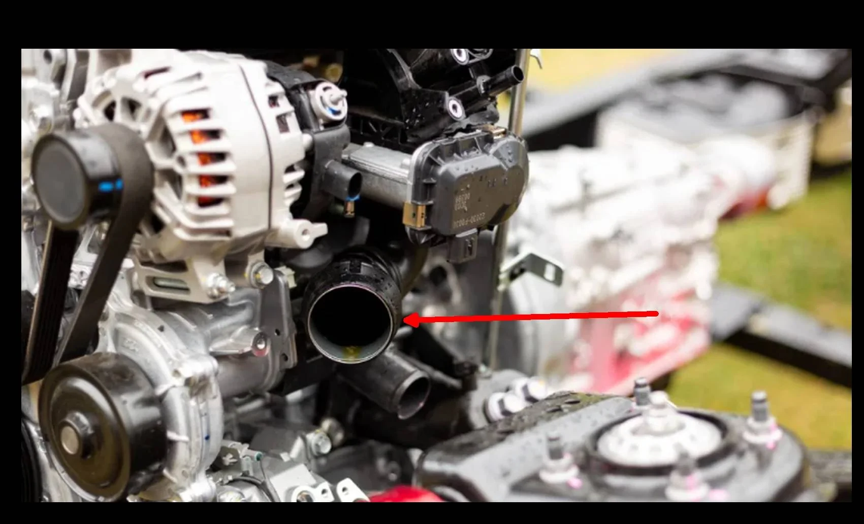

Apparently it's this inlet here.
That’s for the intercooler and Toyota v8s don’t use turbos so again no idea what he’s taking about lol

Okay guys I did some research on this through Toyotas technical information. Sheldon was kinda sorta right but he mentions the inlet being 3inch and it’s not, what is 3inches is the turbine for the water pump which in a way would be a “inlet”. That’s a massive turbine for a 4cyl and that’s what he meant when he said “what we spec for our v8s”. Hope this was helpful
