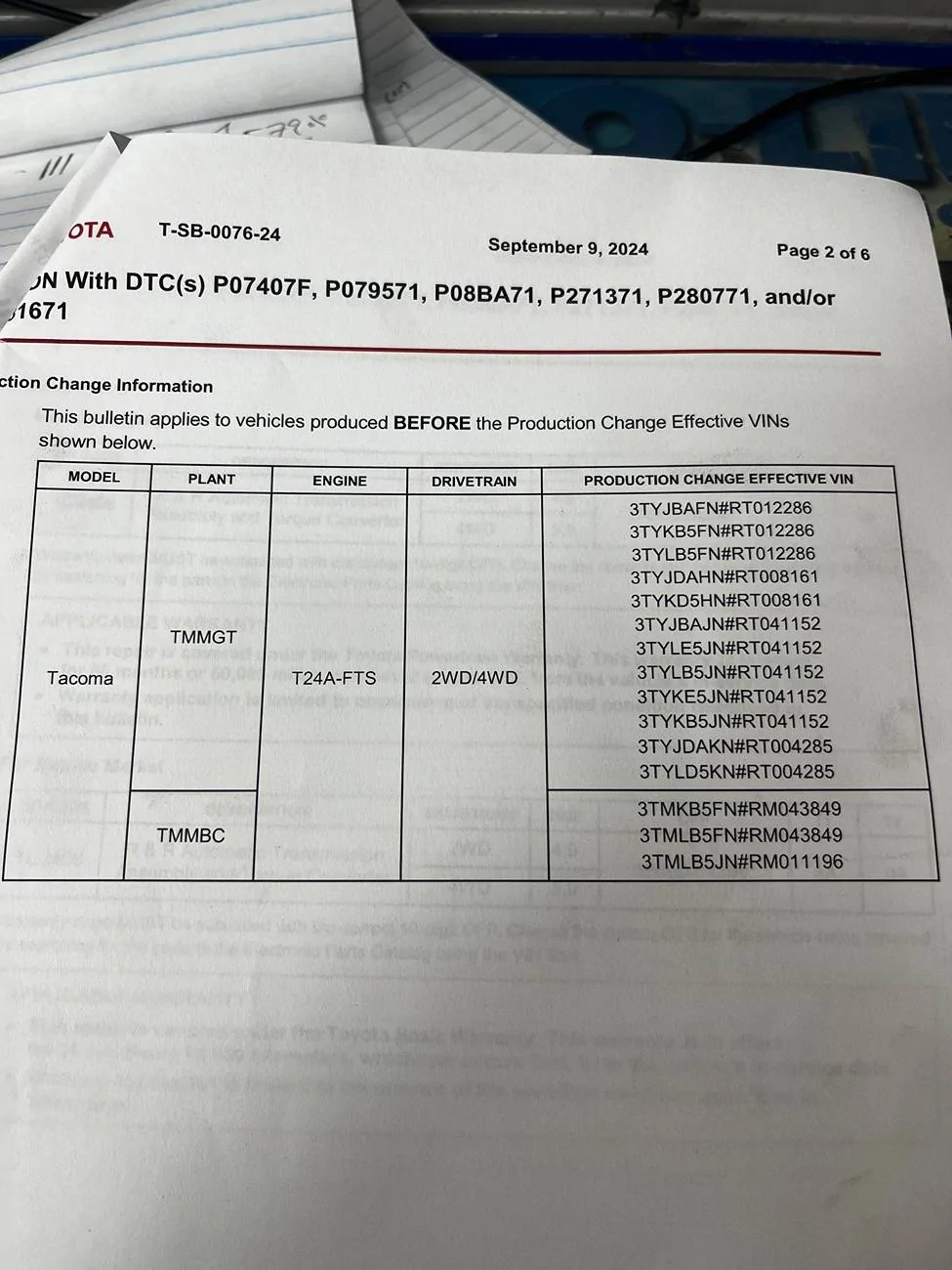

UPDATE - use this VIN lookup tool to determine if your VIN is affected by this TSB:
https://forms.gle/YWwM9Q3JJ8aWWHFW6
Here it is guys, official technical service bulletin for the codes that relate to transmission failure.
**UPDATED WITH PRODUCTION CHANGE EFFECTIVE VINs**
Steps to figure out if your VIN is in the TSB (by @taco_overlander).​
1. your VIN is an exact match to the letters and numbers to the left of the "#" in the TSB list​
2. your VIN has a number to the right of the "#" that is less than the number in the matched line found in 1.​
If you can do both 1. and 2., your VIN is in the TSB​

Can you post the whole TSB?

Wow thanks ! Sadly I fall into the VIN range ... but 7200km (4400miles) I've not had any issues with the transmission (yet). All seems fine with it.
How can you tell your vin falls into it? I can’t figure it out. Can you explain

How can I figure it out if mines affected? I can’t figure it out
Follow your first portion of your VIN in the range (up until the #) ....... then in the last 6 digits, if your VIN range is before the numerical number of the last 6 digits then you fall into it.

Just start at the left and take in one digit at a time.
3TYLB5JN7RT015852
