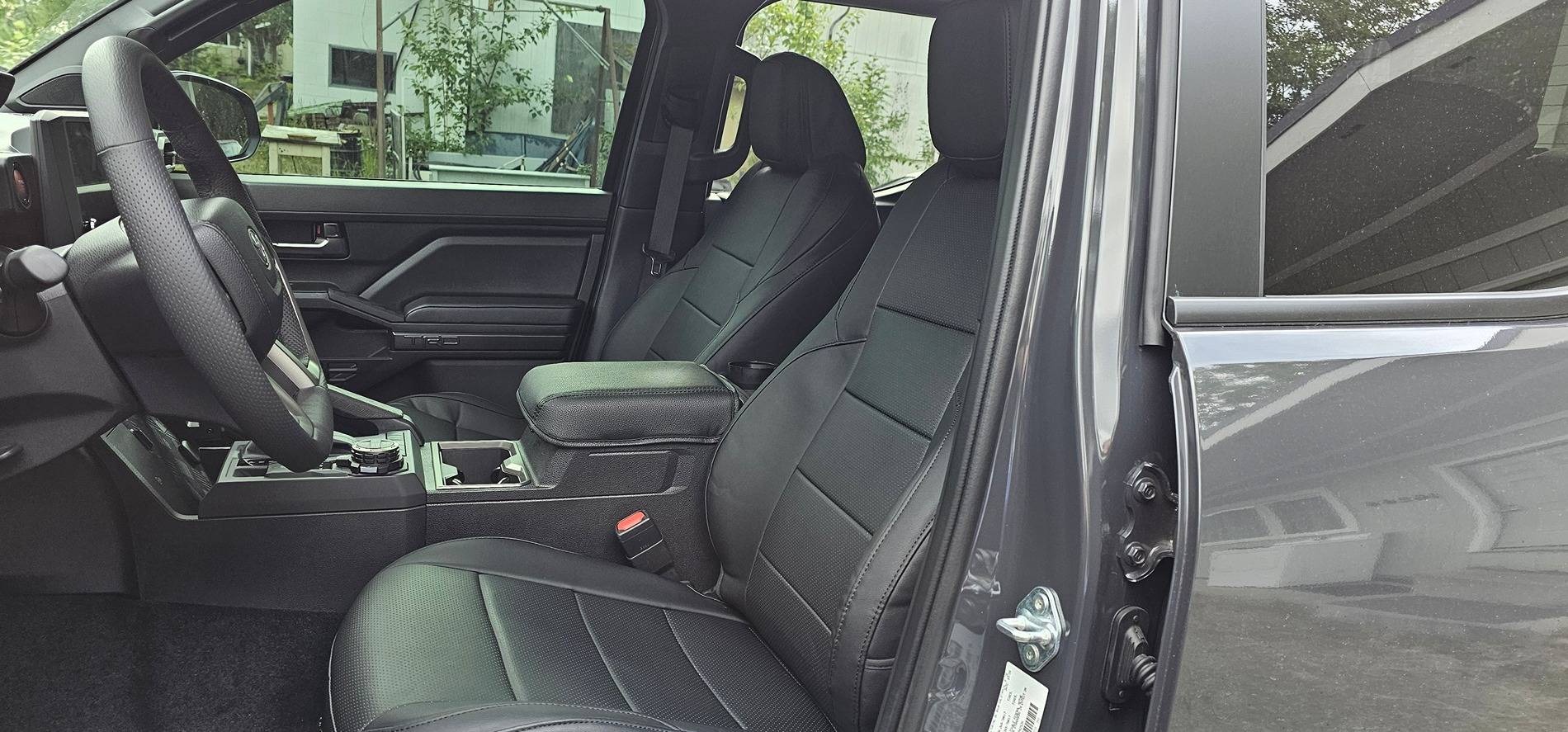

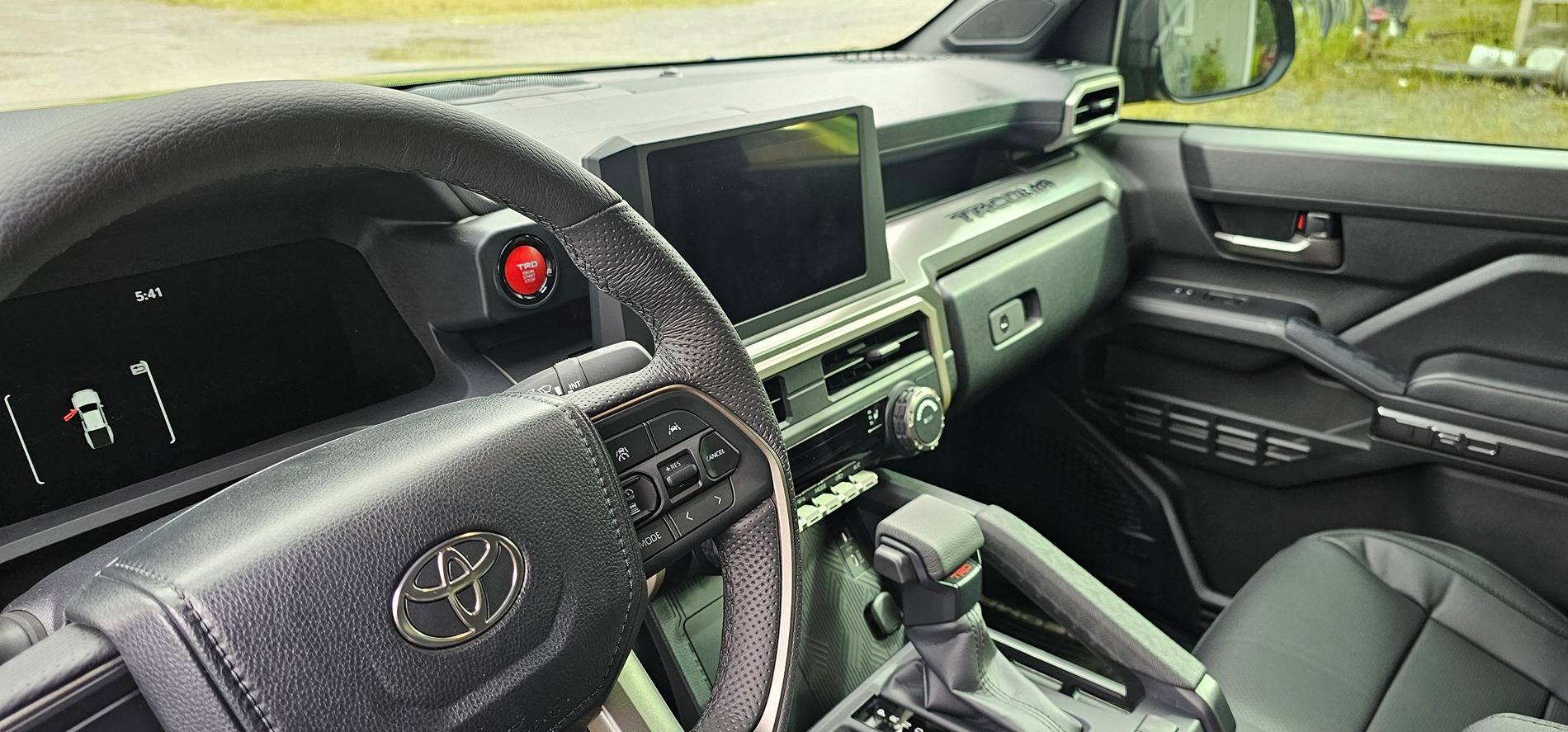

Hey guys I got everything I wanted when on got my Off Road upgraded package Tacoma but for some reason. This came with the 8in screen.. Power seats sliding rear window, moon roof... $50k plus.... Anyway I fixed the seats with some nice "pleather" seat covers... Now I'm ready to have a bigger screen... It sucks the base model Off roads came with the 14in screen but the upgraded off road came with the smaller one... Has anyone swapped theirs out yet... I want the OEM 14in but I haven't see it or the price plus the volume knob is in a different spot... Any recommendations for an aftermarket touchscreen that's has wirless android audio... I want between 10in-14in screen... Thanks
Edit*Is there a part number for the bigger infotainment screen and knob?

Pn I have been told for screen is 86100-Ak010 I have also seen a 86100-Ak030 part number which I believe is for those with JBL the knob is the same as the 22+ tundra 861280c060 and you would also need the switch 86170AK010. Last here is two videos
To see the back and hardware for the 24 Tacoma and,
To see how this was done with the tundra
Now my thoughts it's not worth it especially currently. That 14inch screen is beautiful,but it's also 9k. Second problem is you would have to hope you have history with your dealership AND that they were real ones because tundra owners who did the swap were complaining about issues of working and vin locking. If you get one new or used either way you will likely need a dealer to use a company device to sinc the vin onto the display or lose things like navigation. The other issue is the wiring harness if like the tundra the volume line could be installed and just plugged into a dummy switch and it's what I expect, but I haven't checked and if it's not there you would have to find a pn for that as well. I honestly think drilling a hole in the dash would be the easiest part of the process. All this and most likely If you ever have a wiring problem anywhere your dealership could say you started it with your mod. They could also just refuse and say the pn doesn't belong on your truck no hard feelings. Anyways if you have any questions let me know, and if you wind up trying it show everyone here I would love to know the validity of the process if I ever see a screen on eBay for cheap.
