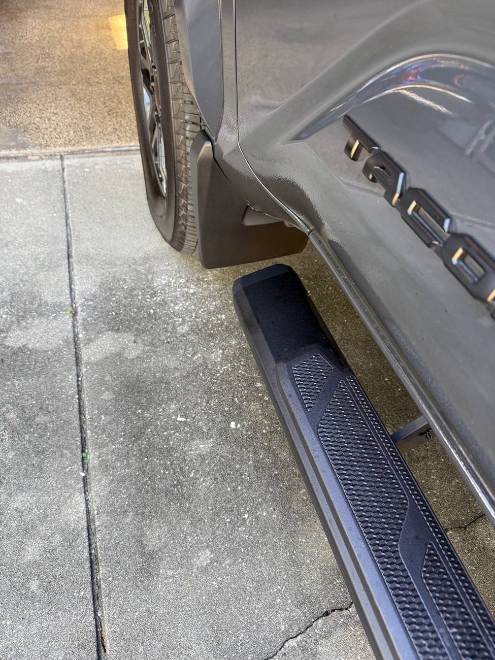

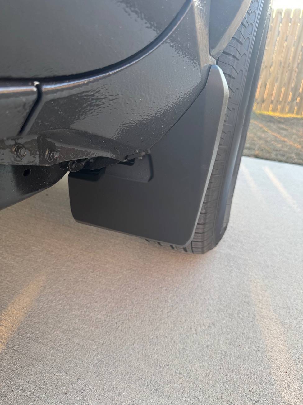

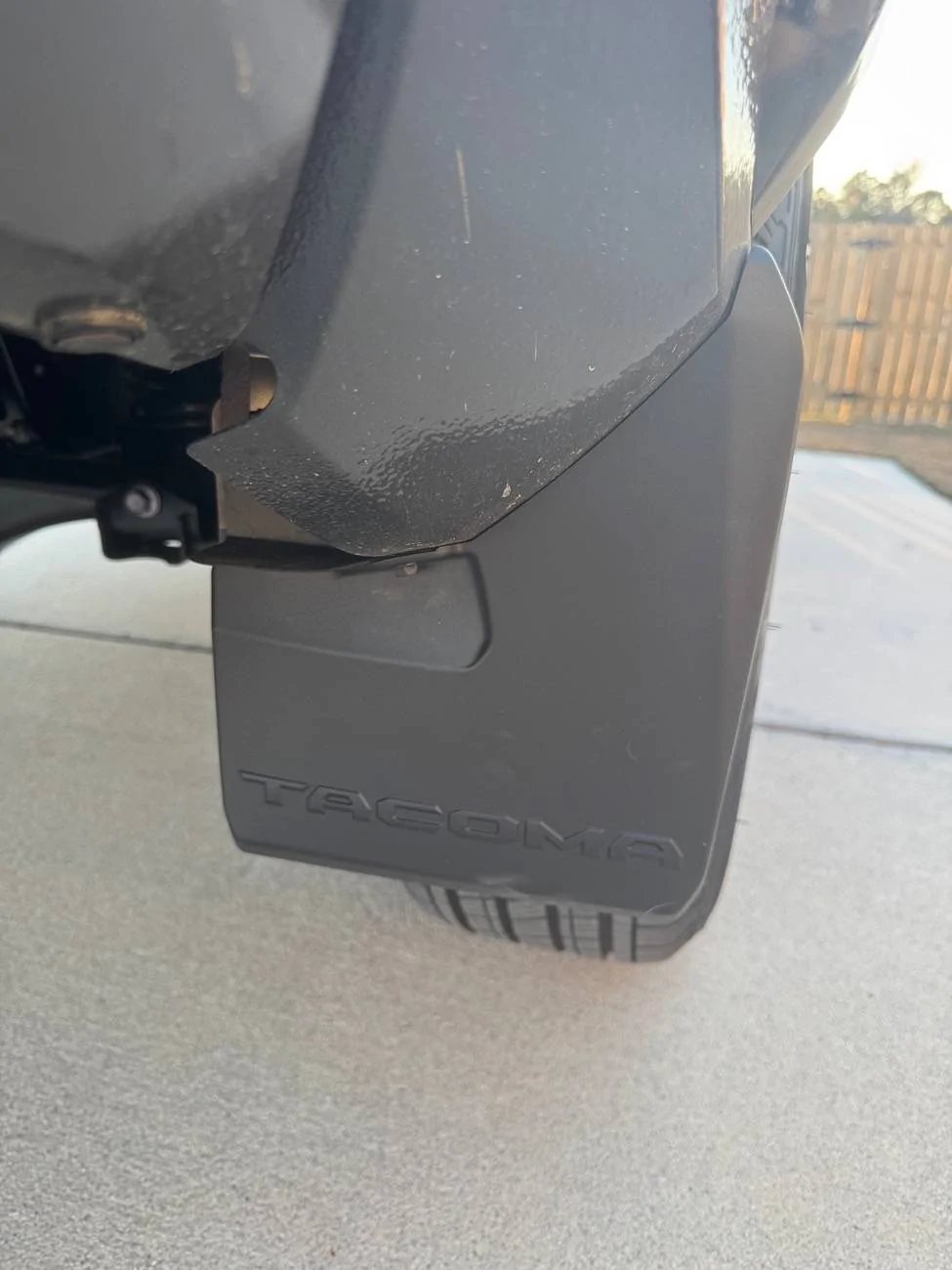

Just installed these on mine. Should help a bit with stuff flying up off the tires. I’ve got some running boards on the way that’ll provide some extra protection as well. I liked the look of these mudguards better than the aftermarket options.

No drilling. There were three screws to remove on each side in the front and those were used to install the front mudguards. The kit came with 4 screws for each side in the rear. There are already pre-drilled locations for the install, so it's literally just lining it up and putting the screws in. Super easy and the fitment is great. You can find them online, but the dealership that I bought my truck from couldn't find any mudguards in their system.

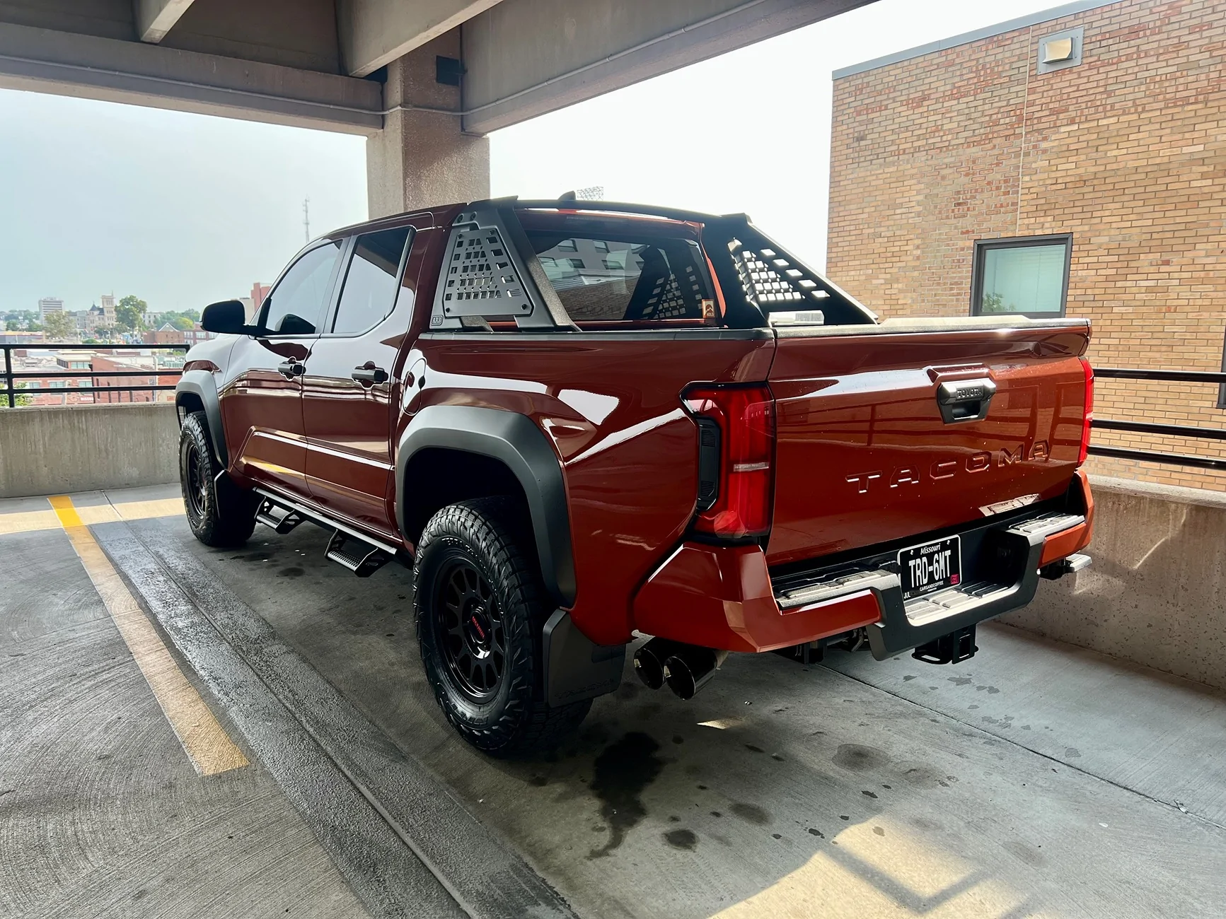

I hate to be the bearer of bad news. But they suck. They are too small and dirt just gets thrown past them all over the side if the truck.
Just got off the phone with Toyota customer engagement after filling a complaint. Our 25 limited has extreme stone damage due to the sub-standard front mud guards. We drive about 3/4 miles on gravel but stay below 20 mph and the truck has auto running boards. The dealer had all kinds of excuses “your truck wasn’t designed for gravel roads” but three Tacoma trucks before and average of 200K miles not even close to this amount of damage @ 15,000 miles no less.
Toyota actually said they would like to hear from more Gen-4 owners about this issue.
Once this is resolved I will get aftermarket flaps that actually do provide protection. The foot rails automatically retract and give no additional protection even in the OFF setting.

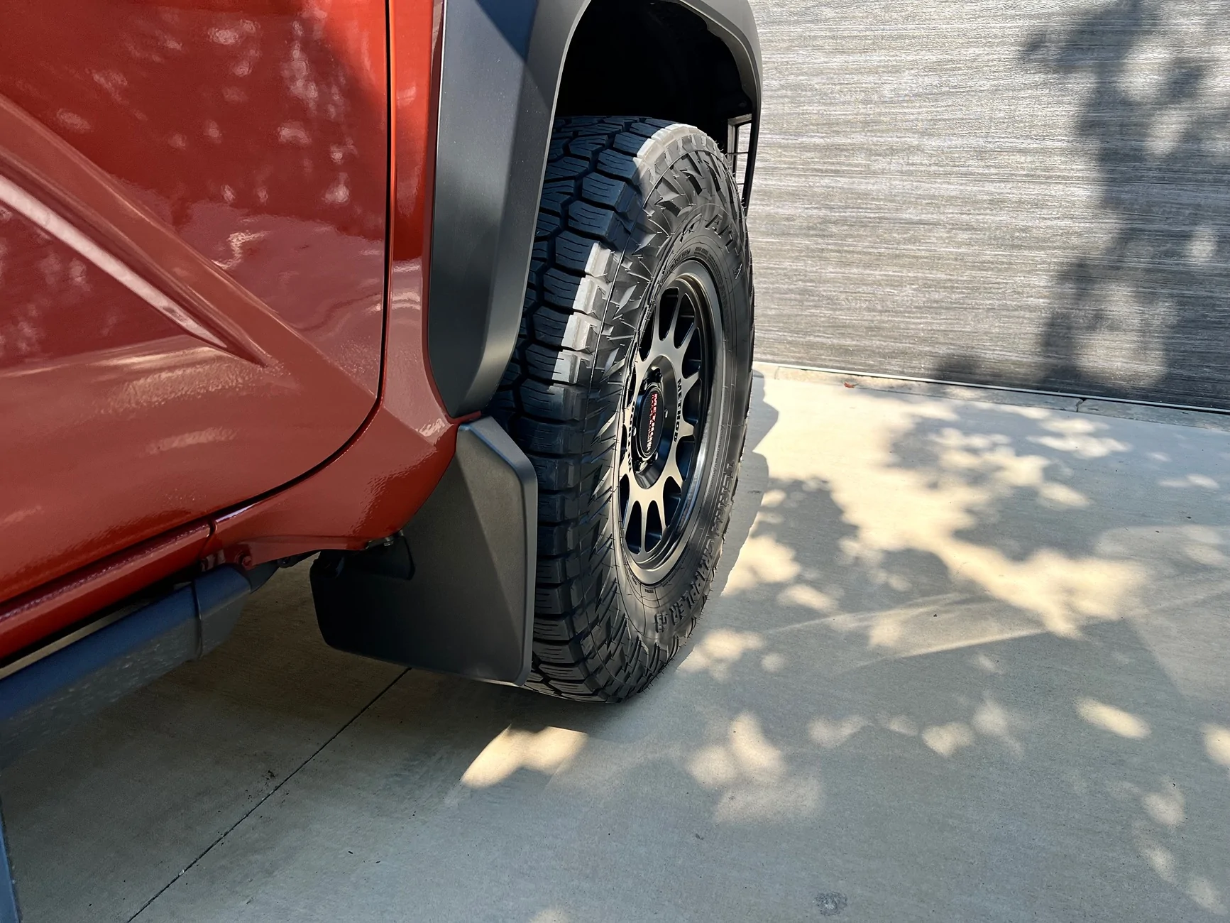

OEM trailhunter flaps on mine, provide more coverage than the standard Canadian flaps. Covers my 285 tires and +35 wheels no issues
