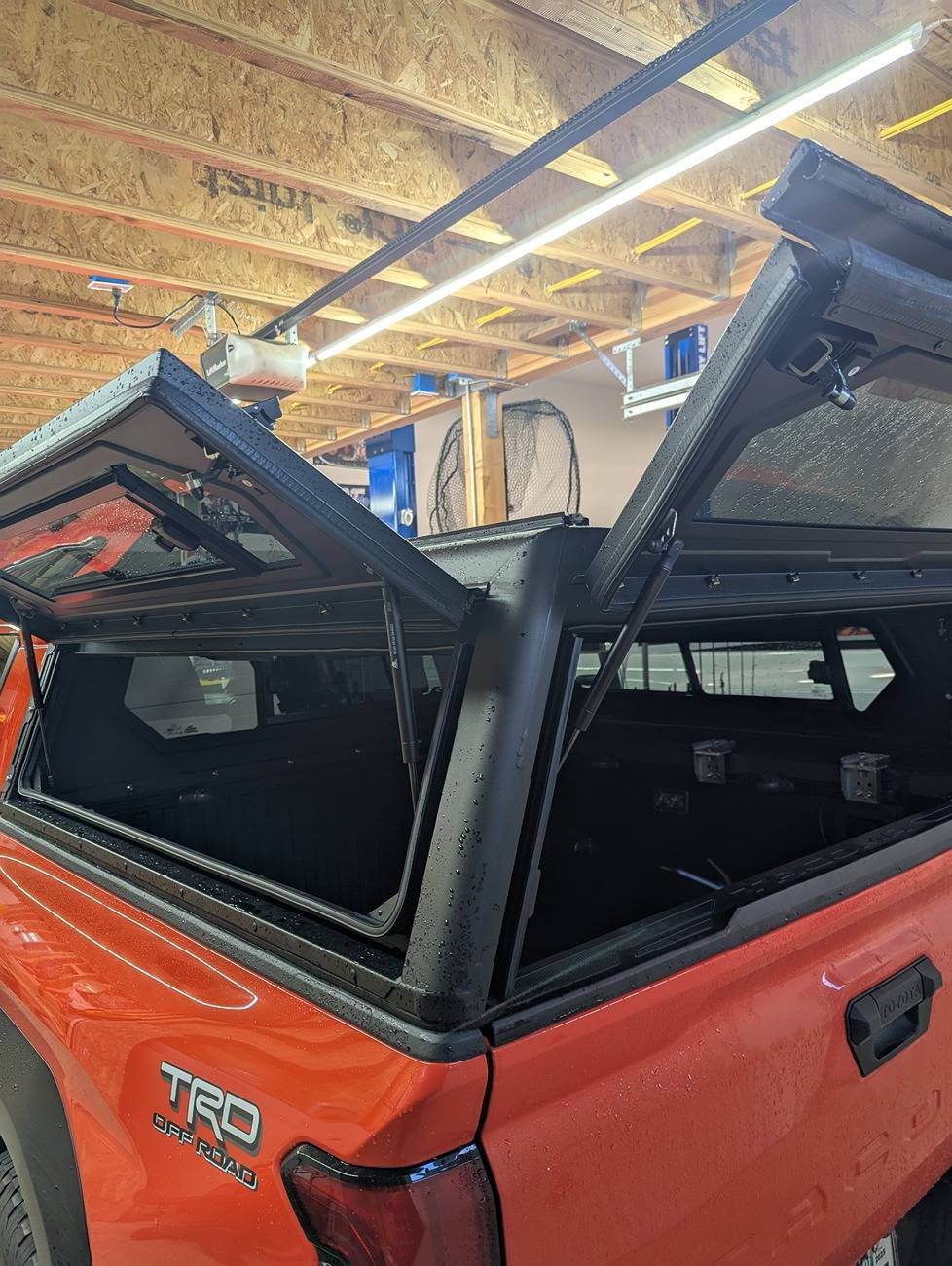

If you have an Alu-Cab Contour canopy on your 4th gen, and you're a taller person like I am, I thought I'd share an easy solution to the low hanging lift gate, when open. I bought the canopy straight through OK4WD, the US importer in New Jersey. I bought it through Chuck and worked also with Jon, their Alu-Cab expert to work out a few adjustments. These guys are awesome!

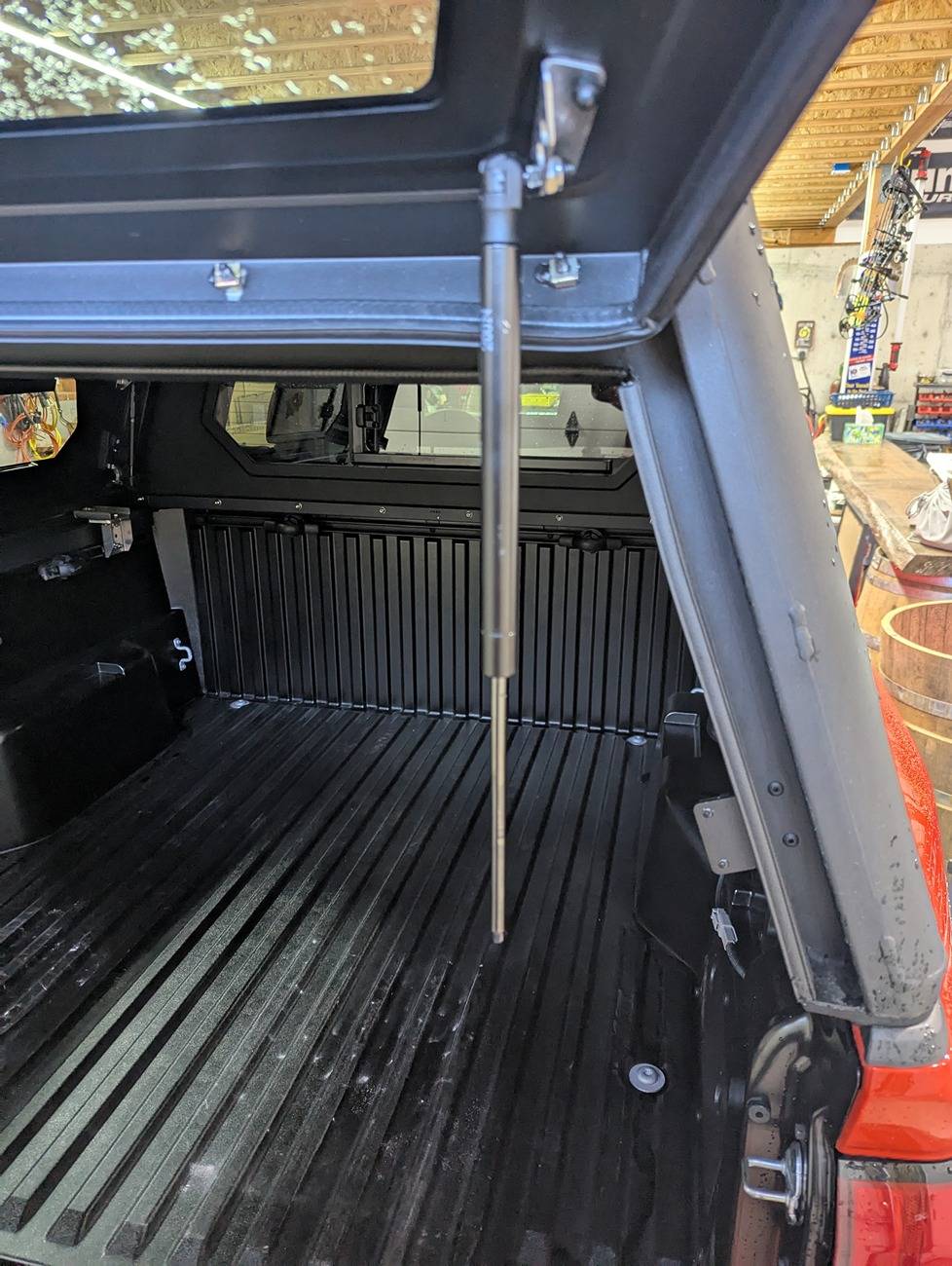

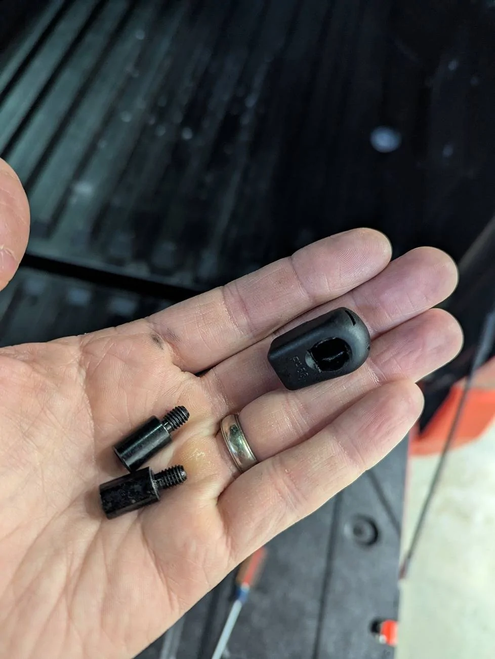

The factory rear gas struts are a little short for me and leave the rear gate opening far less than the side panels. I'm 6'6" so that was less than ideal for me. Jon sent me a set of longer struts but they wound up being a touch too long to cycle to full close. We then tried these extenders and that's the ticket! I have them doubled up on each side, they are metric in thread and length, but added about 1-3/16" in total length to the struts and that extra length transferred to 5 inches more on gate height. The gate started out at 71" from the garage floor as it was from the factory, and now it opens to it's max at 76.5", which might be a little high for some but is perfect for me.

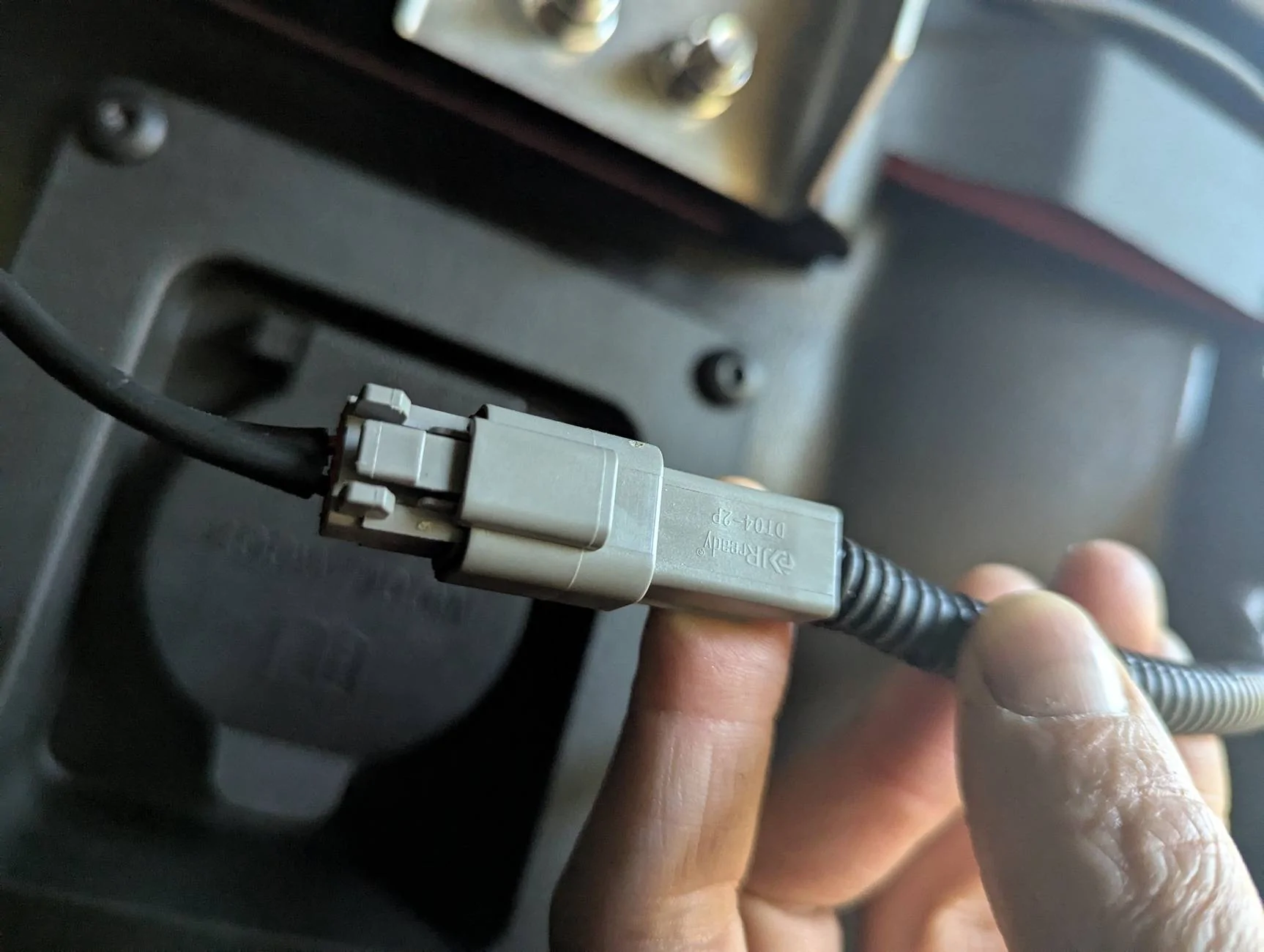

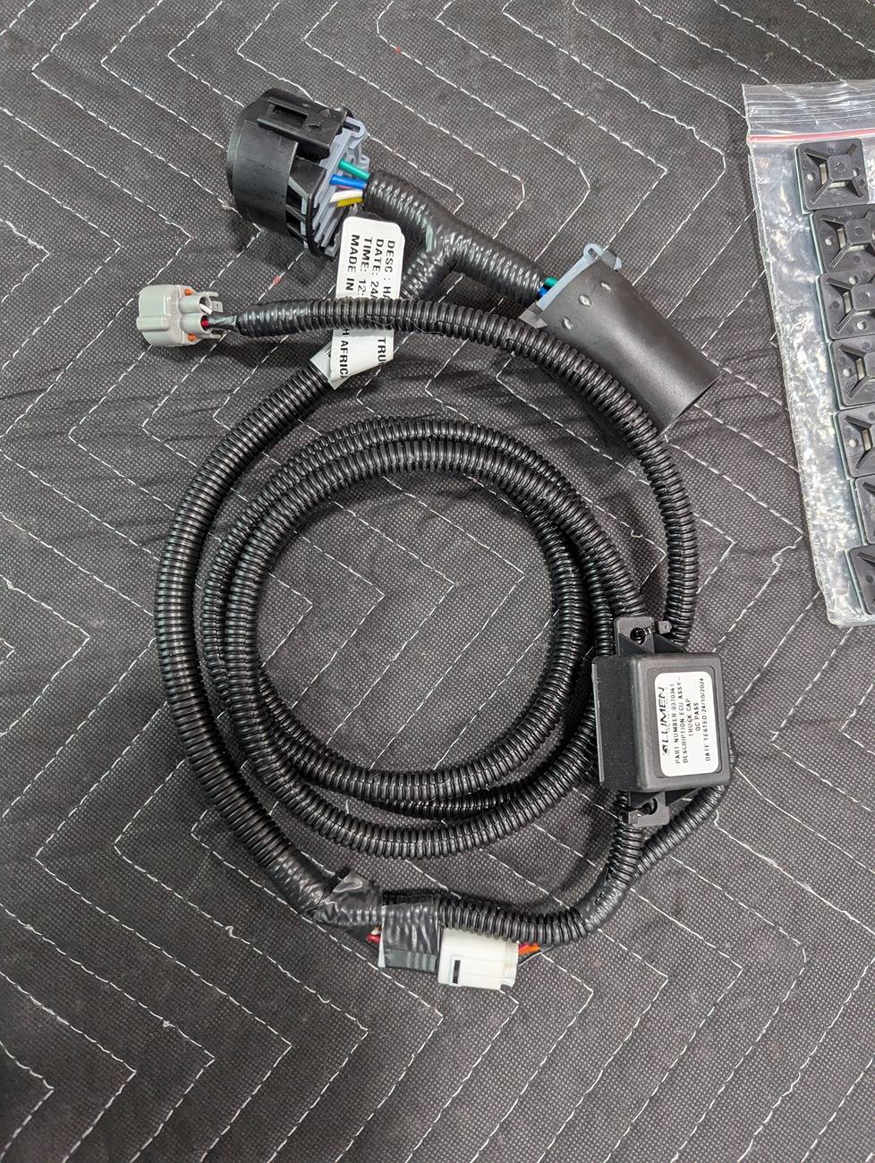

For the third brake light wiring, I actually sourced the SmartCap T harness, that would normally come with a SmartCap canopy, that plugs into the 7-way trailer connector under the truck. You simply disconnect the backside of the trailer plug harness and run this T harness in series with the trailer wiring circuit. I then routed the 2-wire pigtail up through the passenger side taillight housing area and drilled a hole in the steel vertical bed support just ahead of the taillight. I then wired on a Deutsch connector on both ends for the connection. The Alu-Cab just came with an open 2-wire pigtail that you can install whatever connection you want. The SmartCap harness comes with a Toyota/Lexus based connector that I cut off in favor of the ones I have on hand. Sourcing the matching connector proved to be a hassle and costly in area. Maybe they're more readily available in South Africa where all this is made...?

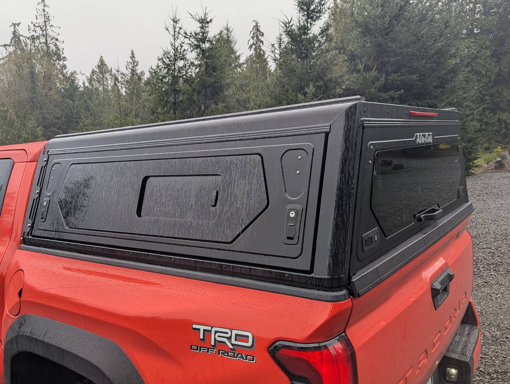

Looking good!
Any issues with water ingress? I see some rainy day photos.

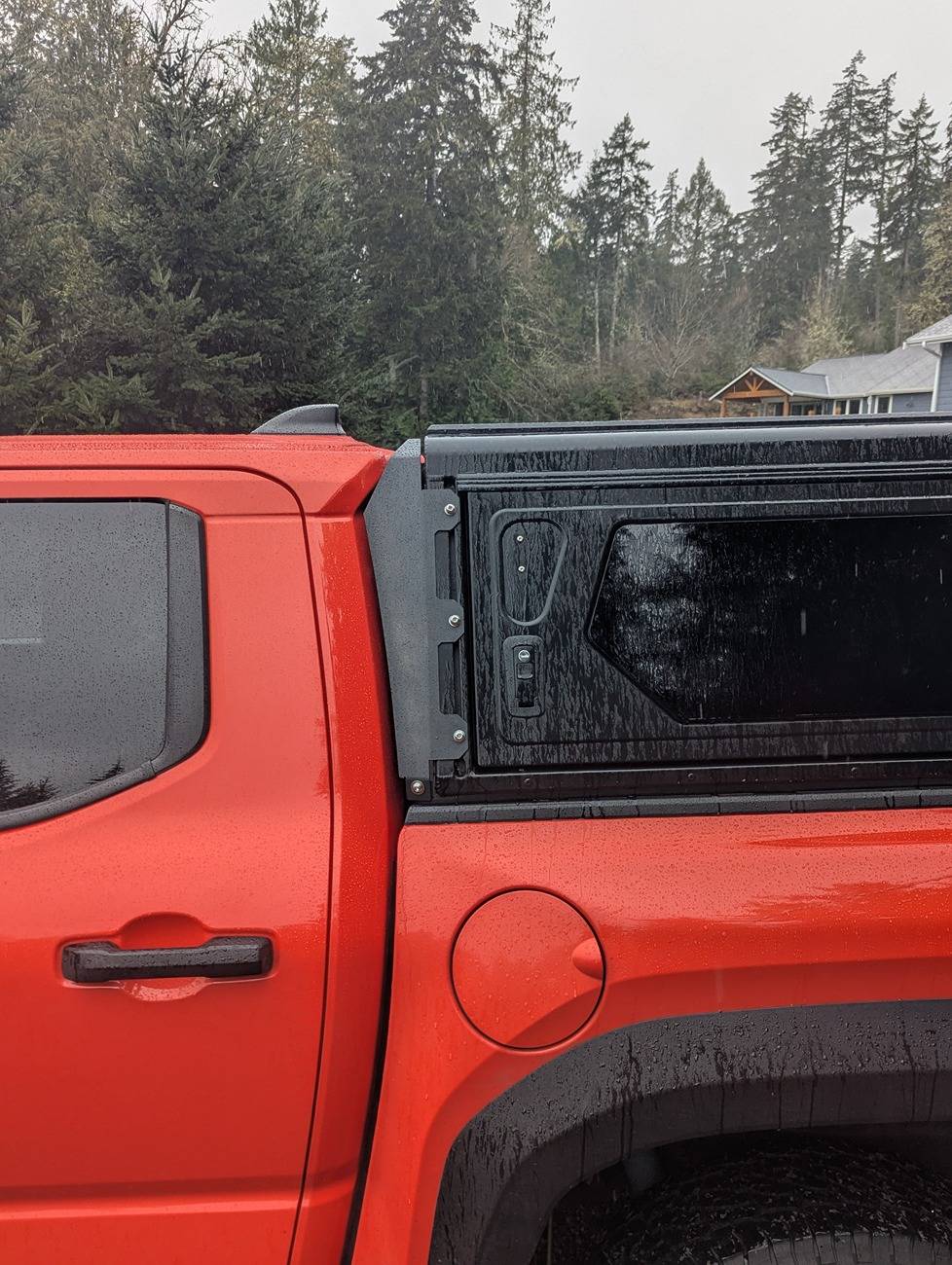

I'm thrilled to report that the Alu-Cab doesn't leak a drop! I'm pretty impressed with it. The front corners of the bed I might do a little more butyl rubber to close up those factory gapped Toyota bed corners. I did a little bit of that but it could use a little more, and a large roll came with the Alu-Cab product for that use due to how Toyota manufactures these beds. The factory D-rubber on the bottom edge of the canopy on the first round of these was installed accidentally at the factory before shipment, as there is a front panel that gets installed that sits on the front rail of the bed before the rubber seal is to go on so the D-rubber comes off, which consists of drilling two rivets in the rear corners, peeling the D-rubber and adhesive off, the filler panel goes in with a foam-rubber seal, then the new D-foam seal goes on which at first look I thought would be inferior to the D-rubber but it is actually more robust and seals down on the plastic Toyota bedrail caps nicely. They sent a tube of SikaFlex as well, since some of their full camper models they recommend removing the bedrail cap, sealing the cap to the body and then installing the camper. I did not do that for my canopy and so far, no water intrusion from under the rail caps. The bracket and shim system Alu-Cab uses for installing to the truck makes it nice for the air-gap adjustments and all seem to work well together. I adjusted it around the bed a few times getting it to where I liked it for seal, cab clearance, and lift gate function / fitment.
I was looking at SmartCap products too but I don't like how they went to the 3-piece roof (for shipping purposes) on the 4th gen Tacomas, and just have too many seams with 7 different panels that are assembled. The Alu-Cab is welded aluminum and ships as a complete unit with no bolt-together seams for the main construction. The only bolted pieces are the bottom of the lift gate, and the front filler panels (bottom and sides). SmartCaps are nice and look good, but I read about too many people fighting through issues with seals, lock mechanisms, paint peeling, etc. so I shyed away from them. I hope they can get you resolved and squared away. You might have some re-torquing to do over the years/seasons to keep up on the weather seal flange areas but a lot of people are very happy with those and have little issues. I live in a wet climate area most of the year so I couldn't risk it.

Are you able to share how you sourced the SmartCap T-Harness?
I reached out to SmartCap to see if I could just buy the harness from them but they needed a cap serial number before they'd sell me one.

I had the same problem when I tried to buy it direct, no go. I went through my local canopy shop, which is Canopy World in Bremerton, Washington. The manager's name there is Scott. Maybe look them up and see if he can help you out and ship it to you? it's a nice product, spendy, but works well. I think there are a few others out there but this was easy and once I went through Scott I got it surprisingly quick.
