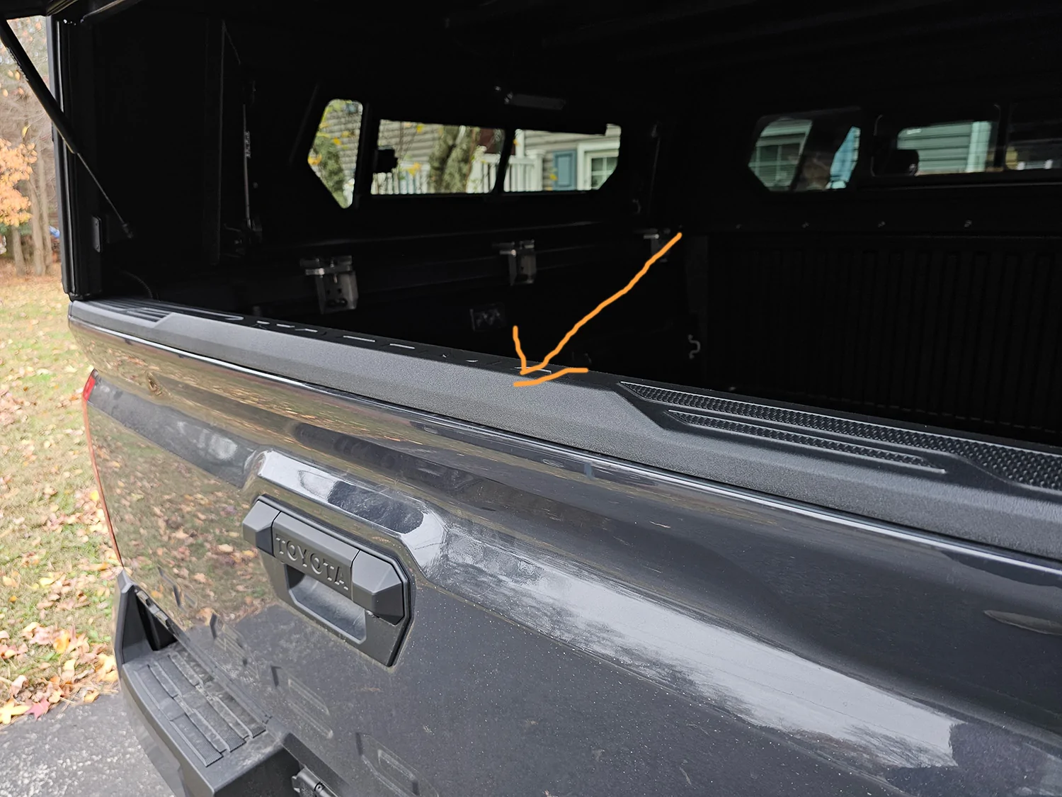

I ran into a problem with the back hatch not closing because of the bump on top of the tailgate. Did you have that issue? Might be I need shims changed. Could you tell me how many shims you used in front, middle and back? Thanks! Your truck looks great!

I think I used, from front to back, 5,4,4. Also, did you remove the inner rubber gasket that goes over the horn on the tailgate?

Thanks for your reply. Are you able to close the hatch when the tailgate is already closed? That bump prevents me from doing that. I had it installed by a local company. Not sure if they removed the inner rubber gasket that goes over the horn on the tailgate. I will find out. Thanks again!

Yes, I can close my hatch. It’s snug, but you want the inner gasket to press against the lip of the tailgate rail.
Maybe your canopy sits too far toward? That would cause the hatch to not close well.
I installed mine myself. I don’t always trust other people’s work to get it right.

I spoke to the guys at ok 4wd and they said they just remove the inner gasket which is what you mentioned so that's what I will do. The place where I had it installed had never done one of these so they weren't sure and did not remove it. Thanks again for the info and good luck with your truck.

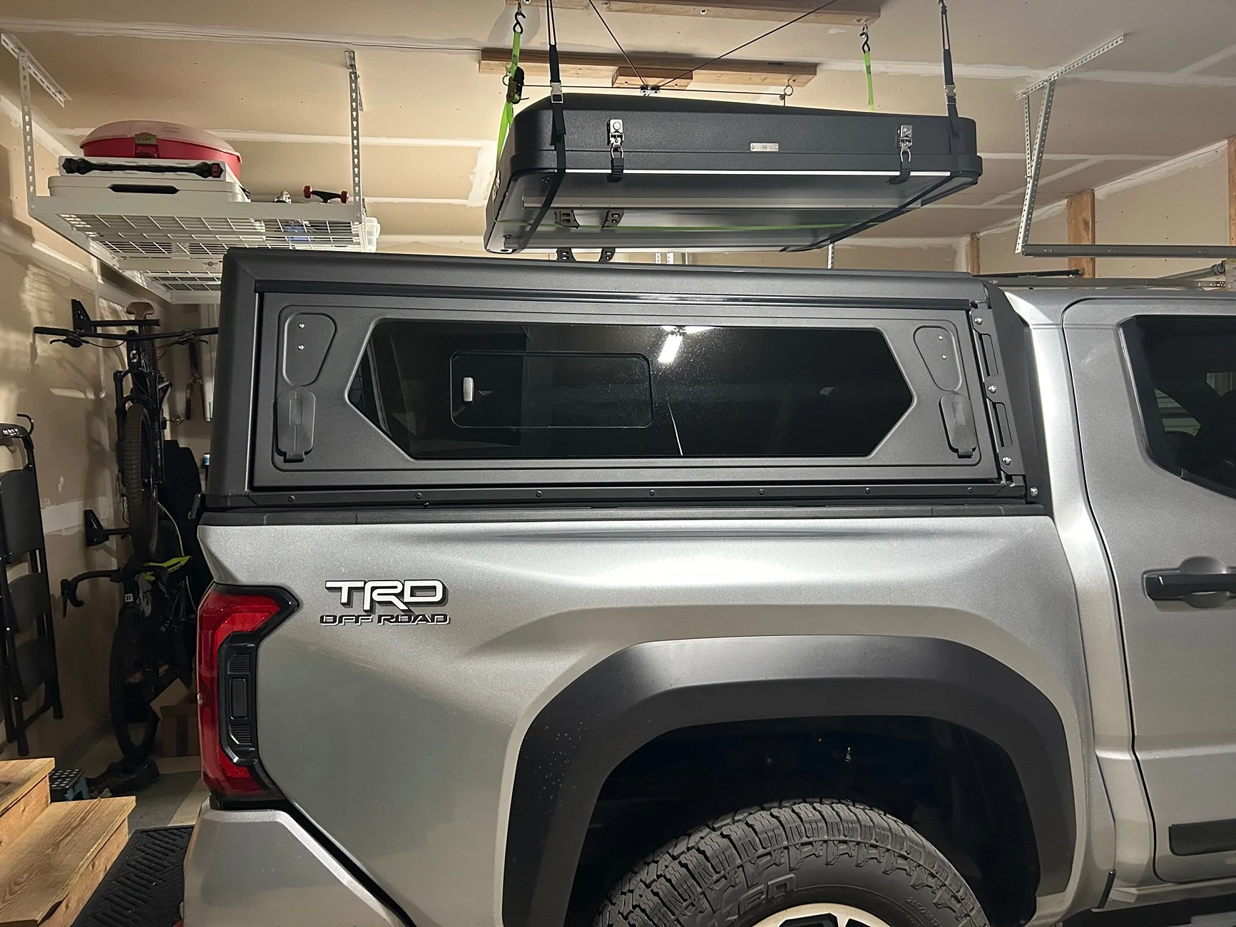

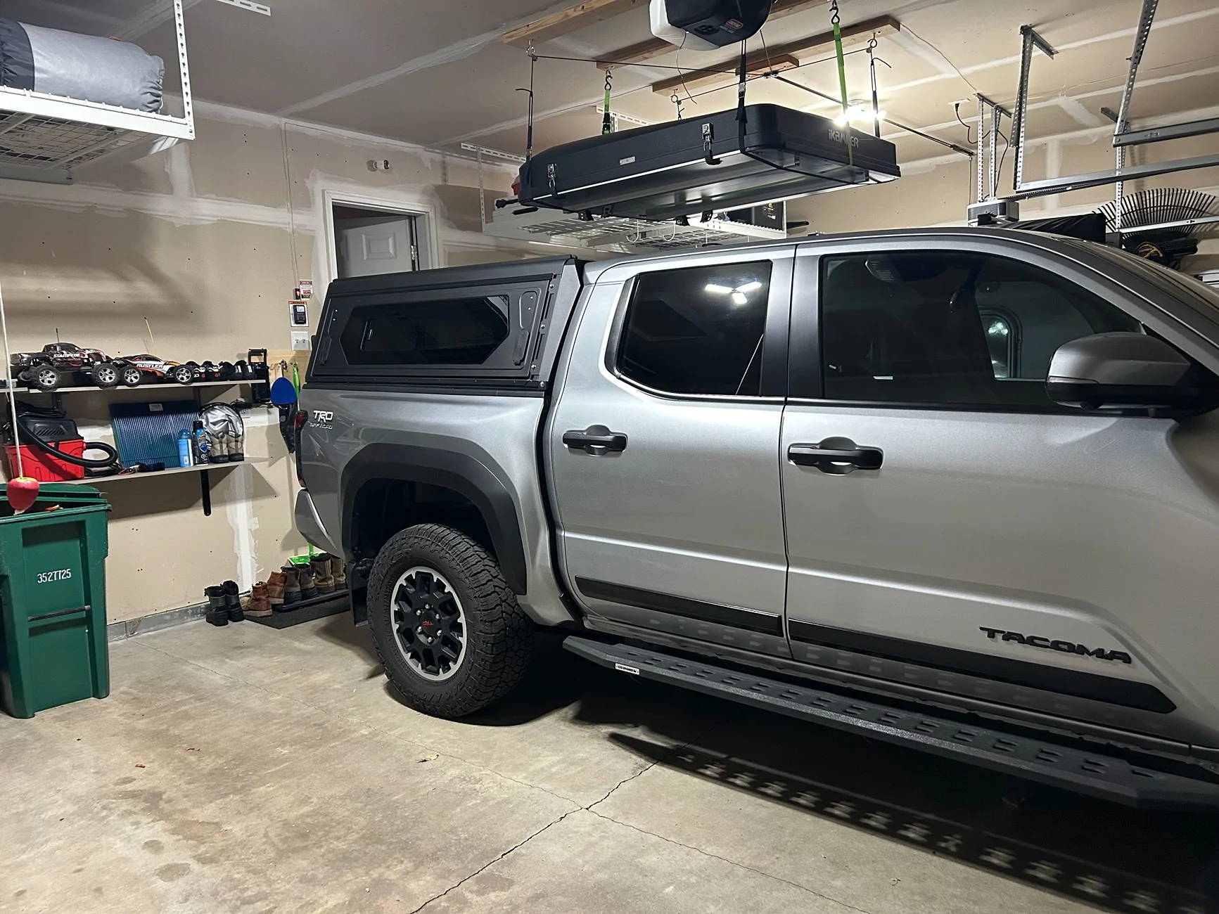

I have the standard 7’ clearance that most newer homes have. Not ideal for having a RTT on any canopy style other than a midheight rack system. I mainly have the topper to keep my belongings dry and safe.
My main mode of camping is my Bean trailer. When the kids were smaller I used the RTT for them, but not much since. I can place the RTT on top of the Bean or on crossbars on top of my Alucab. However, it’s a PTA to get it on and off. I used to use a jeep topper crane system to get it on and off, but that was a PTA too. The way it’s set up in my garage is for storage only. It would work really well if you could put the RTT on and off with that pulley system and drive in and out.
I would definitely get the Alucab. I’ve been very happy with it on many fronts. In my opinion it’s better than a RSI Smartcap, which I have also owned in the past.

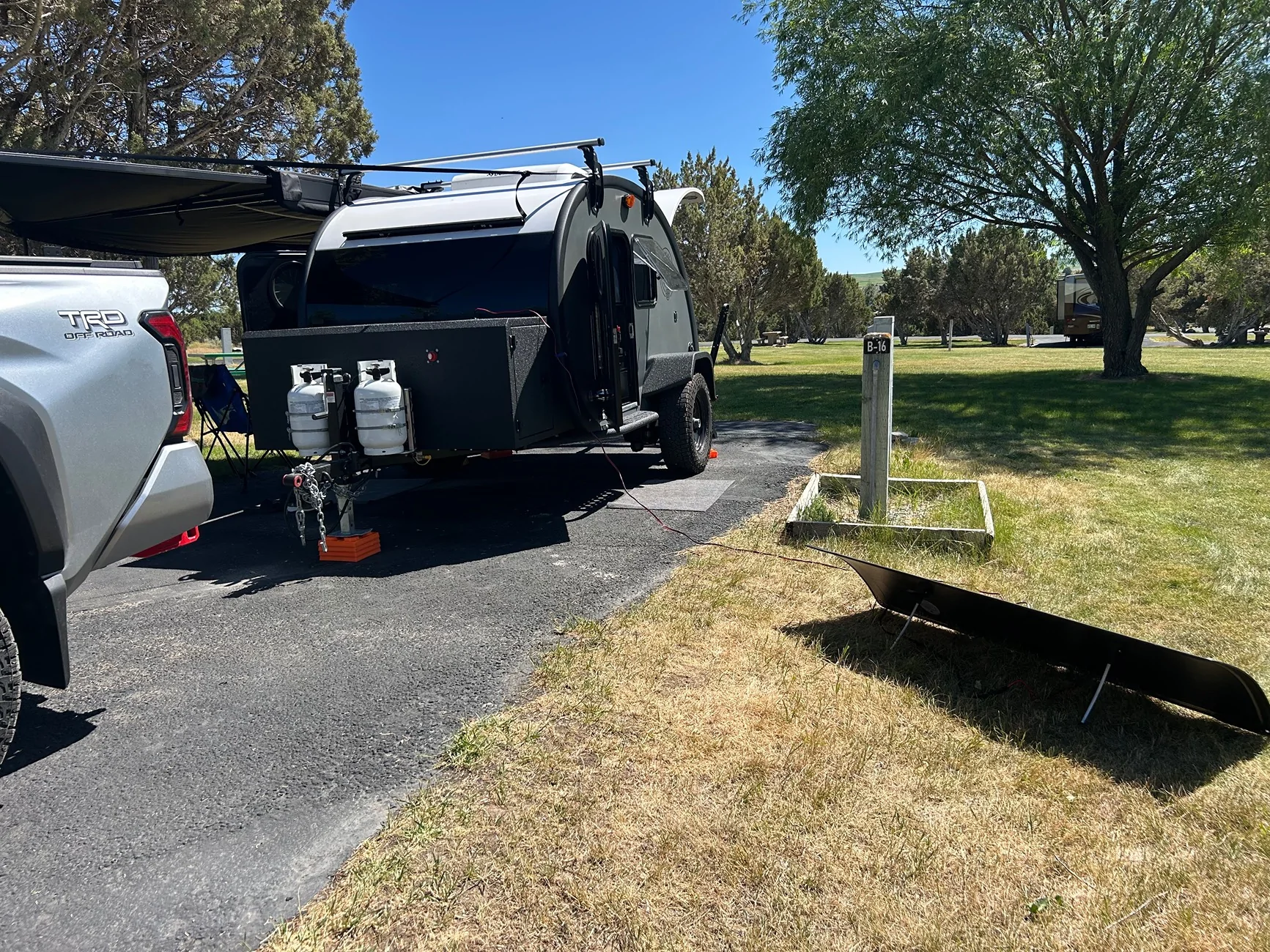

Thank for the compliment! If you have other questions feel free to ask. Here’s my Bean! You should considered this instead of a RTT.
