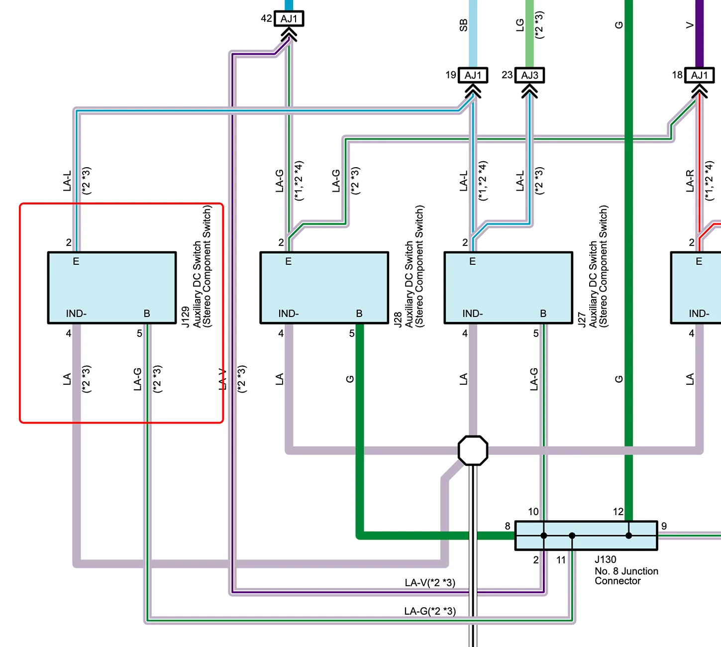

Here you go:
(And no problem OP, happy to help.)
Excellent. What about a wiring schematic for what pins get what signal?

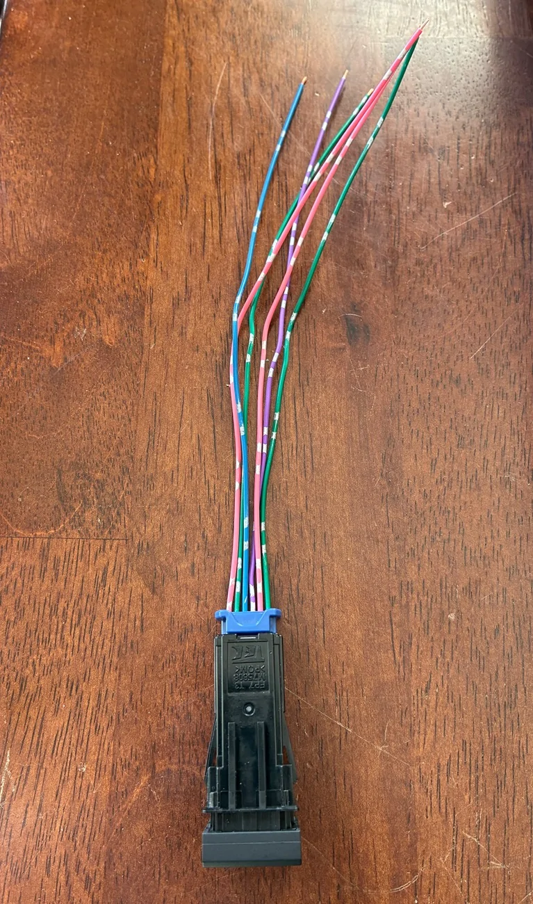

Got the pigtail in from China.. connector fits perfectly. Now who’s got a pin-out diagram for an oem switch?
2024 Tacoma AUX4 Dash Switch-Wiring Harness IMG_0167
