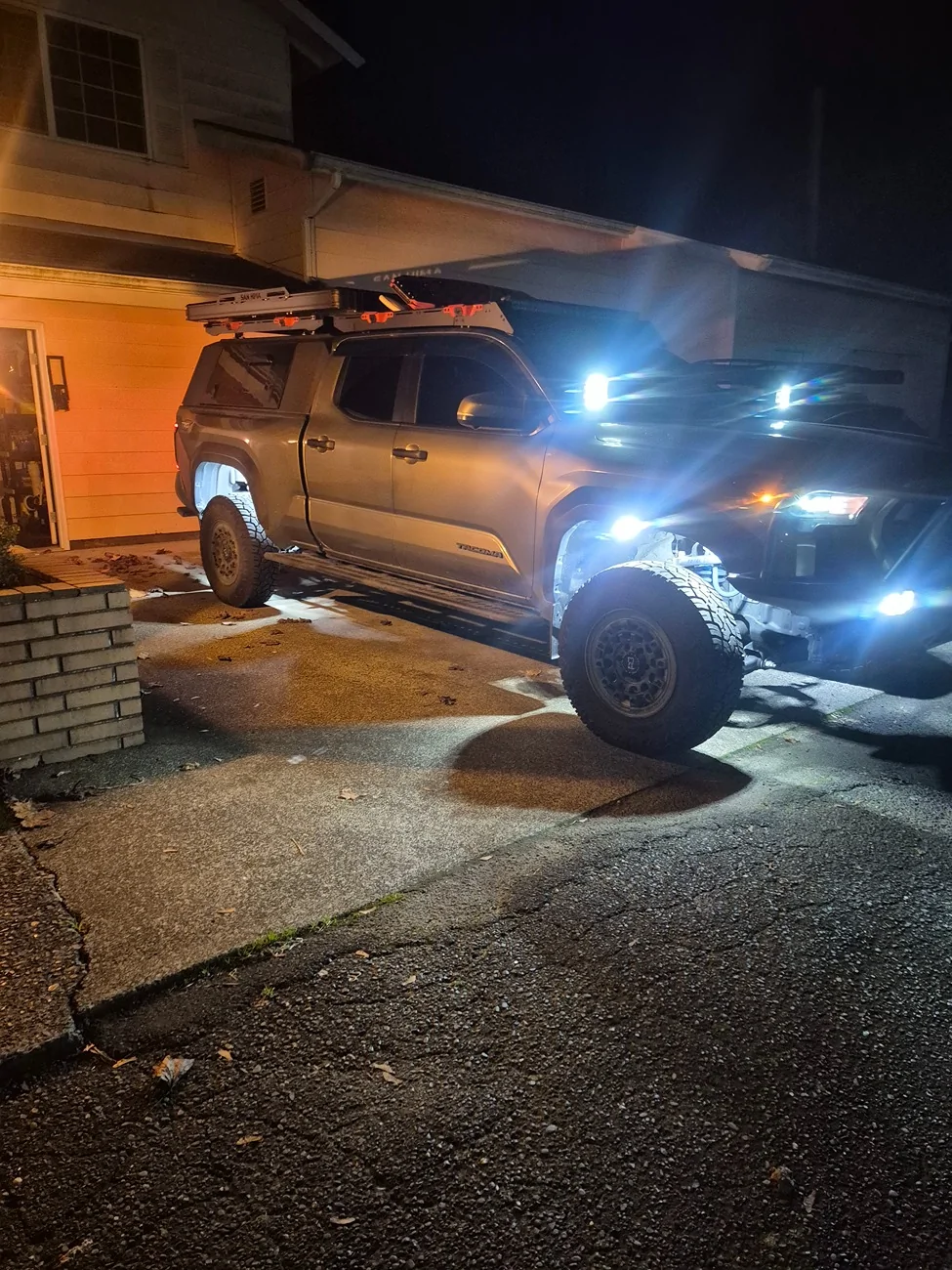

I didn't find a harness, but I just cut the end off of the fog light terminal and soldered, spliced in my new fog lights.
2024 Tacoma Baja Designs Squadron SAE fog lights wiring into the Fog light switch? 20251119_200041
2024 Tacoma Baja Designs Squadron SAE fog lights wiring into the Fog light switch? 20251130_134858
