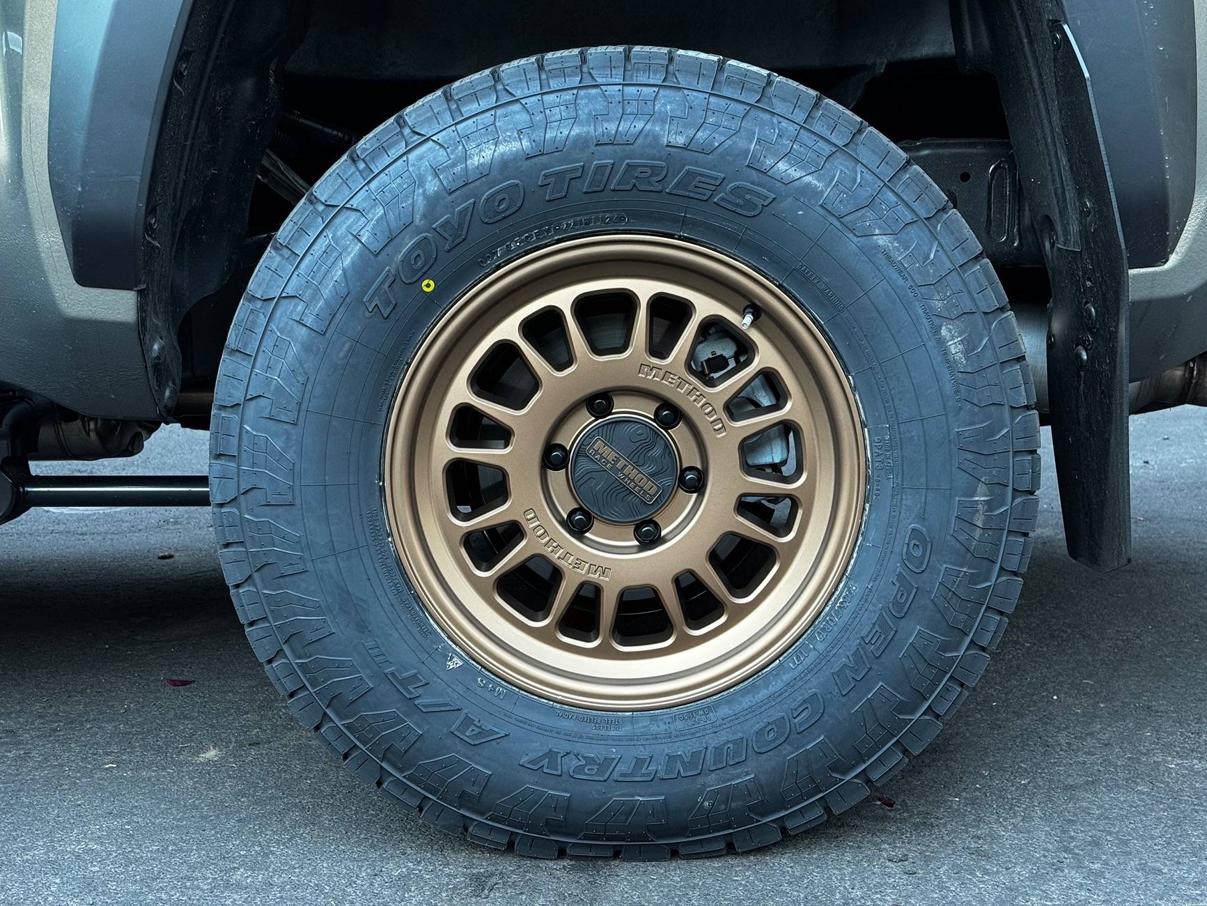

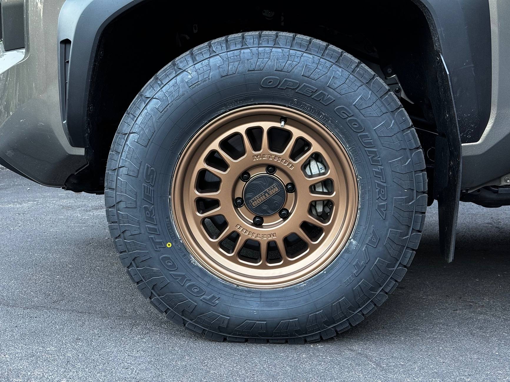

I chalk tested my Toyo Open Country P285/70R17 tires. The “calculator” said it would be 26 psi from the stock 30 in the increased size. My chalk test showed 33 front and 26 rear with an empty bed. Just wanted to share.
2024 Tacoma Chalk Tested P285/70R17 Open Countries IMG_2375
2024 Tacoma Chalk Tested P285/70R17 Open Countries IMG_2374
