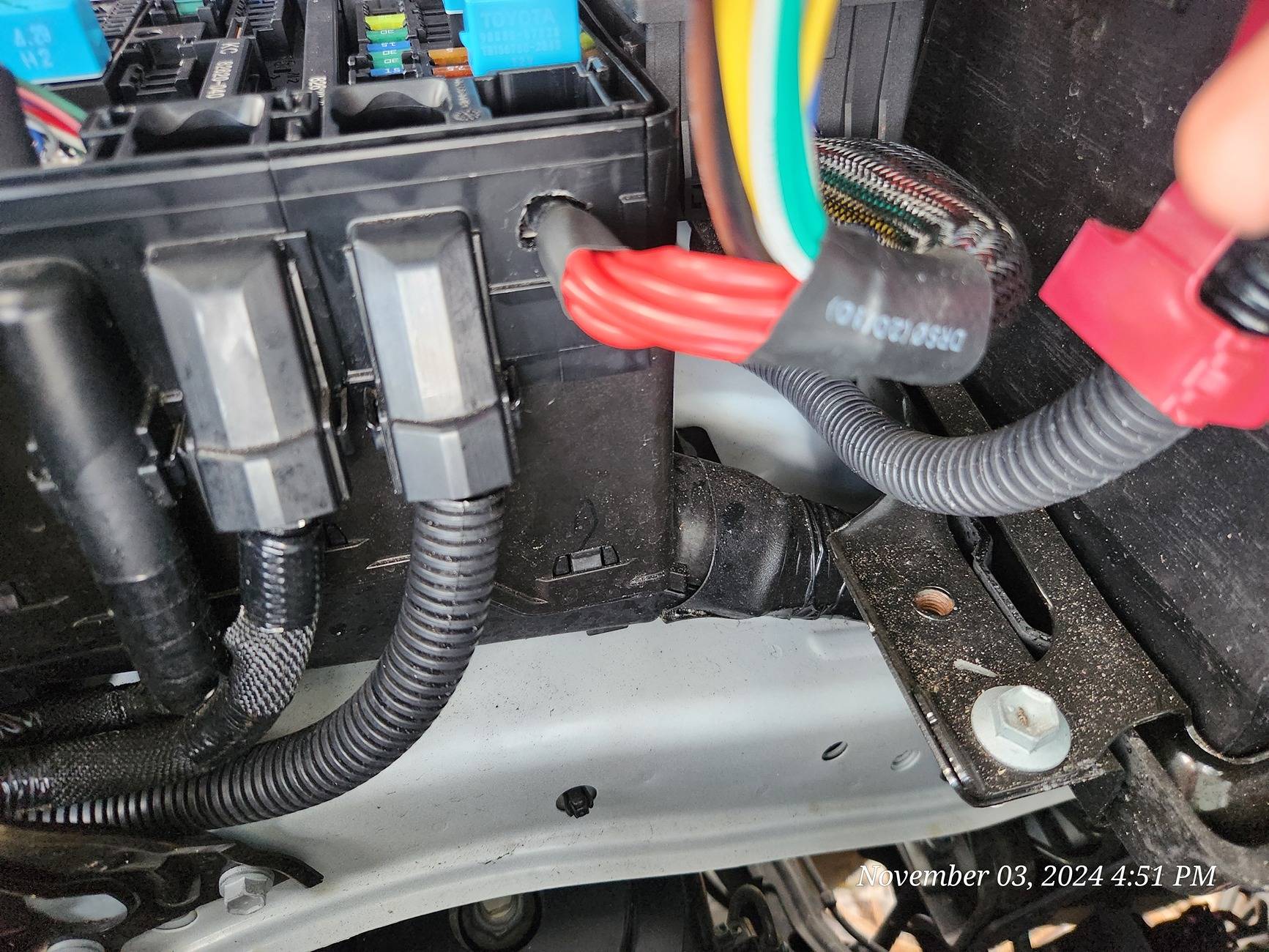

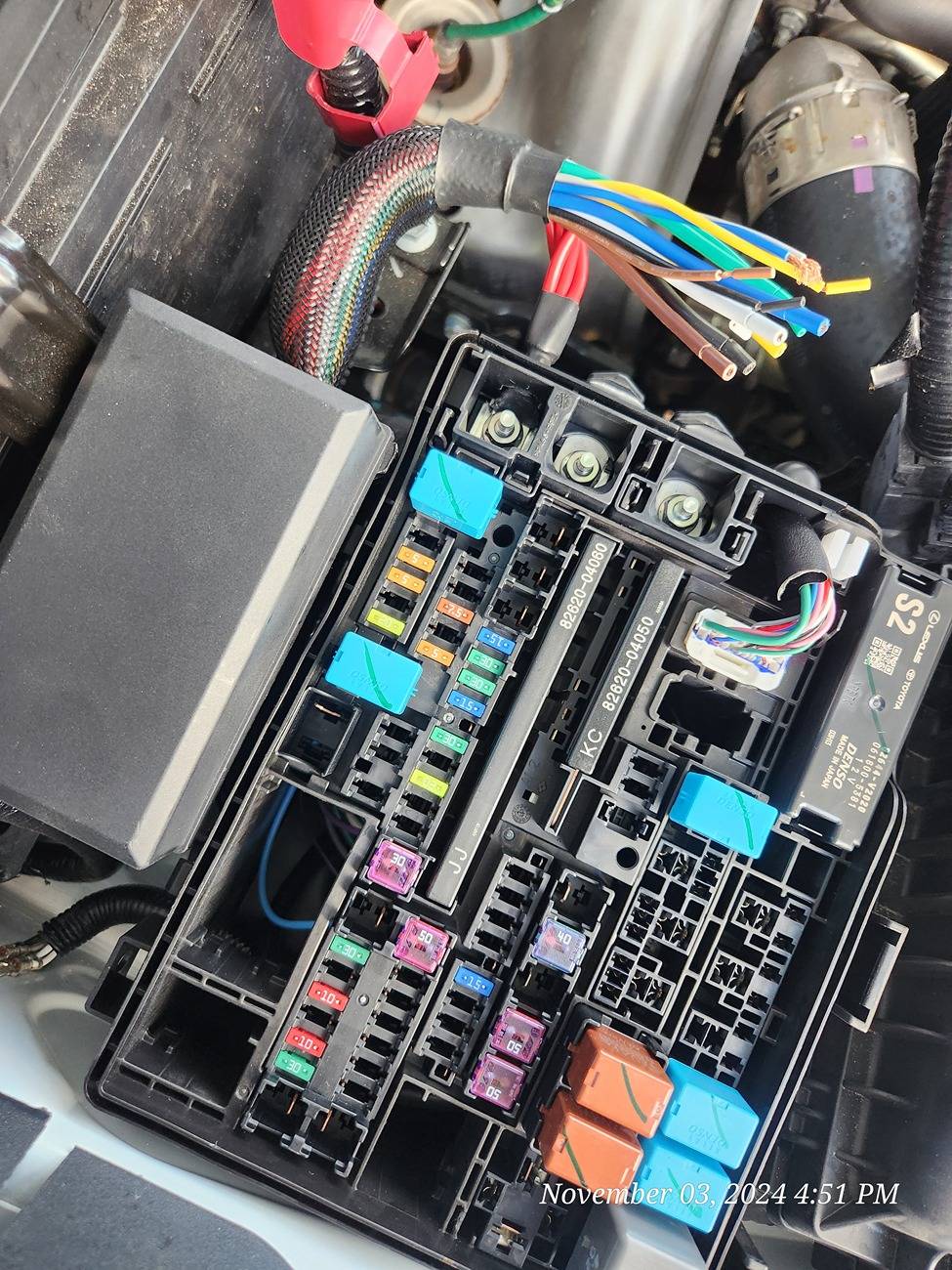

in the fuse box by the battery there is a open bus connector I used this to add my aux relay/fuse box
this bus connector has a insert around it and at the side of the box that can be removed to make adding the hole much cleaner than doing it while is on the truck
2024 Tacoma clean aux setup for those without factory aux 20241103_165123
2024 Tacoma clean aux setup for those without factory aux 20241103_165116
next is to run a cable from the new aux relay box in through the firewall. I would recommend a cable with multiple conductors in it, I used one with two in the future I will likely replace it with one with 4 conductors . 1 will be used to provide 12v to the switch(s) and the others will be used to return 12v from the switch to activate the relay. connect the red conductor to the + on the battery or to bus connector if the hole you made is big enough. the other conductors can be connected to the relay signal wires for me I chose the blue (so the skinny blue wire)

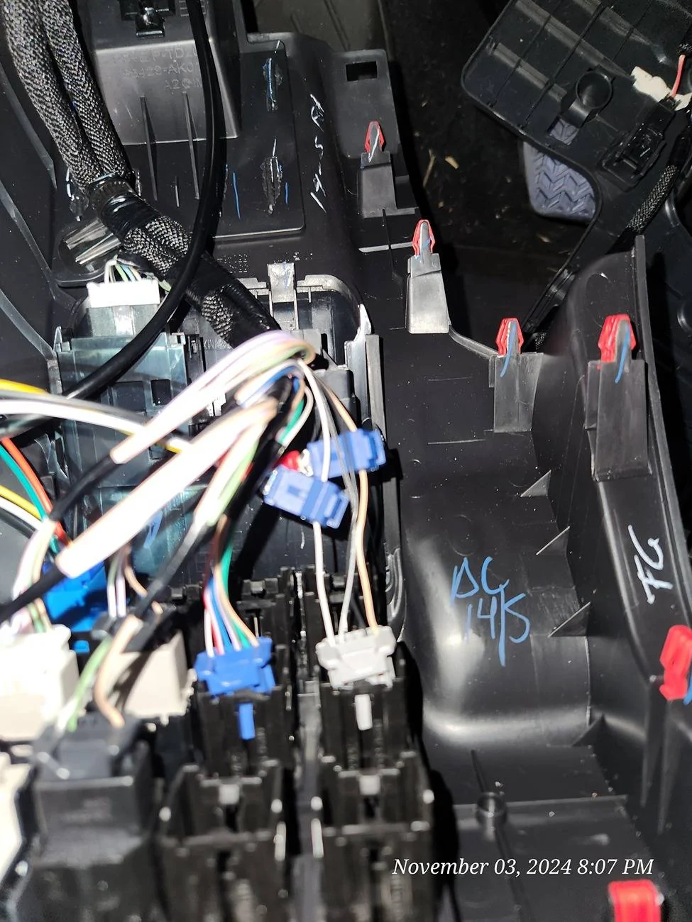

now for the switch. I used the cali raised OEM style square switch
to make the switch function just like the OEM switches I used wire taps connected to one of the unused connectors (the one with only 4 wires on it)
the light yellow color wire on the right side of the OEM plug is 12v dash light controlled so it provides power to light up the switch when the rest of the switches light up at night. this gets connected to the yellow wire on the new switch
the black wire on the opposite end of the OEM plug is ground it gets connected to both the black and white wires on the new switch
next we will connect the wires we ran though the firewall to the switch. the red wire we connected to + on the battery will connect to the red wire on the new switch(s) if running more than one switch you can splice them together so that this one wire will provide source for all of them
next connect one of your other conductors that come though the firewall (in my case black) to the green wire. this will provide a trigger for the relay.

@syrade I have those same exact spare wires in dummy spots behind my empty button placeholders that you have pictured that you used to tap into (black/blue male connectors). Do you happen to know what those are? Are they specific to some other function's buttons for a feature we don't have or are they simply there as a way to secure the spare wires for the 3 AUX buttons that aren't there and just thrown onto extra connectors?
I have everything in place except for the relays and the buttons and am hunting for the wiring for the AUX buttons and wondering if those are the ones. It's very challenging to tell and people that already have AUX buttons are not as willing to open the panel and snap a picture of the back side wiring.
I'm curious how you figured out what wire you wanted to tap for your project.

@CrCo35 the one I taped into is for the fuel door button that is on some of the other trims, the offroad doesn't have the locking fuel door so its extra. the blue connector is the wire for the inverter that is also not equipped for the offroad trim.
as for the factory AUX buttons, the wiring incab to connect these is missing there are some photos of the kick panel connectors that are on some of the treads that show where they connect and where the incab aux pigtale would connect and both are missing so it seems that the wire harness is at least a little modular. not to mention that just the pigtails are like 65-70 bucks each.
there is also a spare unconnected cable in the center console I suspect is for the swaybar disconnect that is not on my option but was talked about as being able to be put on after the fact (one of the only things it seems)

Thanks for the info. I ended up buying access to the wiring diagrams for 2 days and figured out what those were today, might steal your idea of tapping into them for illumination though.
I'm going to do some more recon on mine because I'm almost certain I can see the wires for the AUX connections where they should be by the kick panel but then they disappear into harness wrapping.
