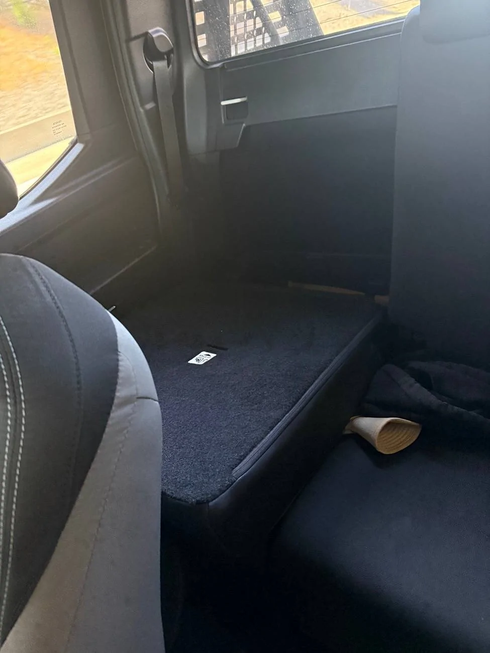

click noise in the back seat
dvazquez
Dario
Dec 19, 2024
san diego
having a click noise in the back, traced it back to the back right side , the noise went away when i dropped the seat down, i tried clicking the seatbelt in case it was that hitting the wall but no, it’s the seat, any recommendations to stop hitting those noises?
2024 Tacoma click noise in the back seat IMG_5658
