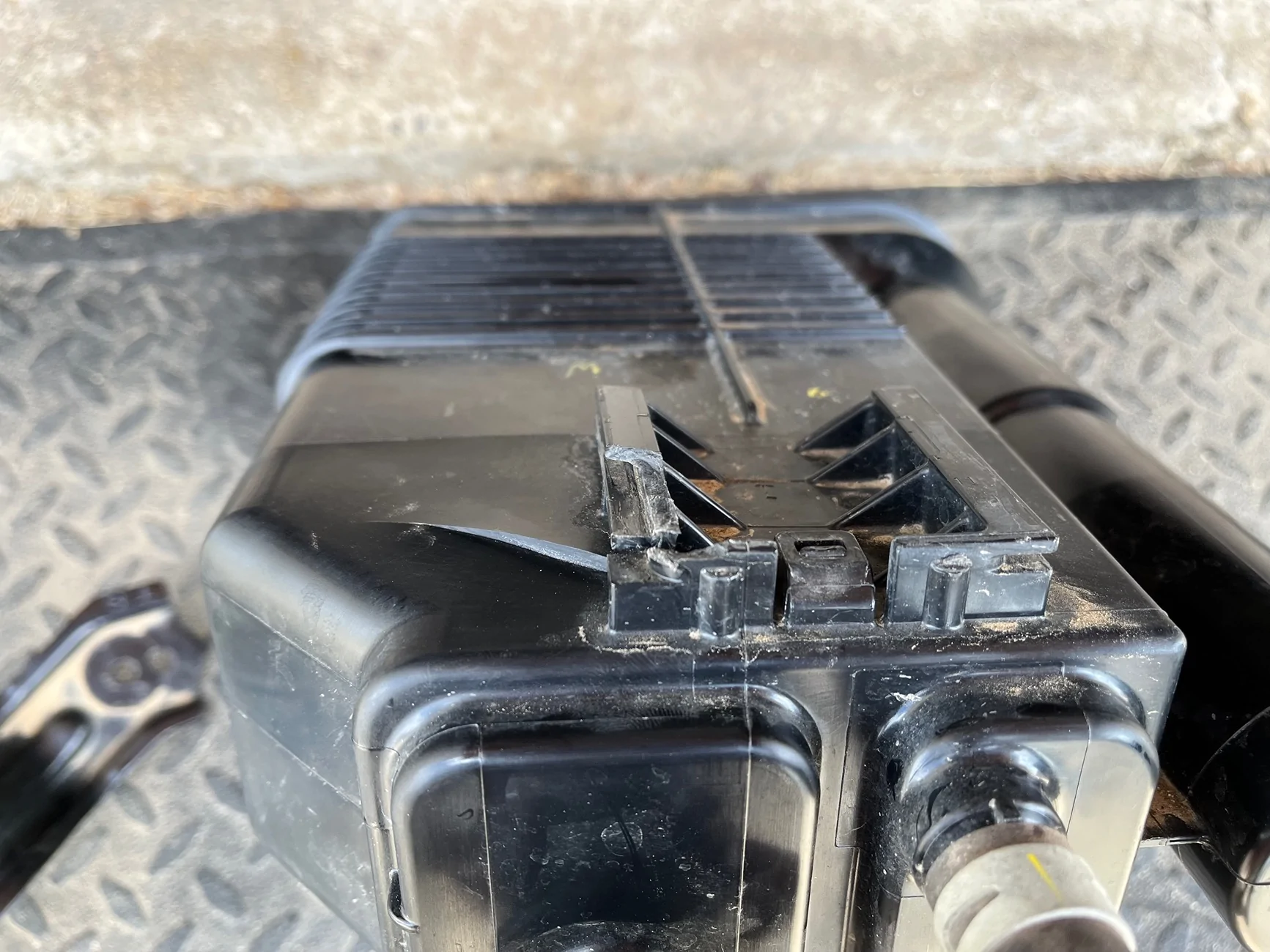

My 2026 Tacoma TRD Off-Road has 3700 miles on it. I recently had the check engine and cruise control system malfunction lights come on. Just prior to this the “check fuel cap” notification came on. The dealer found a crack in the charcoal canister and said “it probably got hit by a rock”. So it’s not under warranty. This canister is protected by a crossmember and the spare tire covers it almost completely. The rock theory seems far fetched to me. Anyone else have a cracked charcoal canister issue?

We shall see. If it’s some other issue besides a rock, it will happen again. They will have a tough time explaining that. I pulled it apart to take a closer look and to me it looks like it burst under pressure. I have driven a lot of elevation and temperature extremes in the time I’ve had the truck but I’ve also had the suspension flexed out a lot in all directions. If it’s caused by frame flex or internal pressure it will happen again quickly.

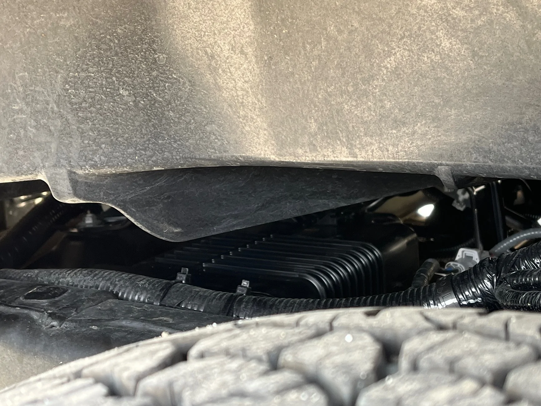

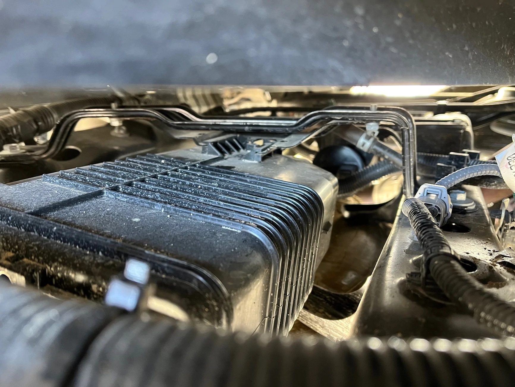

It’s very protected, especially where the crack is. Just above the side ports. The dealer theory is ridiculous.

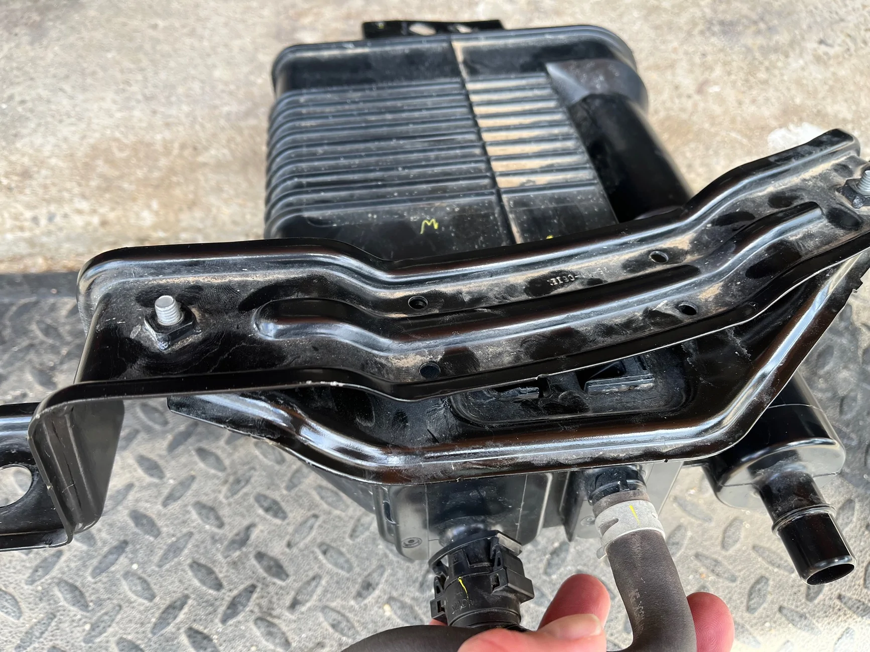

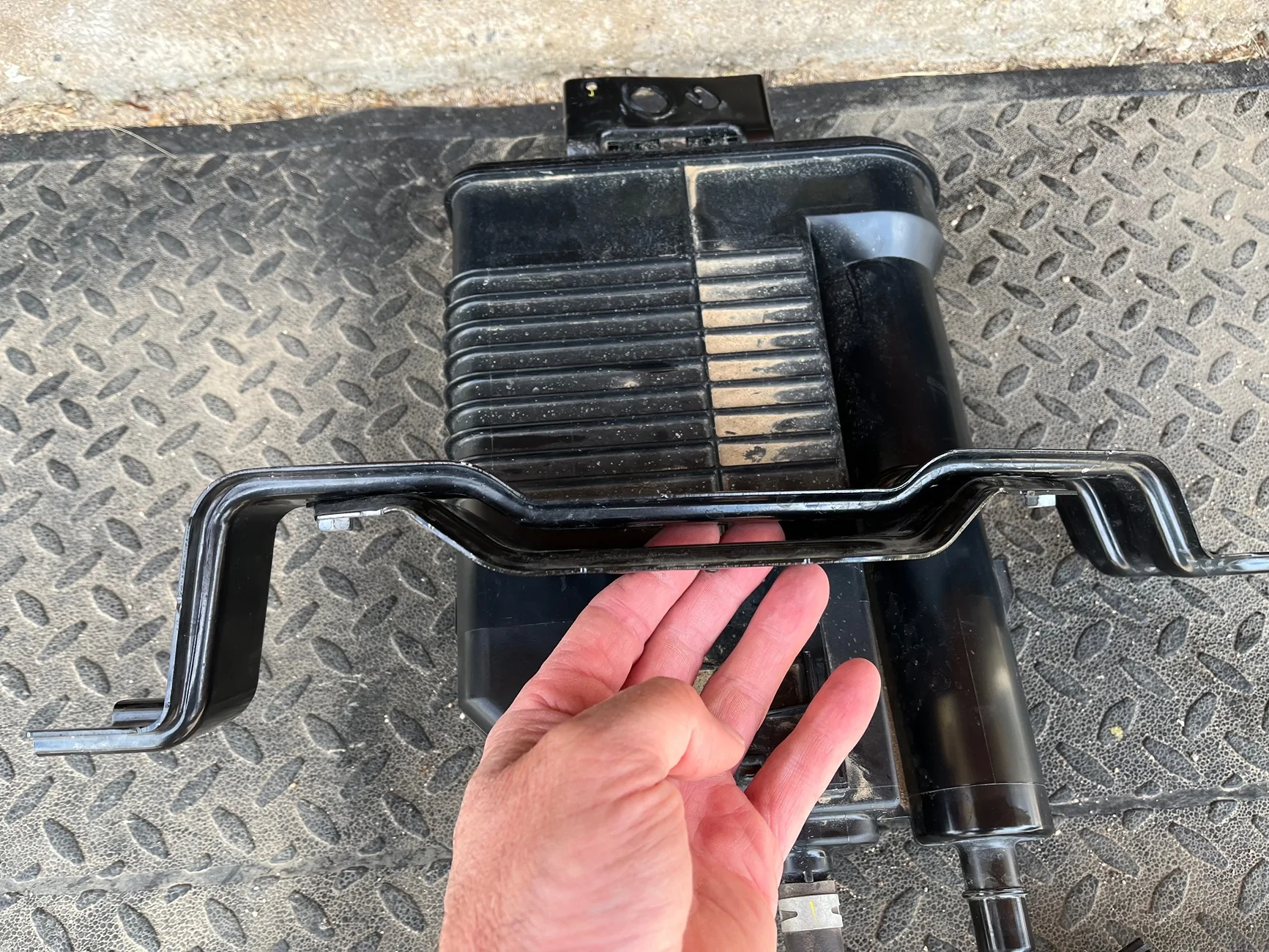

After lowering the spare tire and inspecting the charcoal canister for witness marks from a rock impact (I didn’t find any), I had the charcoal canister replaced at the dealer. As mentioned above, Toyota Care agreed to cover labor. I also asked the dealer to take one more look to make sure the damage wasn’t caused by an over pressure instead of an impact. They still believe a rock large enough to cause this kind of damage mysteriously flew cleanly through the narrow gap between the bed, frame and wiring harness and then somehow circled around or magically through two different metal brackets to hit the canister on the opposite side. The metal brackets are undamaged. I know, it sounds improbable, but it looks absolutely impossible and preposterous when you see it all in person.
Note how the cracked area is fully covered by two metal mounting brackets. Also note that this area of the canister is protected by the spare tire from underneath.
