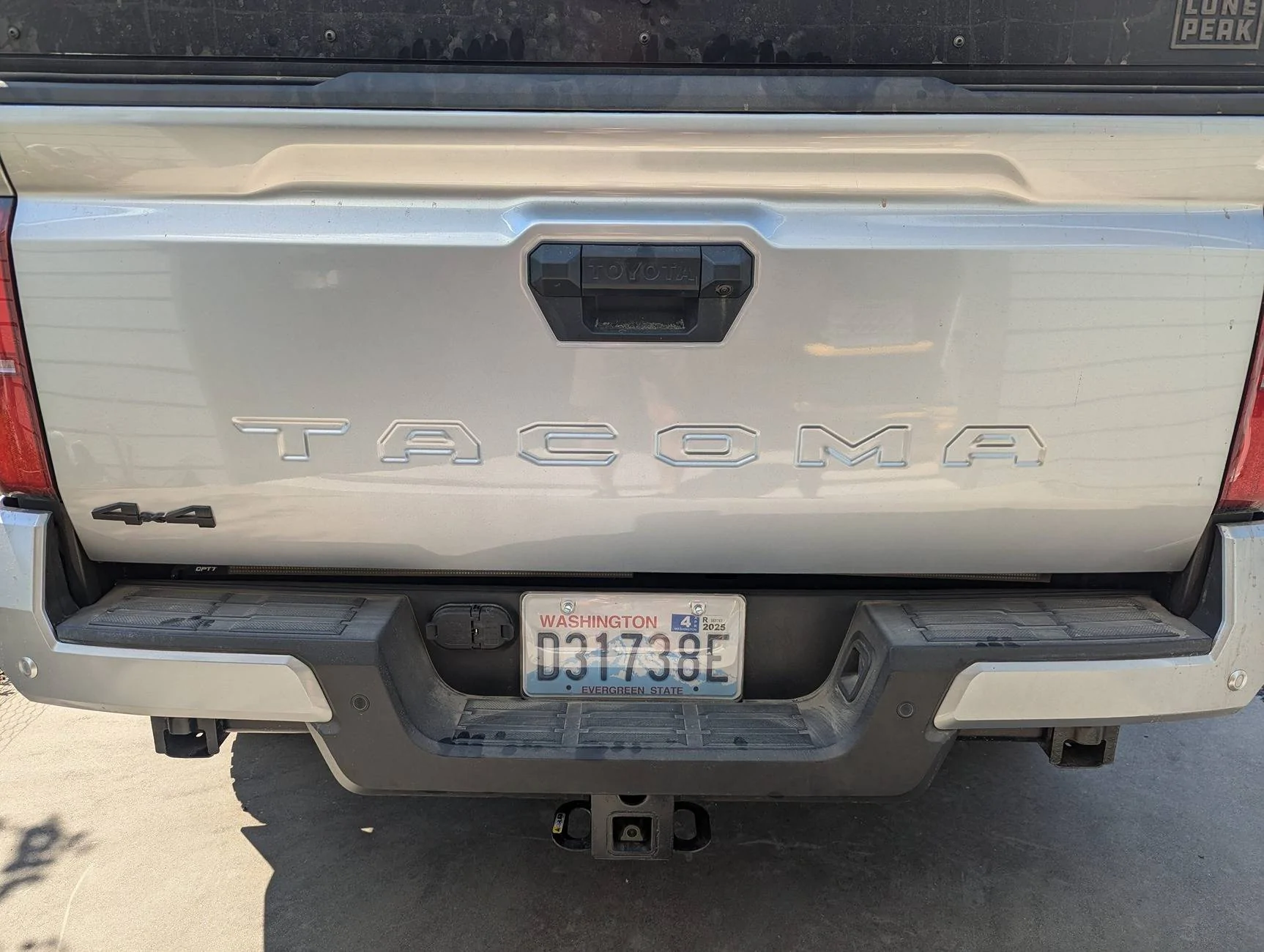

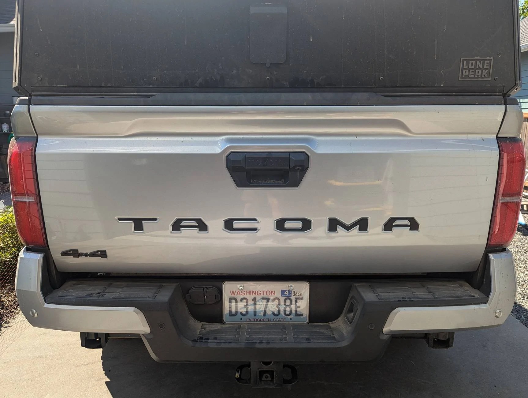

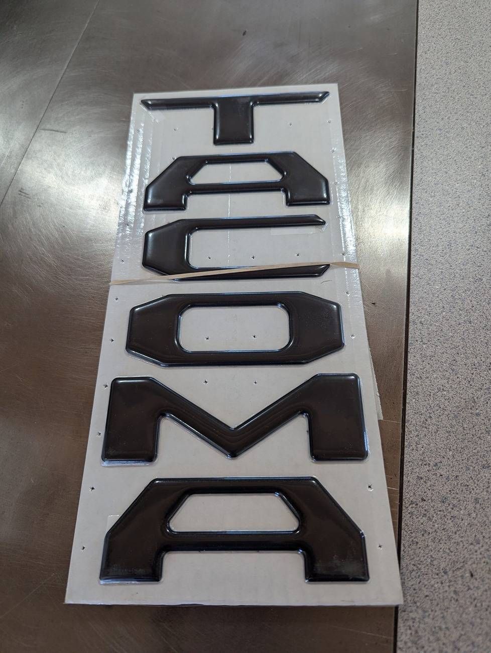

First up, lettering for the tailgate.

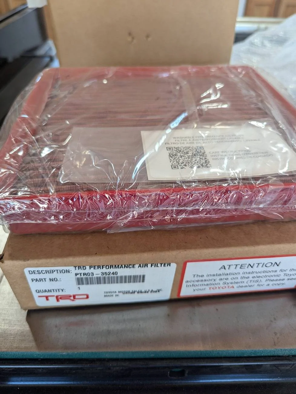

Next, TRD Performance Air Filter. Not much to show with this one...

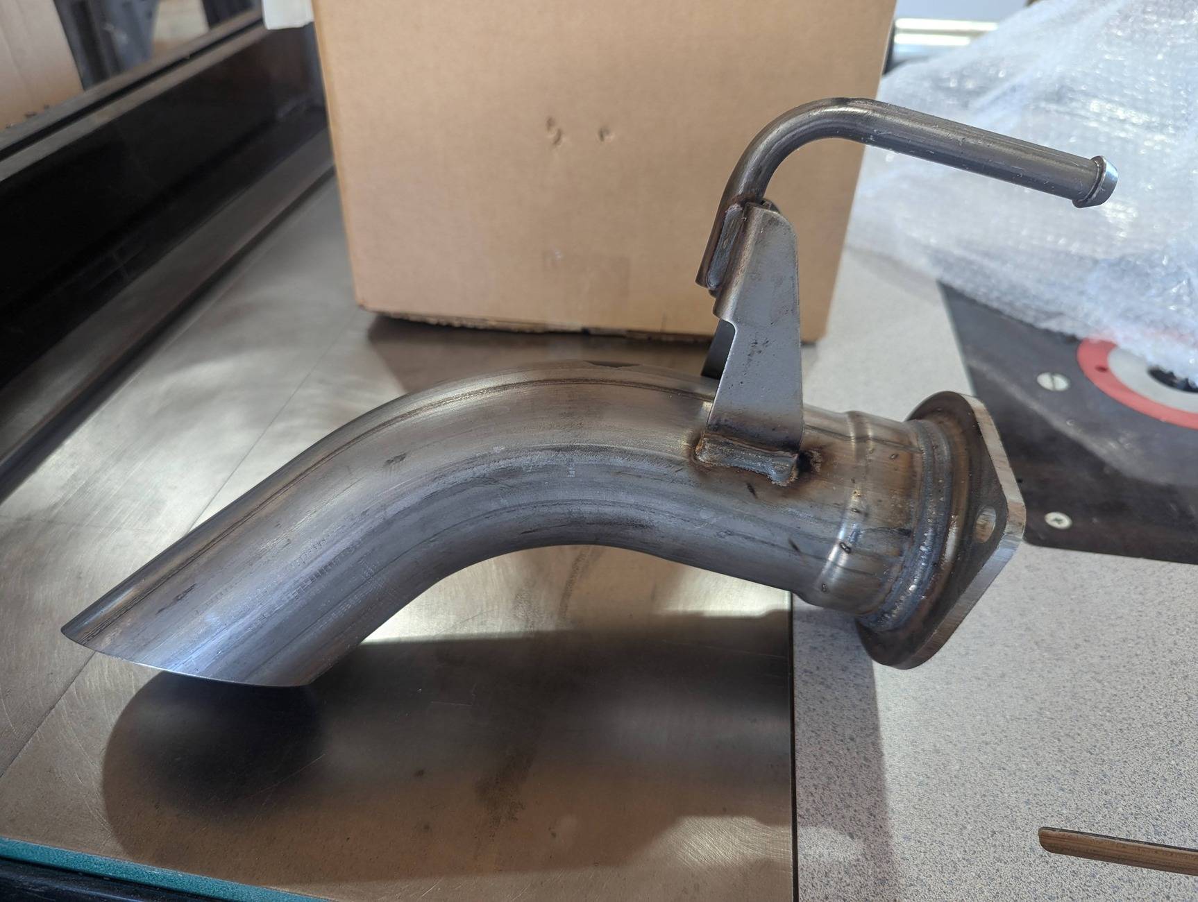

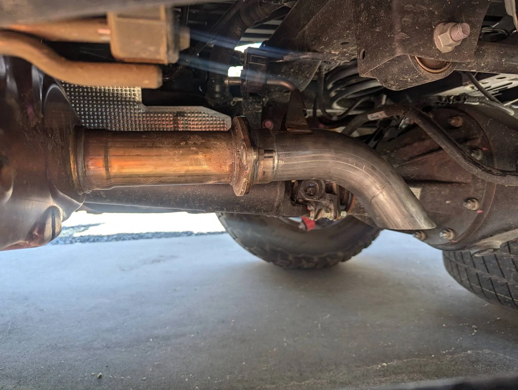

Finally, the axle dump exhaust tip. I was surprised that apparently they've changed the part and it now has the hanger bracket already welded on. That was unexpected, but nice.
One tip for removing the old exhaust. First, lift the truck using the subframe (not the axle) to get as much clearance as possible. Second, drop the spare tire. It was going to be a pain in the neck to snake out of there but dropping the spare let it slide right out, easy peasy...
