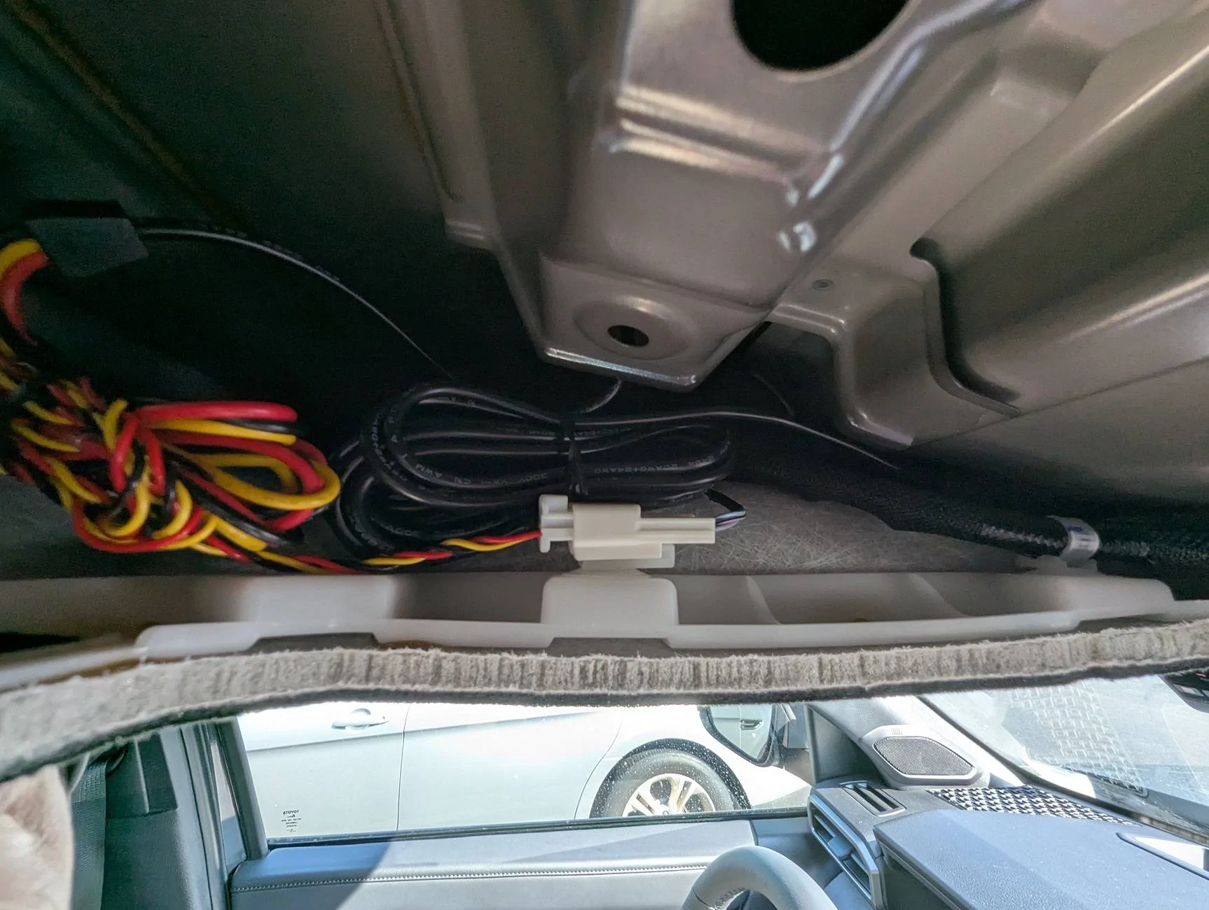

Some notes on cable routing. The space next to the dome light is fairly cavernous and you should be able to stash most of your excess wire up there.

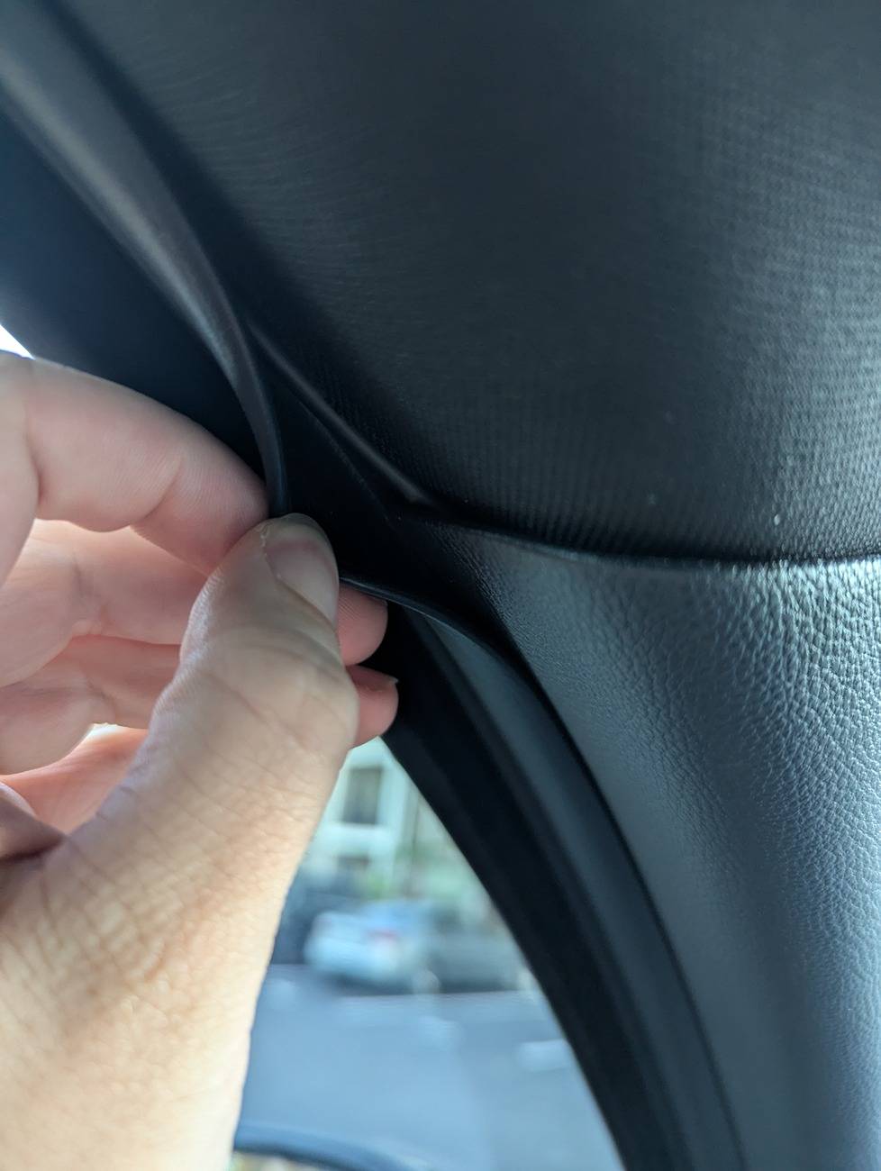

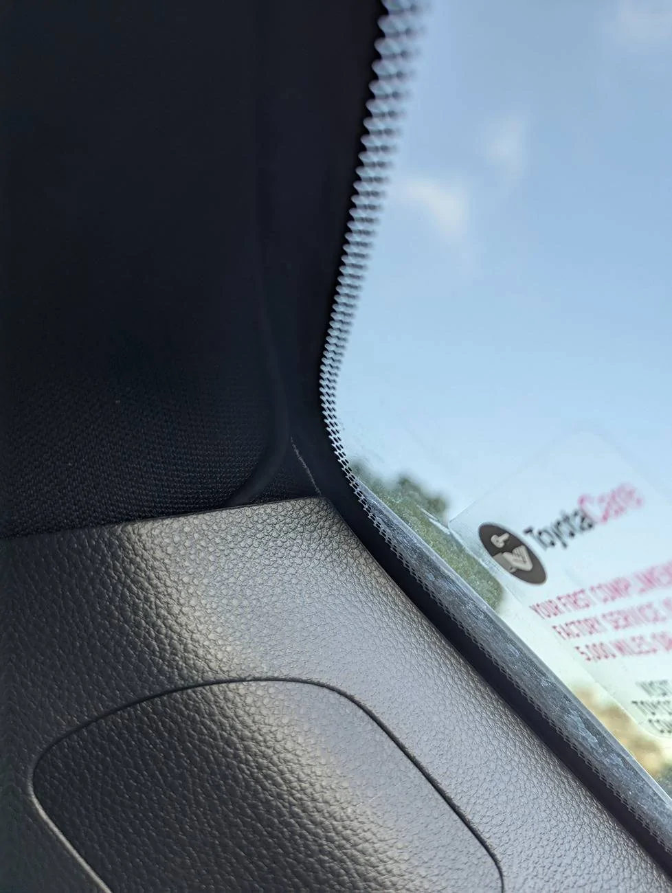

If you have a rear camera I would recommend starting from the back and stashing any excess in the headliner once you get to the front. Otherwise it's pretty standard, follow the headliner around to the door seals and then go from door seal to pillar to door seal to pillar in the rear and then tuck the rest into the headliner in the back.

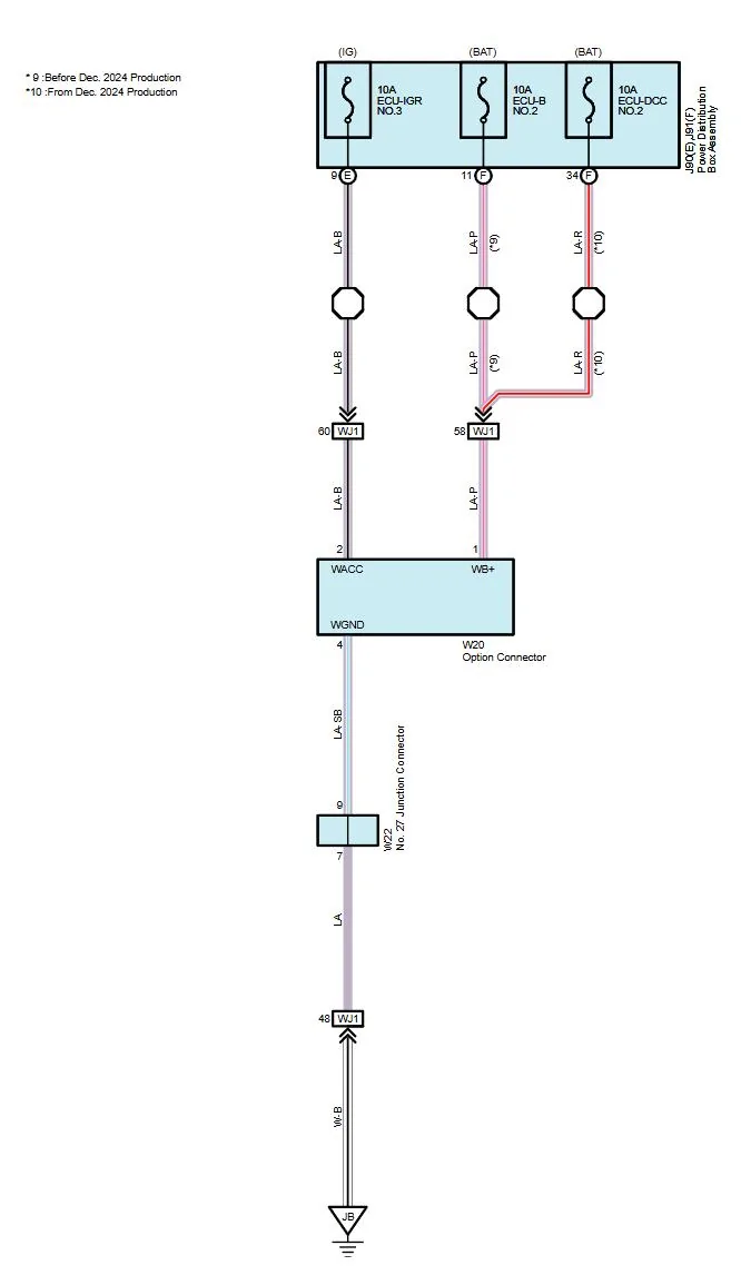

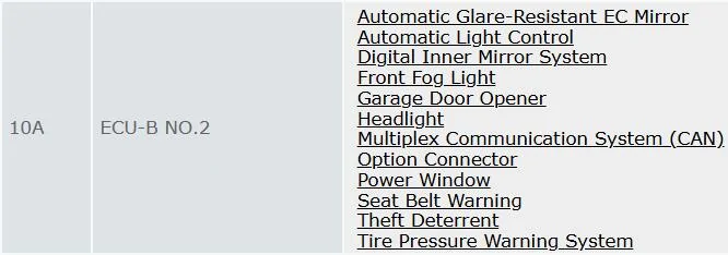

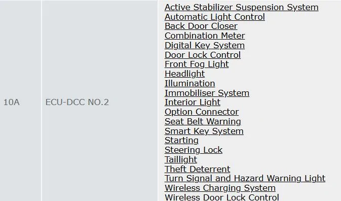

Any idea on what fuse that runs to or the wire gauge/current carrying limits ?
I am fairly sure that the wiring harness for this plug is 22AWG and I think it's fused off the dome light which is 10A. But I wouldn't wire anything in that draws more than 5A.
EDIT: Looks like it depends on production date. Regardless it is 10A fuse, but I wouldn't want to pull more than 5A as there are several other things connected to each fuse. It is referred to as W20 Option Connector in the wiring diagram.

Thank you! Are these schematics all publicly available on toyotas site?
You're welcome. Unfortunately they are not publicly available and technically shouldn't be shared. They are available through TIS (Toyota Information Systems).
It has all of the information that service techs and dealerships have access to on wiring, mechanical, and software. It's great but unreasonably expensive for information that owners should have about their vehicles. Mortals like us can get a 2 day subscription for $25. It's best to get a subscription when you have a project and then save all the stuff that might be useful. There isn't a good way to print everything off and you'd lose a lot of the functionality like cross referencing. There is a mountain on information, most of which you'll probably never need.
