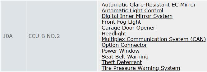

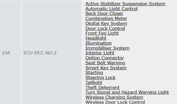

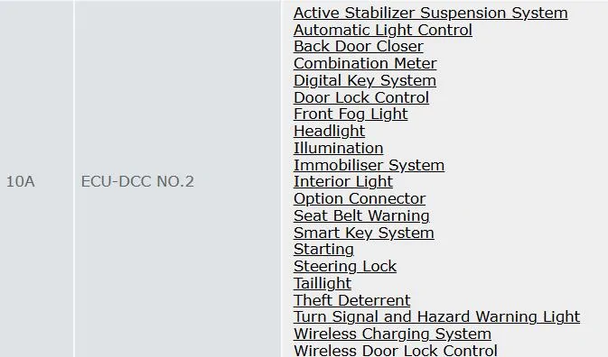

Any clue as to what fuse that may be? Can’t find anything related to camera.
It's either ECU-B or ECU-DCC depending on your build date. Could also be ECU-IGR.
And in case this isn't obvious, take out what you plugged into the dome light camera connector. Something is not wired right.

No luck on the fuses
Hard to know beyond that without knowing what went wrong. Possibly one of the connectors above the mirror came loose during install? Otherwise worse case is the 12v shorted to neutral and fried something.
Without knowing what went wrong I'd check all the fuses and then probably take it in to the dealership and plead ignorance.

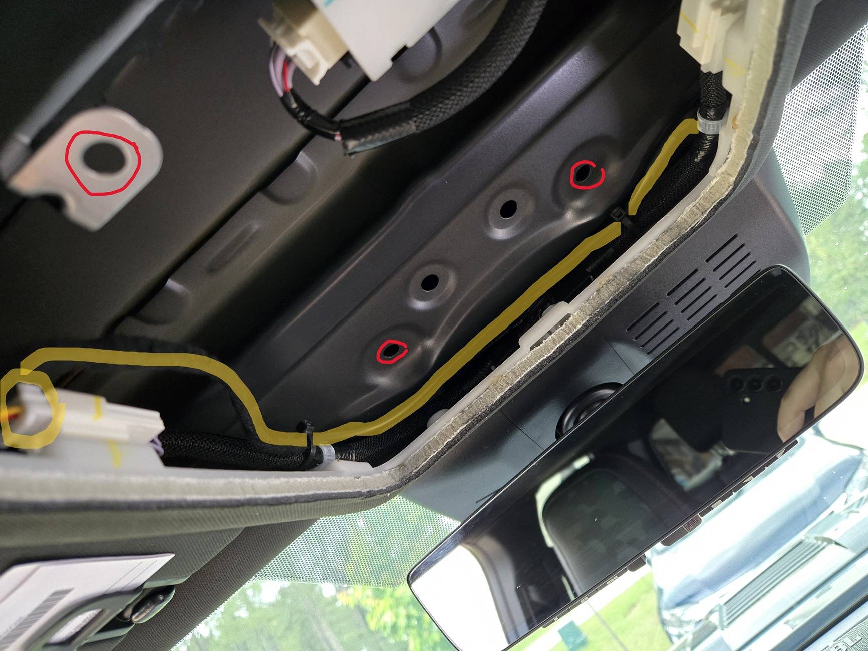

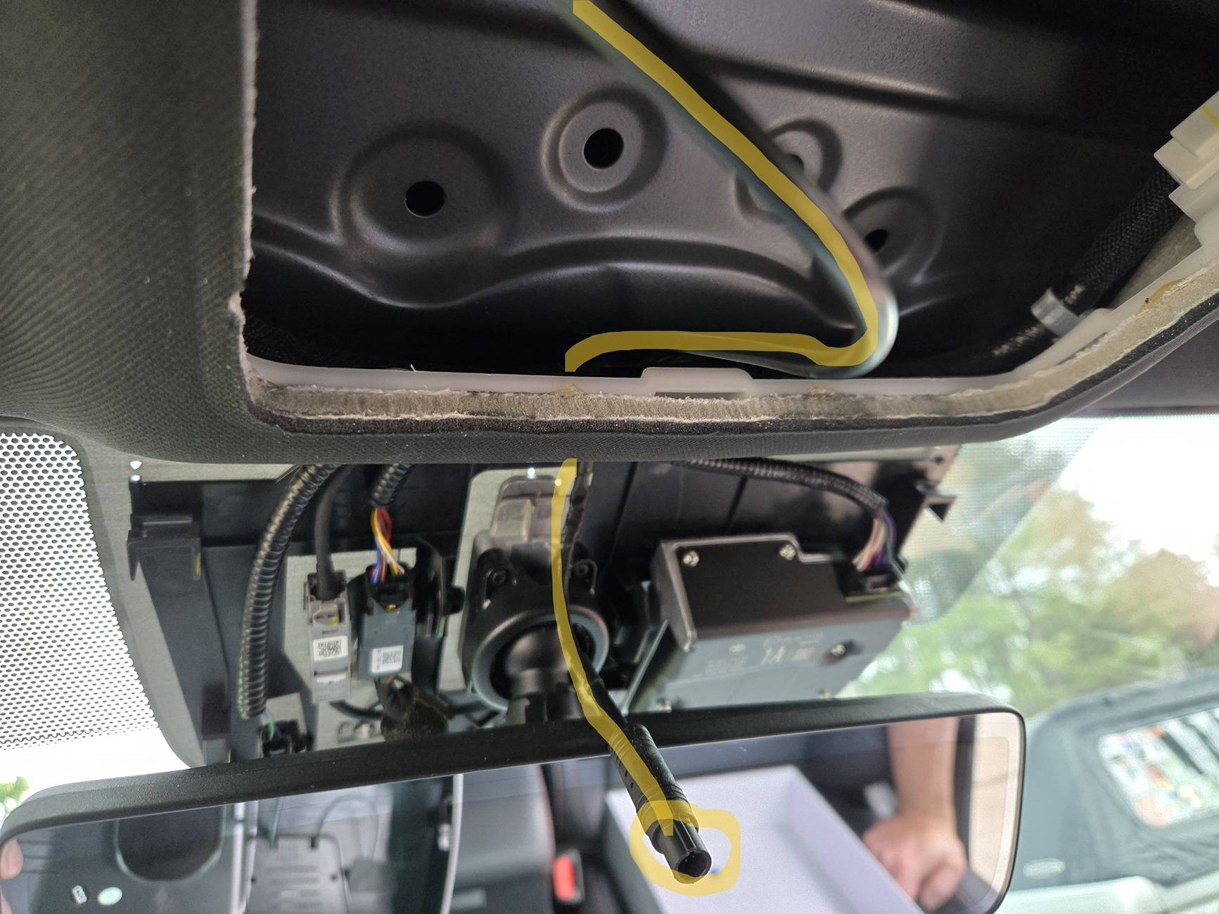

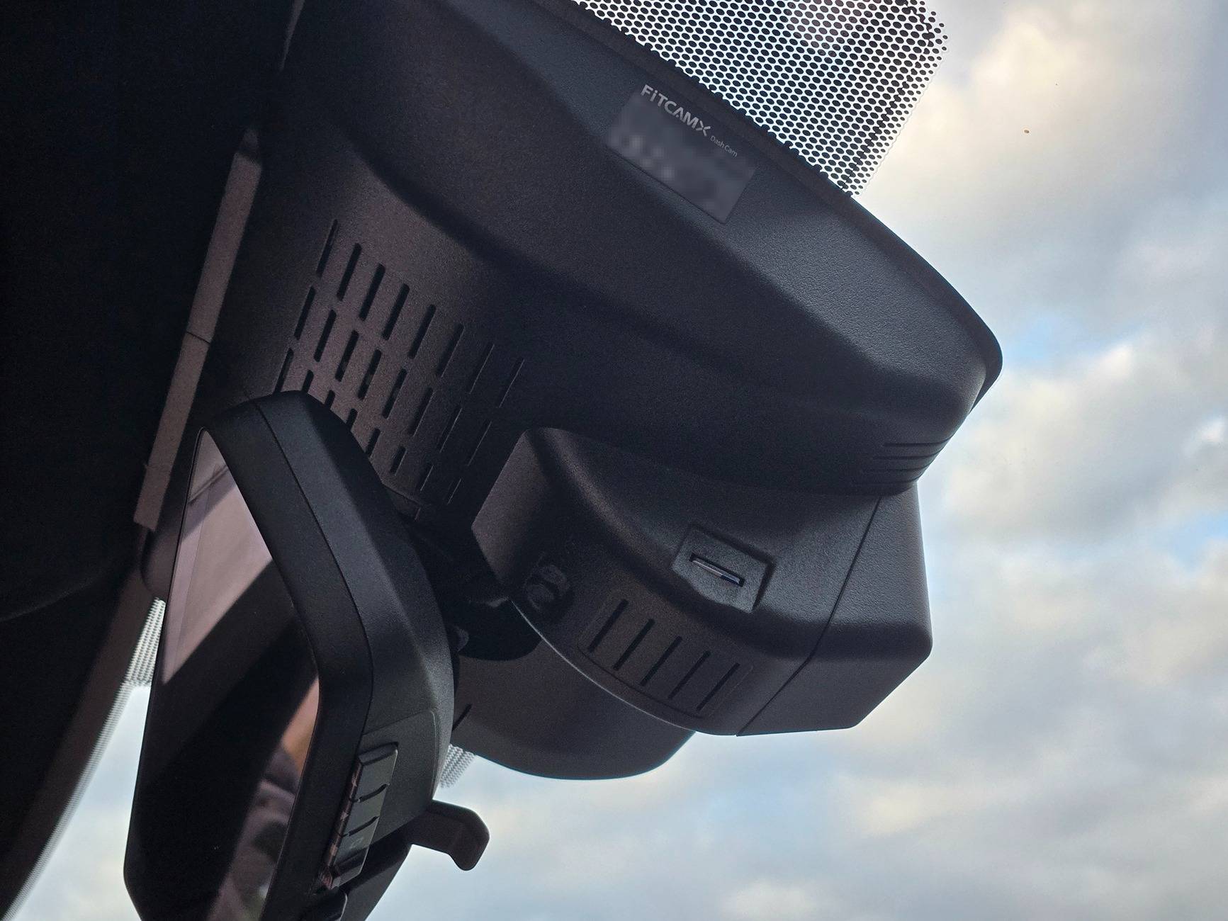

Figured i'd post here instead of creating a new thread. I know there are better DashCAM options out there, but I've had FITCAMX on many of my previous cars without any issues and love the OEM look of it [even more OEM than Toyota's OEM Dash].
Anyway, FITCAMX also has a parking mode cable available to use with the 5pin Harness. Their site says for 2021 Toyota Sienna, but that is the exact same connector as the one pre-wired in our trucks > https://fitcamx.com/collections/fus...parking-mode-cable-for-toyota-sienna-2021-now

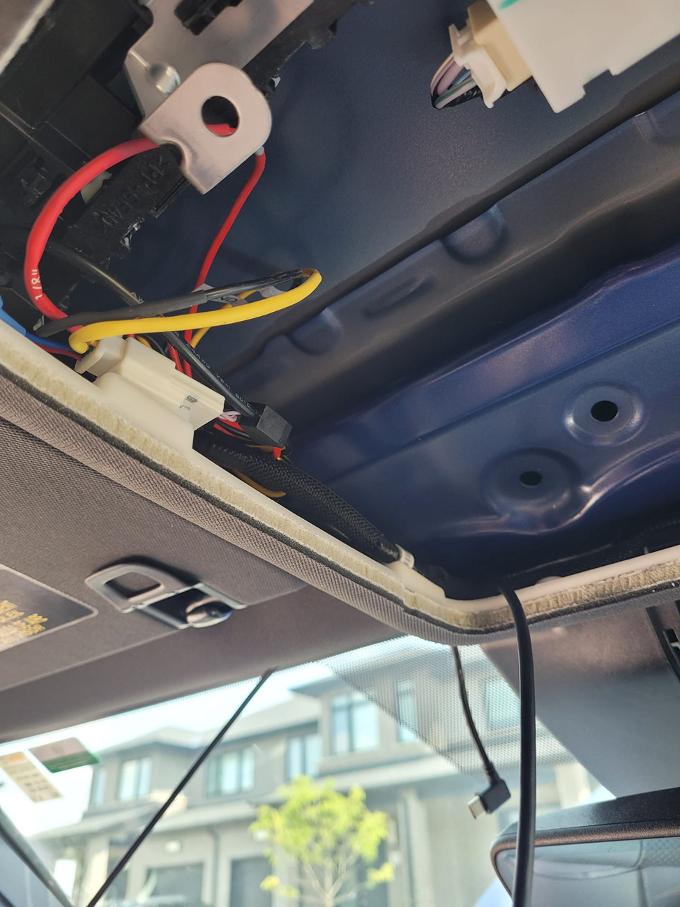

@BoboForShort you're an absolute genius, thanks for this! I just finished installing a VIOFO A229 this past weekend and the whole thing was a breeze.
I got the pigtail from Aliexpress as suggested, soldered the 3 wires from VIOFO hardwiring kit and went straight to the OEM plug overhead.

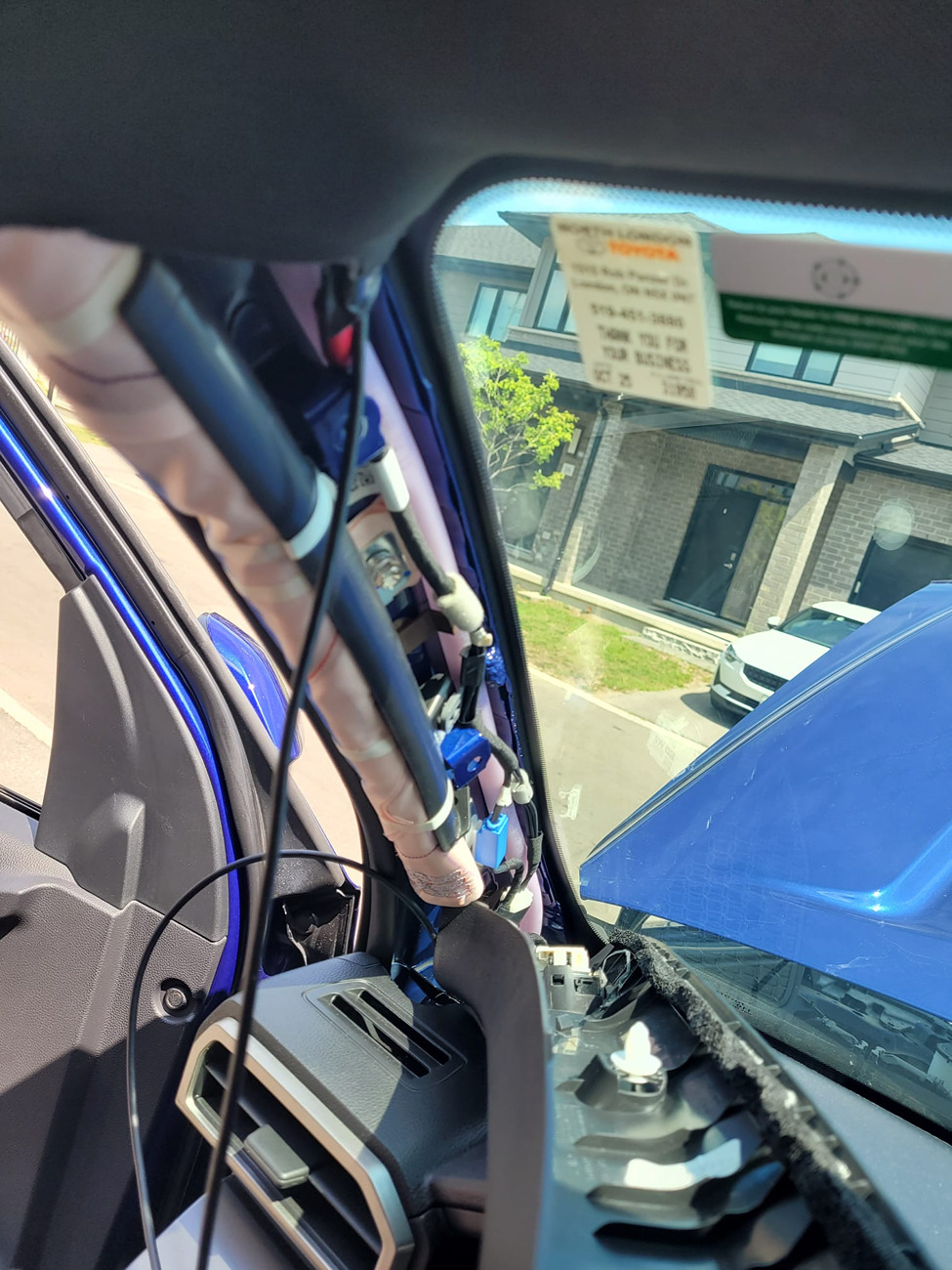

2024 Tacoma Dashcam Hardwire w/o Fuse Box *ALMOST* as easy as Dongar WhatsApp Image 2025-08-10 at 14.04.34_6e5a875
For the rear camera I ended up going towards the A pillar on the driver side.

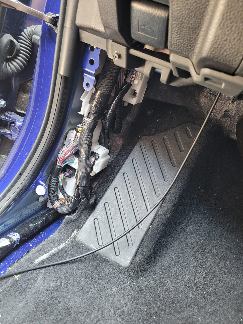

2024 Tacoma Dashcam Hardwire w/o Fuse Box *ALMOST* as easy as Dongar WhatsApp Image 2025-08-10 at 14.05.26_1c1e1a54
Routed the cable behind the airbag, along the existing harness, down into the kick plate.

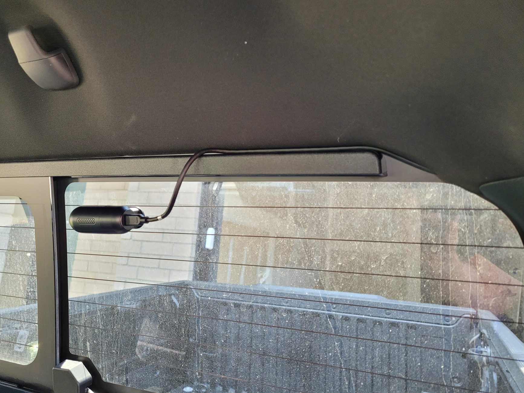

2024 Tacoma Dashcam Hardwire w/o Fuse Box *ALMOST* as easy as Dongar WhatsApp Image 2025-08-10 at 14.07.04_da584853
And then on to the rear window.
2024 Tacoma Dashcam Hardwire w/o Fuse Box *ALMOST* as easy as Dongar WhatsApp Image 2025-08-10 at 14.07.04_4c4e2098
Parking mode works (although I am not currently using it, but tested and everything works). Setting up the camera and the app was actually very fast and easy as well.
