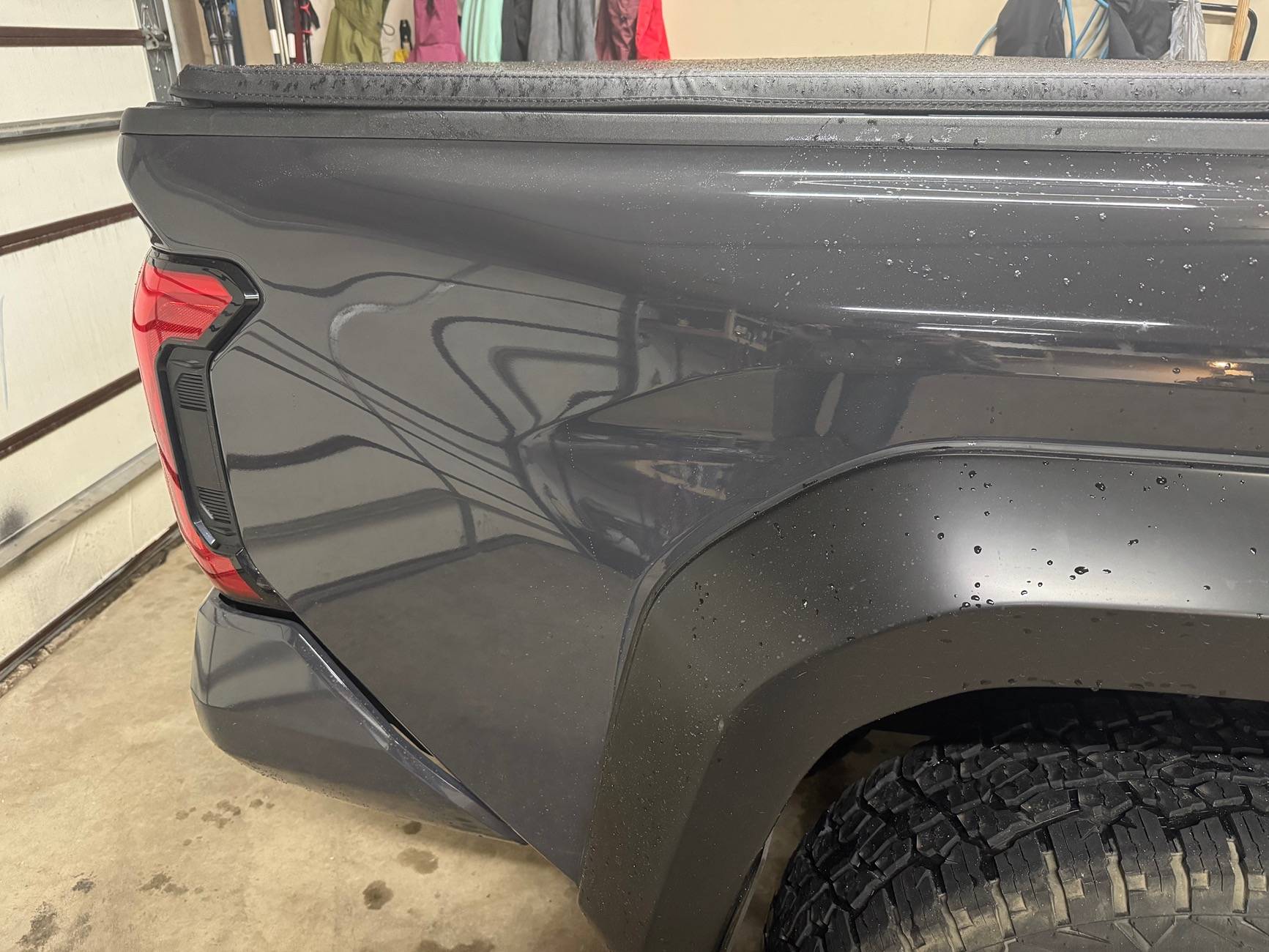

I just used the 3m Runner wheel on my Black TRD Sport to remove the bed stickers. I did not remove the outer layer of the stickers first. Used a Dewalt cordless drill and removed both stickers in less than 10 minutes. It did not heat up the panel and you cannot tell they were ever on there. I actually removed the tacoma and 4x4 badges also, and it took much longer to remove the glue that adhered the badges to the truck than the stickers. The 3m wheel works fantastic. i was very surprised with the ease of removing the stickers and the final outcome. Would highly recommend.

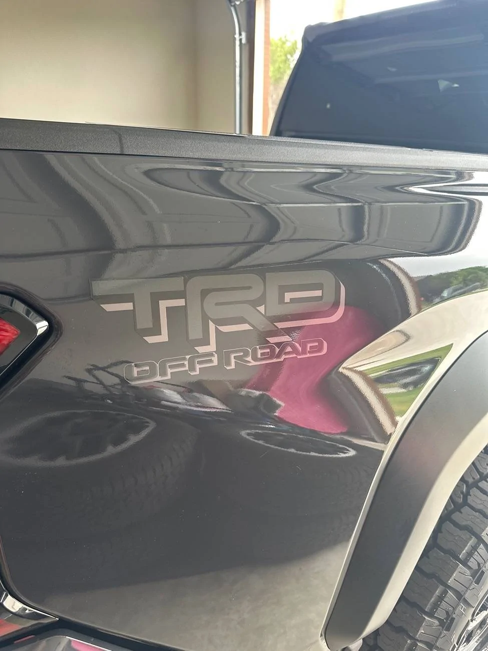

Here's mine! Took the decals off. I was looking at this and thought it would blend nicely on my truck with underground gray.
I actually bought these grey decals for my Underground sport, but I’m hesitant to try to remove the originals. The grey decals look nice though and I think they would look better. Not a fan of the white OEM.
I just put one on my underground! Even with using a hair dryer it took a LONG time getting the old decal off. I’m only halfway through and think I’m going to wait for some Texas heat to help with the other side

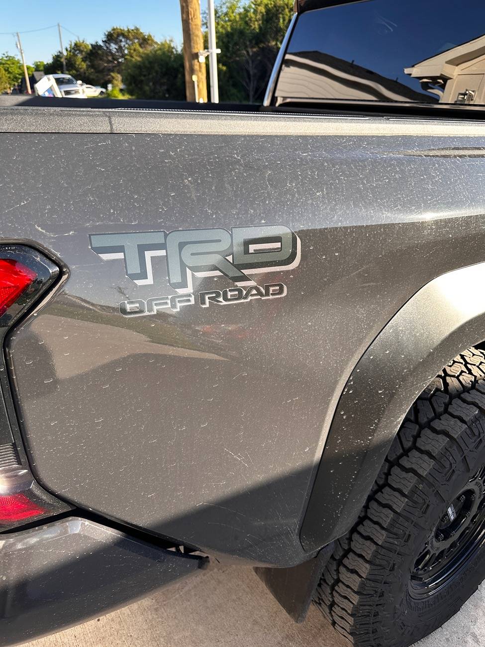

Do you have more pic of it? I am on fence either leaving the bed side decal less or put new one one......
I don’t have another pic but I’ll get one as soon as I have the chance. It’s a slightly different grey than Underground but I think it blends nicely while standing out just enough

Took mine off a couple days ago, 3M stripper wheel took 10- 15 mins.
I’m considering getting something like that for the other side, was there any damage to clear coat you had to fix afterwards?
Zero damage. It did leave a smudge like residue from the eraser wheel that wiped quickly off with goof off.

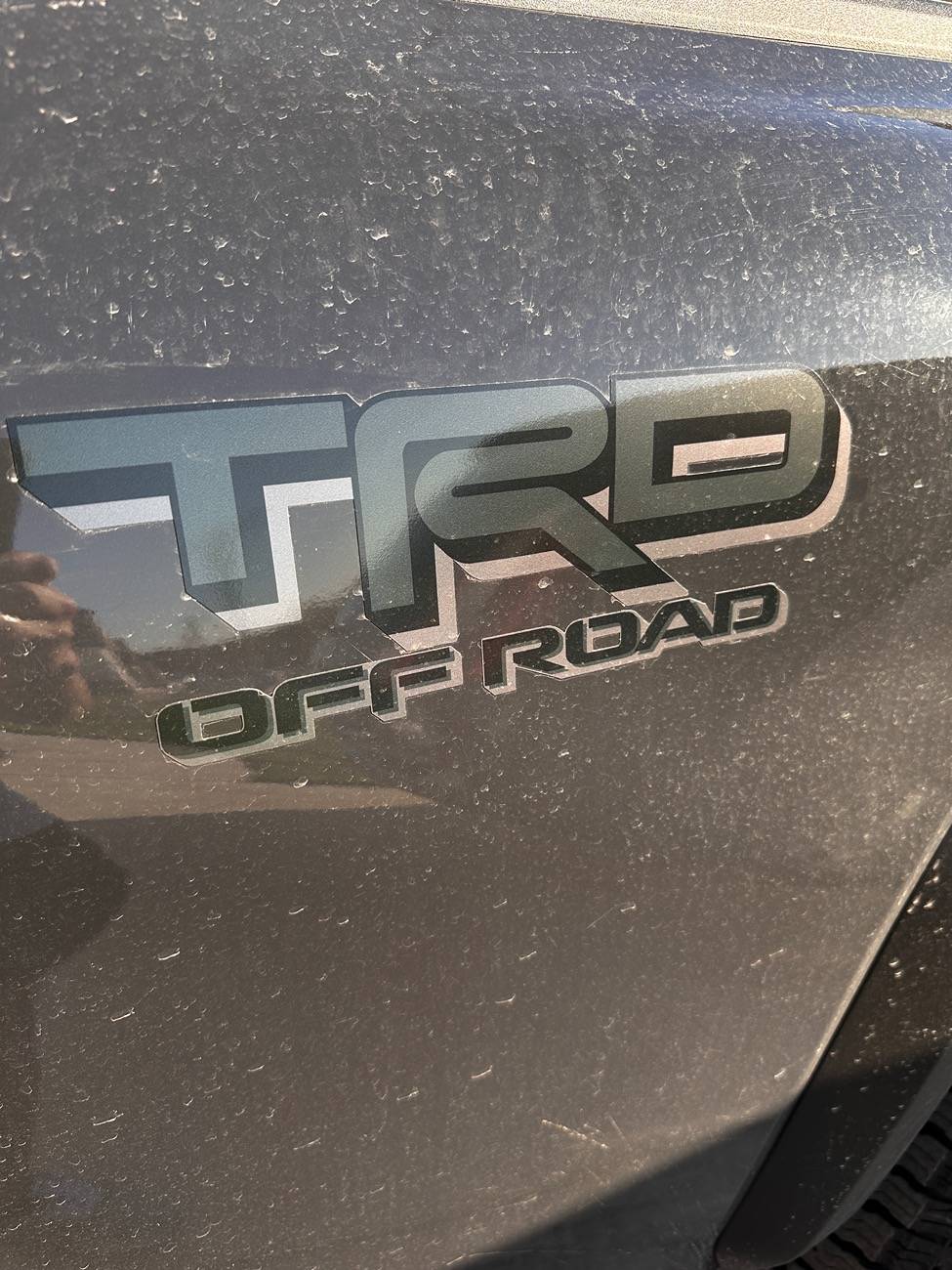

Finally was able to get a couple pics with decent lighting

i like color blend with that paint color
looks sharp ?%
