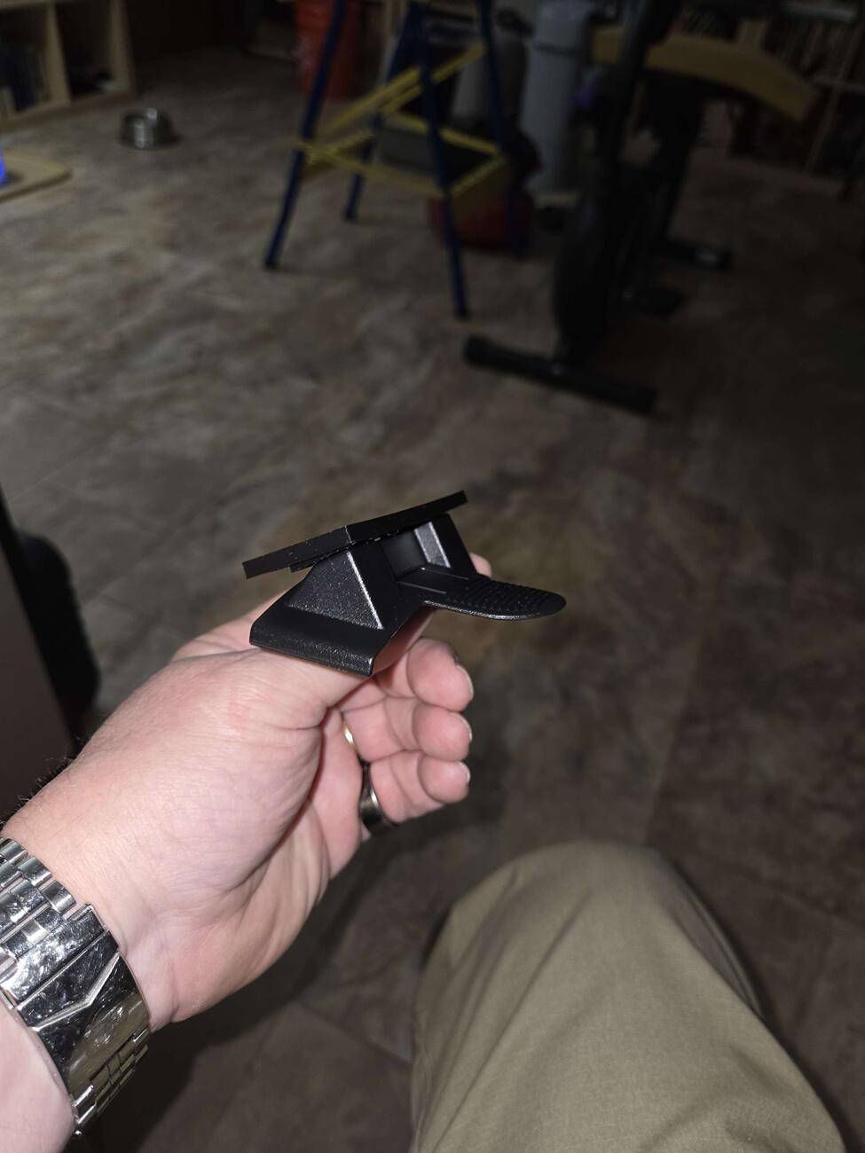

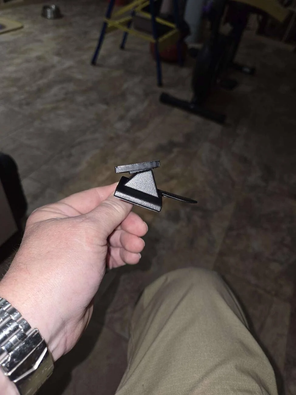

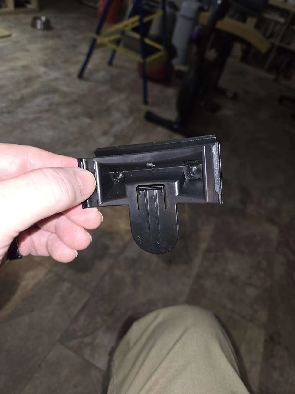

I recently bought a 2024 Tacoma TRD Off-Road (4th Gen) and needed a new windshield mount for my Valentine One (Gen 1) radar detector, as it has a different windshield rake angle compared to the prior 2017 Tacoma TRD Off-Road (3rd Gen). The windshield rake with stock tires & suspension measured at 30.5°, while the face of the suction-cup mount is at 35.5°.

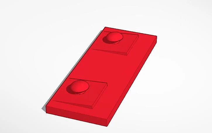

Whopped this up in TinkerCAD this evening, and much to my surprise the first test print ended up perfectly suitable for purpose. Use your preference of mounting adhesive for the windshield.
The .stl can be downloaded at https://www.thingiverse.com/thing:6953185 - the license allows for non-commercial use, and it can be "remixed" if you wish to make changes.
