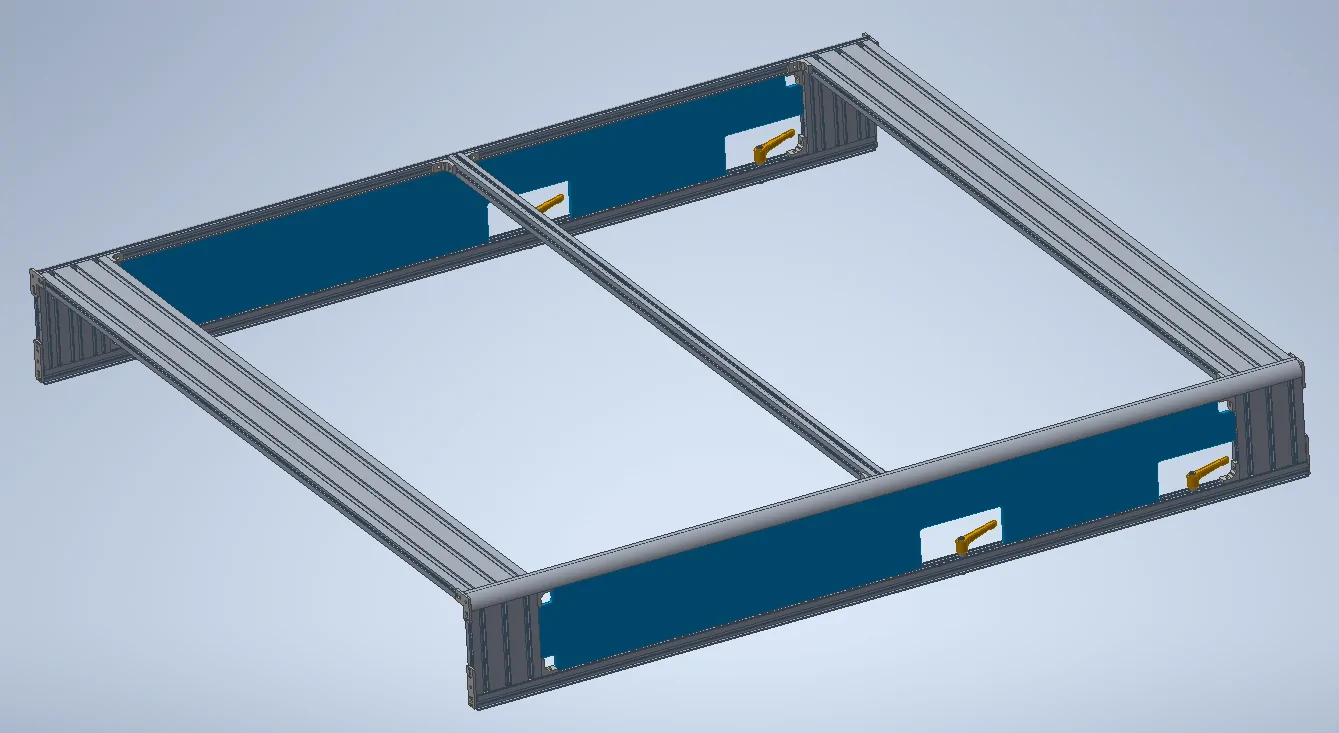

Fortunately, my company makes the aluminum extrusion framing, so I've been going through the catalog and working through a design at lunch. Here's where it's at!

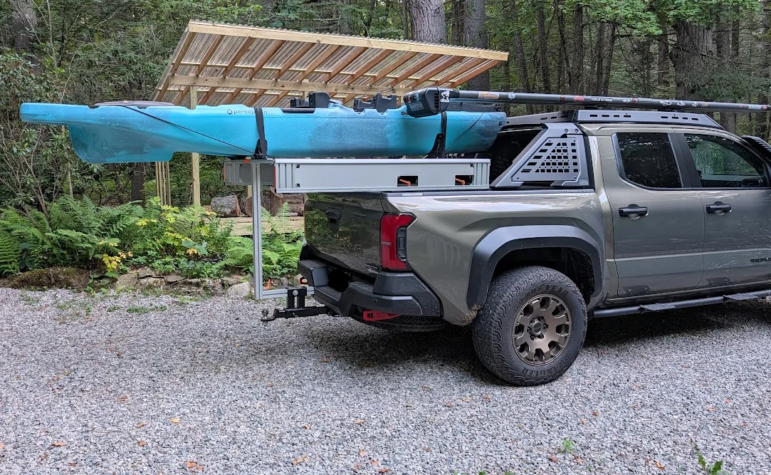

Final Model:
2024 Tacoma Designing a bed side rail extension thing for kayaks! 1782491445285-ri

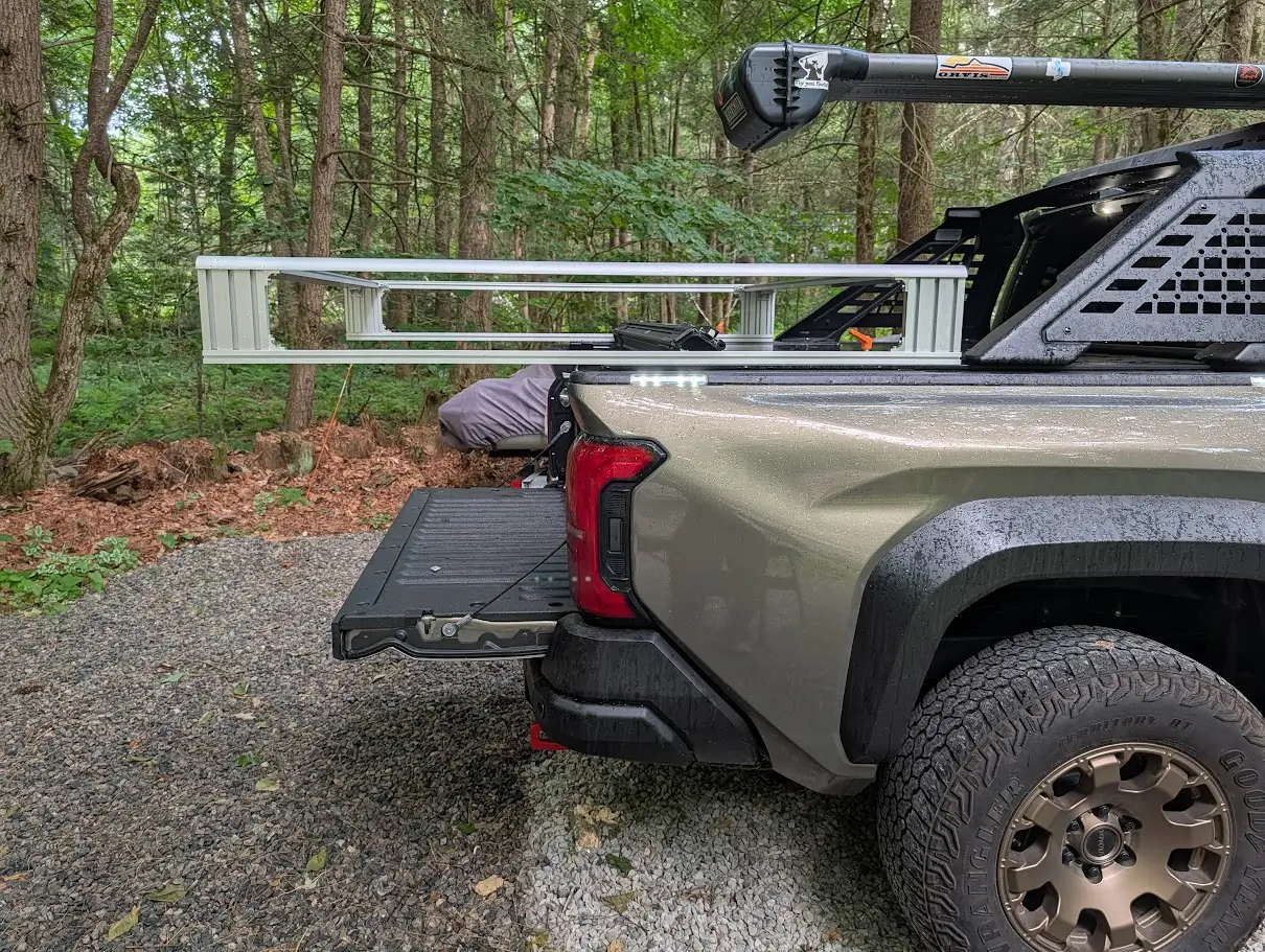

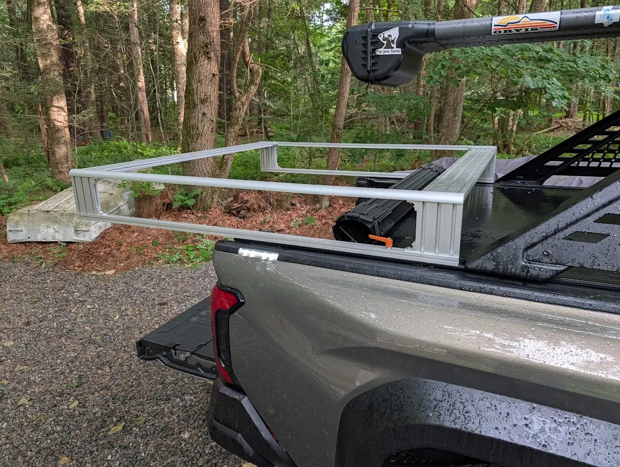

Here's the basic frame on the truck:
2024 Tacoma Designing a bed side rail extension thing for kayaks! 1782491545120-wi

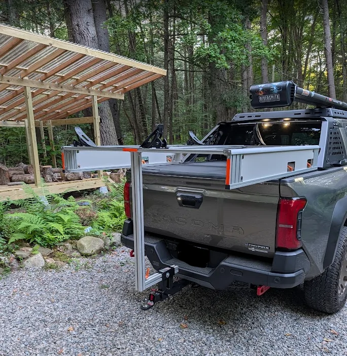

2024 Tacoma Designing a bed side rail extension thing for kayaks! 1782491591597-zy

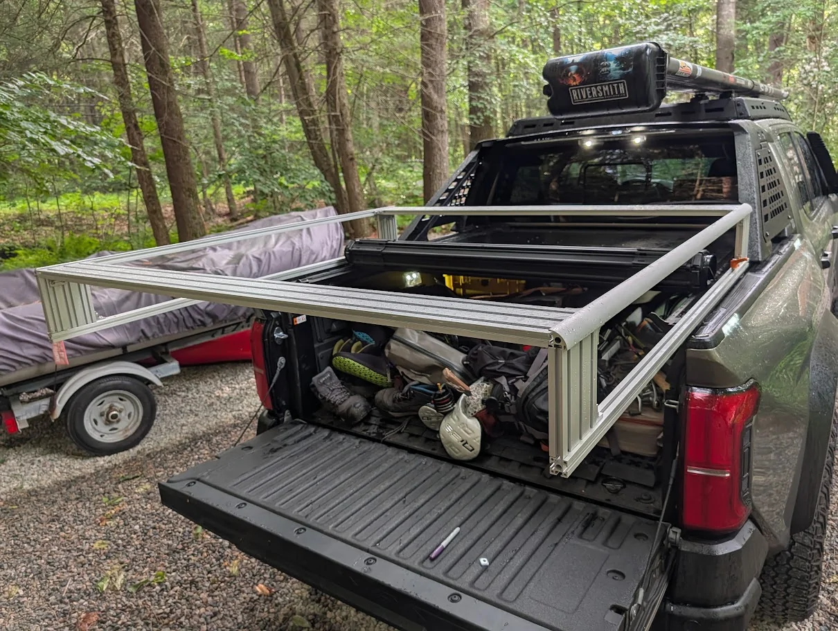

2024 Tacoma Designing a bed side rail extension thing for kayaks! 1782492364770-to

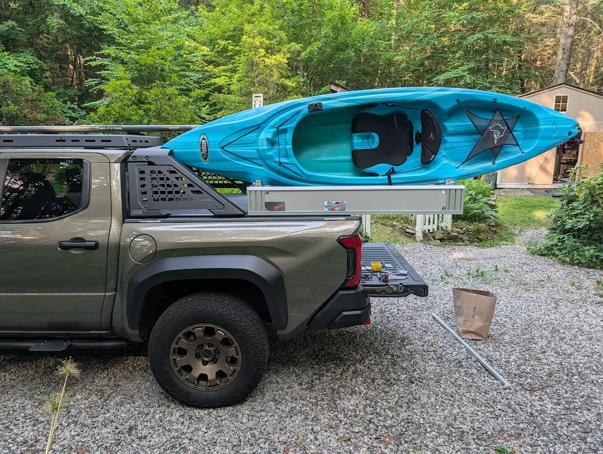

It laid on and mounts really solidly. The handle bolts lock it in really well and lock the rails together. The cover rolls up no problem. I went through some iterations on how to support the sag, and I had trusses in there originally but it got heavy quick. So I've got some foamed PVC hard panels being machined now on the router that will fit right in the internal t-slot pockets on the sides and be lightweight, but fully rigid. The middle crossbar is for a handle.
What do y'all think? Anyone else have this on a wish list?

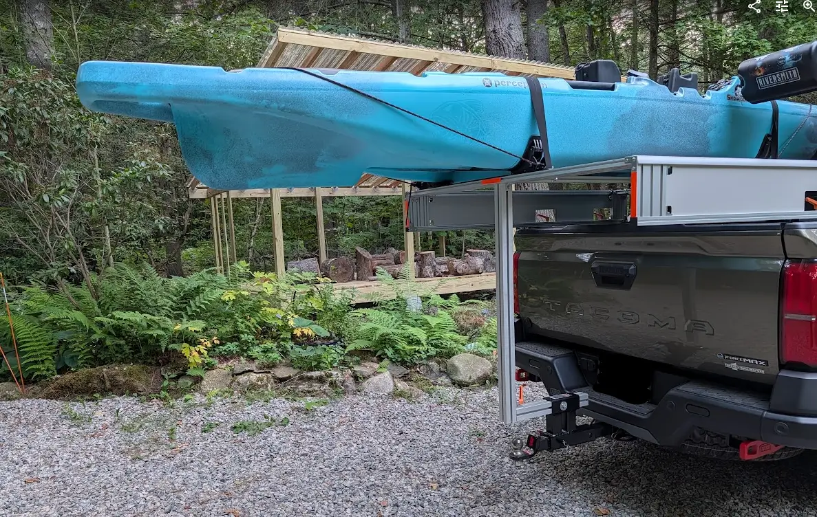

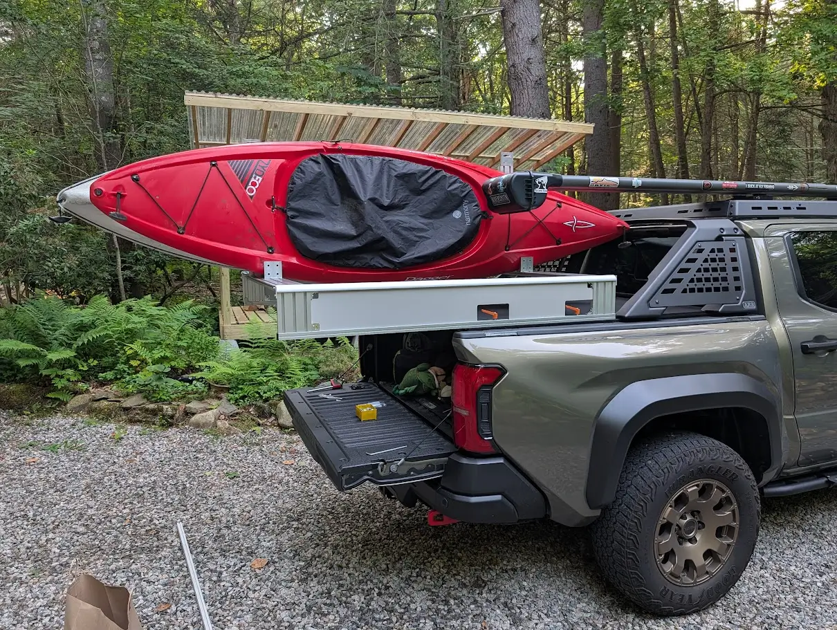

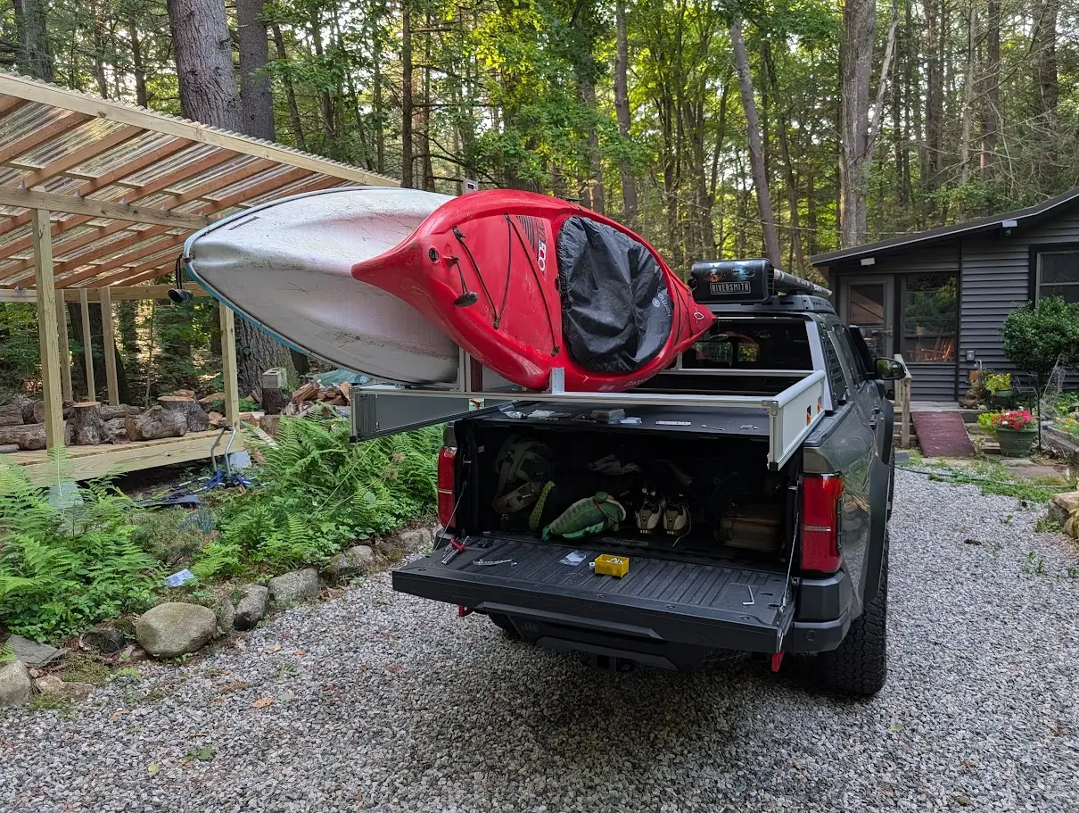

Finished it up last night. It couldn't have come out better. Super happy with it. The side panels make it completely rigid. Perfect height, easy to load, and the stops hold both kayaks exactly in position for tying it down. I shortened the front post a little for better hold down, and added some rubber matting to the rest points. The cover still rolls up just fine, and still have access to everything in the bed. If it wasn't 9,000,000 degrees out I'd be on the water after lunch....

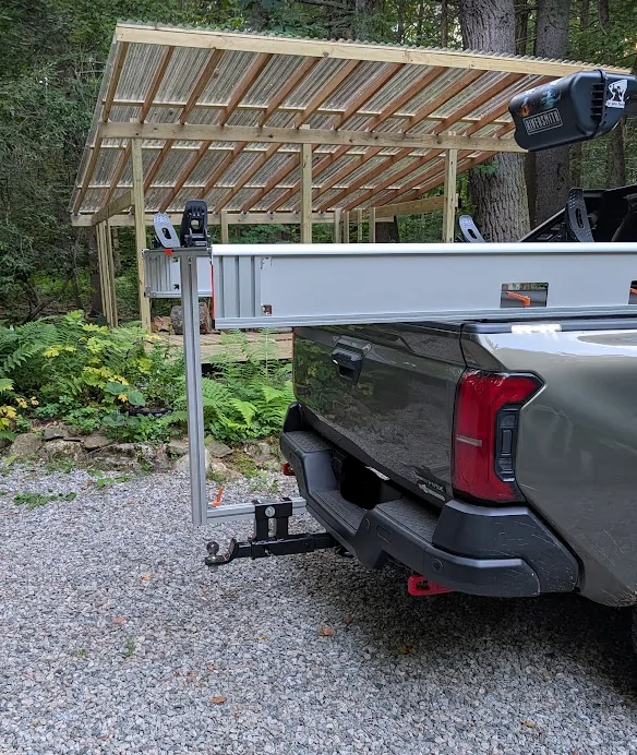

Well I'm back. Was enjoying the ease of kayaking again, and I fish, so I got a fishing kayak! What I wasn't enjoying, was that these things are F#^&$# heavy. And, it's longer than my other ones. I got the Perception Showdown 11.5' pedal kayak. When I put it up on my rack to add cradles, it started to bend the brackets that hold the actual cover system on inside the bed, and flexed onto the bed sides plastic trim. That wasn't gonna work....

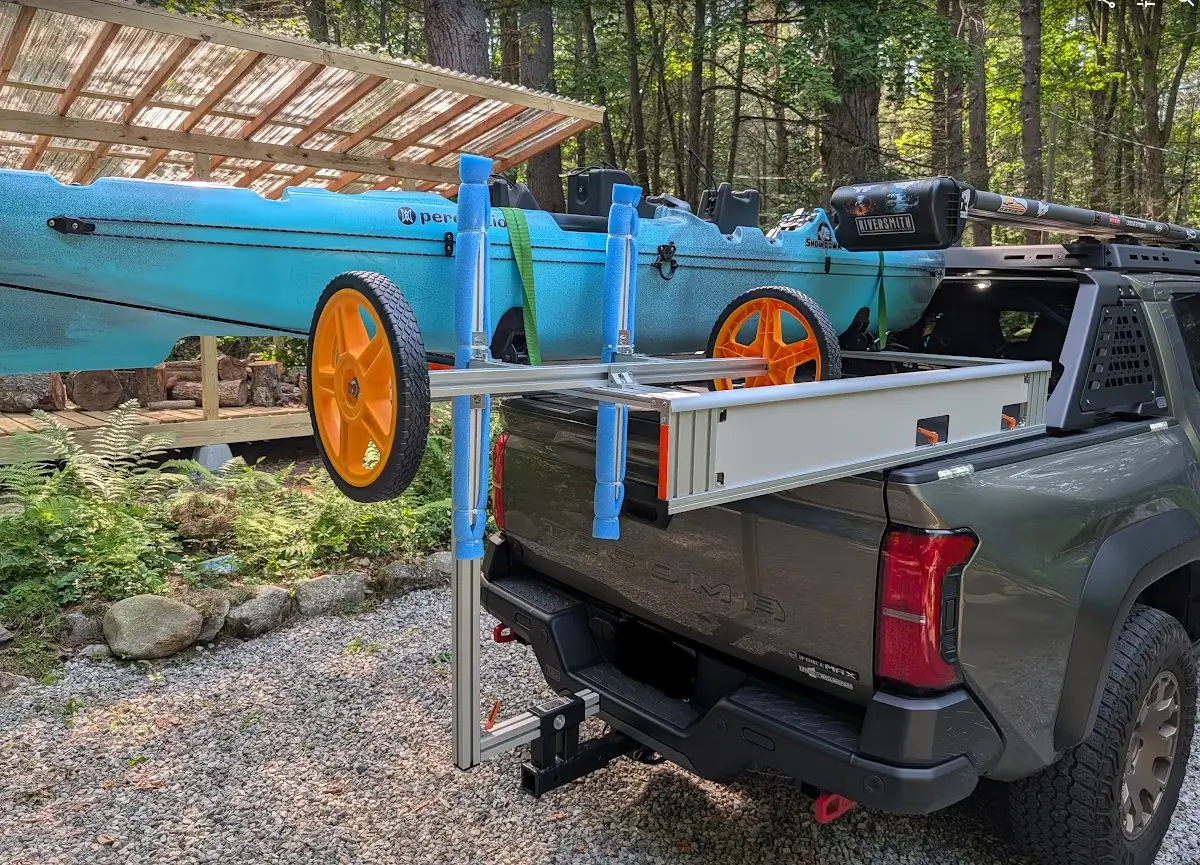

With some research, I found a double hitch extender for adding accessories for $36 bucks at Harbor Freight. With that I can hitch up the boat and build a kick stand for the rack when I have the big yak on it. I grabbed some 50x50mm extrusion, which slides right in, and bolted it in from the sides into the t-slots so it doesn't jiggle. I then mounted the upright to a gusset with a quick lever on it so I can dial in the height I want. Now the rack is rock solid with a 100+lb kayak hanging out the back even on dirt roads. Another mod I'm super pleased with.
After that I built and mounted the kayak cart. Everything still opens and closes, tailgate and cover, for easy access to the gear once the boat is off.
