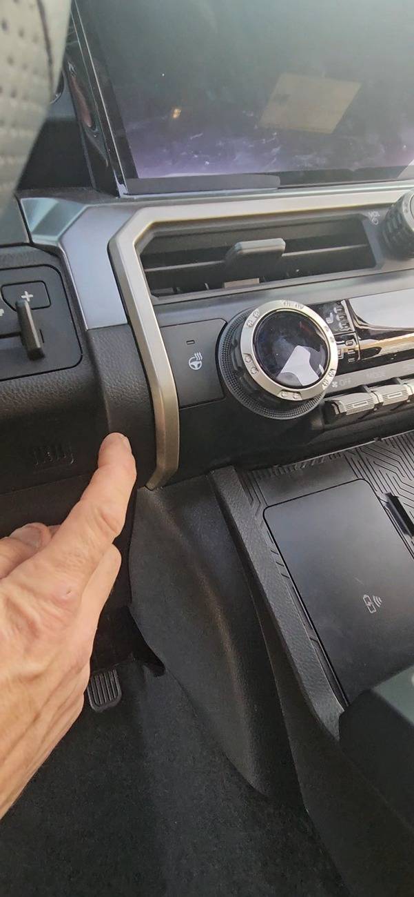

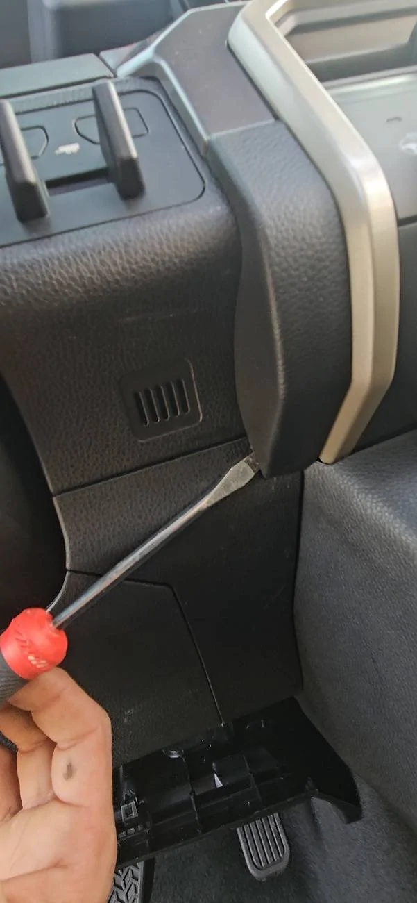

My phone doesn't support wireless charging, but that spot is perfect for holding it while it is charging on a cord. So, I set out to disable the charger. Took pictures in case it will help someone else.
Another post somewhere said the fuse was under the glovebox. Manual shows where and how to open.
2024 Tacoma Disable Wireless Charger 1-IMG_20240729_094654354
Just need to push the clips forward and pry gently. The flex it a little to get it out.

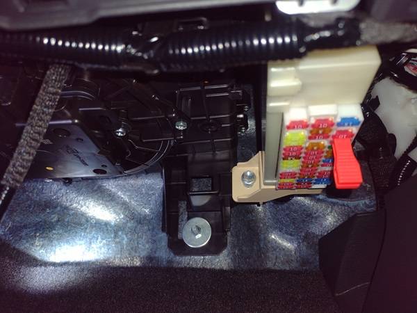

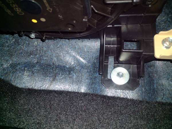

2024 Tacoma Disable Wireless Charger 2-IMG_20240729_093736732

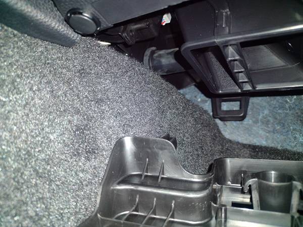

Box is on the right

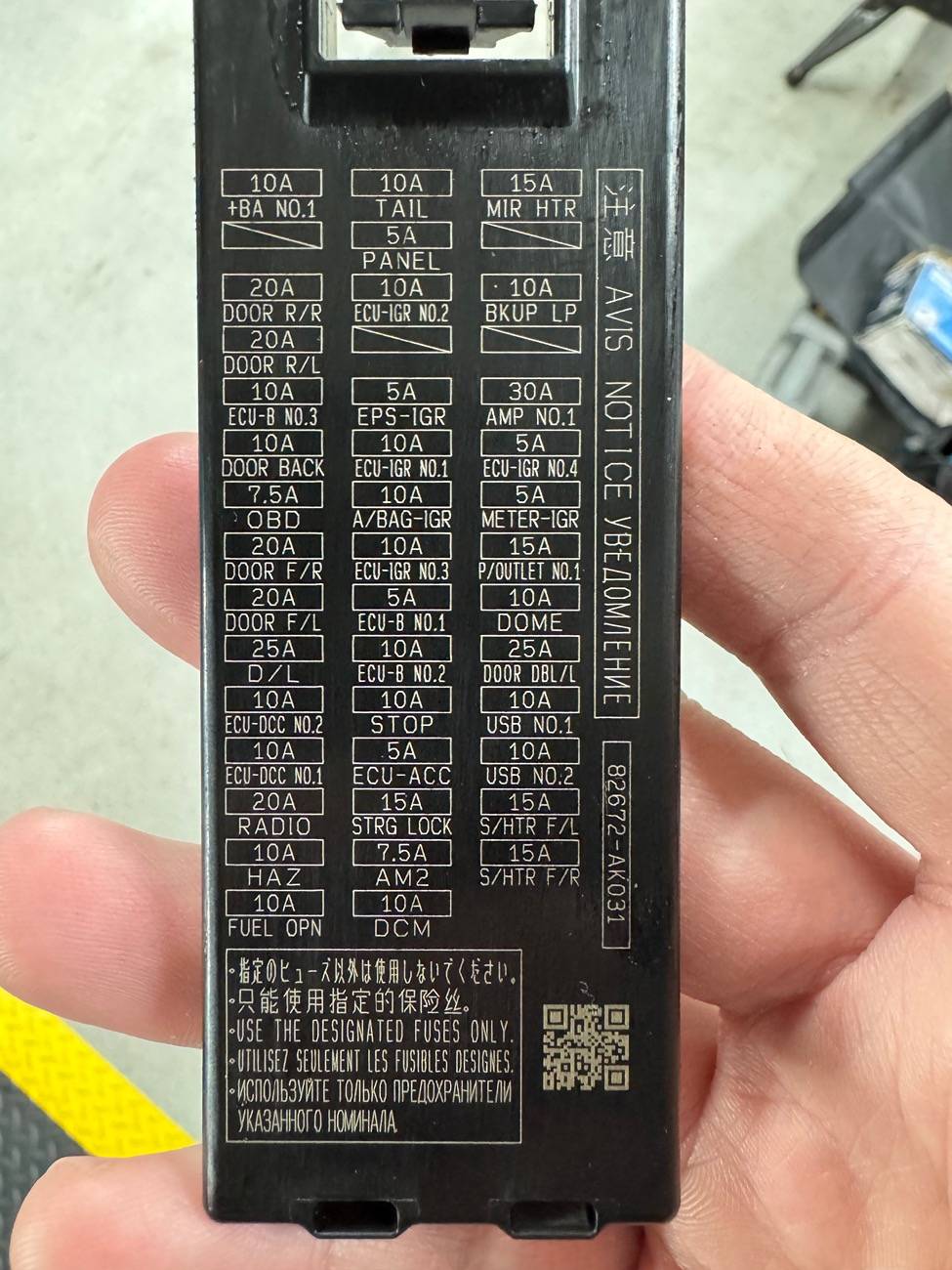

2024 Tacoma Disable Wireless Charger 3-IMG_20240729_094438965

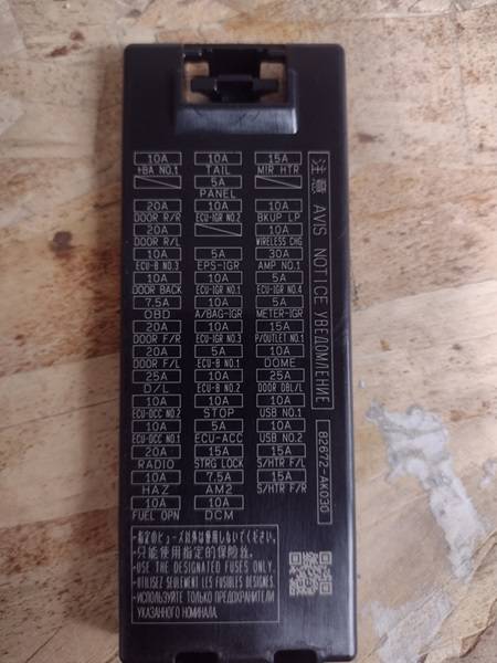

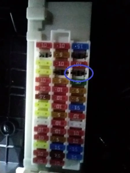

4th fuse position down on the right.

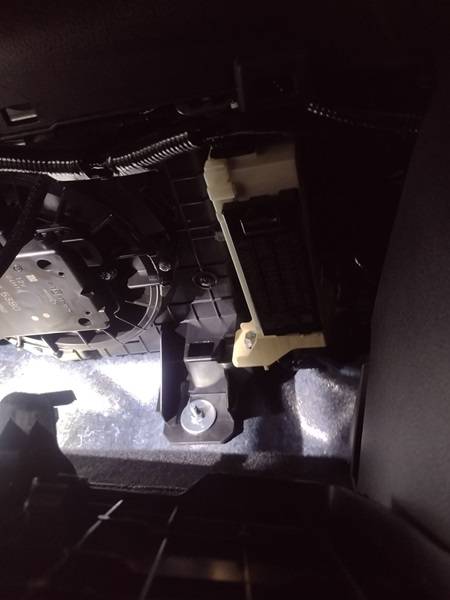

2024 Tacoma Disable Wireless Charger 4-IMG_20240729_094037563

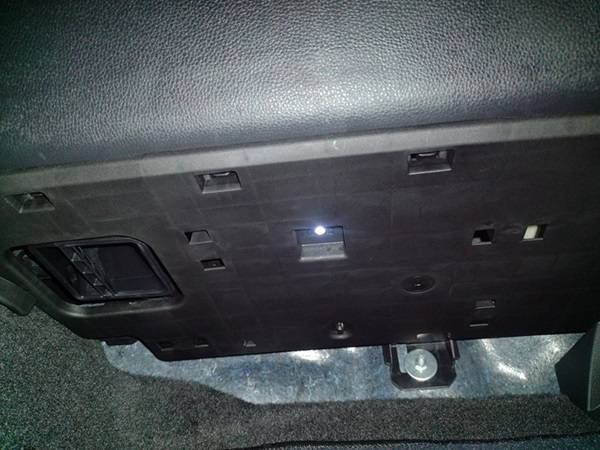

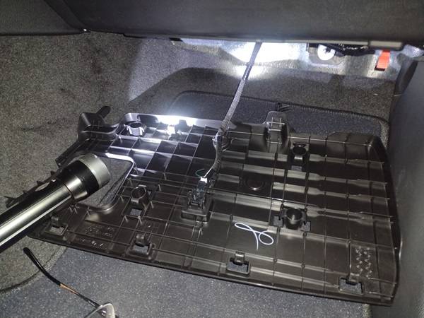

2024 Tacoma Disable Wireless Charger 5-IMG_20240729_093745493

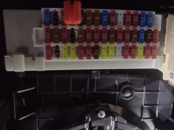

2024 Tacoma Disable Wireless Charger 6-IMG_20240729_094100840_HDR

Trick to getting the panel back on is getting the back pins into the square holes.
