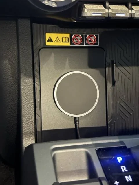

Got a much better MagSafe charger installed using two other posts to disable the OEM charging mat. This holds the phone higher and flat providing a perfect gap for the camera + case bezel:
2024 Tacoma Wireless charging pad disabled, MagSafe Charger installed 1741203319320-vk
Panel removal:
https://www.tacoma4g.com/forum/threads/disable-wireless-charger.5889/post-135027
Charge mat removal (partial/left side only took 30Sec with a pry tool):
https://www.tacoma4g.com/forum/threads/removal-of-panel-around-chargers.4442/post-123120
USB-C MagSafe charger (used 3M tape):
https://www.amazon.ca/dp/B09NRG9HCK?ref=ppx_yo2ov_dt_b_fed_asin_title&th=1

Thanks, I had no idea;) Jokes aside, I needed a solution that charges my phone as opposed to cooking it.
OEM Wireless charge mat:
My phone overheats and barely charges. Perhaps it's my phone's size [15 Pro, non Max], my MagSafe case and/or both however I don't experience poor [and worrisome] performance like this with any other wireless charge mat.
Replacement MagSafe charger:
Phone charges at a decent rate, doesn't over heat

I suspected position/size and case may be contributing.. sits low [smaller phone] large gap behind a MagSafe case with rare earth magnets to boot.. regardless, wasn't good.

I would be weary of placing MagSafe on top of the OEM wireless charging pad.. Looks to be a simple fuse for non-hybrid, unfortunately pry tool for hybrid.
If you have a hybrid and don't want to disable the wireless charge matt I would suggest placement to the right or else a thin metal plate between the MagSafe and the OEM pad.. EDIT: but plenty of room to the right!
