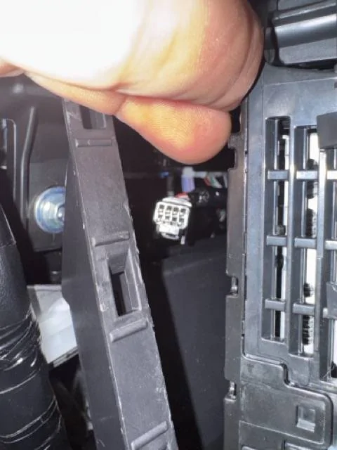

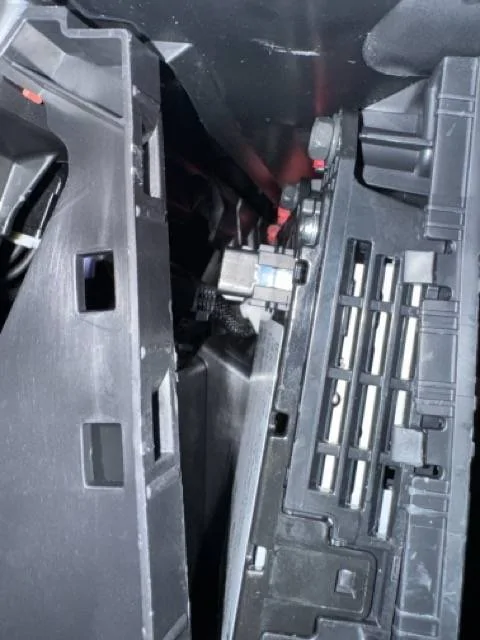

Just a quick note - the panel with the wireless charge pad is retained by clips and can be pulled forward for easy access to the connector eliminating the requirement for a long screw driver:
I suspect this connector could be repurposed as another/internal USB charge port but I don't have time to verify;)

I did try a little to pop that out but it wasnt making me feel great so i used the long screwdriver to pop off the harness instead BUT I was wondering how I would get it back on if I ever needed ??

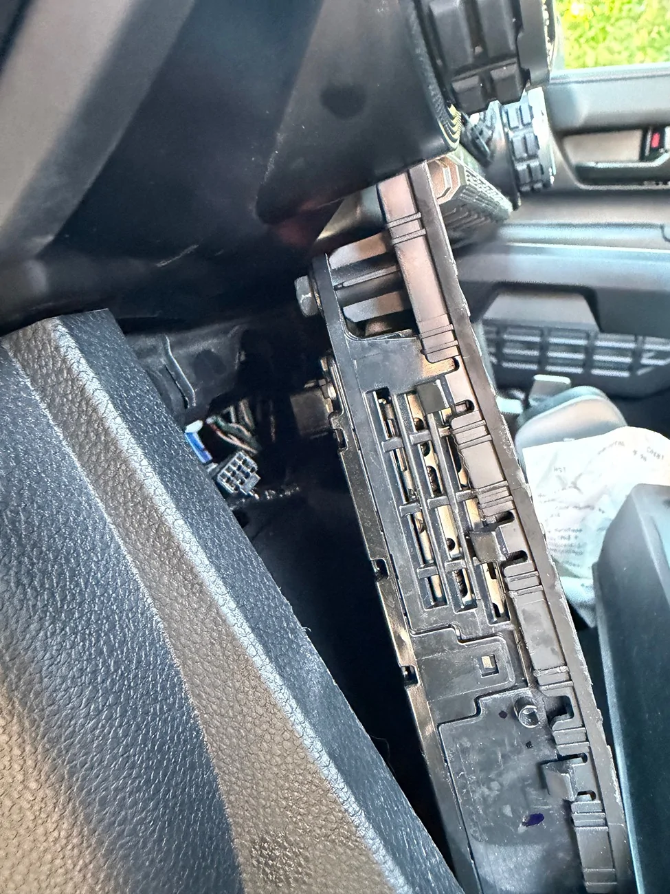

Agreed.. I was not comfortable pulling the whole thing out - felt pretty settled/stuck to the right side where there's no removable panel to get at the retaining clips

I decided to give this another shot and I have everything apart and have no goddamn clue how you got that out!! It just does not actually come out I don't get how you did it

Just did it myself worked like a charm, connector is still impossible without pliers if you have big hands
