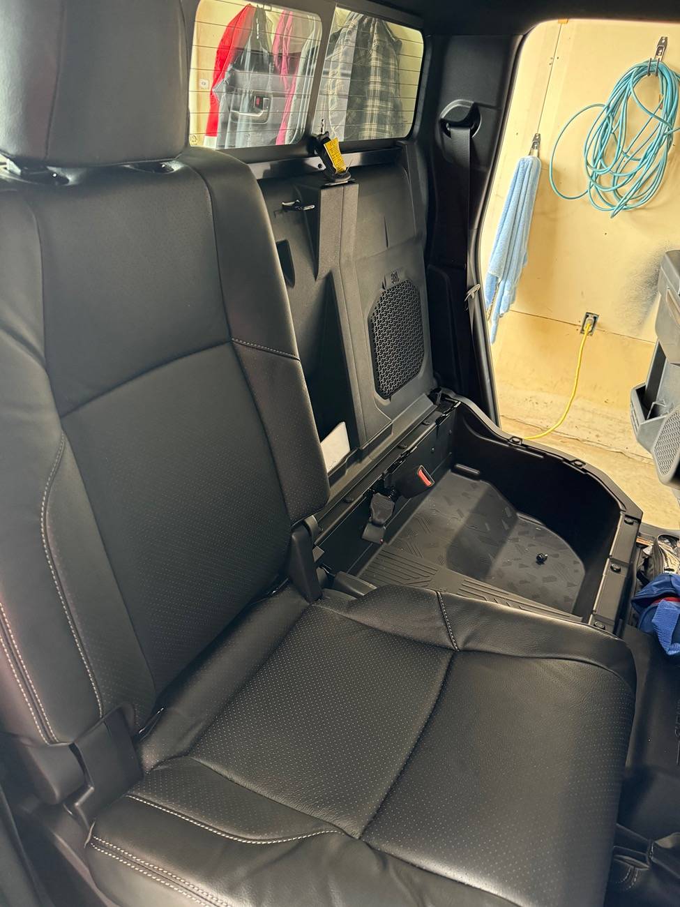

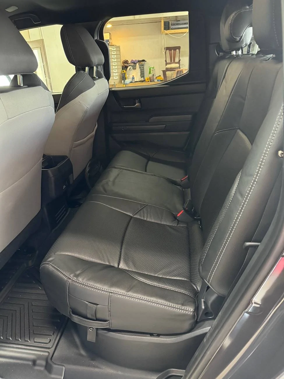

Not a project I was looking forward too! Took me 6 hrs just for the rear seats. Forearms are smoked! An extra set of hands is recommended!

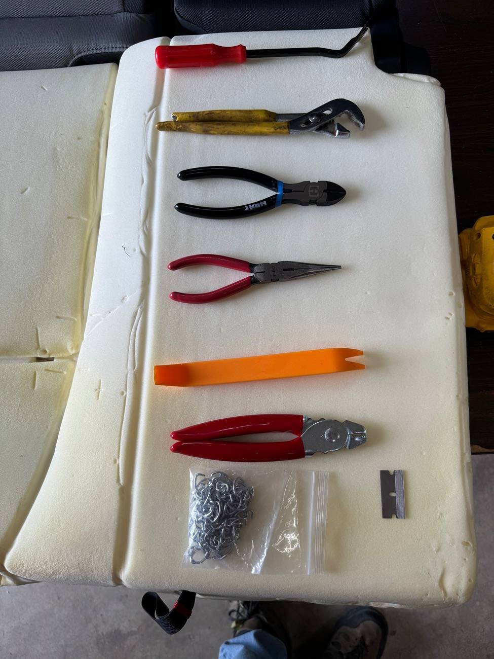

I pulled the rear seats out, 2 bolts for the 40, 2 bolts for the 60, pull the backrest release strap and they pop right out. Super simple and lightweight. Pulled off one cover at a time then replaced it with the Katzkin. It’s slow going and requires a fair amount of strength when clipping the old hog rings and getting the new ones on correctly. There are small slits for the rear seat fold down straps and the fold up locking snaps. The only thing I had to cut was small slits next to the plastic rod where the hog rings go through and the headrest holes, came out nice but was a little anxious cutting brand new seats!
Headrest cover are the most difficult to get off and just as hard to get the new ones on! I pulled too hard in the wrong spot and ended up with a small tear in the center headrest..? a needle and black thread and nobody will know but me! so be careful!!
Edit
One trick I learned, the headrest are a nightmare! I went to Walmart bought some fresh fruit, took the bags and slipped them over the stripped headrests, plugged one side of the headrest shaft with electrical tape and placed a vacuum hose on the other side it sucked the foam to about 1/2 the normal size then slipped the Katzkin cover on in about 30 seconds!
Also be careful when zipping the back of the covers the zippers seem to be decent quality but they are nylon/plastic zippers don’t force them!

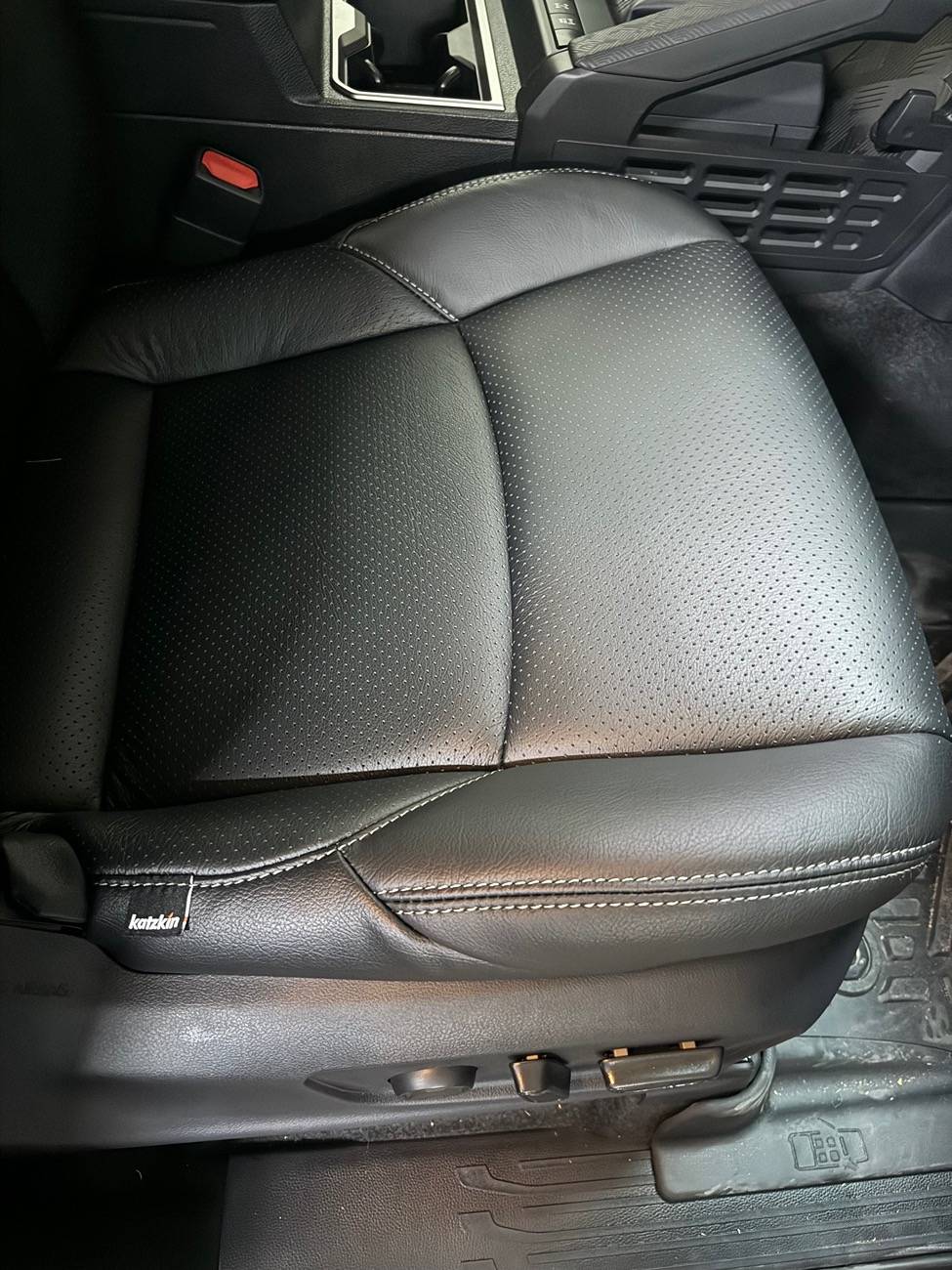

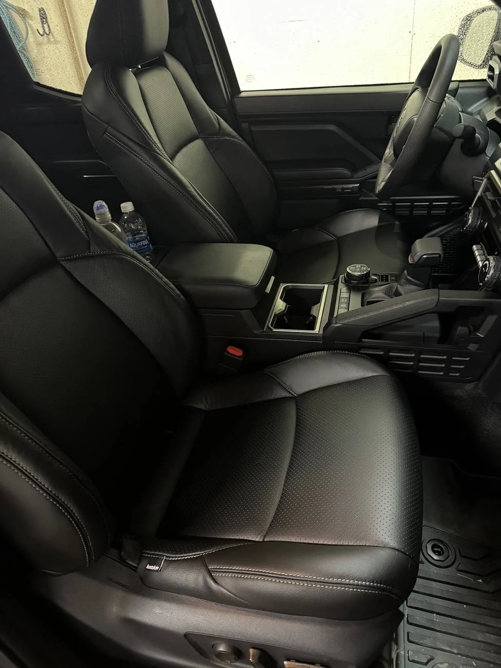

Finished the Katzkins! 7 hours for the front seats! Total time was around 13 hours.
You’ll need a T45 to remove the seats, and be sure to disconnect the negative battery terminal just to be safe! You don’t want an airbag going off.
I would have documented everything involved but it’s just too much.. Probably would have added 2+ hours? But I’m confident this is a project anyone with basic mechanical skills and a little common sense can do.
Well worth the time, saved about $8-900.
I think the quality is far better than OEM SofTex and looks better. Bonus… Fresh leather smells sooo nice!
