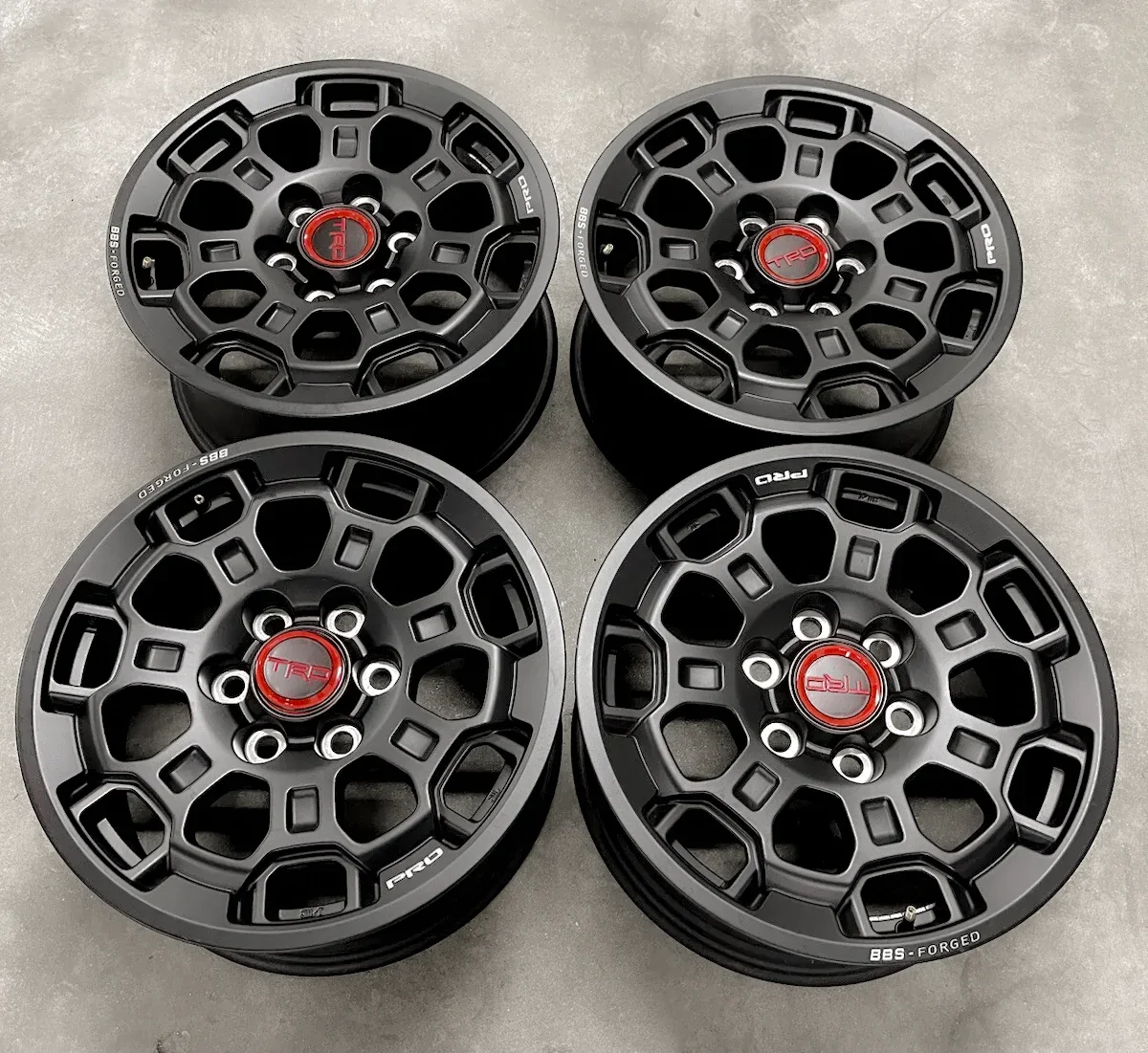

And yeah, from my own research it’s not just tire weight that matters. It’s the combo of tire weight, rolling resistance from the tread and sidewall squish, tire size (diameter matters more than width, but both play a role), and wheel weight.
I know my new wheels are wider, but they’re also lighter than the OEM wheels, so I’m clawing some of that rotating mass back.
By going from 265/70R18 to 285/65R18, I’m not really changing tire diameter, just increasing tire width by about 0.8 inches, and increasing wheel width by 0.5 inches with the BBS. Yes, the tires will be heavier too, but this truck was never meant to be a commuter anyway.

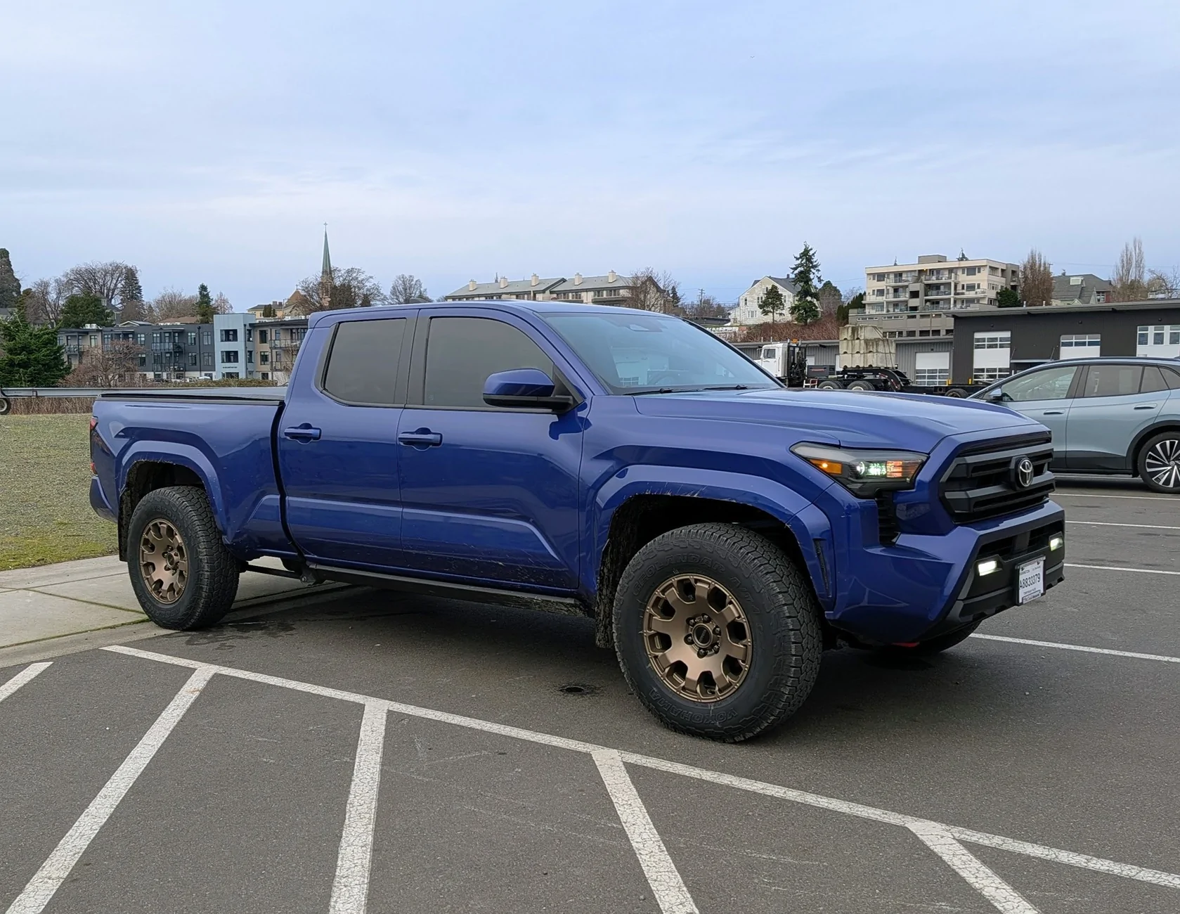

Mate, your truck was part of the inspo and why I went on the hunt for the wheels in the first place! Love how your set up looks. Spent a lot of time in your threads.
You went E load with the 265/70 if I recall correct? You think I could go 285/65 (and keep it SL) no issues?
Yes, E load. Since I am seldom on a highway they aren’t an issue for me. If I was doing long distance driving, I would probably be running a softer, lighter tire.
You should not have issues with that size tire. Other members here are running them with the same wheels. @ronlee has them on his truck.
