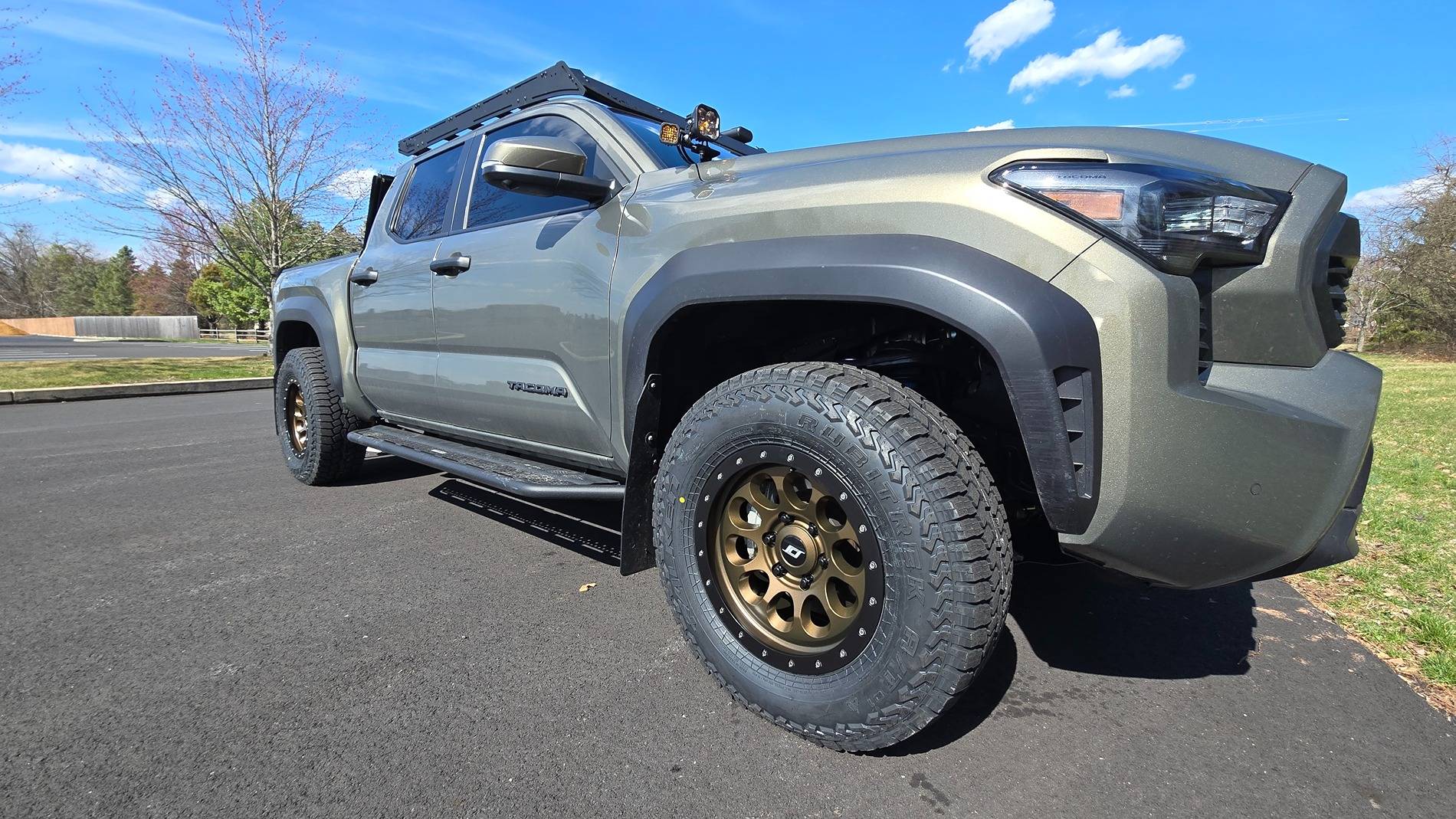

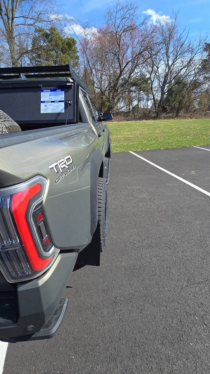

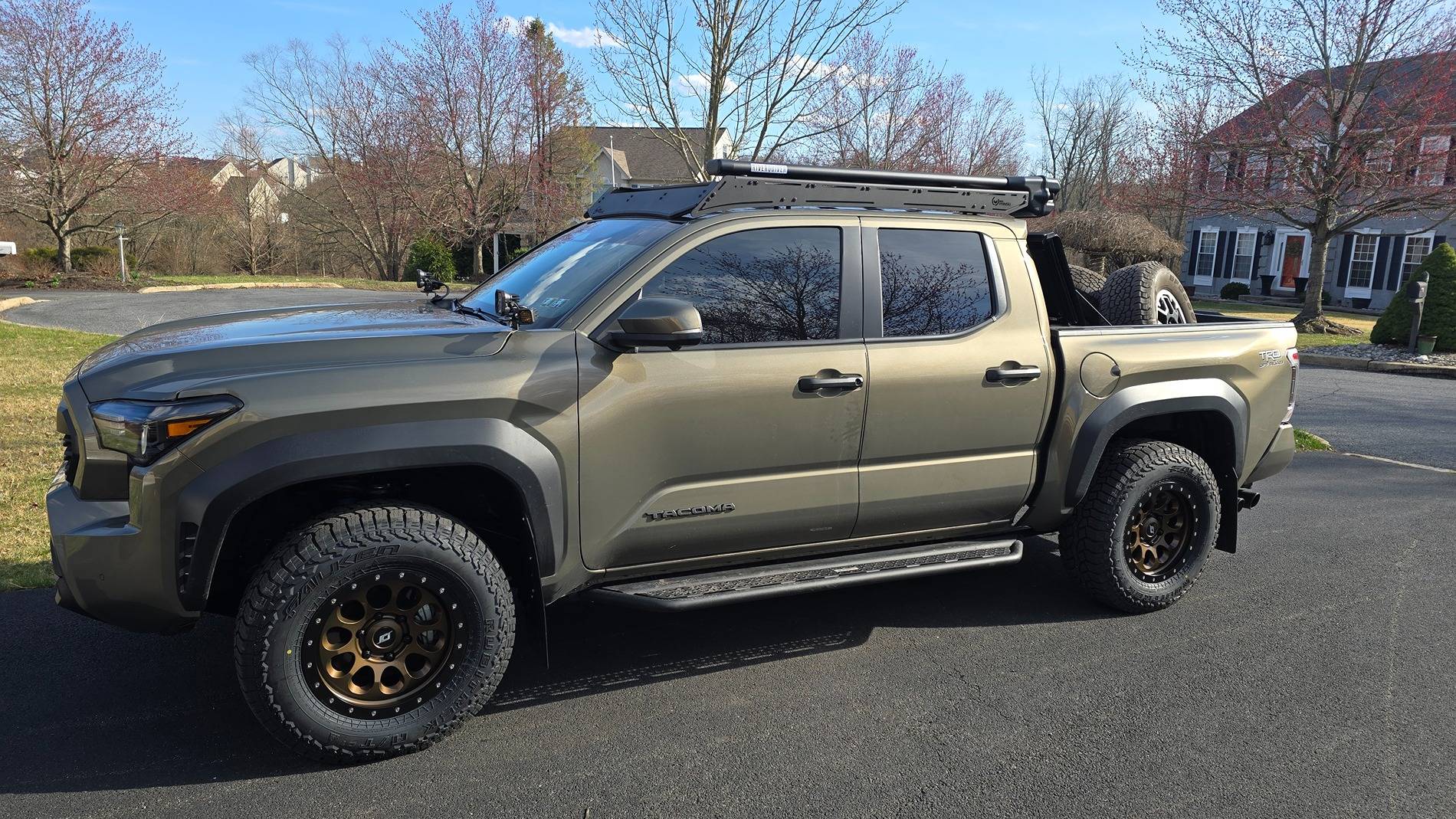

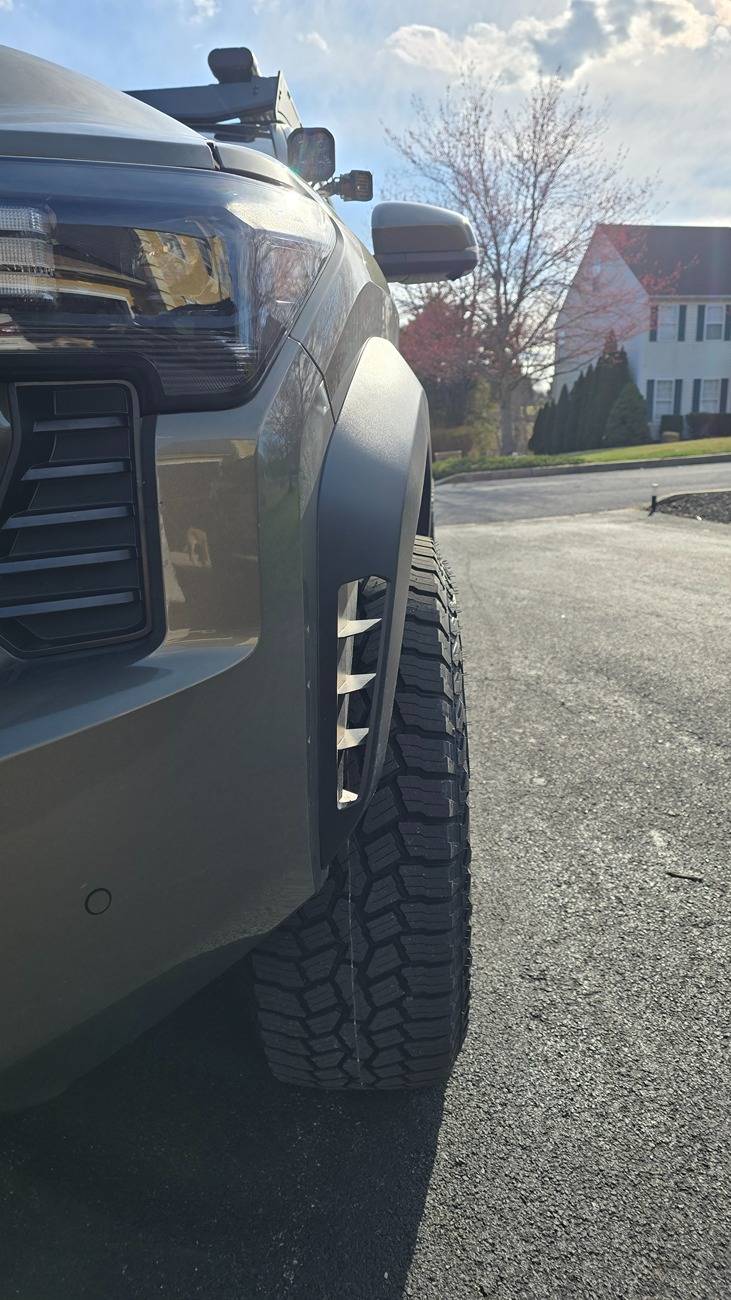

That good looking stock setup! </Sarcasm>
2024 Tacoma Major vibrations at 65+ after changing wheels and tires 1000014821
2024 Tacoma Major vibrations at 65+ after changing wheels and tires 1000014829
2024 Tacoma Major vibrations at 65+ after changing wheels and tires 1000014832
2024 Tacoma Major vibrations at 65+ after changing wheels and tires 1000014824
