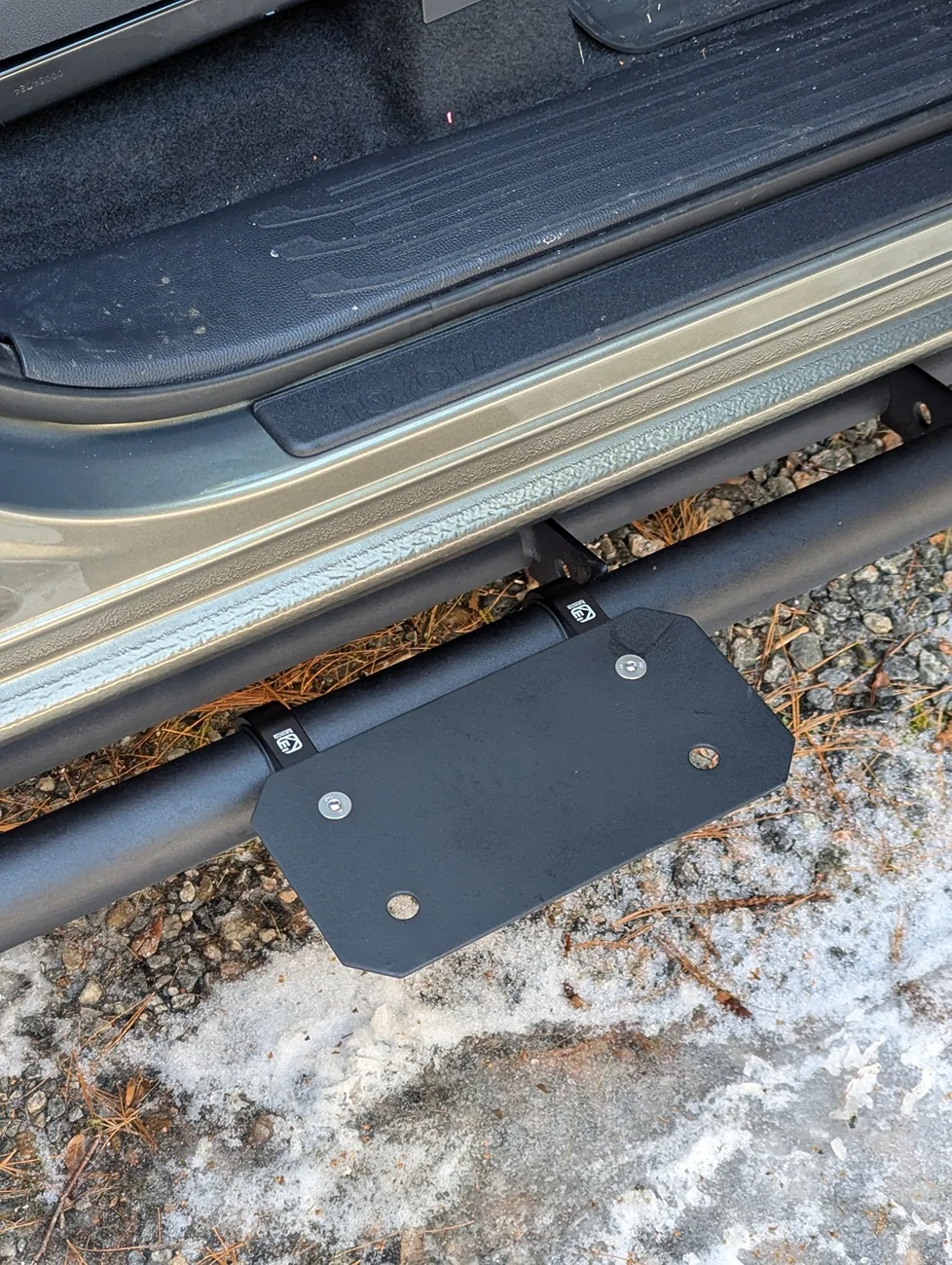

2024 Tacoma EASY DIY Side Steps for ANY Tube Style Rock Rails - Executed on 2025 Tacoma Trailhunter 1766107861759-00

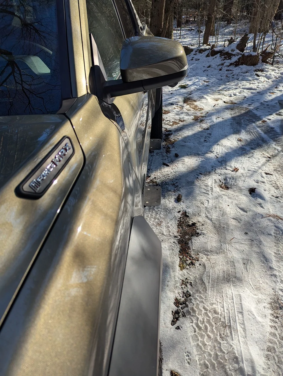

Finished, mostly:
2024 Tacoma EASY DIY Side Steps for ANY Tube Style Rock Rails - Executed on 2025 Tacoma Trailhunter 1766109398097-kv

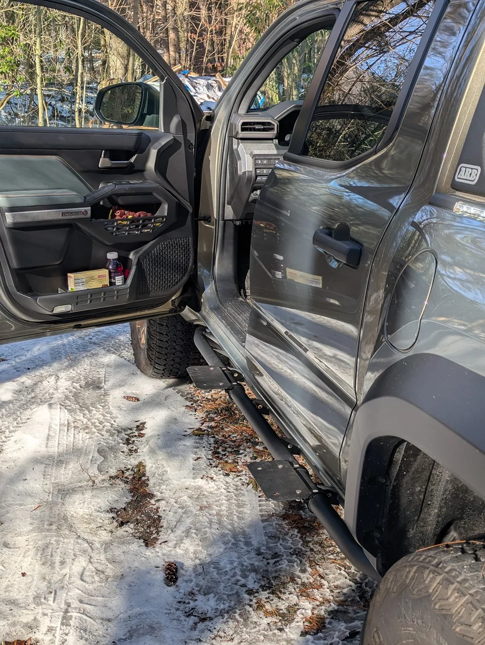

2024 Tacoma EASY DIY Side Steps for ANY Tube Style Rock Rails - Executed on 2025 Tacoma Trailhunter 1766109447768-6

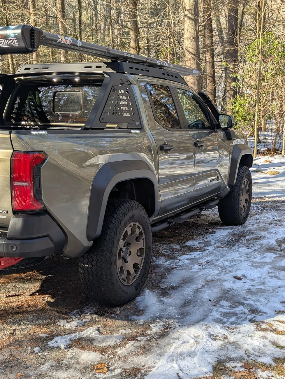

2024 Tacoma EASY DIY Side Steps for ANY Tube Style Rock Rails - Executed on 2025 Tacoma Trailhunter 1766109462602-m3

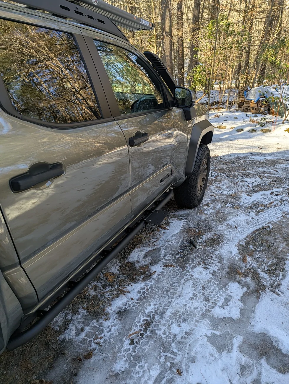

2024 Tacoma EASY DIY Side Steps for ANY Tube Style Rock Rails - Executed on 2025 Tacoma Trailhunter 1766109480319-k1

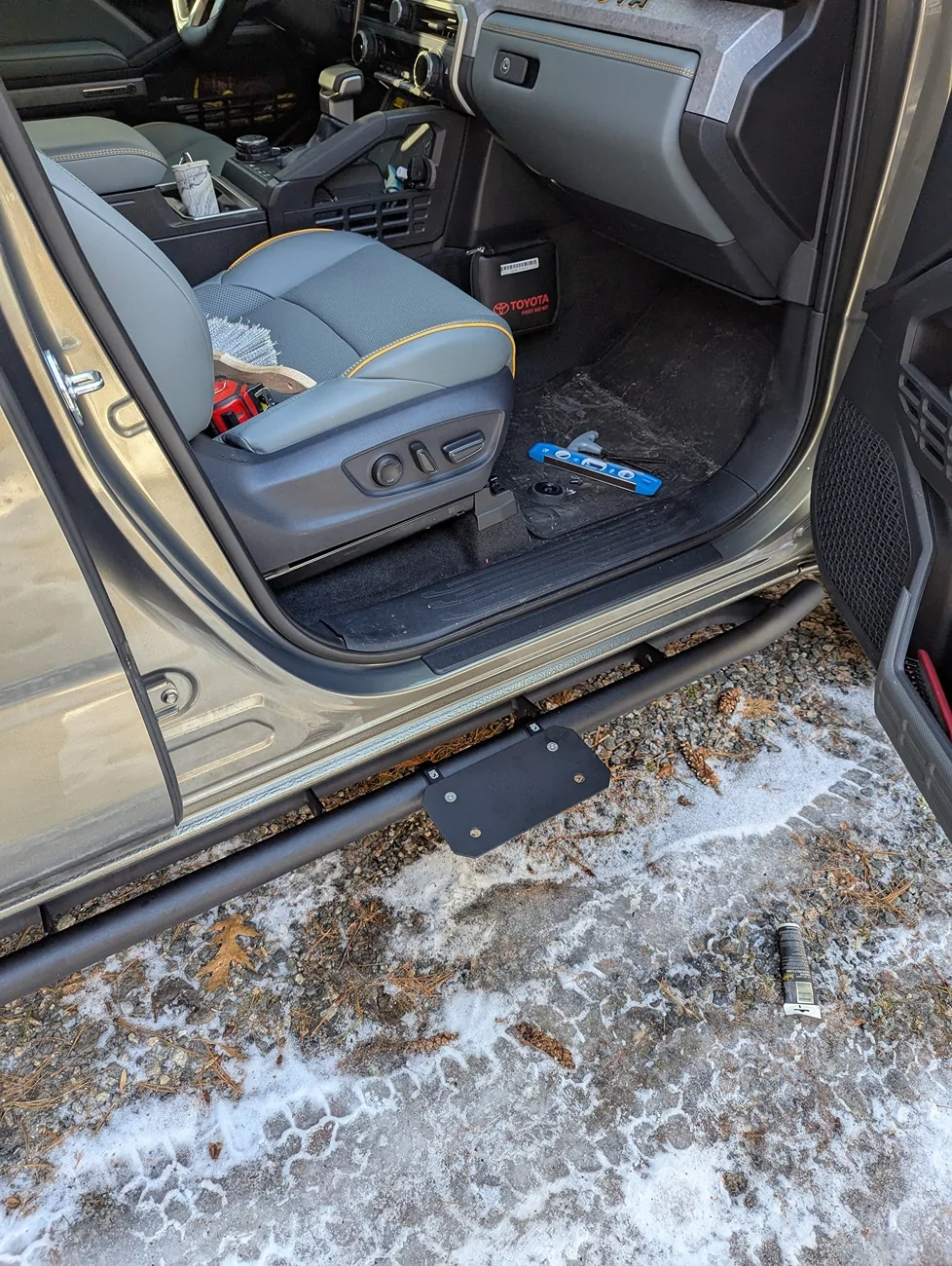

2024 Tacoma EASY DIY Side Steps for ANY Tube Style Rock Rails - Executed on 2025 Tacoma Trailhunter 1766109491546-1x

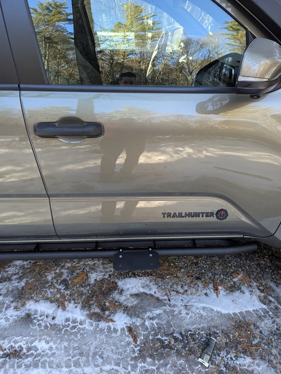

2024 Tacoma EASY DIY Side Steps for ANY Tube Style Rock Rails - Executed on 2025 Tacoma Trailhunter 1766109574644-n
They don't even stick out past the fenders
What do you think? Suggestions? Thoughts? I'm not a huge guy, but they don't even hint at flexing. Solid.
I'd make the step plates out of 1/4" hard anodized aluminum if I were to sell them, but the steel ones here are galvanized, powder coated, bedlinered, and taped, so they should be okay for a while...
