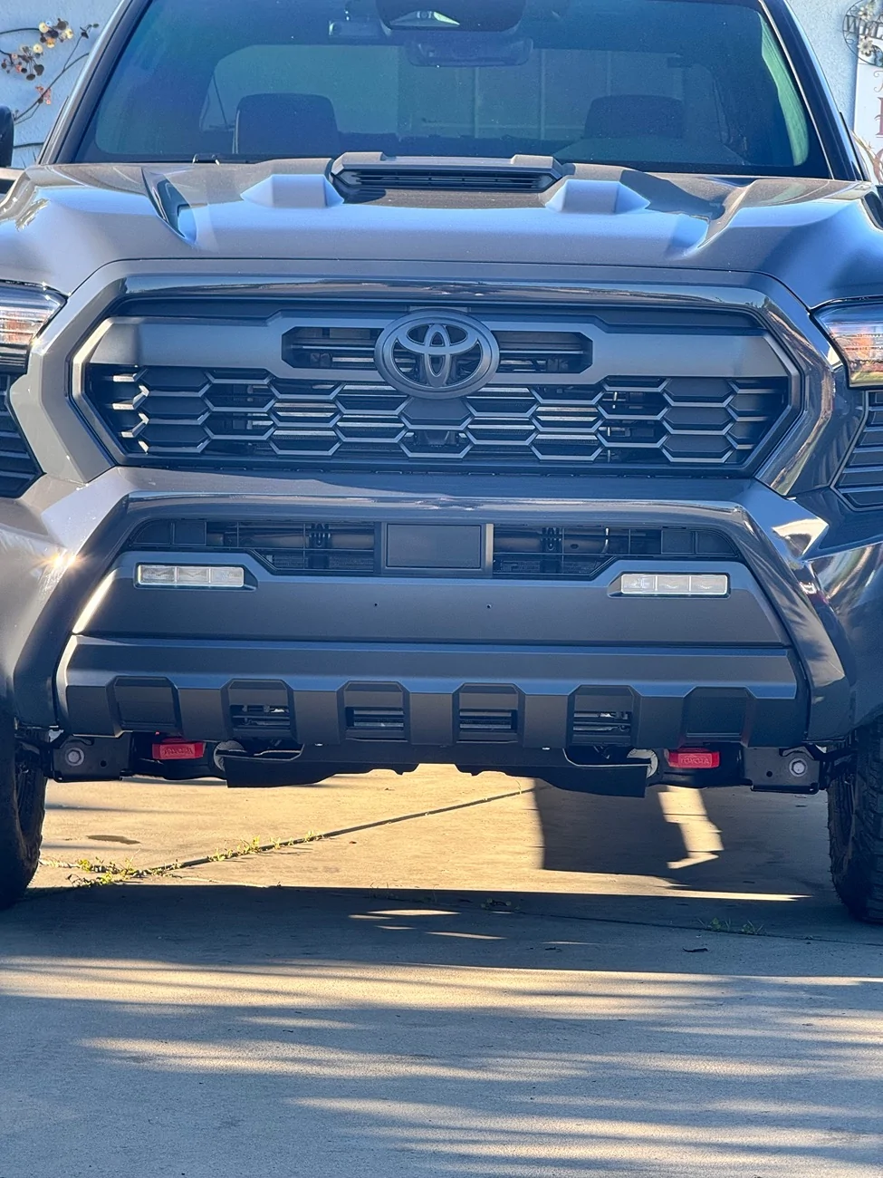

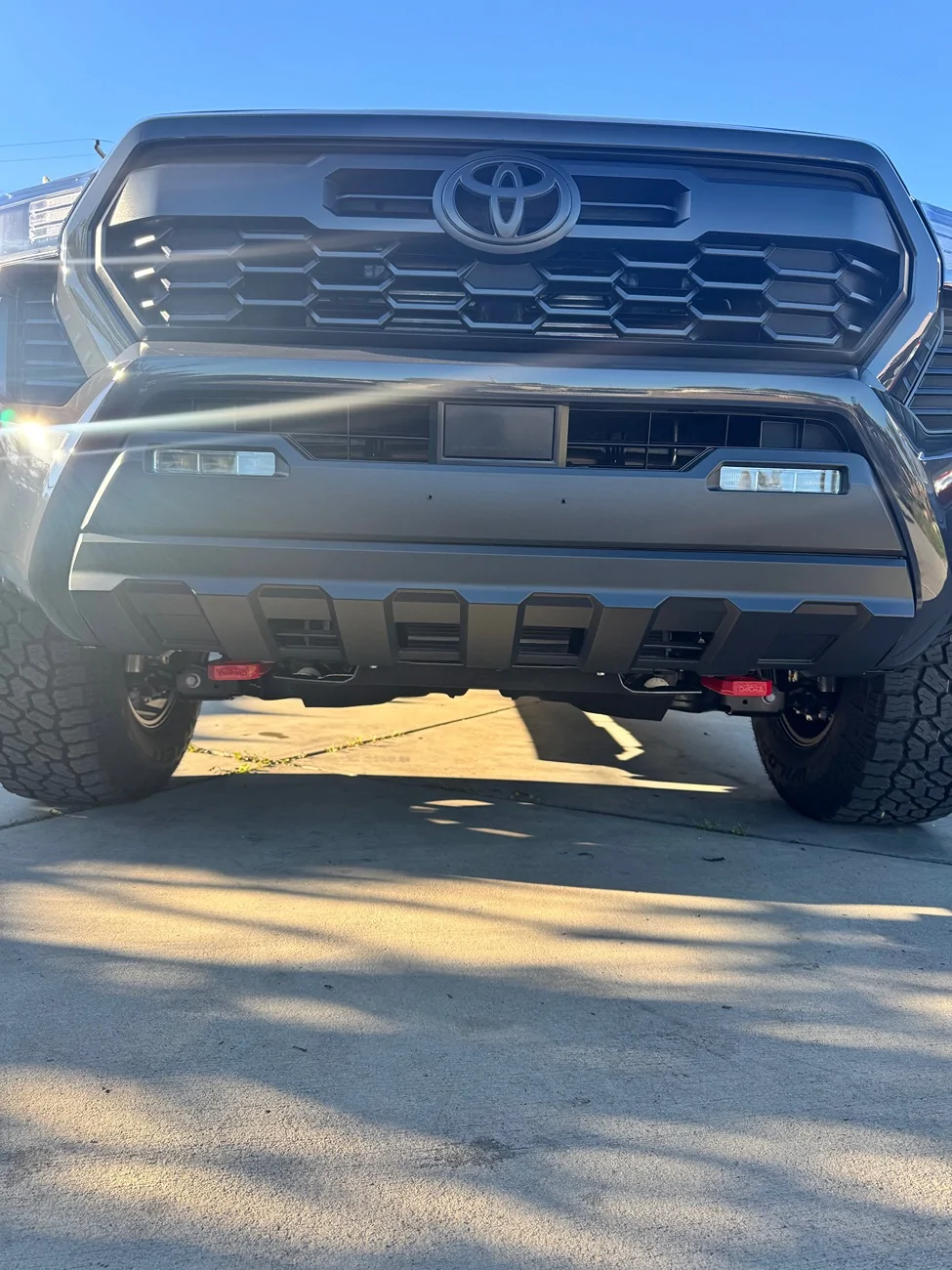

I bought OEM Toyota tow hooks to install my Tacoma. After installing them both successfully and correctly, I noticed the one on the left (pictures included) is a little uneven.
I don't think this is nitpicking because in the pictures it doesn't look as bad, but in person it's totally obvious.
Anybody else have this issue? I already tried uninstalling it and installing it back on. Still uneven.
Worst-case scenario, I'll keep it how it is, but just wondering if it's common or if there's a fix.

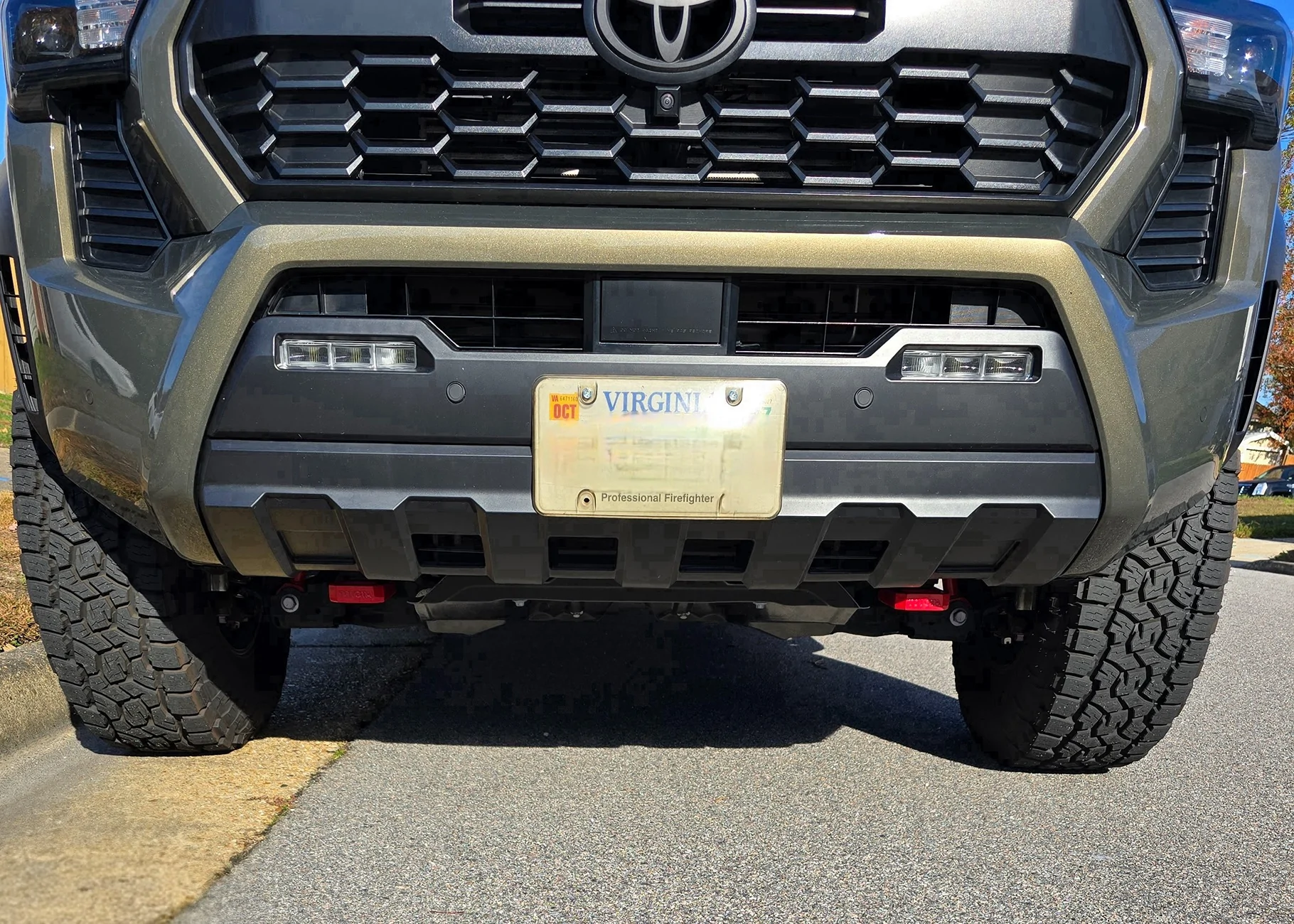

Agree, snaggletooth is a bit off. Not sure if anything can be done.
I don't think it's common. Mine line up fine as far as I can tell.

My truck has the same thing on one of the tow hook mounts. The threaded plate was welded onto the core support a little crooked.
Some square bevel washers would correct it, with equivalent thickness flat washers on the opposite hook to space that one out the same amount. I might do that for mine.

That’s too funny. I just installed rough country recovery and my driver side is exactly the same as yours.
