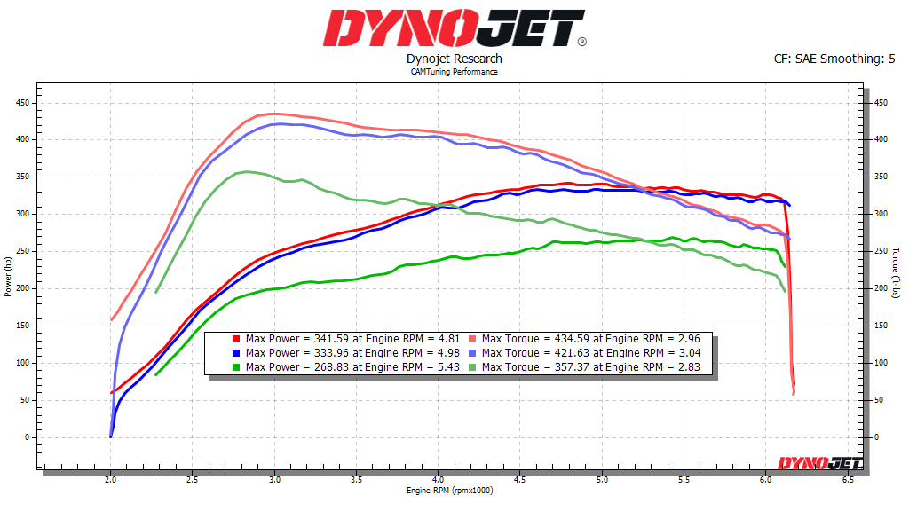

Any dynos showing gains?
He hasn't been on the dyno, as I remote tuned him. I have the same mods (intake, downpipe and intercooler) and have this graph showing gains after the downpipe install. It picked up power everywhere without any tuning updates. I am certain if I pushed on it a little more it would gain more.
Green was the stock truck, 4th gear, 91
Blue was tuned with intercooler, intake, stock downpipe on 91
Red was just after swapping the downpipe (did this on the dyno)
2024 Tacoma FAF High-Flow catted downpipe tuned by CAMTuning downpipe vs stock vs stockdownpipe
