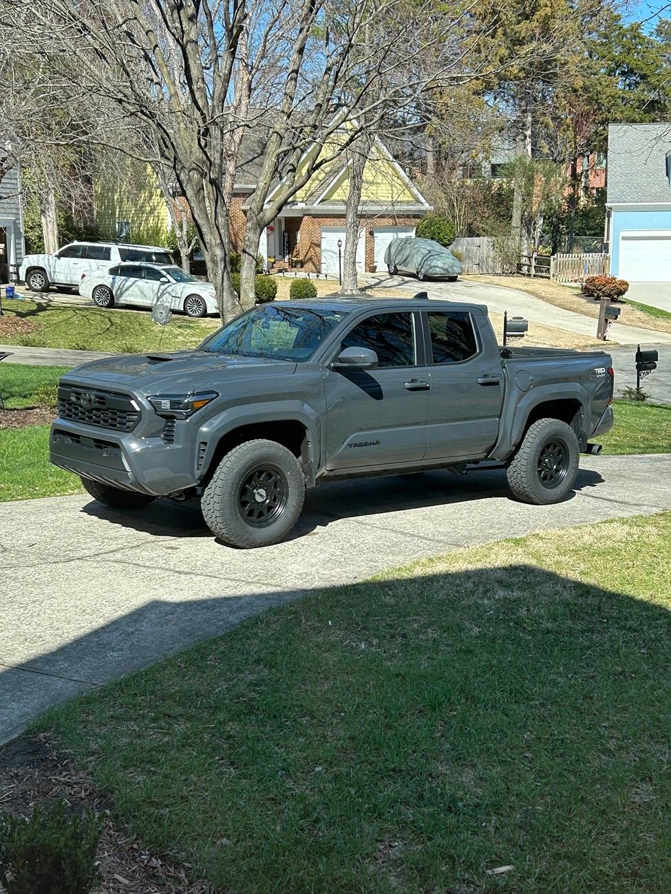

I’m strongly considering buying these for my 24 TRD OR. I’m not really a wheel guy so wanted to ping you guys to make sure these will fit properly. I know the 6x139 is the right bolt pattern, but not sure if 6x5.5 is interchangeable and also wondering about size up considerations and 0 offset.
Method 316 Race Wheel - 4 Wheels. Aluminum Matte Black 18 inch diameter by 9 inches wide 6 lug (6x139.7 or 6x5.5) and 0 Offset.
Thoughts? Would you go with this wheel setup?

I ended up calling method and a few other places for fitment conversations. Turns out they are 18 offset, so will be poke poke.

If they are +18 offset, they will have less "poke" than 0 offset. Stock TRD Off Road wheels have +55 offset. +35 gets you about even with the outside edge of the wheel flare, +25 sticks out just a little, etc.

Right more poke than +25…less than 0. Still kinda aggressive poke…yeah?

It depends on what you like. +25 would be about all that I would want, but it's nowhere near enough for other folks. And too much for others. You just have to look at photos in the build threads, wheel offset threads, etc, and figure out what suits your tastes, wants, and needs the best.

Yeah, all things being equal, I probably would have a + 35 to 25 preference. But with getting the MR316’s with 18 offset for more than half price, I’m going to have to live with whatever + 18 ends up looking like.

I think it'll be fine. I see zero offset trucks on here and they look really good, and +18 is just over 1/4" more sticky outy than +25 wheels. ?
That amount is inconsequential.
