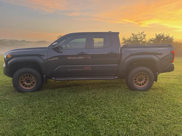

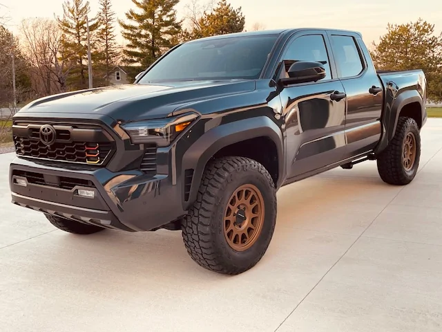

First pic is 285/70/17s on a stock off road., 2nd pic (sunset) is after I installed the all dogs springs. Never any issues with rubbing etc. Have not done anything extreme but very happy with the set up.

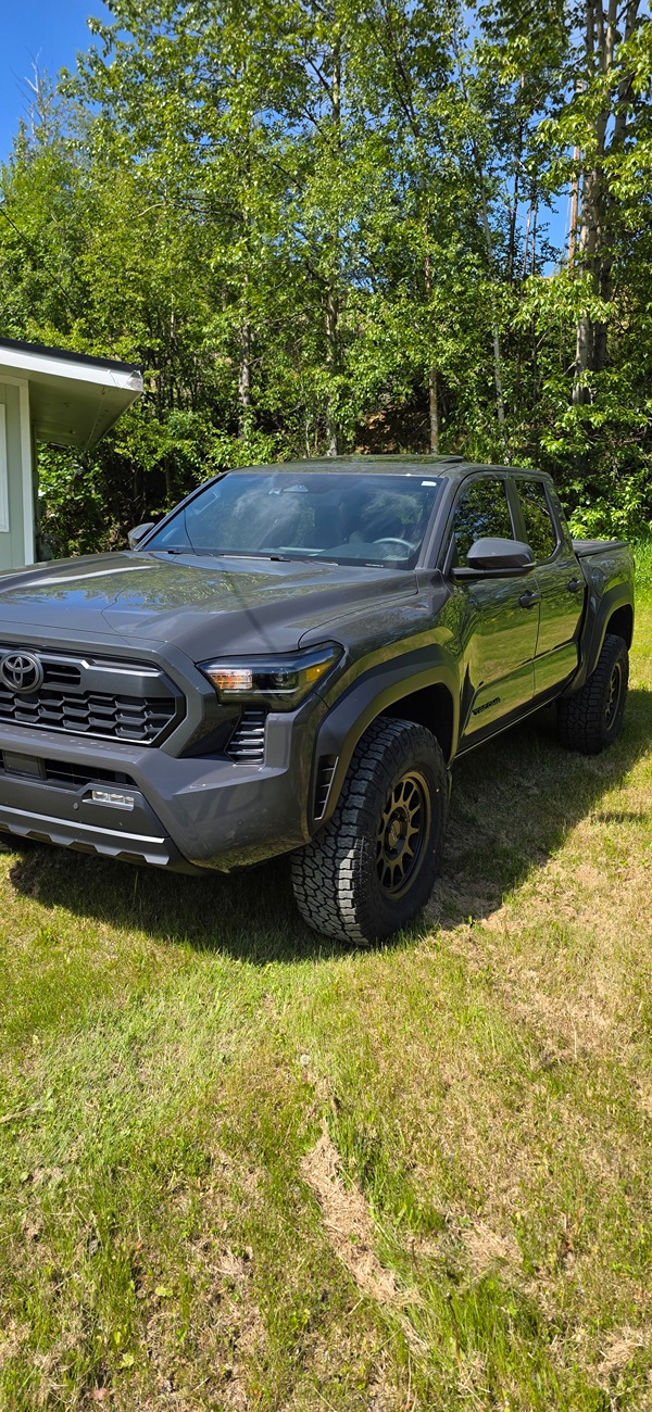

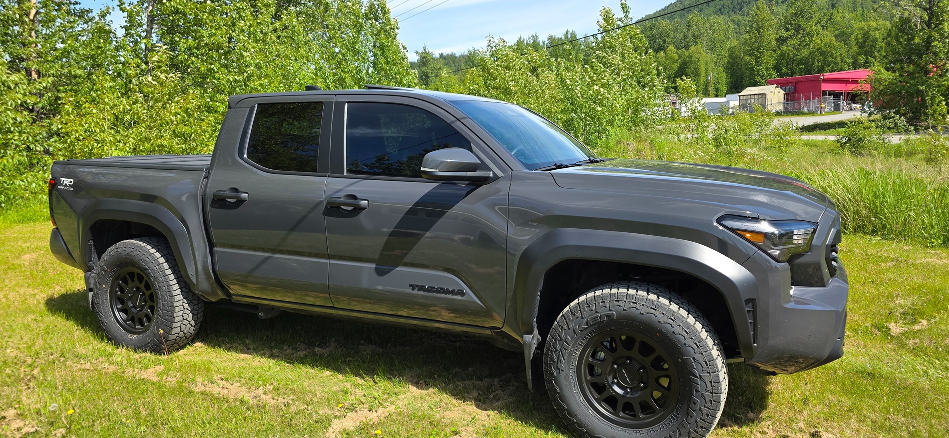

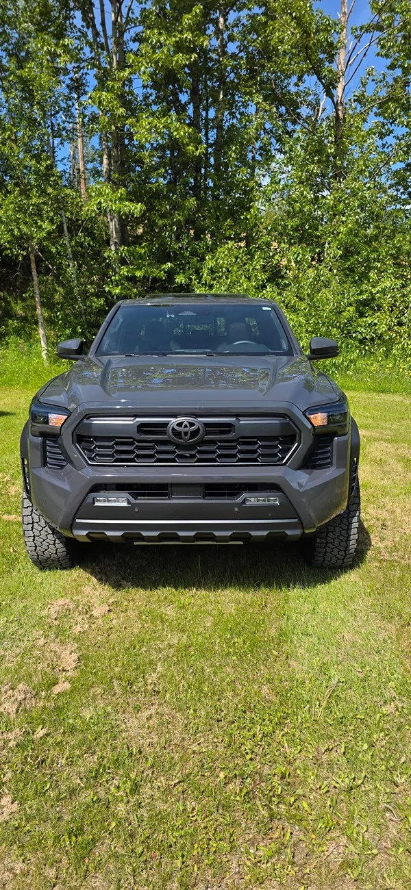

Same setup on stock suspension... Method 703's 285 70 17... Only rubbing was the Canadian mud flaps..
Had to remove and use rokblokz

Crazy, I swapped the little stock mud flats for the Canadian ones and no rubbing at stock height, of course nothing after spring install.
I'm running Falken At4w... Maybe tread pattern? It was the little nubs that stuck out on the front Canadian flaps... Only hit going up driveways and turning at the same time..
But enough for me to swap them

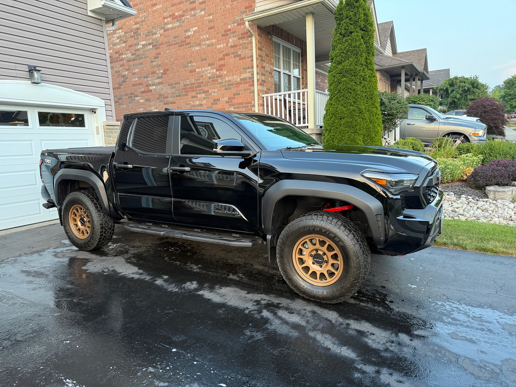

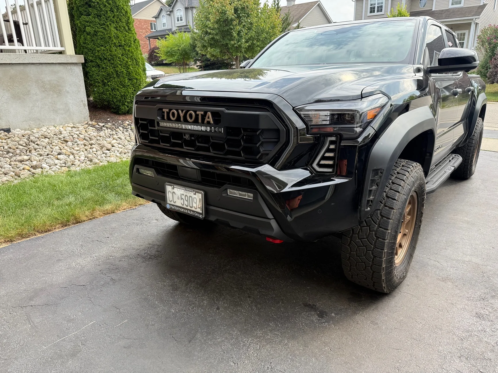

I have the same setup. First pic is right after I installed the front All-Dog leveling springs. Second photo shows height after springs settled. Have had no issues before or after the springs. Tires are Toyo Open Country A/T 3 285/70/17.

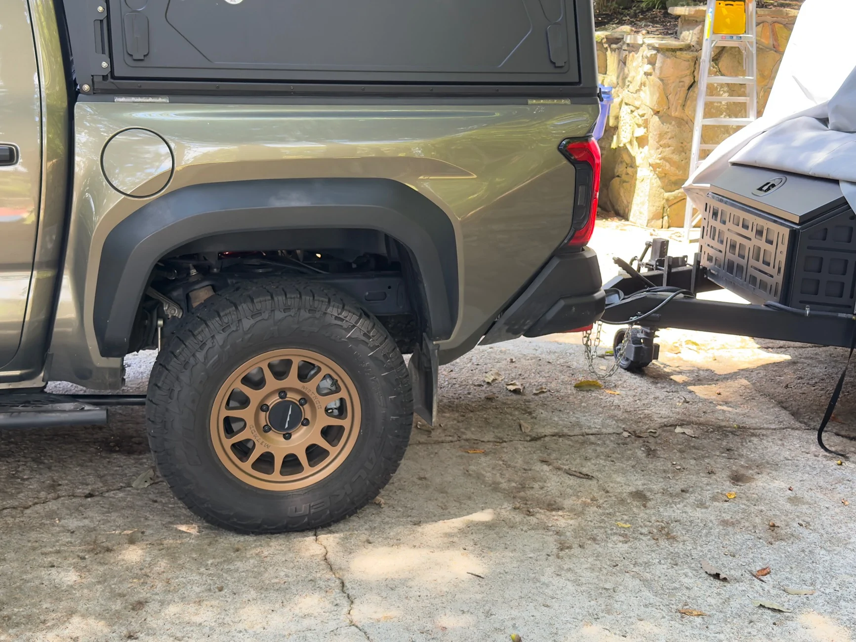

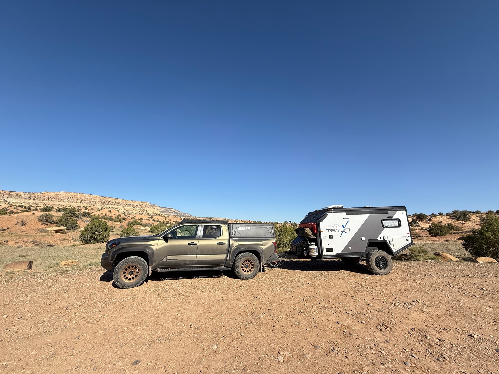

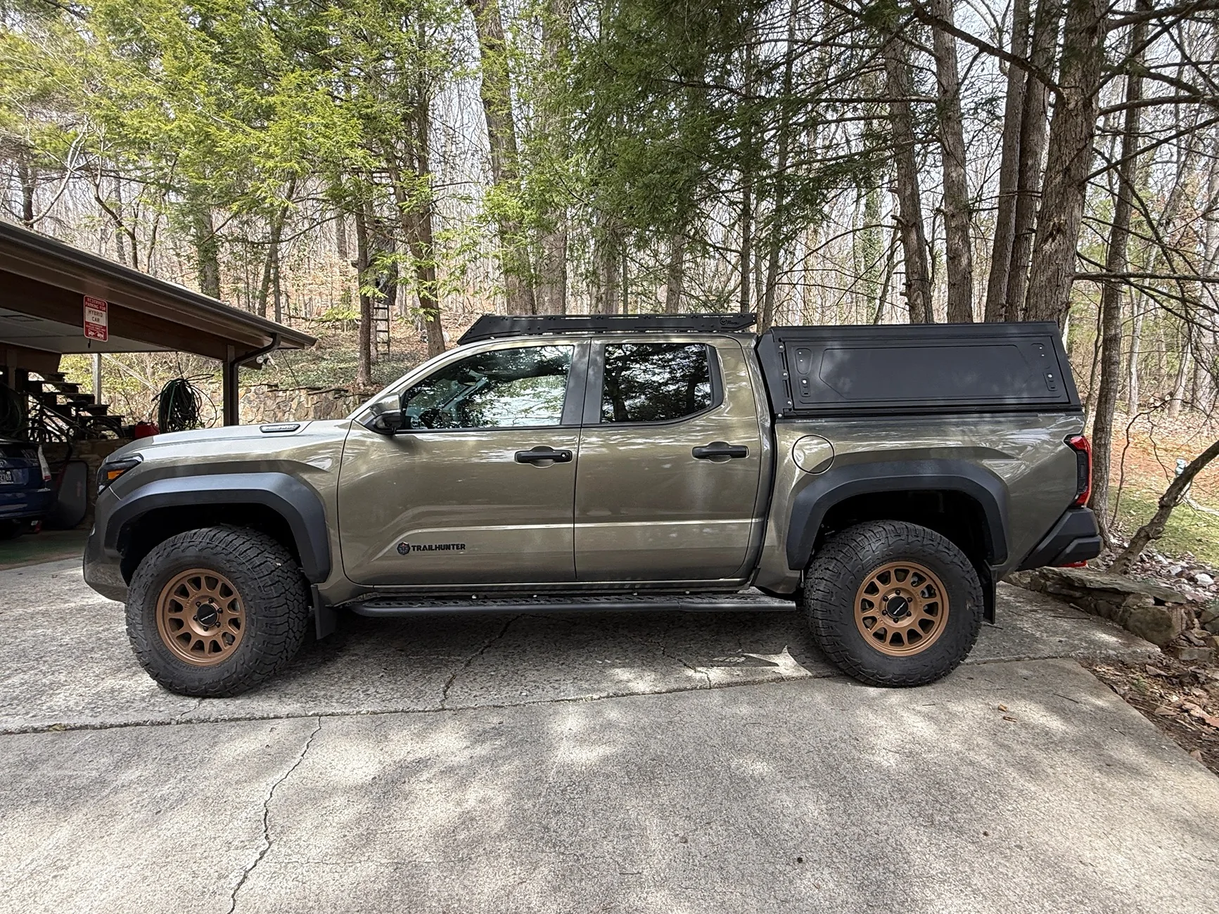

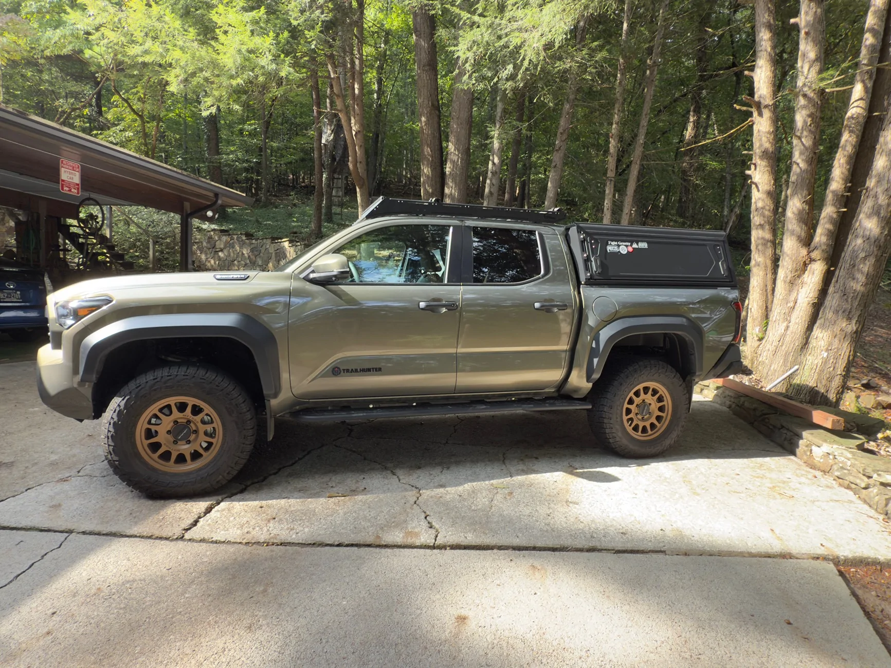

Running same exact setup with Falken ATW4 tire… Original on stock TH with CBI Bumper with winch and AluCab Contour on back.. No problems with rubbing at all.. Just changed to Dobinson Springs because of extreme squat in back while towing TetonX Trailer. now with springs, settles a little (trailer 4000#/ tongue 540) but nothing extreme.
First image is truck loaded with trailer after Dobinsons change.
Second image is truck with new springs.
Third is truck with trailer loaded before spring change.
Fourth is truck with OEM shocks.

nothing done to the front?
Front also got Dobinson springs. C59-822.
rides nice and handles rocks and rough roads well. Just got out of backcountry in Big Bend Ranch SP pulling a 3500 TetonX camper. it was tight in areas and one gnarly 15 degree uphill on loose rock and rock. It was interesting.
