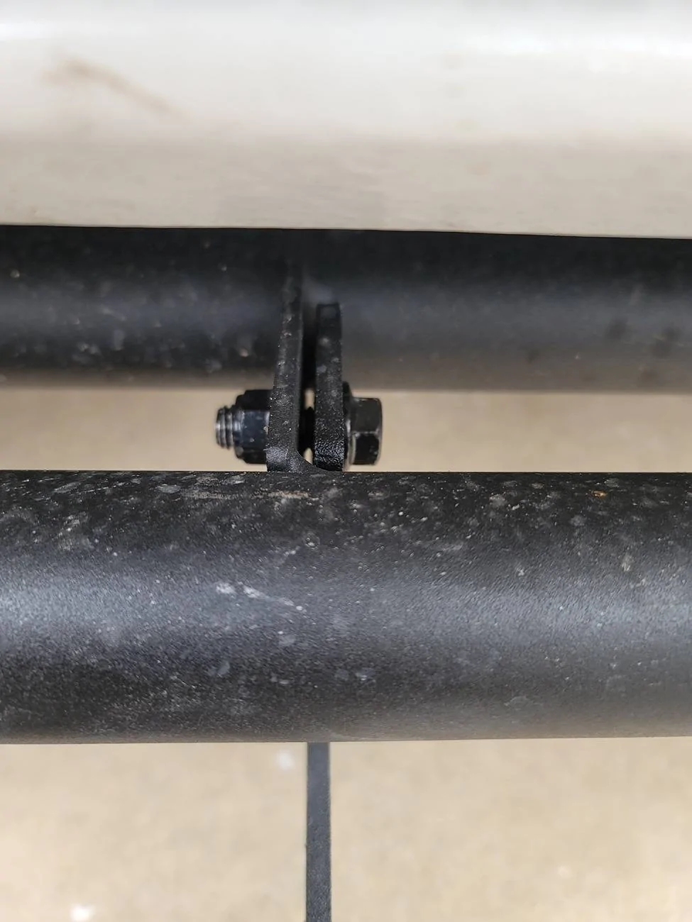

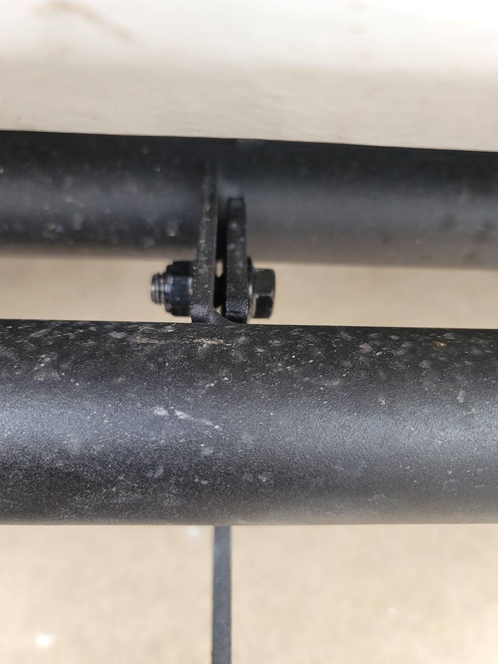

I ordered a set of four of them. They are very solid, and they look great. However, please note that there may be 1/4" of a gap between the step mount and the mount where you bolt them to the OEM Rock Rails (see picture). I have tightened them as much as possible, but there is still a small gap. Regardless of that small gap, they are very sturdy and they do not move around at all.
I would buy them again. They work perfectly. See pix for the small gap when mounting them
Measurements are 9.5" wide x 4.5" deep and the drop down is about 1.5"

Could you mount it to the other side of the slider plate? Looks like it is hitting the welds from the angles/images shared.

I think you are right @Cabby30 - it does appear to be hitting the welds.
The problem is, the distance between the brackets on the step are such that, even when I move it to mount it differently, one side is going to be hitting a weld.
The steps don't fit evenly between the slider plates. One step bracket is on the inside of the slider plate, and the other step bracket is on the outside of the slider plate - no matter which way I move them. I know it sounds confusing, but does that make sense? I've only installed the front two so far. I plan to install the back two this weekend. I'm curious if the measurements between the slider plates on the back is going to be the same. We'll see.
I'm curious if @Chip had the same experience. From what I can see in his photos, I don't see a gap.
Either way, I like them and I would recommend them for purchase.

I do remember there being a gap on mine when installing them, and they went on like you said, one on each side, what i did was wrenched them down tight with my ridgid impact gun. The metal the steps are made of is soft enough that it will bend, just be carful not to strip out the bolts.

You can also put a washer to fill the gap.

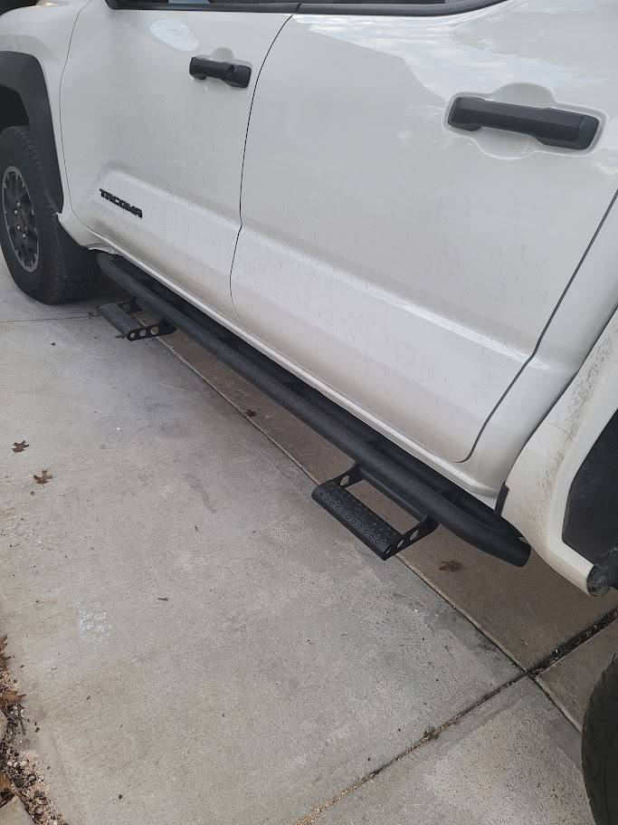

I finally installed the back two steps. I'm happy with them all the way around. They look great and work great.
As I mentioned in my previous post, there is a slight gap between the OEM rock rail bracket and the step bracket for the front steps. However, there is no gap for the steps I mounted on the back steps.
