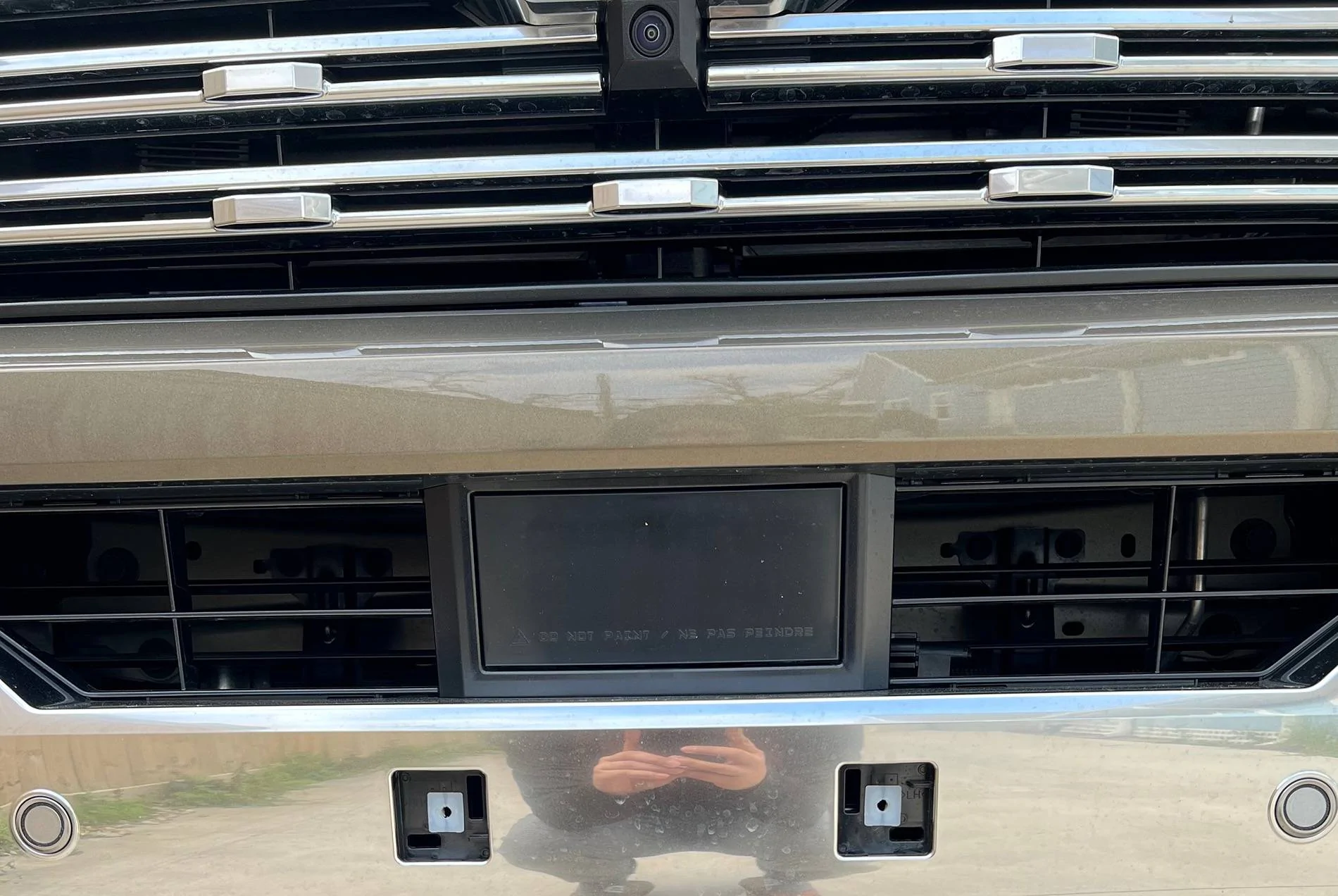

Anybody know the part number if I wanted to order replacements for these or anyone willing to sell theirs for cheap and ship? Texas dealership had a front license plate holder and we don’t use them in AZ. Crappy dealership also unresponsive when I asked for their help.

My dealer also removed them to install a front plate bracket that I didn't need, but fortunately I found the caps in the cab later on. Silly question, but did you check the glovebox, center console, and seat back pocket to make sure they didn't leave them for you? Bummer if they tossed them.

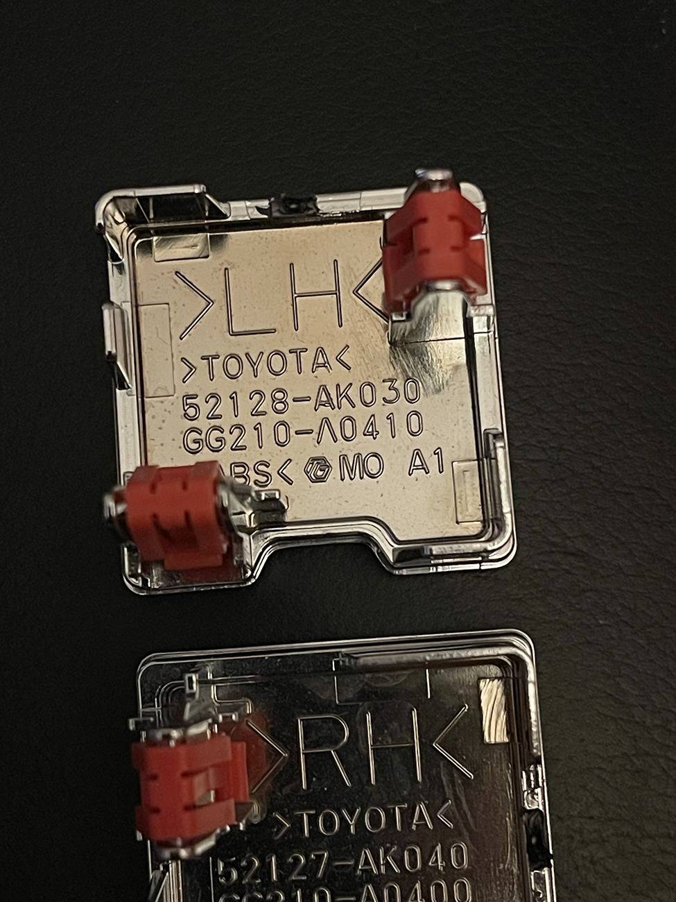

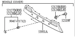

They should have left them with you in the truck, as that is still your vehicle property to have the plugs.
The Limited chrome upper bumper is part: 53931-AK030
The Limited front license holder is part: 75101-AK020
The Chrome upper bumper plugs for the license plate positions are:
LH: 52128-AK030 (the part itself lists a secondary part number of GG210-A0410)
RH: 52127-AK040 (the part itself lists a secondary part number of GG210-A0400)
Looks like they'll run you between $8 & $15 each depending on the dealer/source.

Unfortunately not the case. I checked everywhere I could think of and haven’t found them. Thanks for the suggestion though!
