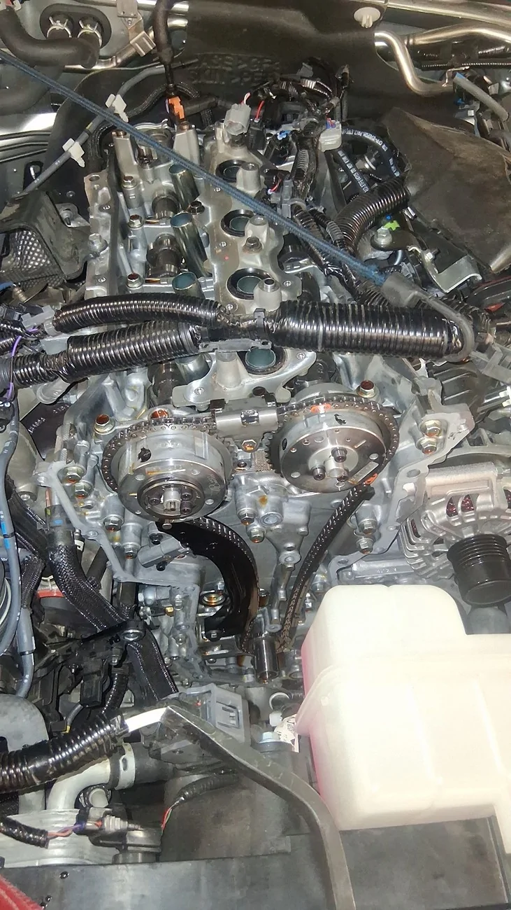

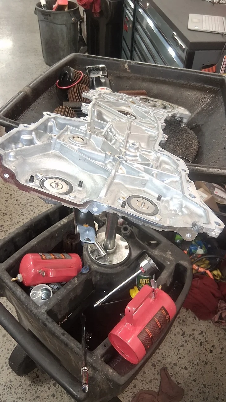

Yes, its fixed. They had to take it apart and reseal it. Apparently, there are two covers. It was leaking around the front cover. Didn't have to replace the coolant but did get an oil change.
As far as the dealer experience, it was good. They gave me a Tundra to drive for the week.

Glad they got you sorted. Also happy to see the motor still in the truck. The list of parts they ordered for mine made me nervous they were trying to pull the motor to do it. Must just be for access purposes they're removing the intake/exhaust Manis. Pretty bummed it's a thing but nice to know I'm not alone haha
