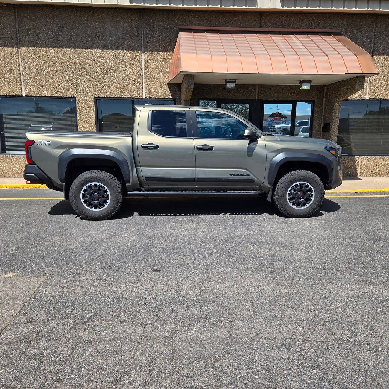

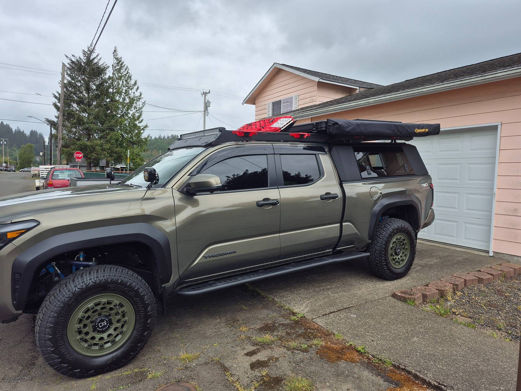

1) poor quality or improperly installed diff drop will cause vibrations. Keep the lift under 2.5 and skip the diff drop. I skipped the diff drop.
2) Needle bearing failure often occurs when lifting over 1 inch, sometimes less. It’s a carry over problem from gen2 and 3. So if your going to tear down to replace or remove the front coil overs plan on getting the ECGS bushing to fix and forget about the problem. DIY was about 2.5 hours for the ECGS bushing.
https://eastcoastgearsupply.com/c-1207180-toyota-clamshell-bushings-2016-and-newer-tacoma.html
I lifted mine 1.5 in the front 1 in the rear (JRi shocks) icon +1 rear springs, factory UCA but will probably get JBA’s because at full drop I only have about 1/4 inch of clearance between the UCA and the shock. Alignment was done.
Ride is far better than factory! Zero problems with the axels, and I’ve certainly tested them🤣

Thanks great start . Good info about the ECGS bushing and the link to them. Also nice looking truck.

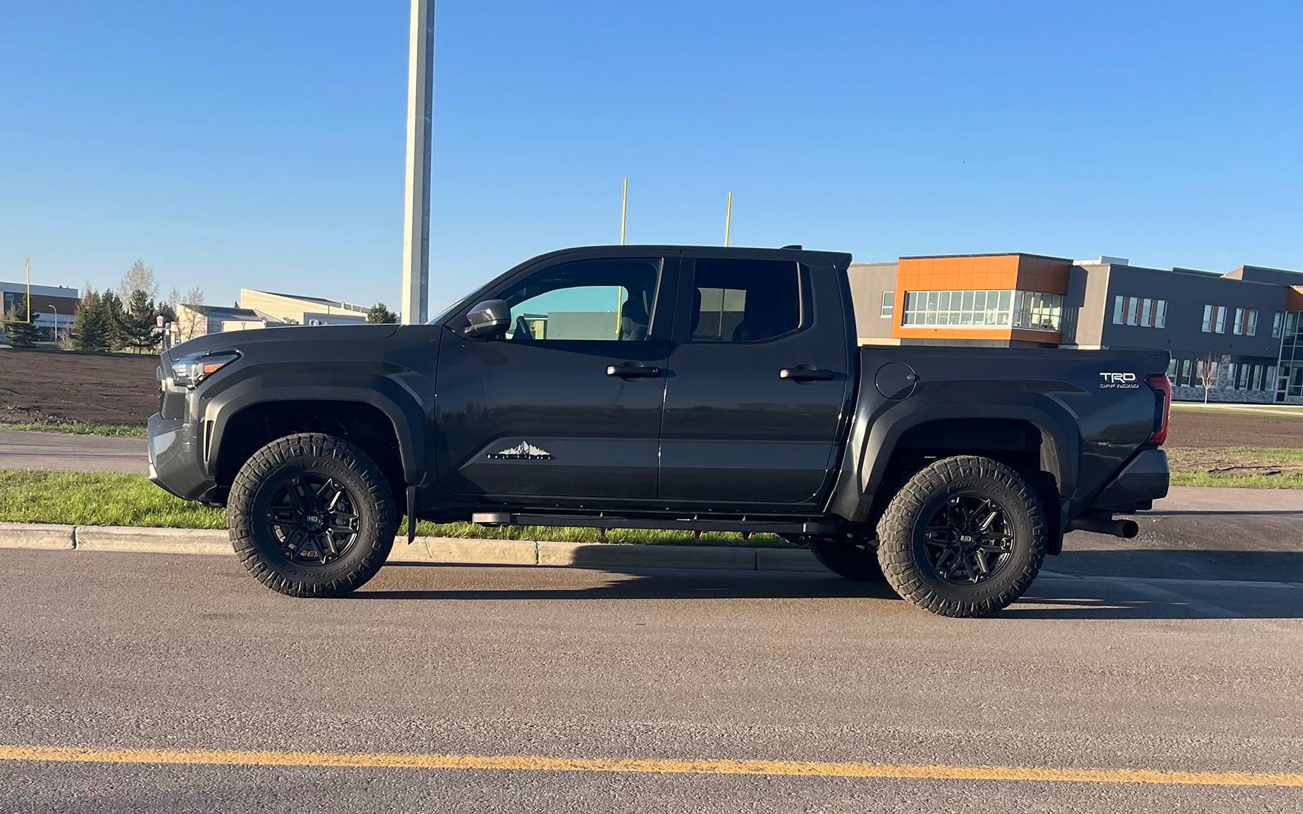

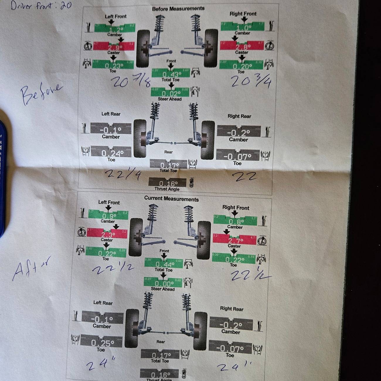

What type of lift and height increase? AllDogs 1.5" front and 2" rear just changed the springs
Did you install UCA and what type? Nope
Did you do an alignment when completed? Yes
Mods to the rear? Front and rear springs
Did you do the Diff drop? No
Do you have any new vibrations after the kit was installed in the front? No
What did you do to correct or get rid of the vibrations? N/A
Do you have any problems with the front axle? Nope
How is the overall drive and feel? Awesome
I also have 33" tires

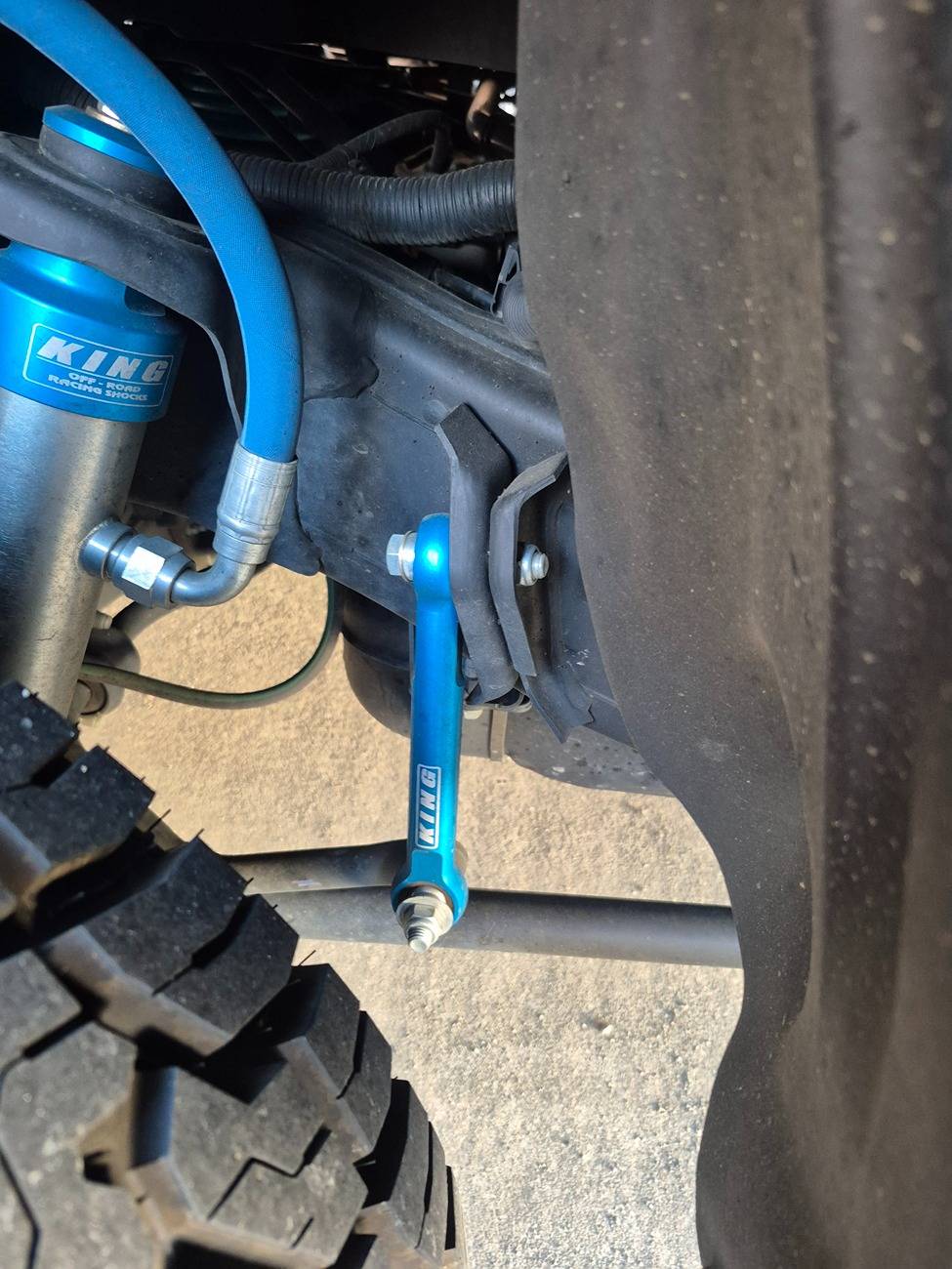

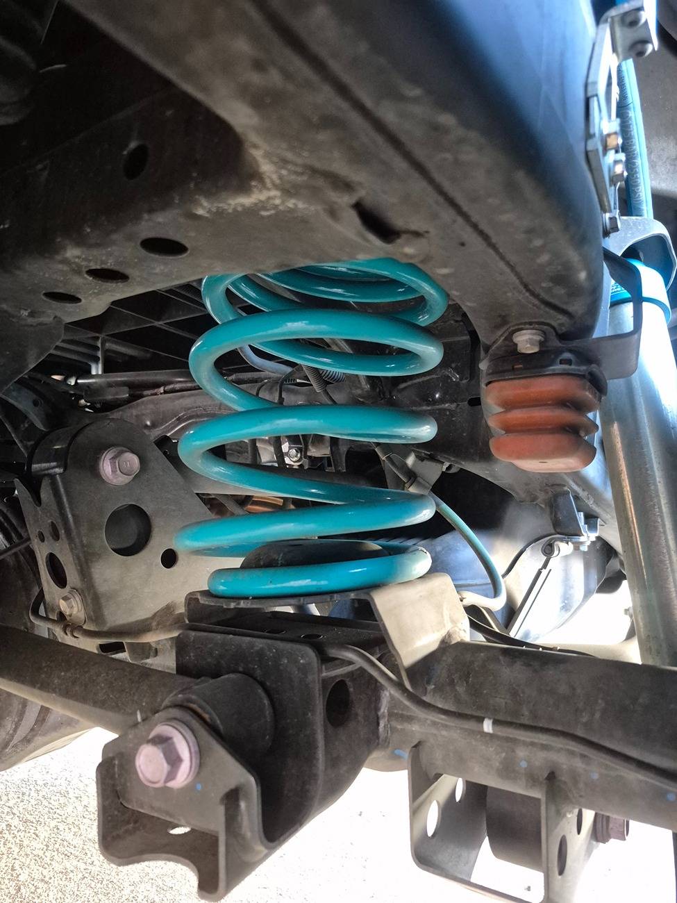

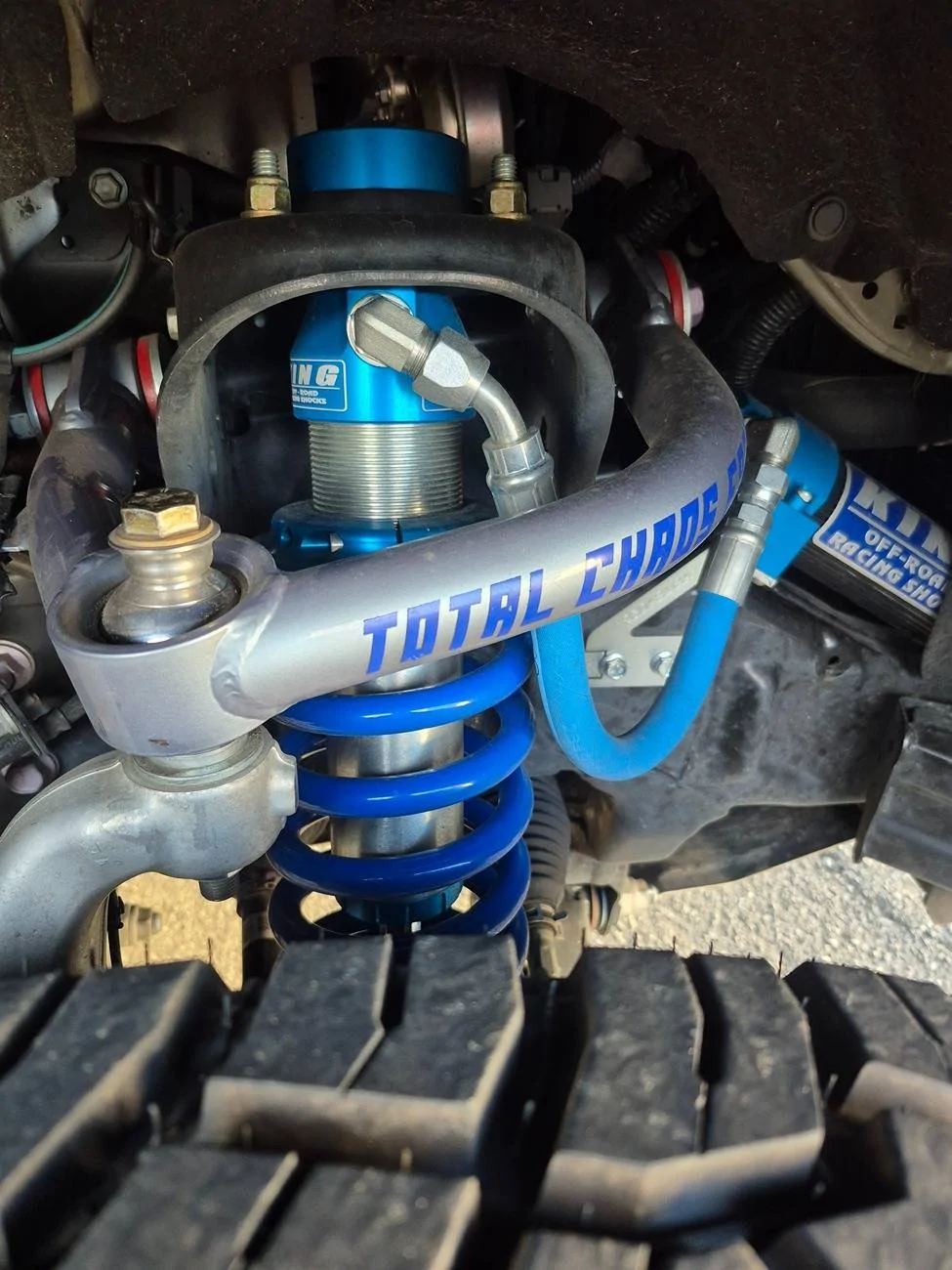

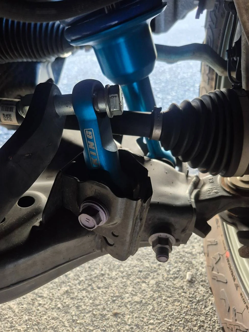

I personally have a total chaos king coil over lift 2 1/2" with Dobson 819 coil Springs in the rear. I did not go with a diff drop Over 5000 miles, no problems. No vibration.
Ride is amazing and corners like a Porsche.
