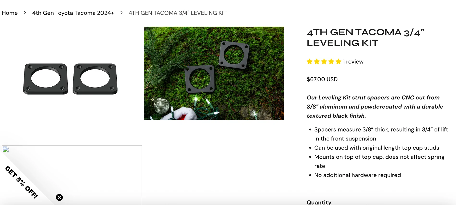

2024 Tacoma Greenlane top hat spacer leveling kit Screenshot 2025-10-31 at 20.21.43
Does anyone have any experience with the Greenlane 3/4 top hat leveling kit? I have been trying to find something that will level the truck out just a bit without affecting the spring rate, and this is one of the options I've come across. I have seen many people running their sliders, but havent found much info on the leveling kit.

It's a 3/8" thick aluminum plate. As long as the holes are in the right spots, it'll work.
And in my opinion: 3/8" is the perfect thickness for a top spacer on these trucks. That's the maximum amount that still allows for full thread engagement of the stud nuts, and keeps a very small amount of rake to the stance.

Will these 3/8" thick plates also reinforce thetop hat?
