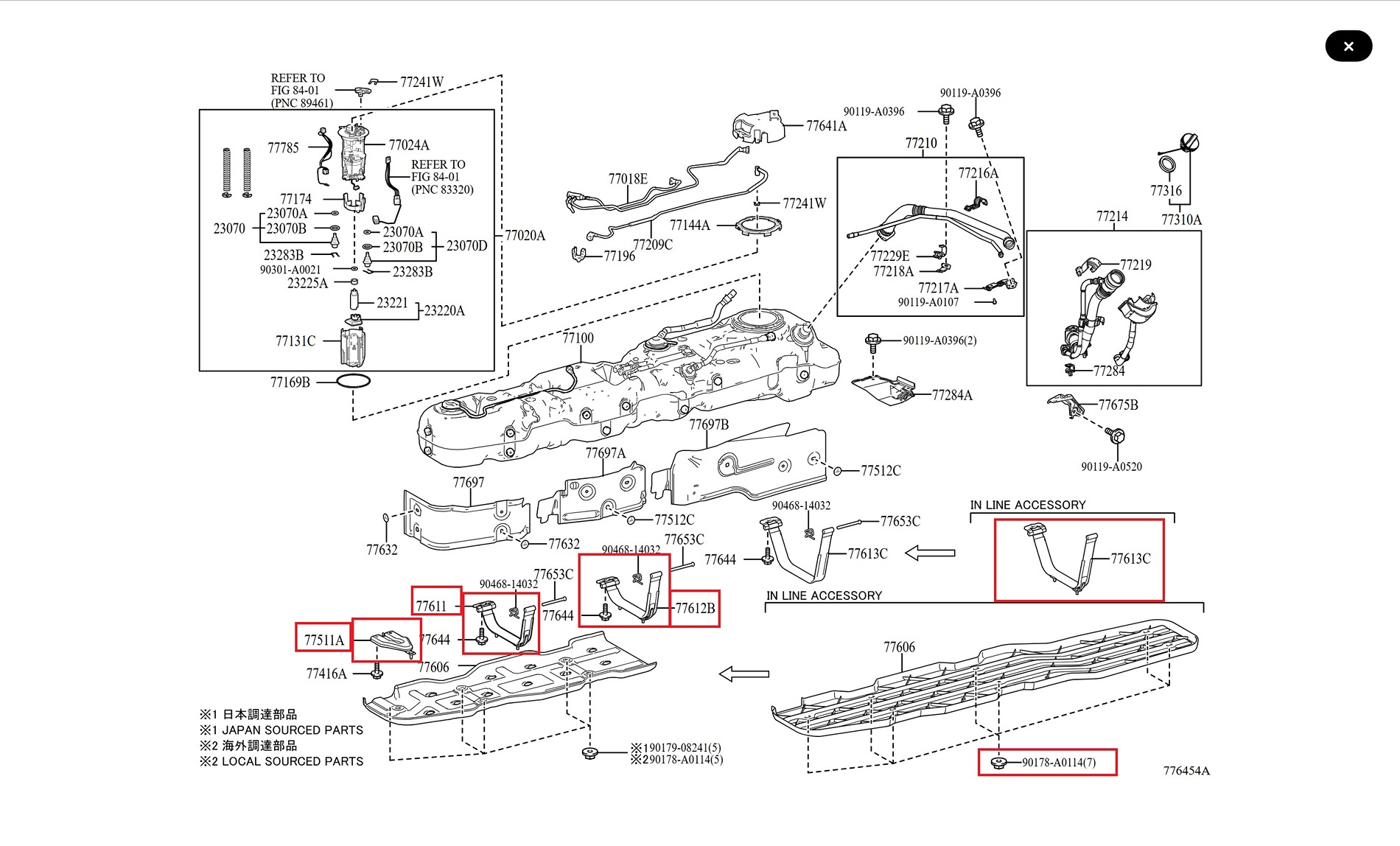

Hi all,
I wanted to add a OEM fuel tank skid to my Limited, but need the part numbers for the brackets.
Does anyone have access to look these up? Please see attached pic...
Thank you in advance!
Resolved! Please ignore.

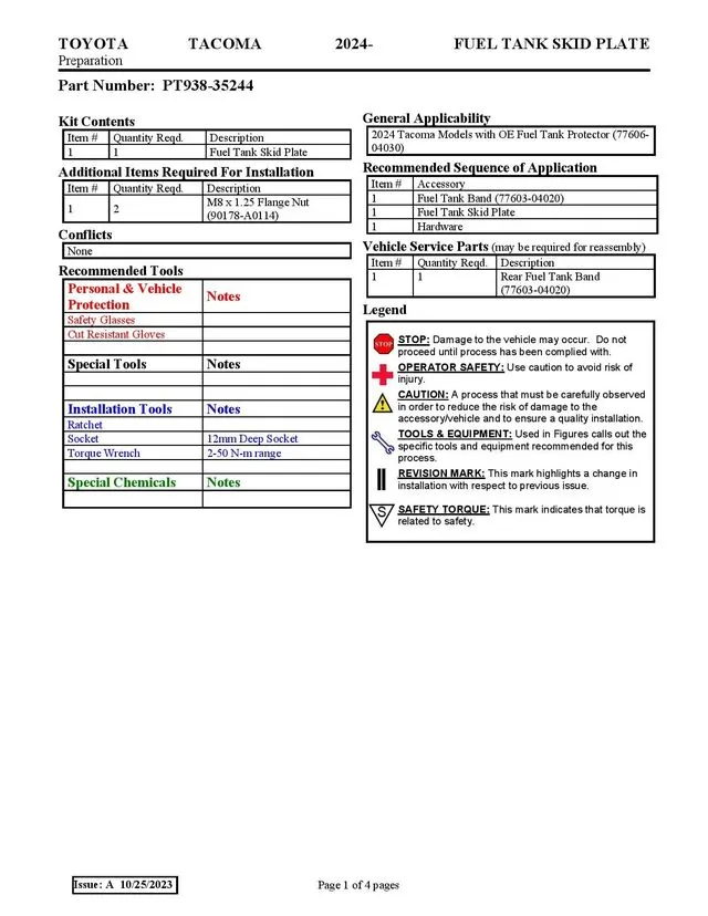

Incase anybody is still looking, part number is 77603-04020. Found this for my own reference as i'll be installing the gas tank skid on my TRD OR.
