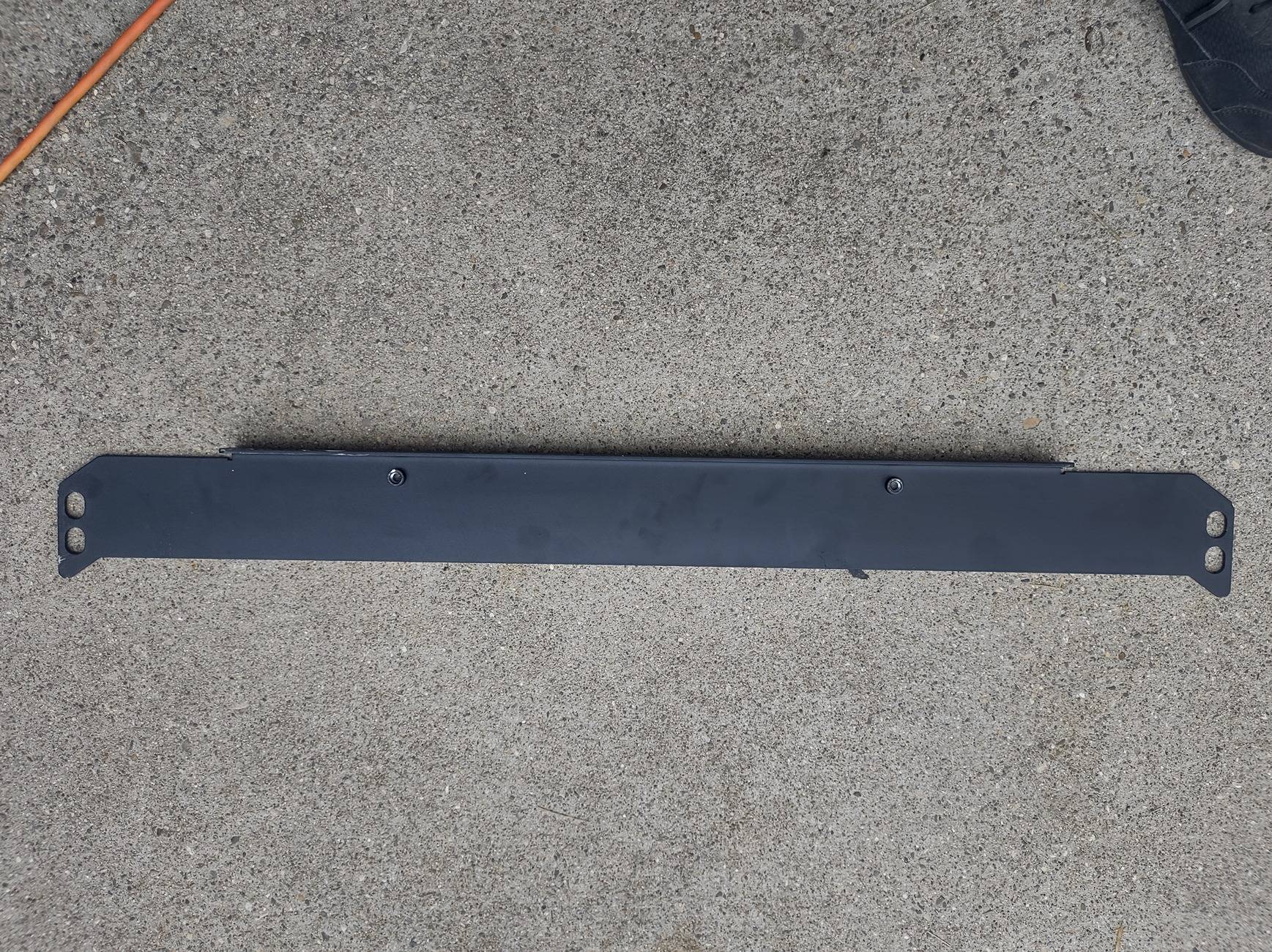

What came with my OR is a bolt on cross member, 2 bolts each end, with two skid plate mount location in between. I got the front covert bumber and skid plate set, did not need the cross member. See picture.
MarkusJ
Mark
May 13, 2024
48
43
Orlando,Fl
2024 Tacoma Sport 4x4
So that came with the Tacoma from the factory?

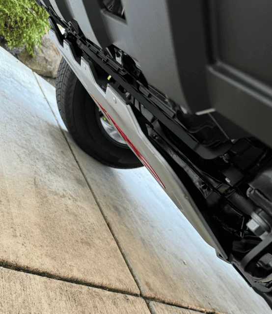

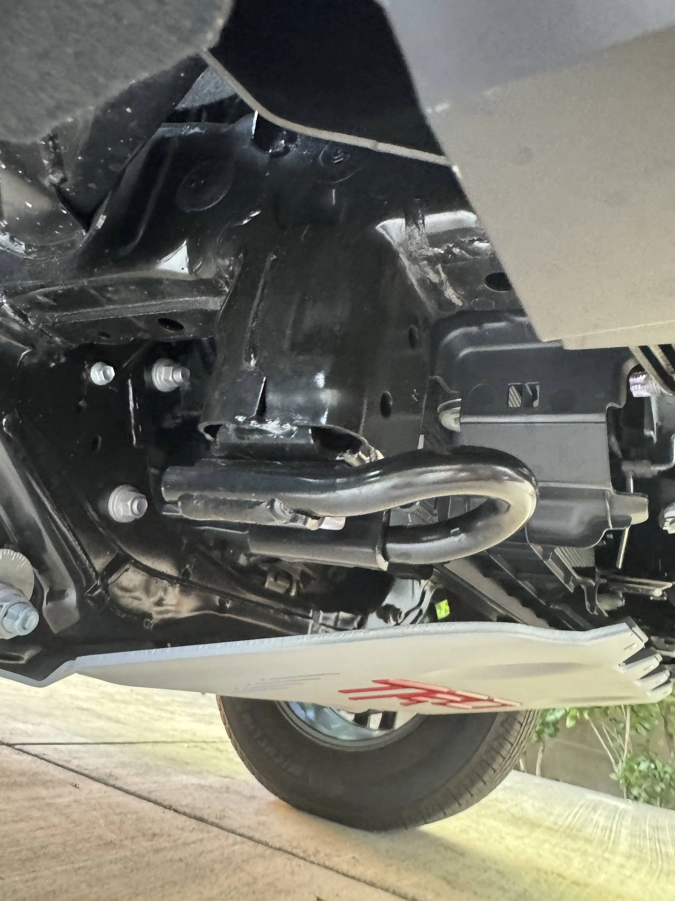

I just purchased a TRD skid plate for my 2024 TRD sport. The front two bolt holes on the skid plate do not have anywhere to mount to on the car. Instructions that came with the plate says that 6 bolts hold it up which I only could find 4. Does anyone know if there is a crossmember that the sports dont have that the skid plate mounts to? The skid plate hangs down lower than I would like on the front and theres only 4 bolts holding it on.
Hello, realize this thread is from MAY, now its NOV.... but I am going through the same scenario now with my New TRD Sport, and was recommended (ordered, Not installed yet) an aftermarket cross member from RCI offroad, to mount the OEM TRD Skid plate. Thought I would post in case it can help anyone else, link: https://rcimetalworks.com/product/front-skidplate-mounting-crossmember-24-present-tacoma/
