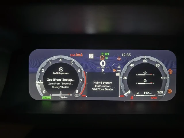

When I drove on the paved road, my 2025 Tacoma Trailhunter malfunctioned and displayed on the dashboard,
See photo attached. I called a local dealer, made an appointment a couple of days later, and cannot walk in right away.
Please help me understand what caused it, etc. Thanks a lot.

"Toyota Tacoma (i-FORCE MAX) indicates a fault in the high-voltage battery, inverter, or powertrain electrical network. It requires professional code scanning at a dealership because the truck may limit power or refuse to start."
In other words, it's basically impossible for us to troubleshoot your issue with the information you've provided.

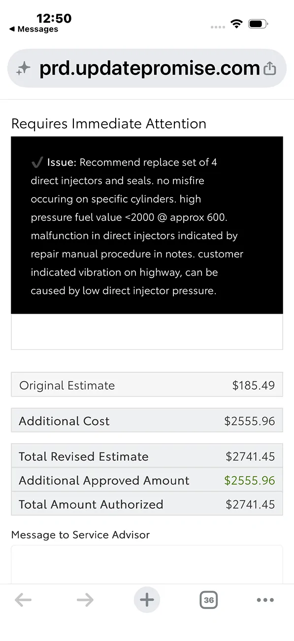

Sent my Tacoma to the Toyota Dealer; the dealer could not find any issues, then he reset the Tacoma bank-1 (I don't know what it is). I picked up my Tacoma back home and only drove around 30 miles; all warning lights turned on while I was driving. It is so bad. Then called the dealer again and sent the Tacoma back. The dealer found the issue and fixed it needing cost more than $2700, and let me pick it up next week. See photos below.

Wait, it's not covered under warranty?
