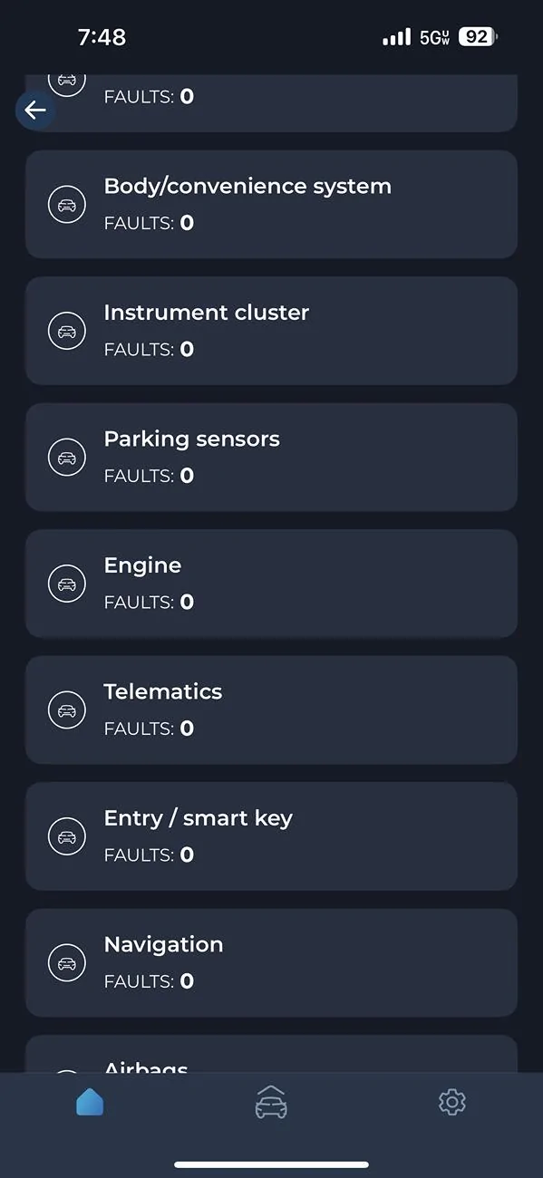

I put on an aftermarket airbox on my Trailhunter and it threw a code whenever I accelerated hard or got up to around 50mph. I worked with their engineer and we couldn’t come up with a solution. No code with the stock box, even with the auxiliary inlet to the air box uncovered. The OP (exia) can save a trip to the dealership by reseting the code by unplugging the battery for 30 minutes.
Has that code appeared again? Even though they cleared mine. It still showed up even without a check engine light on.
I last reinstalled the stock airbox and cleared the code on Wednesday. It’s still cleared.
I found a thread previously mentioned by MT-Taco. The problems seems to be all oiled filter affecting the mass air flow sensor. I feel confident gettting this part returned now.
