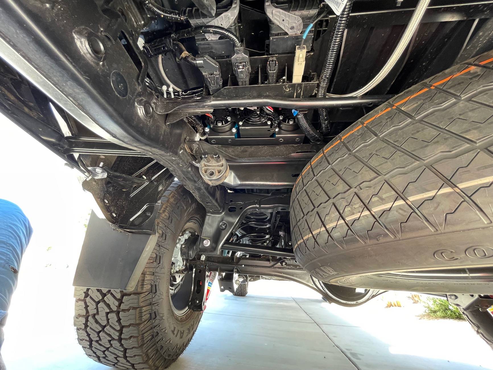

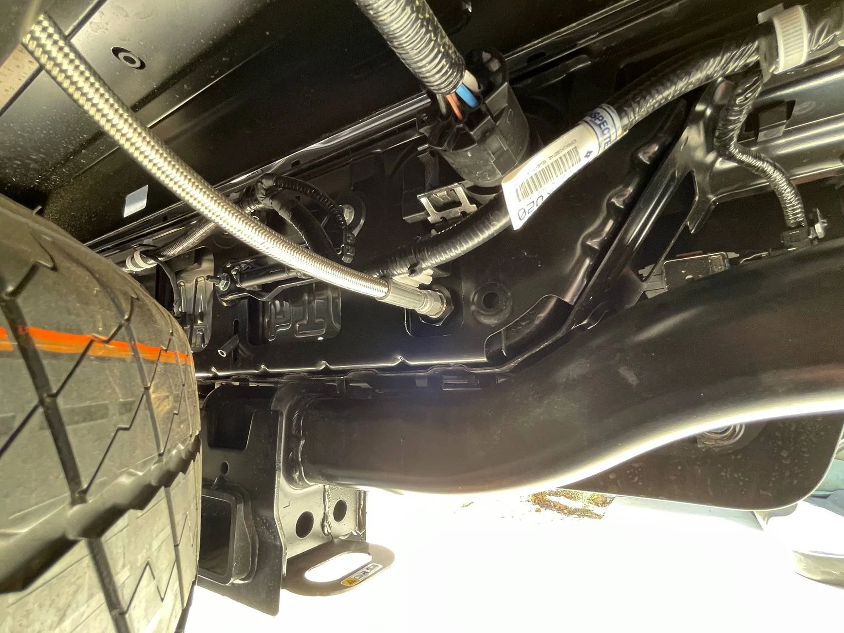

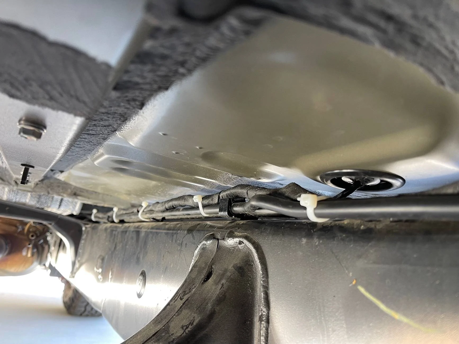

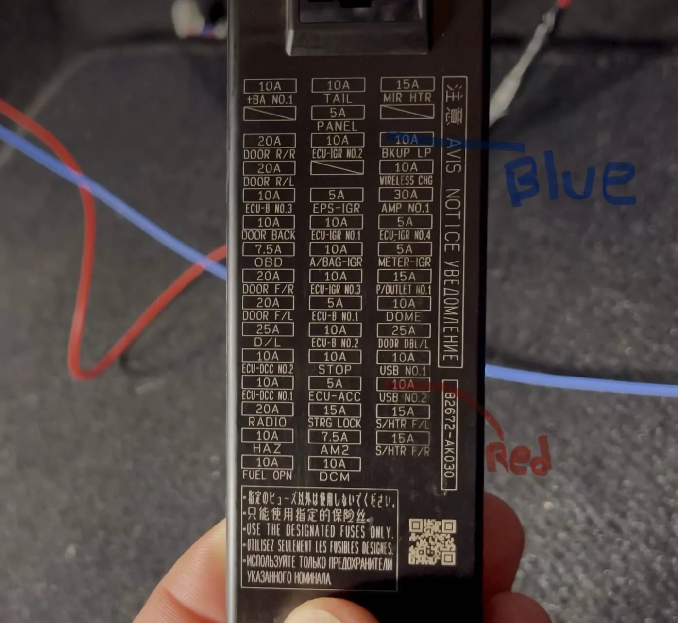

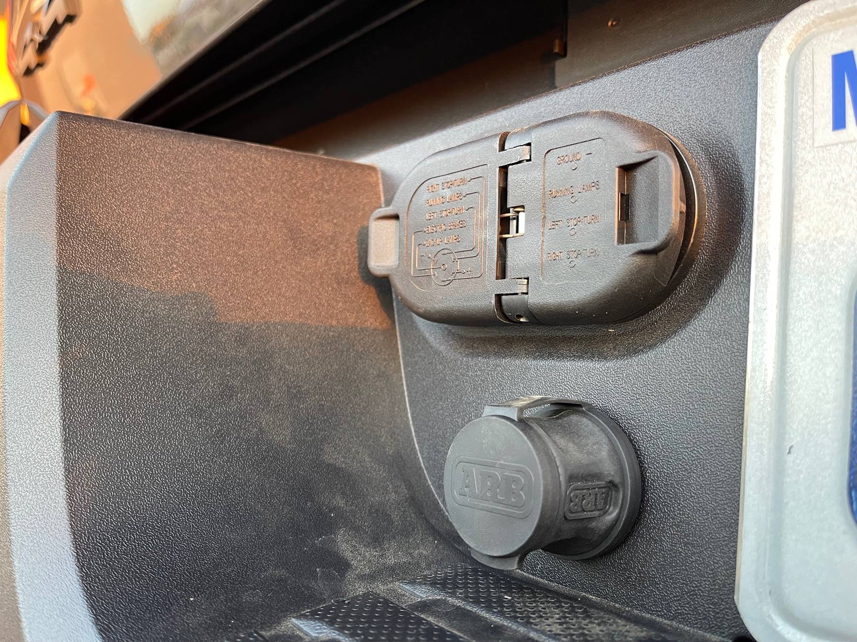

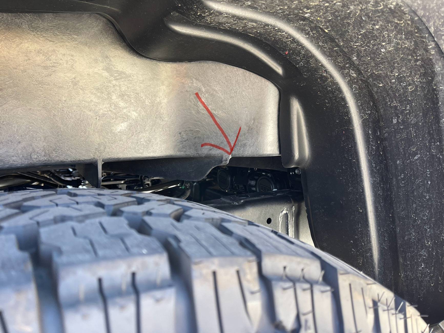

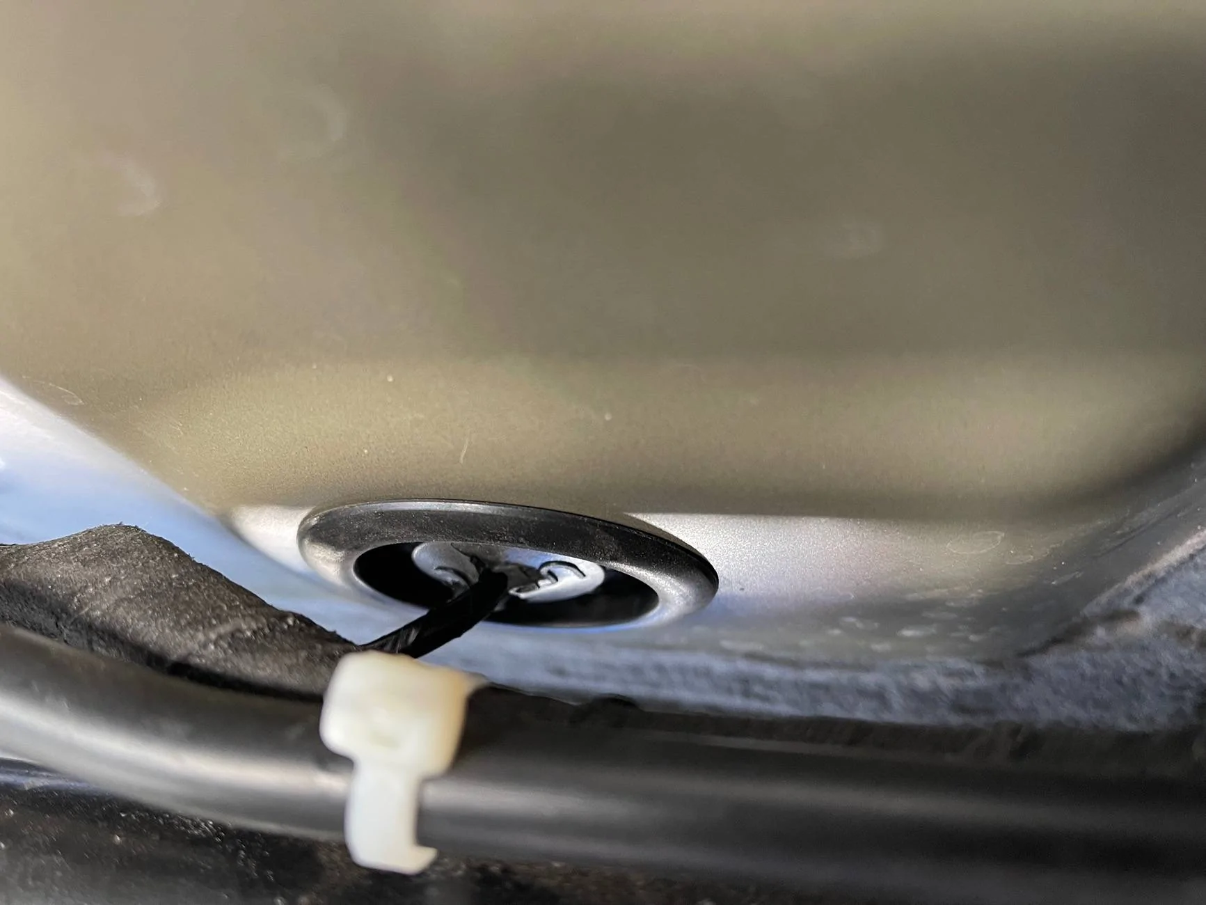

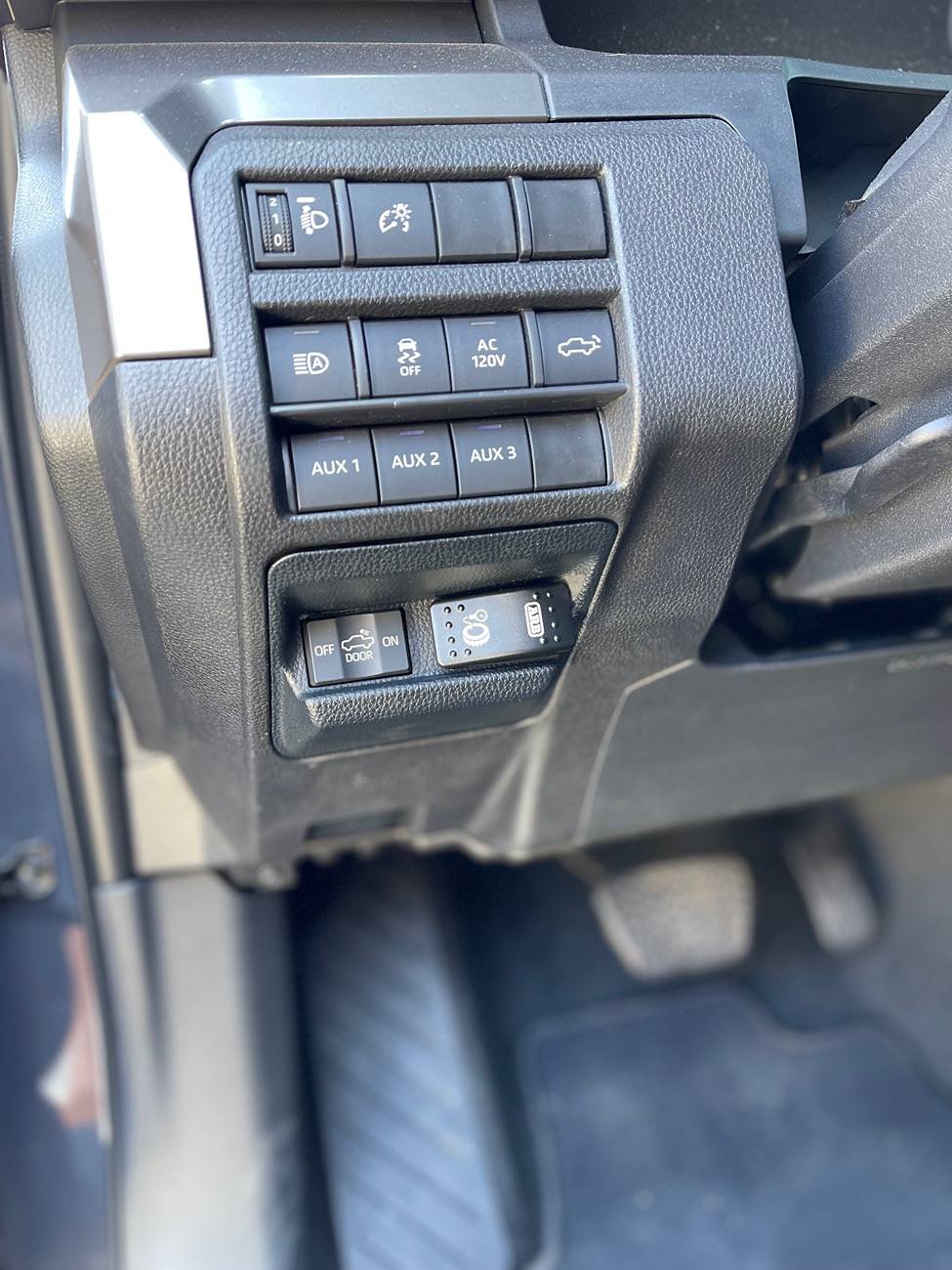

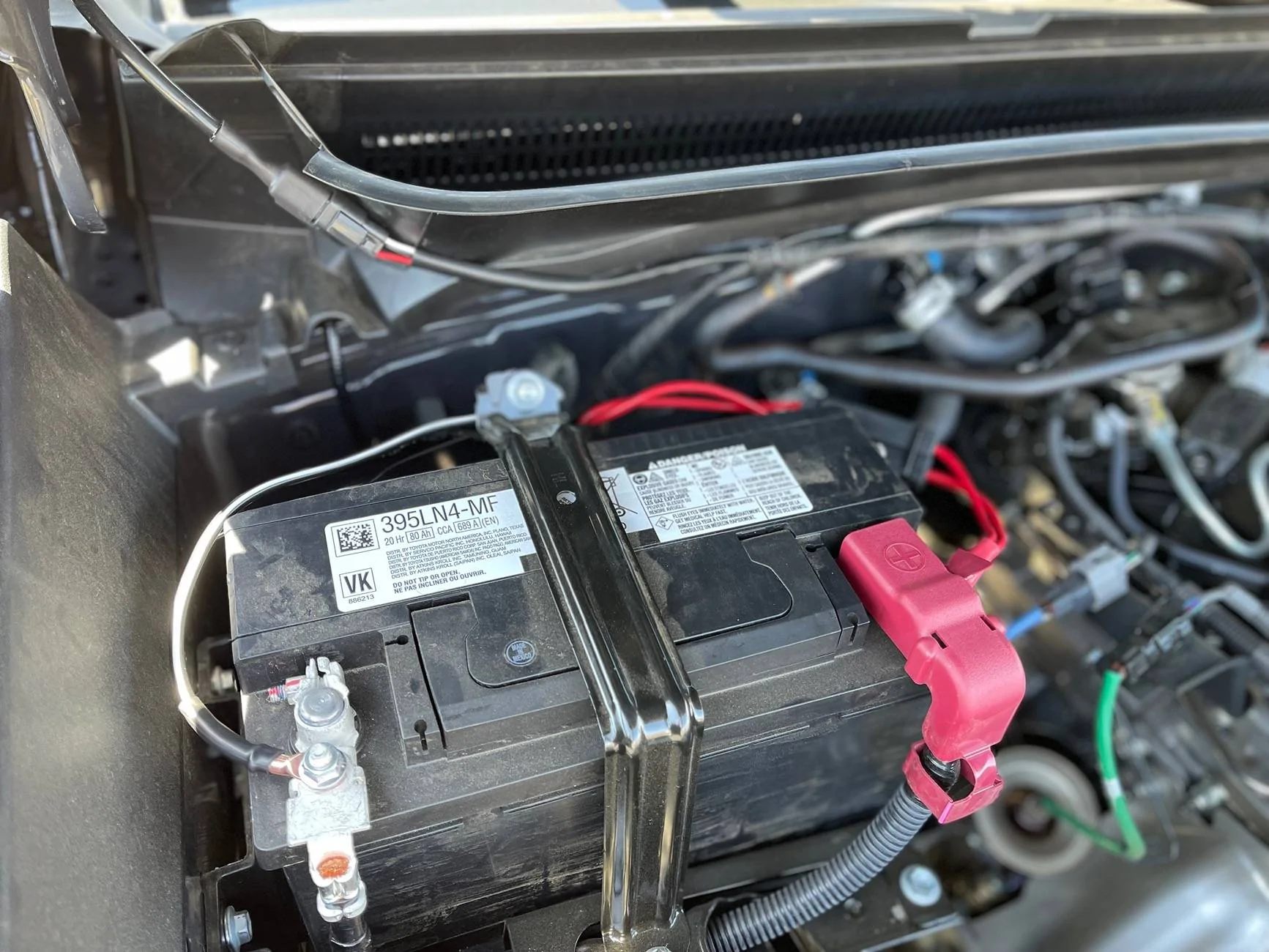

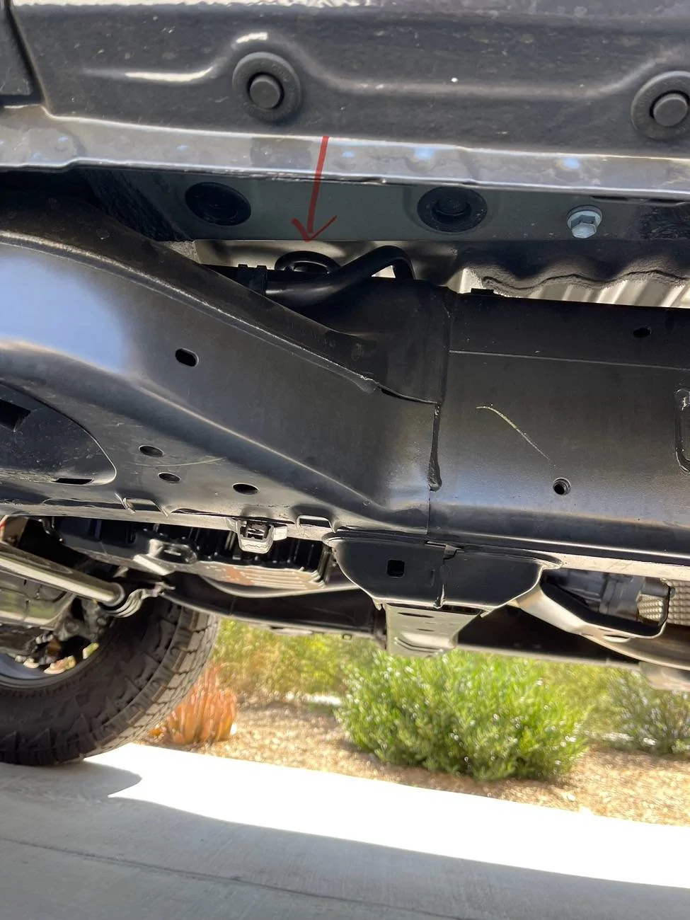

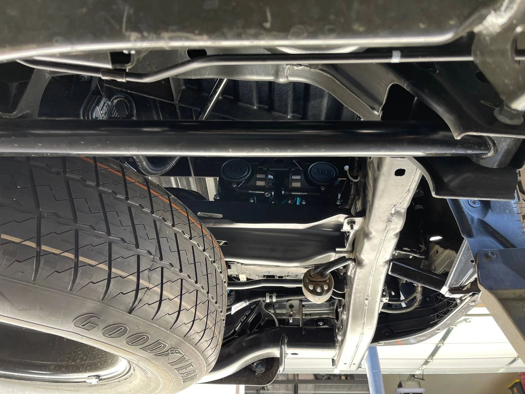

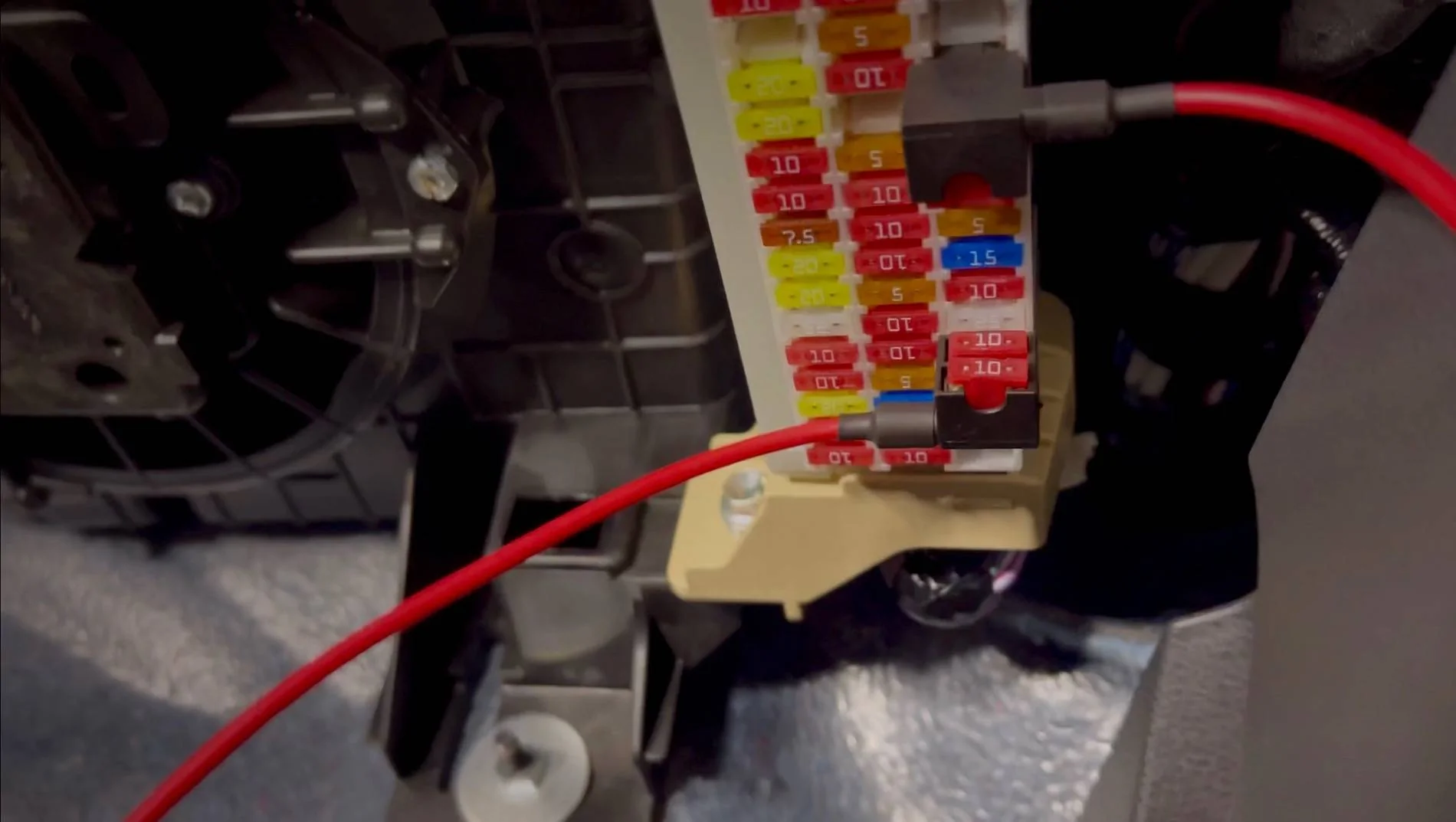

There were 3 options I had for mounting the ARB Twin Air Compressor on the Tacoma OR and ended up deciding on the sub frame by the spare tire. The time consuming part was extending the wire harness which I did 20ft for the battery harness and 10ft for the switch harness. This was a bit too much since it left me with 3-4ft of slack at each harness. This had to be done since the compressor is mounted by the spare tire. Once I figured out where the cab fuse panel was, I just had to figure out what fuses to use for power and illumination to the ARB switch. I had to extend the blue & orange wires from the switch harness to get them to reach from the driver side kick panel to the passenger side kick panel since this is where the cab fuse panel is. I routed it via under the dash, plenty of space. For the illumination wire(blue) I tapped into the 10A Backup Lamp. For the power wire(Red) I tapped into the 10A ISB No2. I recorded the process and uploaded the video to YouTube. Towards the end of the video I point out all four fuse panel locations on the Tacoma OR. Hopefully you guys find this helpful.

I’m not too concern with dust since I can just blow air on to it once in a while through the visual point on top by the rear driver tire. Regarding mud usually it gets caked right behind each tire on to the chassi, it doesn’t get up there next to the spare tire. Either way installing some type of shielding doesn’t hurt, in case a rock or something ricochets towards it. Something like the photo below, just with flaps on all four sides… IDK, still thinking about it.

On my 3rd Gen tacoma I had the ARB air compressor mounted in the bed on the passenger side storage compartment. I used the expedition essentials kit and it was good up until I started getting more into overlanding. I installed a bed topper but having a compressor inside where you sleep or not being able to block that space with anything it becomes a struggle, specially on a 5ft bed. So this time I knew I had to mount it in the exterior. Honestly if anyone is using their truck to go Offroad or occasionally go camping etc, where you don’t block that cubby, the expedition essentials kit is the best option out there. I think that’s where Toyota got the idea from.
