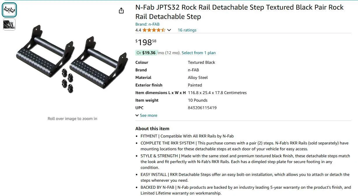

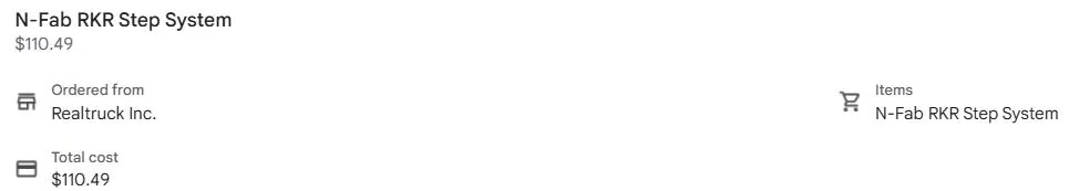

I bought a set with my wife in mind too. Super easy "install". Just bolt on. Got a good price using a 15% off deal Realtruck had going on recently. Looks like Amazon may be overpriced in the post above.

Keep in mind that price is from Amazon.ca - it’s in Canadian Dollars.

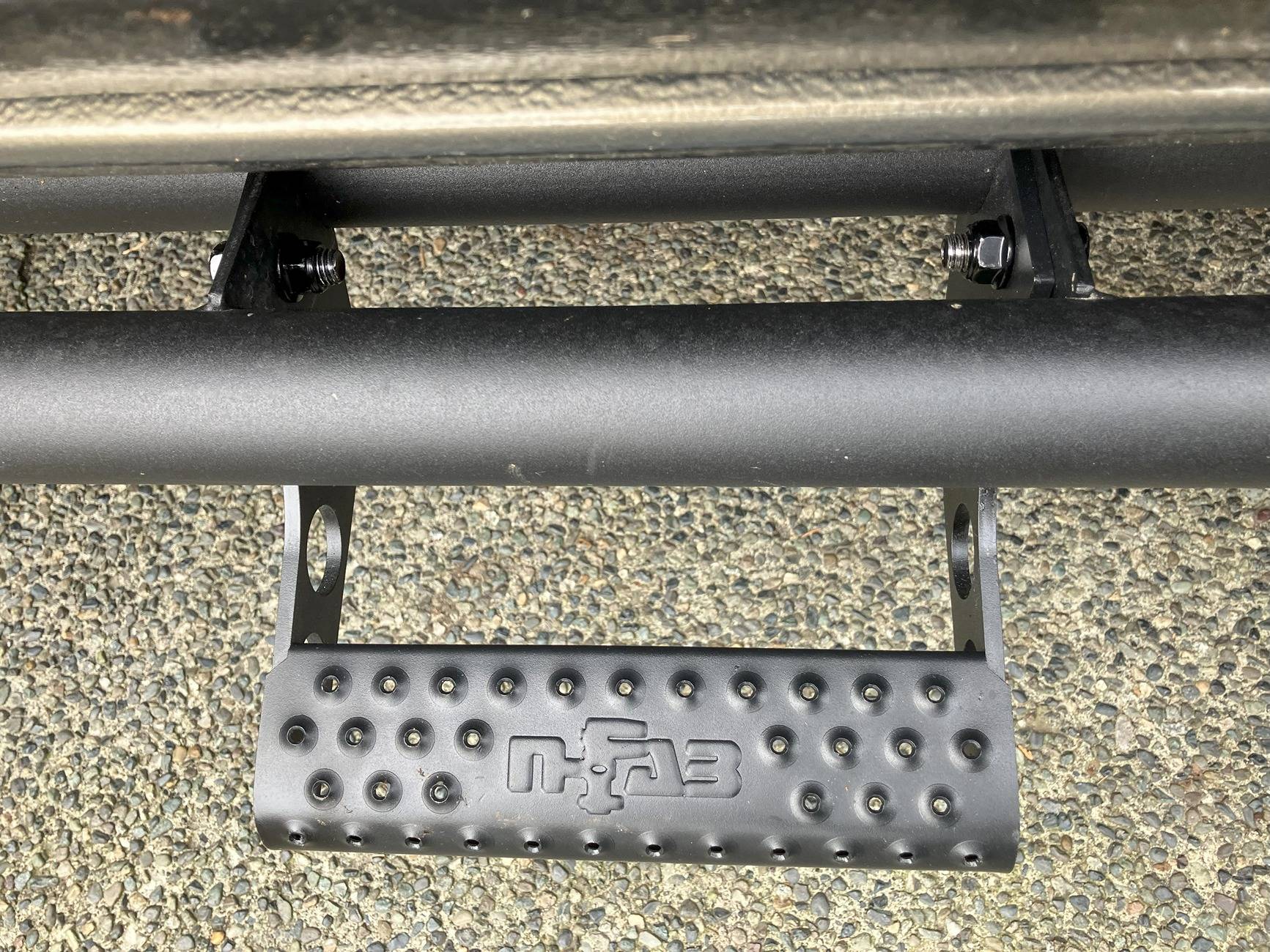

I finally got a few minutes to take some pics of the mounts for these steps. They mate to the rock rails using the spacers between the inner and outer tubes of the rails. The distance between these plates vary over the length of the rock sliders but near the front and rear doors there is a place where the steps will fit. They measure 9.5” wide outside to outside.
I hope this is helpful.

just confirmed these do not fit 2025 4Runner trailhunter, the gap between the rails is too small for the step to attach, sadly will be returning mine
