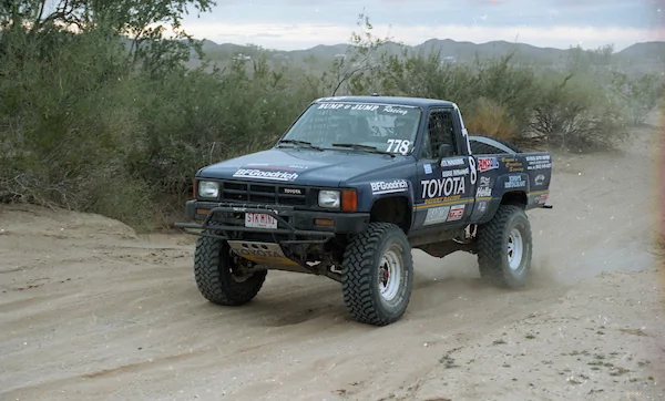

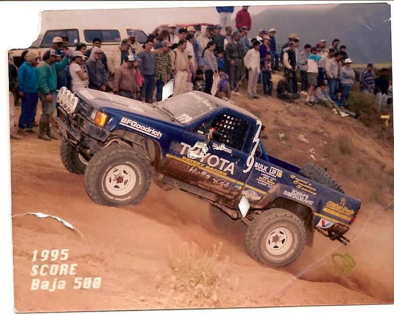

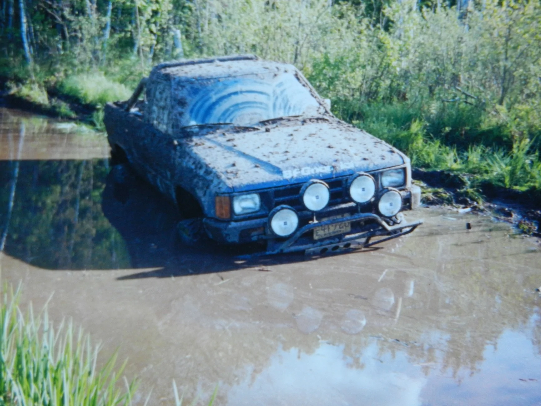

With my old 86 and 35's, rev the engine, 2nd gear, low-4 and drop the clutch and get un-stuck.
It depends on the off-road situation, if you can crawl in 1st gear, fine, if you need some muscle, starting out in 2nd gear, low-4 works great to avoid hitting rev limiter right away.
With this same 86 converted to desert racing with same 5-speed manual and t-case, we gutted the front end. Complete removal of drive shaft, gears till diff was empty, removed cv axles and plugged the wheel bearing holes with PreRunner seals from 1990's PreRunner 2wd.
Ran the race truck in low-4 for every desert race. Worked fine puling 35's with factory 4.10:1 Top speed was 85 on graded roads down in the desert running low-4 with nothing up front.
