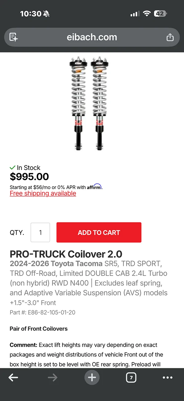

Good evening, I'm new to the forum and I just bought a TRD Sport. I want to lift it and change the original rims and tires. I don't know much about it, so I'm asking for your advice. I'm thinking of putting these on the front:
2024 Tacoma Lift advice IMG_3442

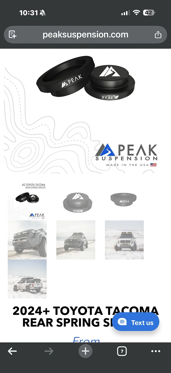

and these on the back:
2024 Tacoma Lift advice IMG_3443
which would lift it 3" in the front and 2" in the back with a 1" rake. I'm considering 285/70R18 or 285/75R17 tires. Is that correct? Is it a good combination? Would I need to change the UCA? I just want to lift it for aesthetic reasons, I'm not going to off-road it.Thanks in advance.

Those shocks look like a larger diameter? So you’re probably going to need UCA’s. At full droop the factory UCA’s might contact the shocks. Also lifting to 3 inches you’re going to need them to get a good alignment. FYI Just changing the front shocks could give you an unbalanced ride. Look at Bilstein 6112’s, I think they are a good option? You can find a full set front and rear for about $1300.

Just my opinion, but if you're gonna do those Eibachs might as well do the whole kit at 2" front 1" rear. If you stay at 2" or under you shouldn't need UCAs. Not sure how 285/70R18 would fit in there, so I'll let someone else chime in. @Panda Motorworks sometimes has great deals on that kit.

Just installed the eibach stage 2 kit on my 2025 Sport 4x4. Also added 3/4” spacers to the eibach 1” rear lift coils to get 1.75” lift in the rear. I wanted to retain factory rake which I did. I also had to crank down the front coil overs to my desired ~2” lift in the front. (When I installed these at factory settings, I was at 3.5” lift.) * Note: these will probably settle to some degree over time but I can re-adjust the coil overs back to desired height.

And when you are setting the front with any adjustable ride height shock, remember you will get roughly 1.5X the setting. So if you set the shock @ 1" you will actually get 1.5" due to suspension geometry. If you throw the Eibach in at the 2" setting they come set on out of the box you'll get 3"+ like @plasticsnaks mentioned
