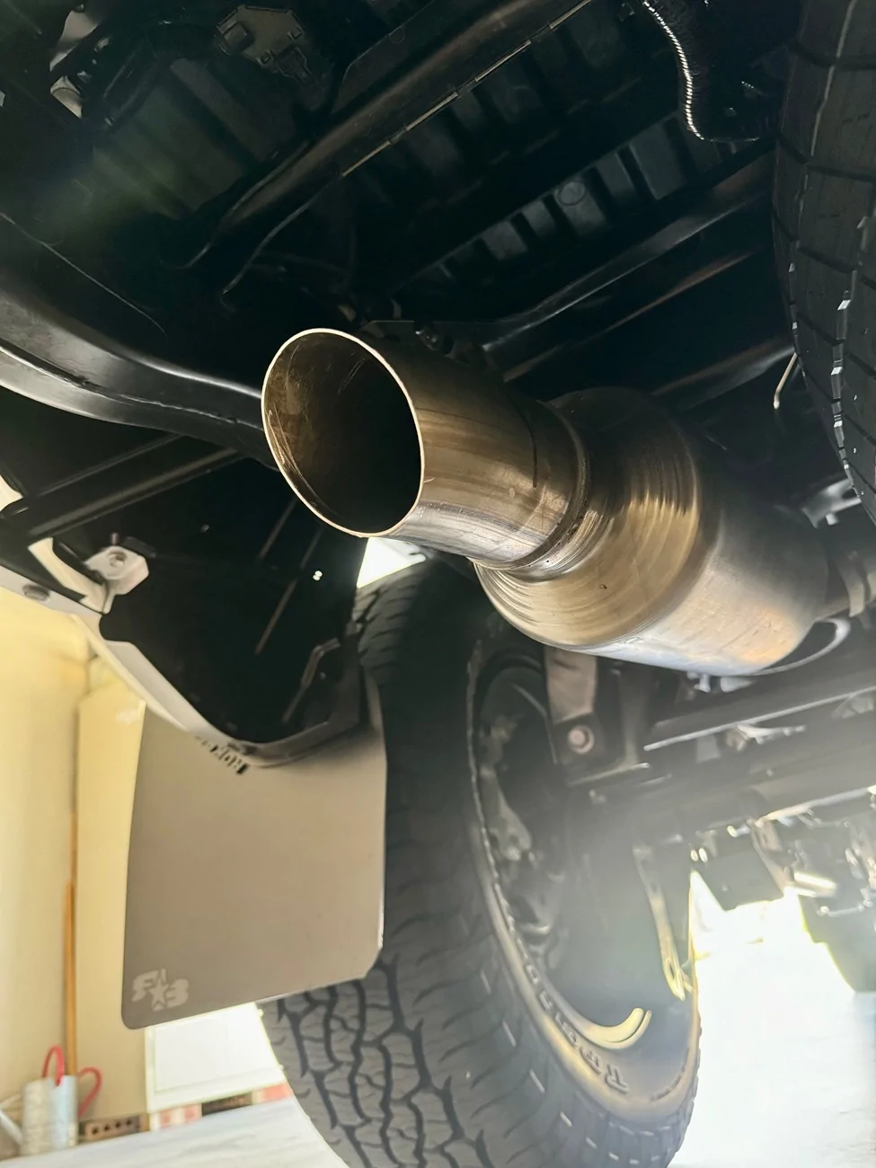

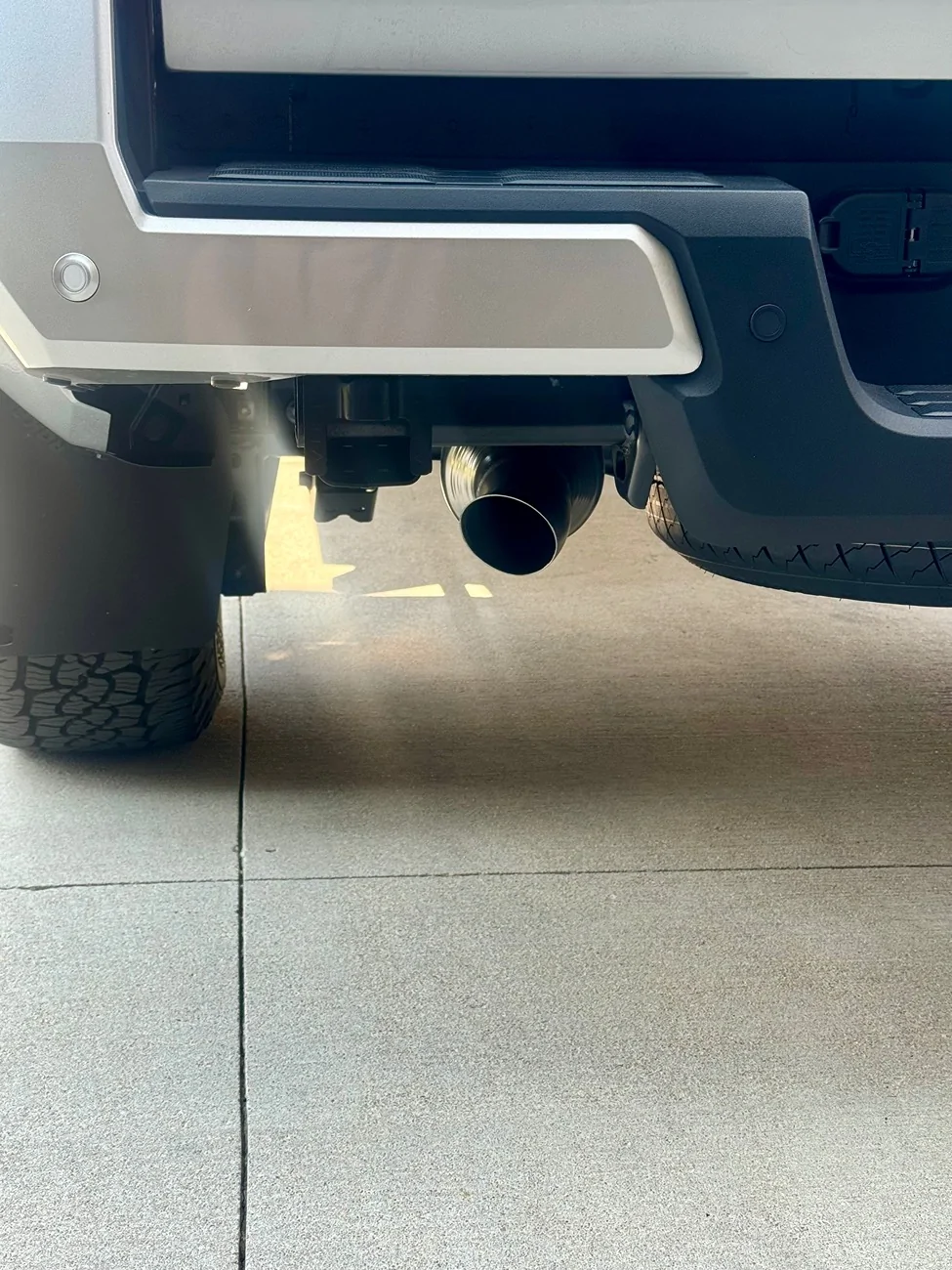

You can't make a 4 cylinder sound good because it is impossible. Just cut it behind the resonator. It will give you a slightly deeper tone but not louder. No drone In the cabin and it costs 1 saw blade. It will also keep the exit point above the spare so it won't drag on rocks. Do yourself a favor and save $1000 bucks. Here is my Limited after the chop.

Can you mount any of the traildumps like in the Trailhunter or the SXTH one? those dump up by the rear axle and are tucked away up high. It would be one of the first things I would have done had I gone the TRD Off Road route.
