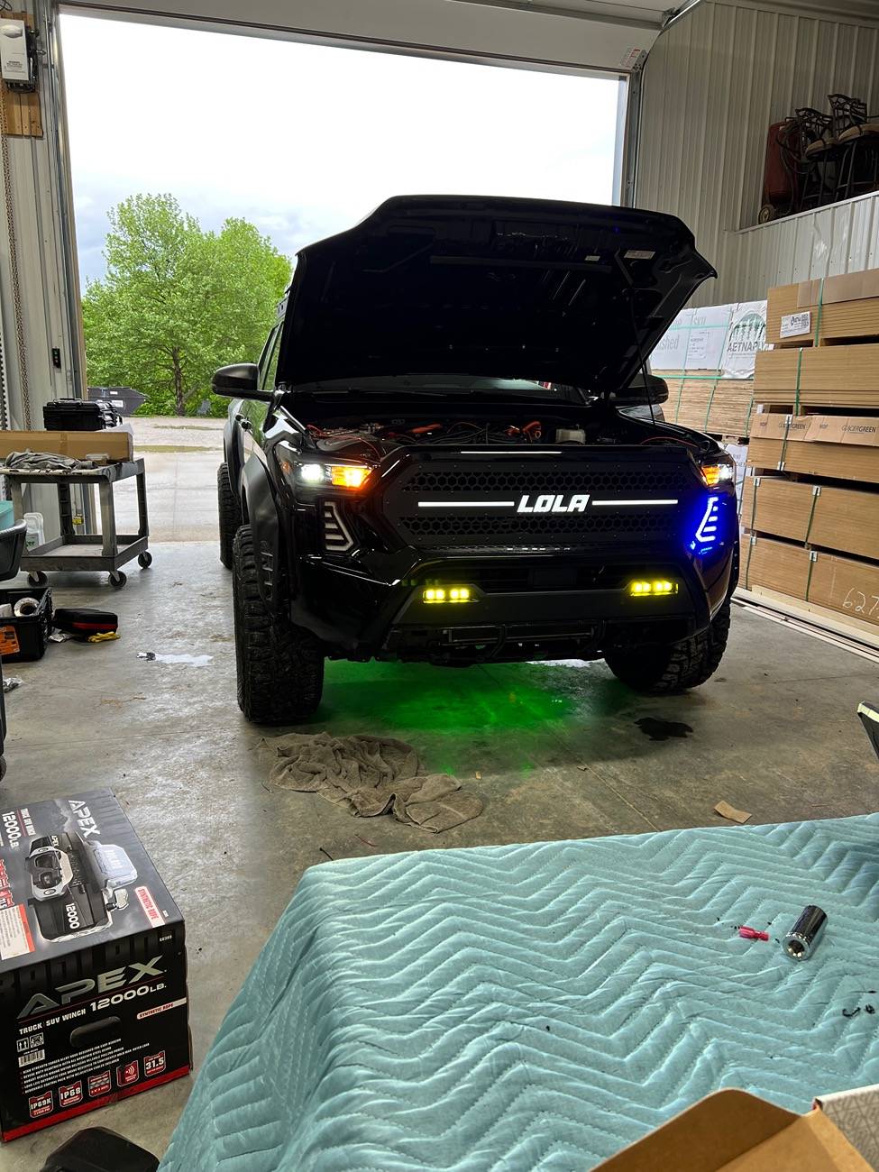

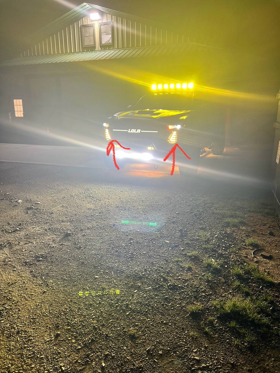

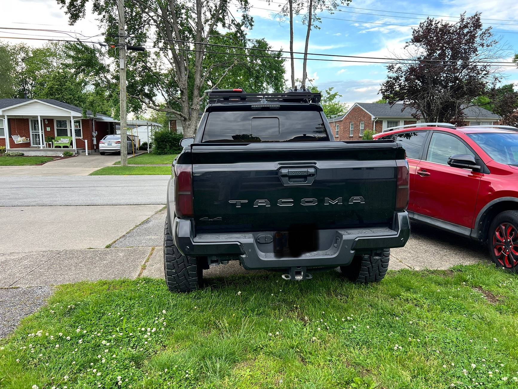

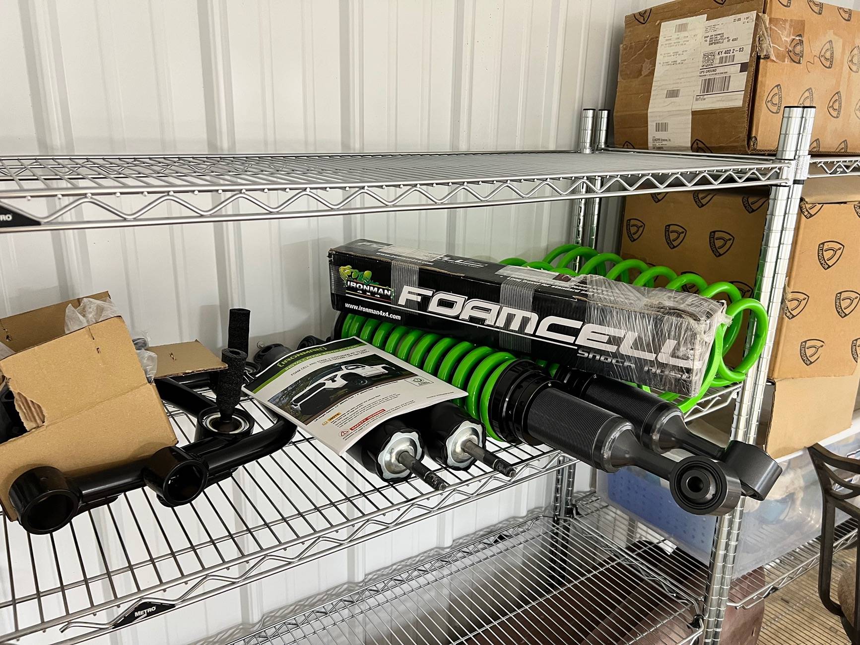

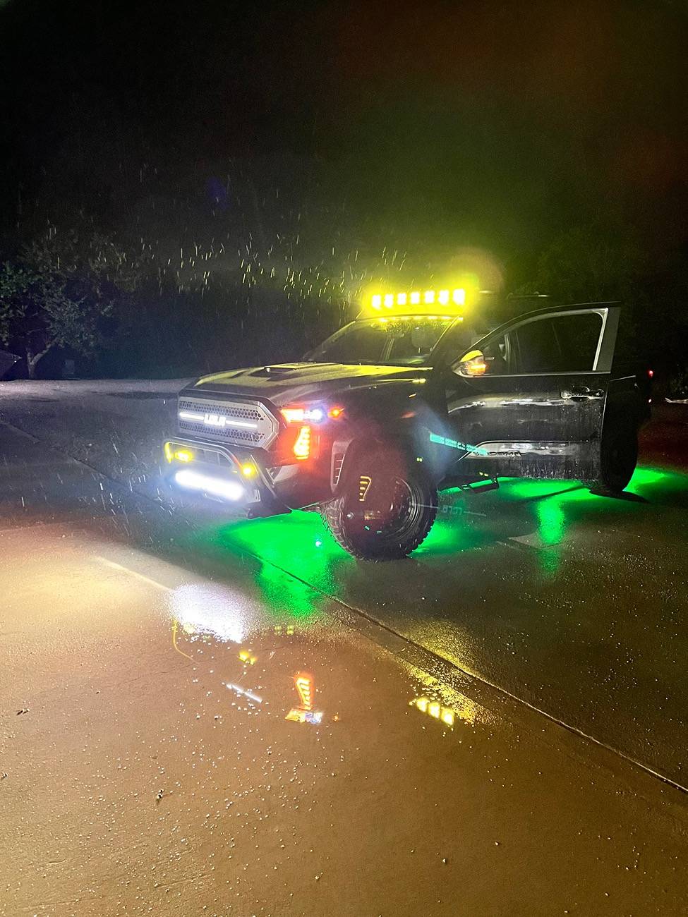

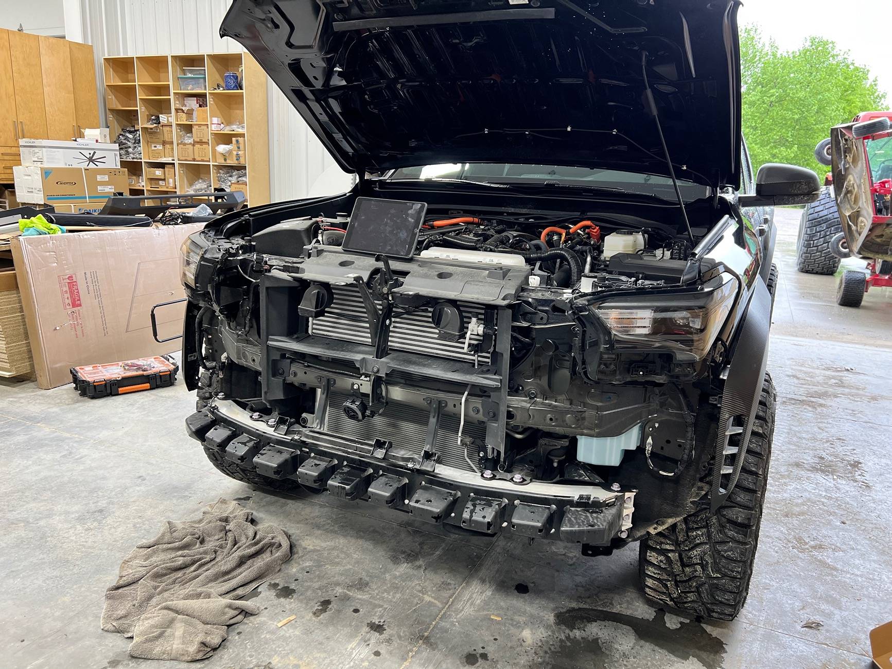

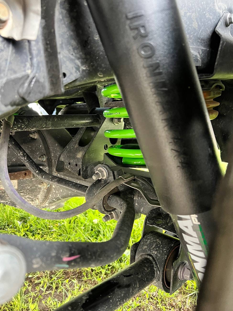

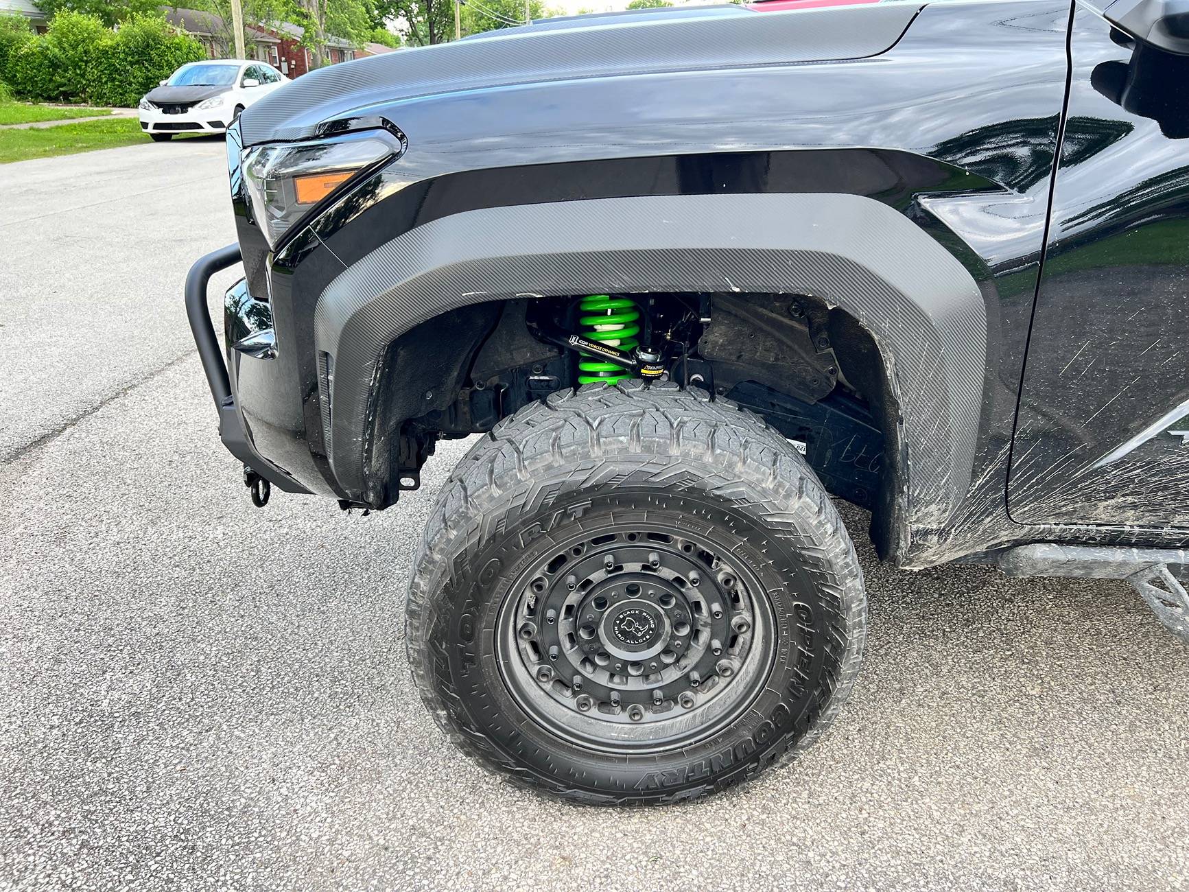

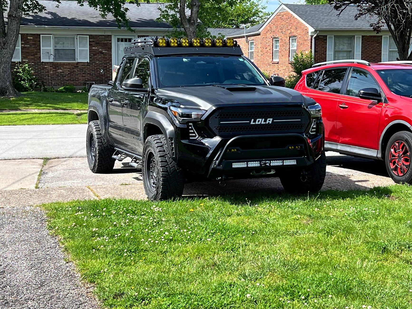

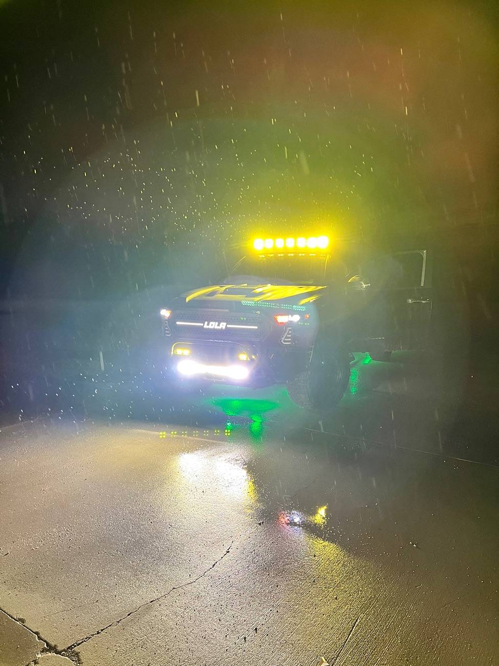

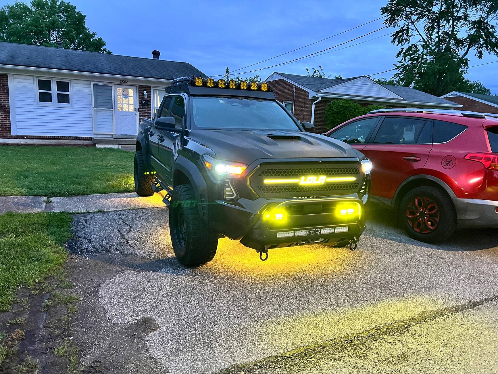

2024 TRD Sport Hybrid So awhile back I posted my build only one thing is left which is tomorrow a 3.5 Ironman pro cell lift. I’ve installed 95% of everything myself. Auxbeam Switch Panel, Sherpa rack Baja xl, Baja s2 fog lights, Caliraised bumper and lightbar, custom grille from Cutting edge off road, cheap Chinese rgb fang lights(if you know lol) Morimoto rock lights, Apex Badlands 12000 lbs synthetic winch, trifold rough country tonneau cover, blacked out tail lights Wraps4Real, 33”Toyo

Funny story my girlfriend was accusing me of seeing another woman and I was like what? What are you talking about? She said it was a woman named Lola and she kept it going for several hours until she told me it was the truck. So I named the truck Lola 🤣

Nice work. I’m waiting for my roof rack then I’ll be done with mine. Well done.

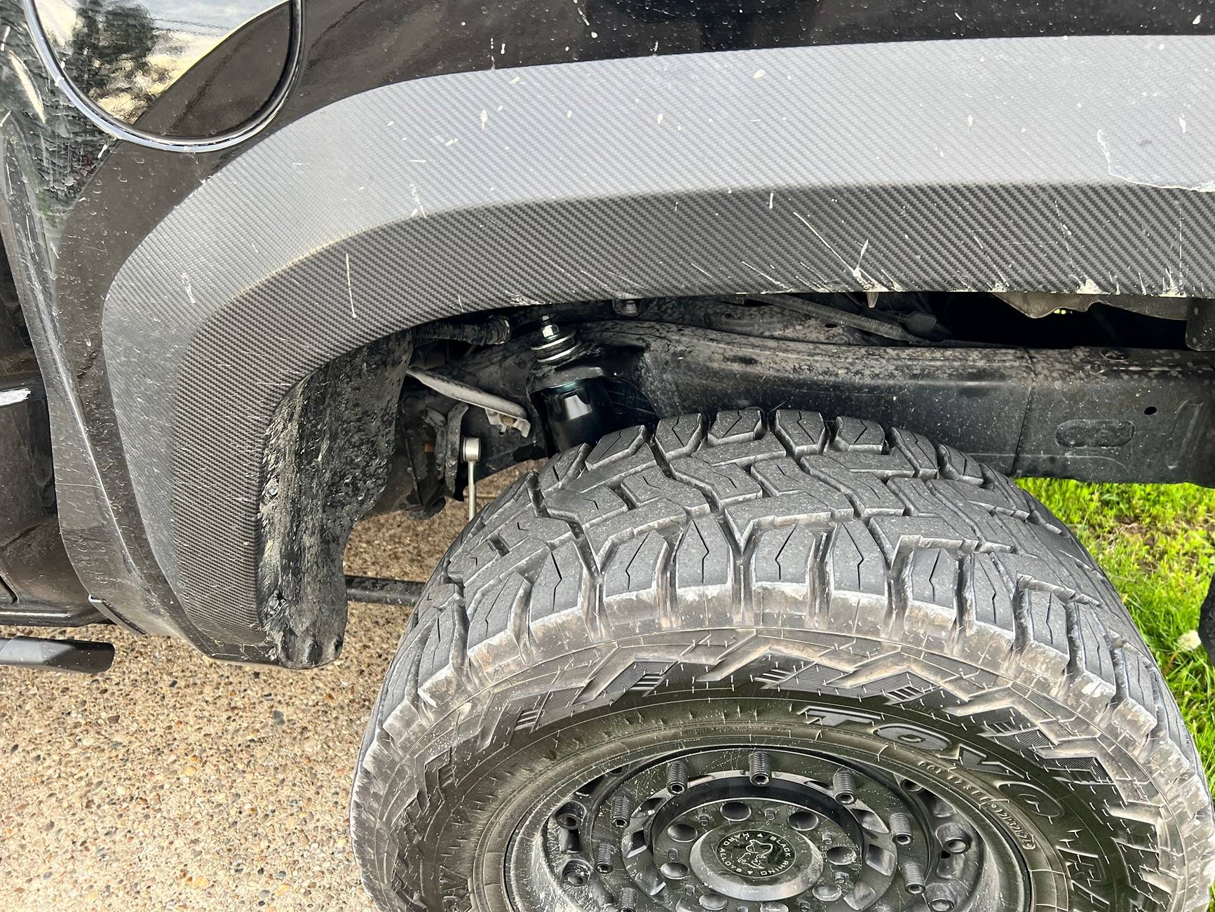

Well since I had to remove the front facade for all the aftermarket stuff installing the fangs was easy. When you do a TRD pro grille or any custom grille you basically have to remove 3 clips of the area with the fang. You could get to it easy if you went through the front fender and pulled my the fender liner. Some of the videos I’ve seen people are pulling prying and breaking the clips which is wrong. Also on videos I e seen people are pulling of the front fender flares which I’ve done 3 times and I notice yesterday that by doing that I’ve broke on a clip on both the drivers side and passengers side. I digress but now I’ve noticed since the trade war with China the price of those has doubled. I got them for 60$ something and now they’re like 120$

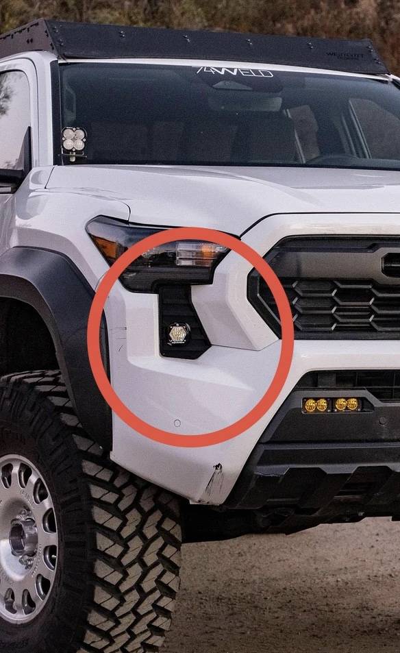

if you’re interested in doing any kind of mod to those panels, I highly suggest doing something that’s actually functional and looks aesthetically pleasing. These are direct replacements and even though the price is about $500, this includes the lights, wiring and replacement brackets. You can choose between spot or flood and it’s going to produce about 2,300lm each. If you chose to do this option, the flush mount lights themselves will run around $250 and includes the brackets, wiring and switch but with that extra $250, you get a “discount” on the fang pieces which are typically $350 from Toyota, plus long wiring, a better bracket and you can choose between amber or white. This is available from Baja Designs but some of the top teor companies like KC, Diode Dyn, Baja and others do have similar flush mounts in size but higher output… like KC has the Flex Era 1 that will run $330 and 2,400lm, Diode Dynamics SSC1 Soort is 1,500lm and the Pro is 2,,400 but you can opt for white, amber or red backlight.
the options are out there for much better quality and design plus these brands have various warranties against manufacturing flaws, LEDs and PCBs but more important, if you crack a lens or the gasket deteriorates, you can order new for $5-10 whereas the fang lights, you’ve spent the $200 and have no guarantee it will last a year, maybe two, if you’re lucky.

Pretty sure you meant “fascia” not “facade” (the outward or street facing side of a BUILDING or a covering to hide unsightly inner workings). 😂 But agreed, it’s a lot of work to fix when someone thinks it’s easier to do it another way when there’s a proper way to do an install… Im sure a lot of people have royally screwed up, regretted it and then told people “this is the wrong way to do it… #AskMeHowIKnow”. Now once thing you forgot was that by bending the fenders, you run the risk of splitting plastic and even spidering/cracking paint… even though they are plastic, the plastic itself is bendable but the paint and retainers will sheer off esp if you forget even a single one, that bolt will hold but the plastic definitely won’t. (Too many years of working in a body shop and finding hundreds of broken clips, rivets and damaged panels had to be fixed at my former dealership by nearly every tech who thought that if it doesn’t move, put torque on it 😂

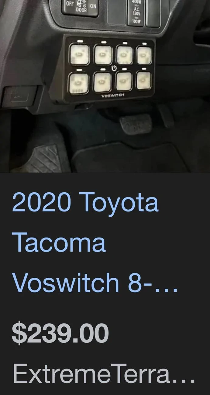

here’s a good example… if you look at the AuxBeam Switch Comtroller, the CaliRaised and the VosSwitch (just 3 examples, there are many more incl on some major Toyota/Tacoma suppliers)… same design for the controller and the control box is eerily the same from cover, board layout, connectors and harnesses… only difference is where and who placed the logo. Sadly, if you call any of the provided tech support numbers (not sales), it goes directly to the same company located in China. That’s why I use a Garmin PowerSwitch for now until the new Diode Dynamics D-Switch is available… around the same price but the Garmin has 6 switches and the controller uses either CarPlay/Android Auto or Bluetooth the D-Switch adds 2 more aux buttons, a dedicated backlight and higher amperage capabilities. But here’s the point of comparing those 3 generic brands and knowing there’ll be no change to the fang unless they design an RGBW design (which will make us more compared to a mall crawling Wrangler than what Toyotas are made to be 😂)…
