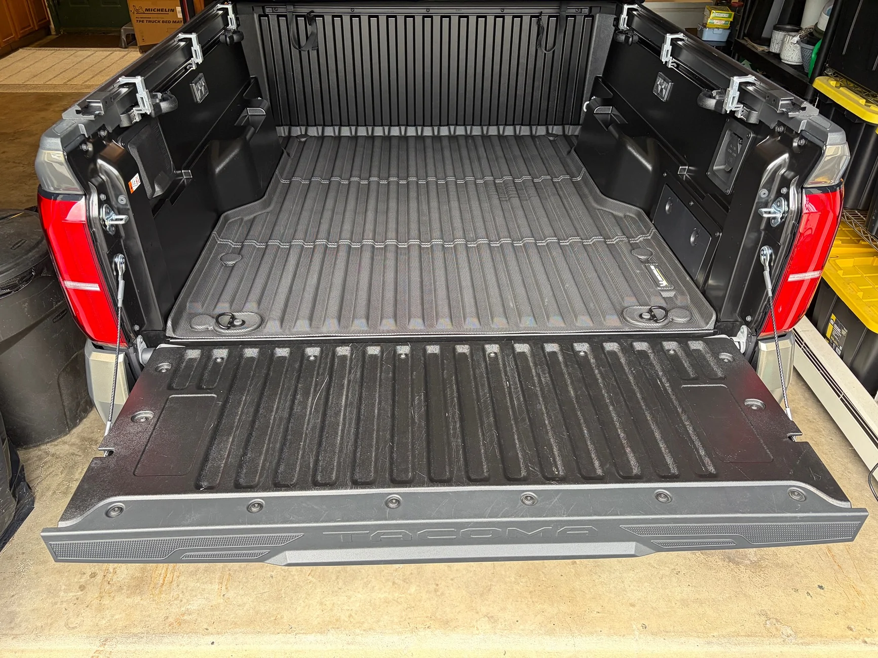

After going back and forth on bed mats I finally settled on the Michelin mat. My concern after using seeing the OEM mat in person was twofold. First it felt like it would be too grippy hindering the ability to just slide items in easily. The second was there was no way to secure it down.

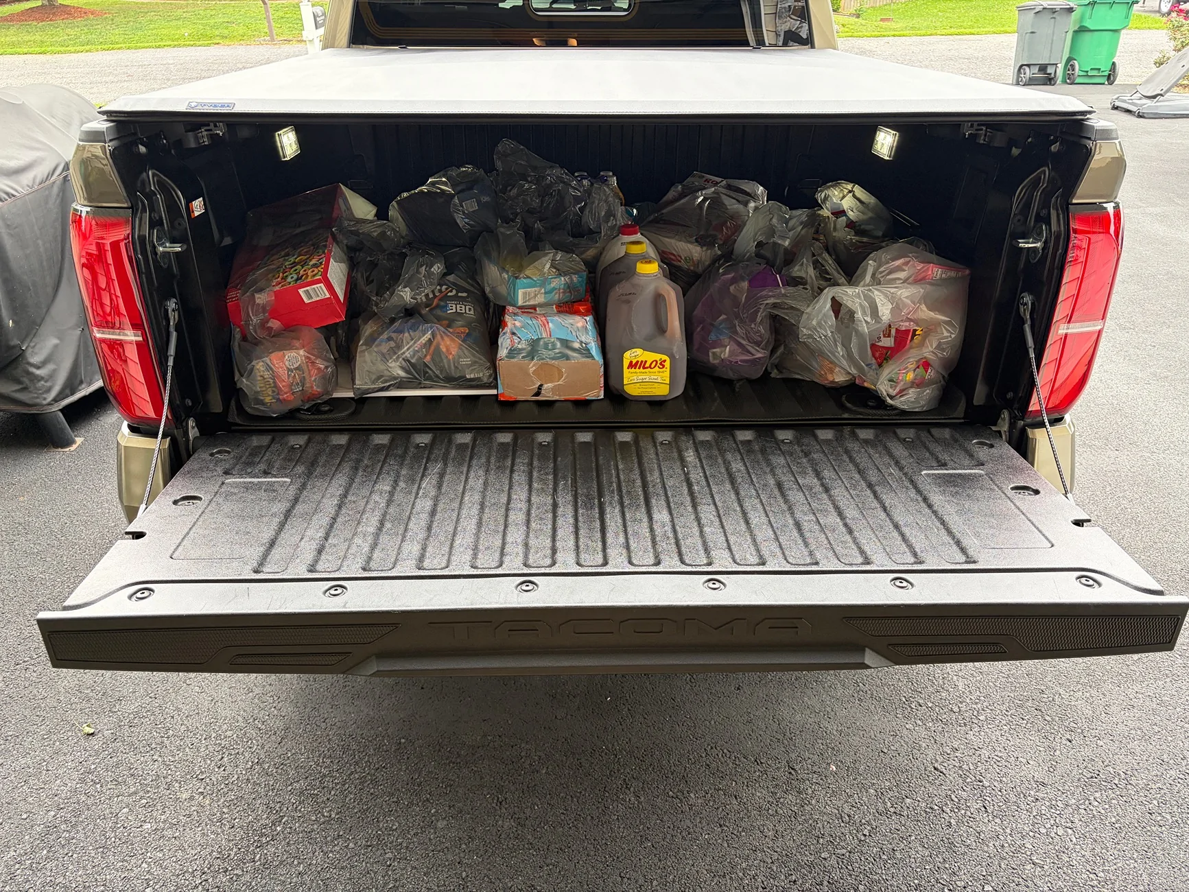

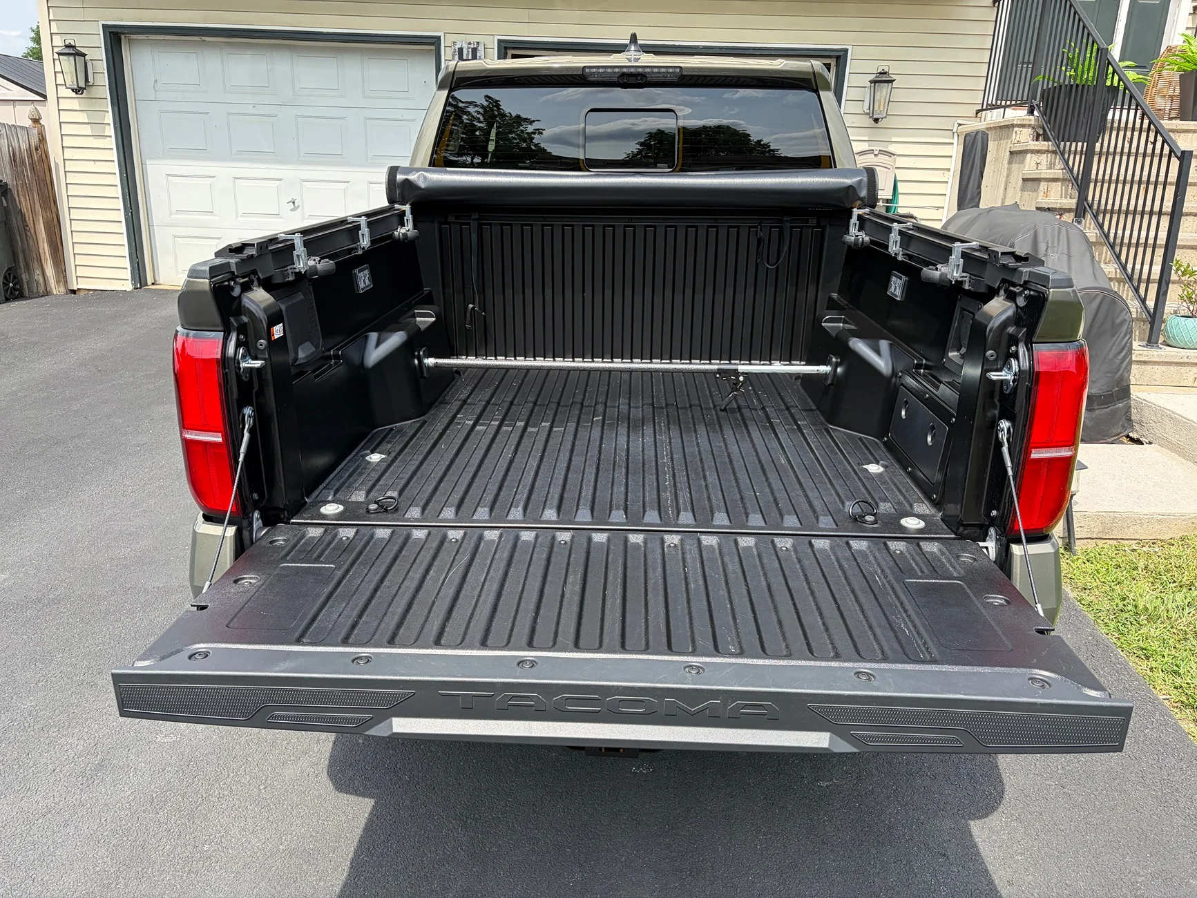

Previously my solution was a ratcheting bed bar to carry smaller loads like groceries but this was cumbersome as it was constantly coming in and out or needed adjusting for larger items.
Install was easy. And fitment was perfect. I let the mat lay out in my driveway for 20min. When I came back it was completely flat. This may take longer if it’s cooler out. It was on the mid 90’s when I started.

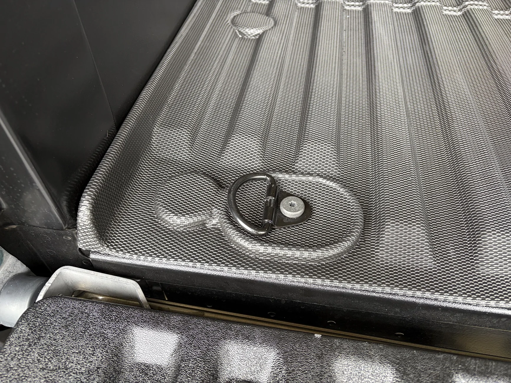

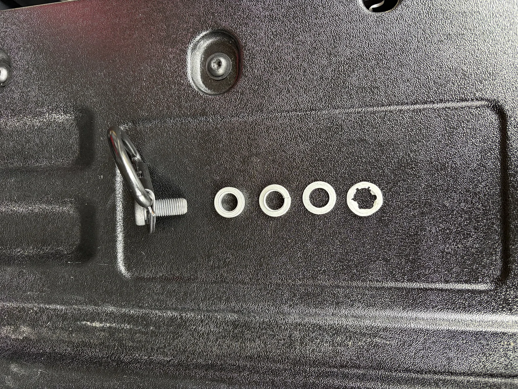

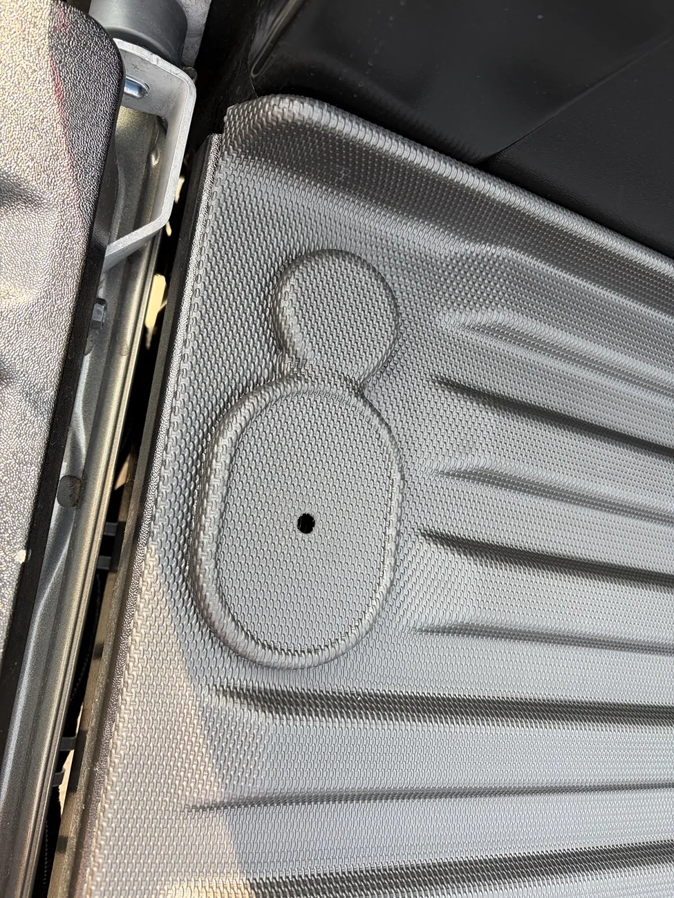

The mat looks like it was made so you can cut out around the bed d-rings, however I like the idea of it being secured. I decided to drill holes large enough to pass through the washer stack and bolt for the d ring.

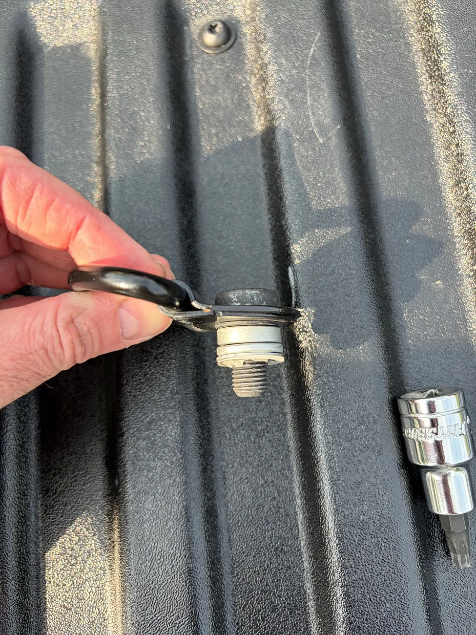

One tip I have for finding the exact hole location is to fit the mat in the bed and then put a little sidewalk chalk on the top of the bolt. When the mat is laid back down the bolt head will leave a perfect imprint to drill a small pilot hole. I then used a 7/16 (22mm) hole saw to drill out the main hole. This allows the entire stack to be torqued down without the mat interfering. The rings will still spin, though with a little more effort. The hole itself will still be hidden by the d-ring.
I’ve seen a few videos where the washer stack was not reused. I strongly recommend against this as removing washers will alter the load strength and sheer strength of the bolts.

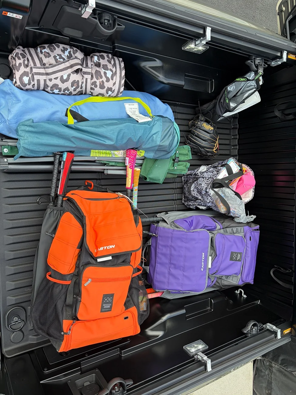

The mat got quite the workout this weekend with our travel ball schedule. I had multiple coolers, bags and chairs in and out. It rained so it did get a bit muddy. However you wouldn’t know. No noticeable scuffs and the mud wiped right out with a little ONR and a towel.
One surprising benefit was keeping my cargo dry. I have a roll up bed cover that leaks a little in heavy rain. After a 100mile drive home the rain that got past the bulkhead seal ran under the mat instead of on top.
