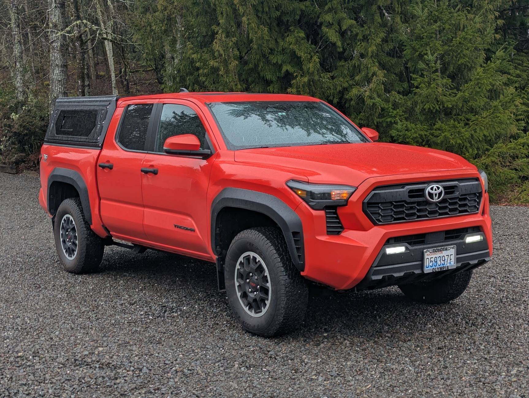

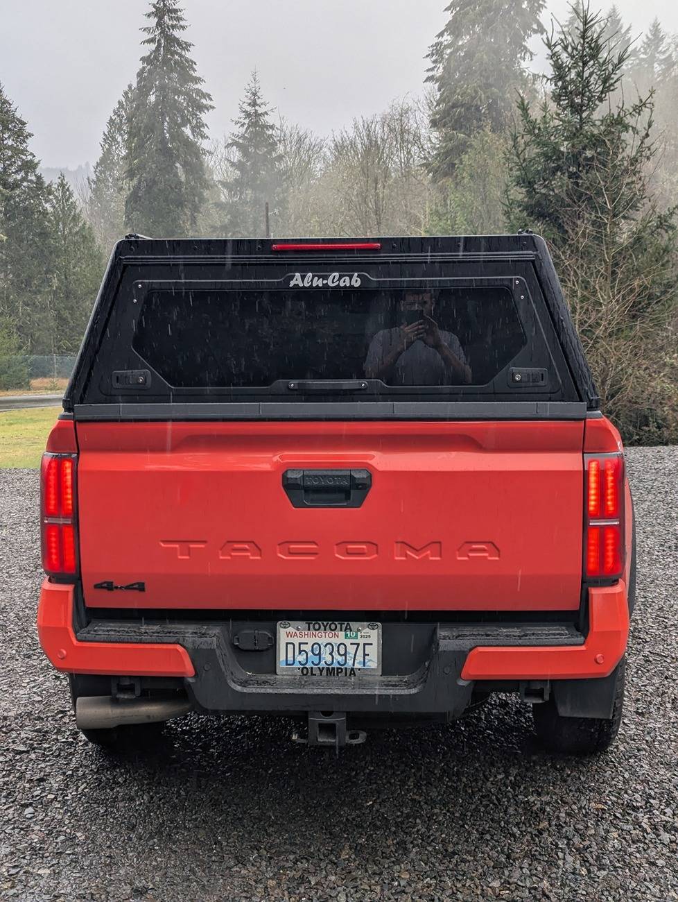

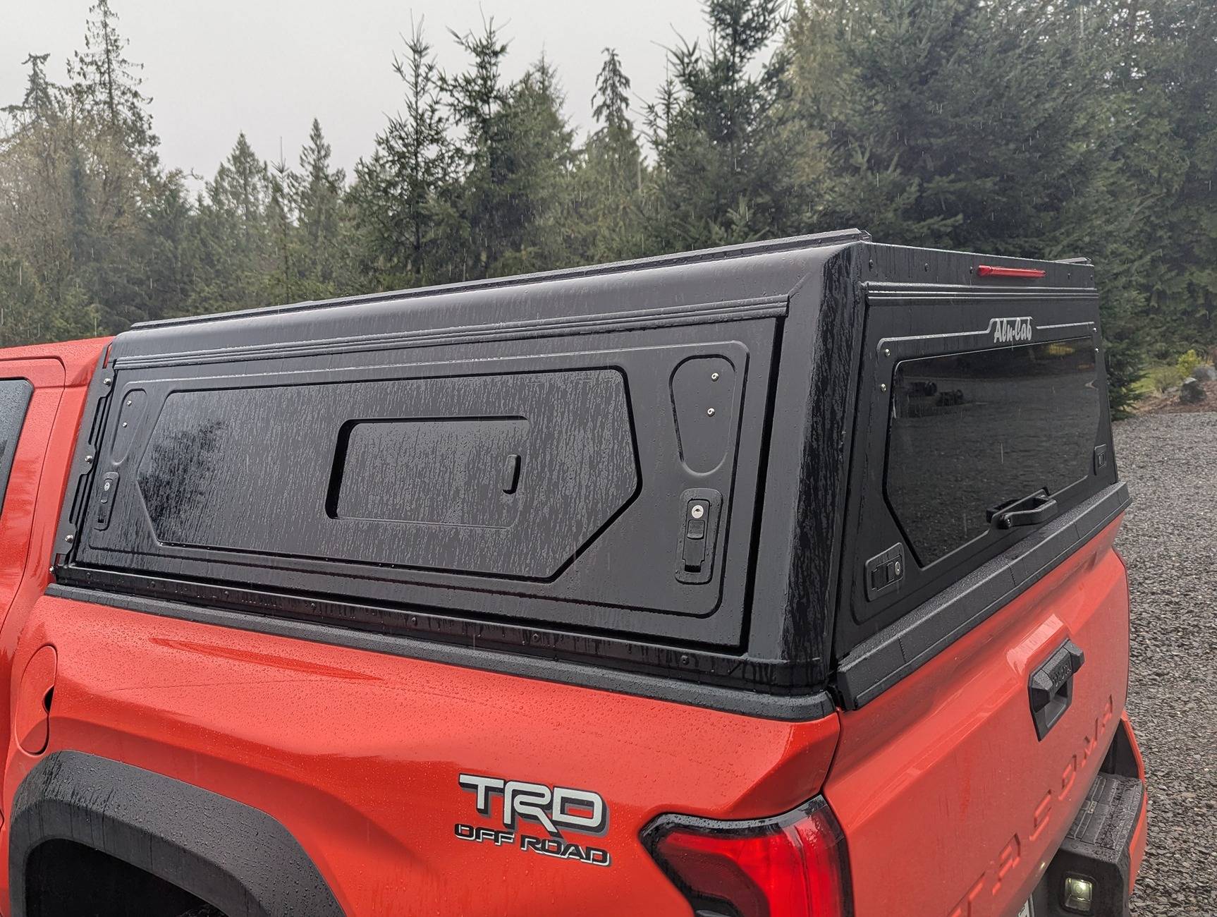

Cool! Alu-Cab definitely makes a quality product, I'm happy with mine as well. I also went direct to OK4WD Taking the time to do the install and wiring correctly certainly paid off for me too, very wet climate and doesn't leak a drop. I ordered the SmartCap third brake light T harness, and extended the rear gate struts to lift it up higher than stock.

Hello. I'm looking into getting one of these for my truck.
It looks like the filler kit is almost coming into contact with the spoiler. Is that a trick of the camera? Just curious if body roll/flex will be an issue with set up. Thanks.

Yeah, it doesn’t touch it.

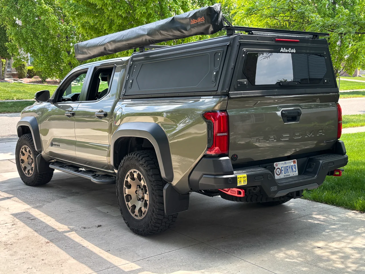

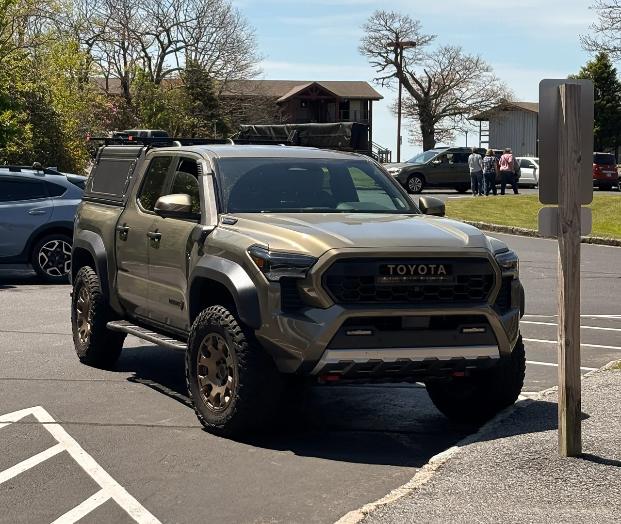

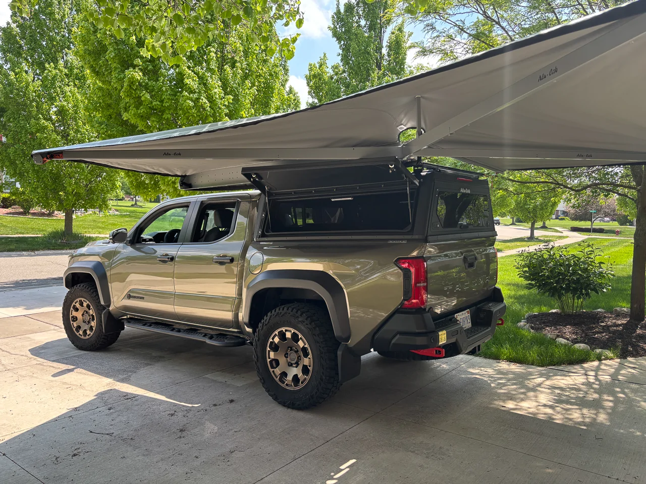

Had an Alu-Cab Contour canopy installed in May, and we've been very happy with it. From my perspective, the build quality, construction, and styling are all excellent. I was particularly drawn to the one-piece design, lighter weight, and strength. The appearance, while obviously subjective, was another selling point.
During installation, I had the interior lights wired through an sPOD. I like being able to turn them on and off from inside the cab. Of course, I can also leave the sPOD circuit on and operate the lights using their individual switches.
The canopy itself has proven watertight. We did notice a drip in the front-left corner after the first rain, but it hasn't reappeared, even after several subsequent heavy rains.
2024 Tacoma AluCab Contour Canopy - Installed Riddick - Alucab Canopy (3 of 3)
Unfortunately, the Tacoma's bed isn't airtight, so a day of driving on dusty roads results in a fair amount of dust getting inside. Alu-Cab promotes its positive-pressure air vent as a solution, but in my experience, it's ineffective. The forward-facing vent is designed to direct air into the canopy while driving. Unfortunately, it's almost completely blocked by the truck's cab, which sits less than two inches in front of it.
Some sort of air scoop might help reduce dust intrusion, but there's still the large gap around the closed tailgate to contend with. I'm debating how to address the problem while still opening the tail gate a dozen times a day. Dust intrusion is really my only complaint, and that's largely a limitation of the Tacoma's bed rather than the canopy itself.
Overall, my wife and I are very pleased. I've even added hooks to the interior so we can hang plants when visiting farmers markets or making similar trips.
2024 Tacoma AluCab Contour Canopy - Installed Riddick - Alucab Canopy (1 of 3)
Before the nine-day trip we just returned from, I added a cupboard with a MOLLE panel on one side. It held all my camera gear and related equipment. I deliberately chose the canopy without windows. Besides saving some weight, I didn't want someone to be able to shine a flashlight through the glass at night and see exactly what we're carrying (after dark, the tinted glass may as well be clear if you're using a flashlight). The cupboard also provides a separately secured storage compartment, adding another layer of security beyond the main bed area.
At the time of installation, I also added a Baja Designs chase light bar. We've encountered situations, particularly in blizzard conditions, where we've lost sight of the vehicle ahead of us. I wanted the additional lighting for safety, especially to help drivers behind us maintain visibility in poor conditions.
All things considered, we really couldn't be happier with the Contour. Setting aside the Tacoma's poorly sealed bed, the canopy has met or exceeded our expectations. It's dramatically improved the utility of the truck bed and made the Tacoma considerably more versatile.
2024 Tacoma AluCab Contour Canopy - Installed Riddick - Alucab Canopy (2 of 3)
